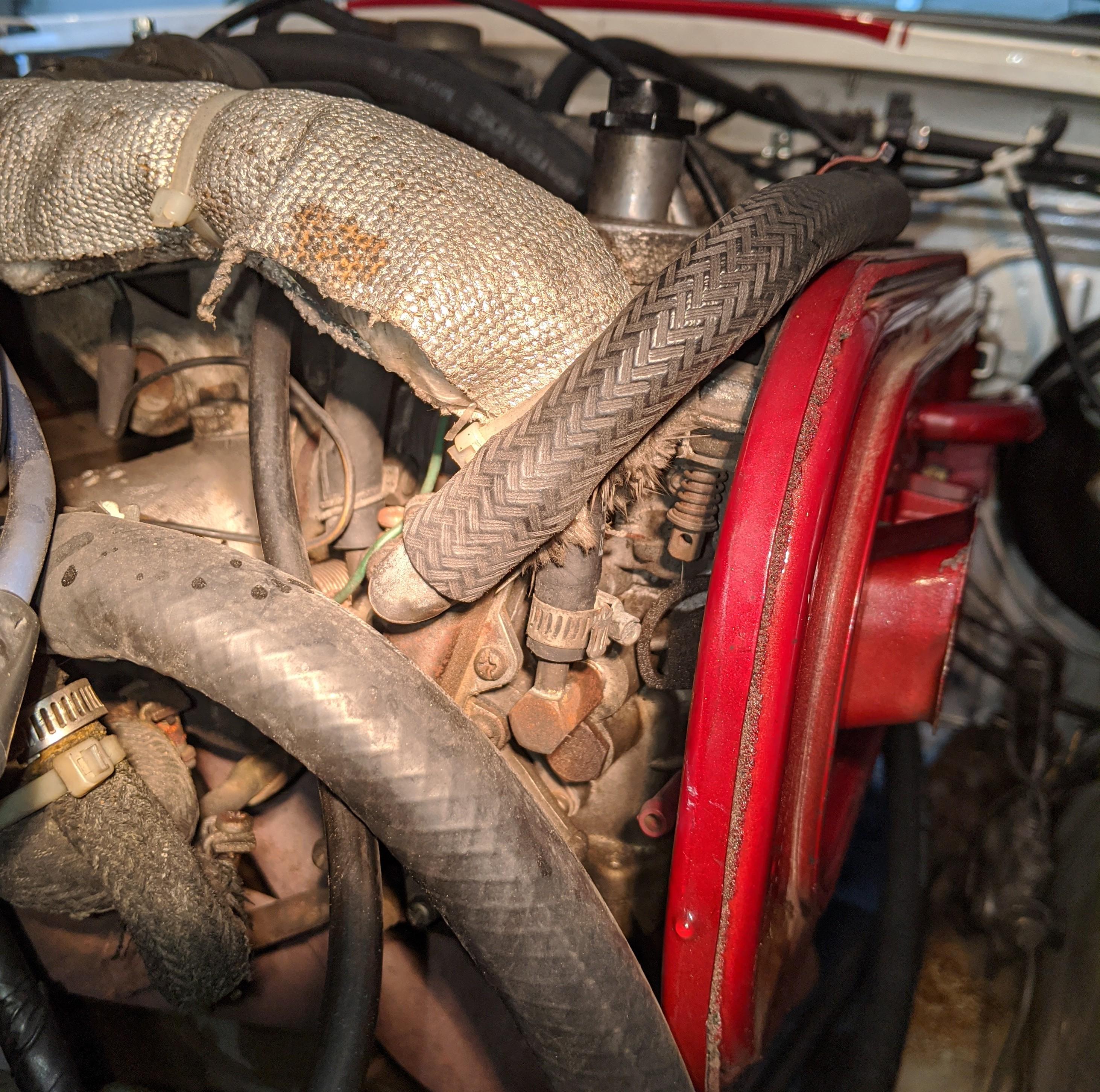

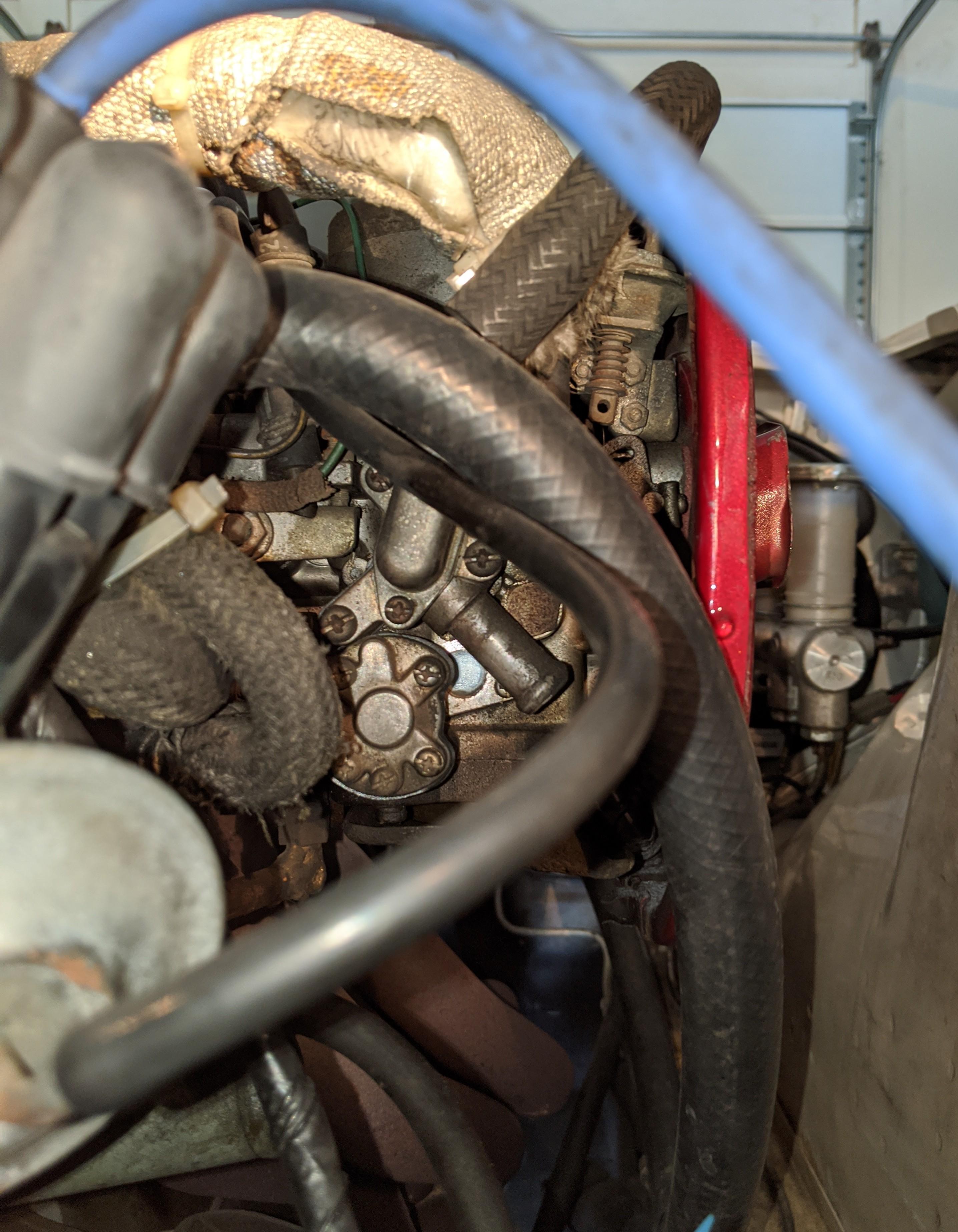

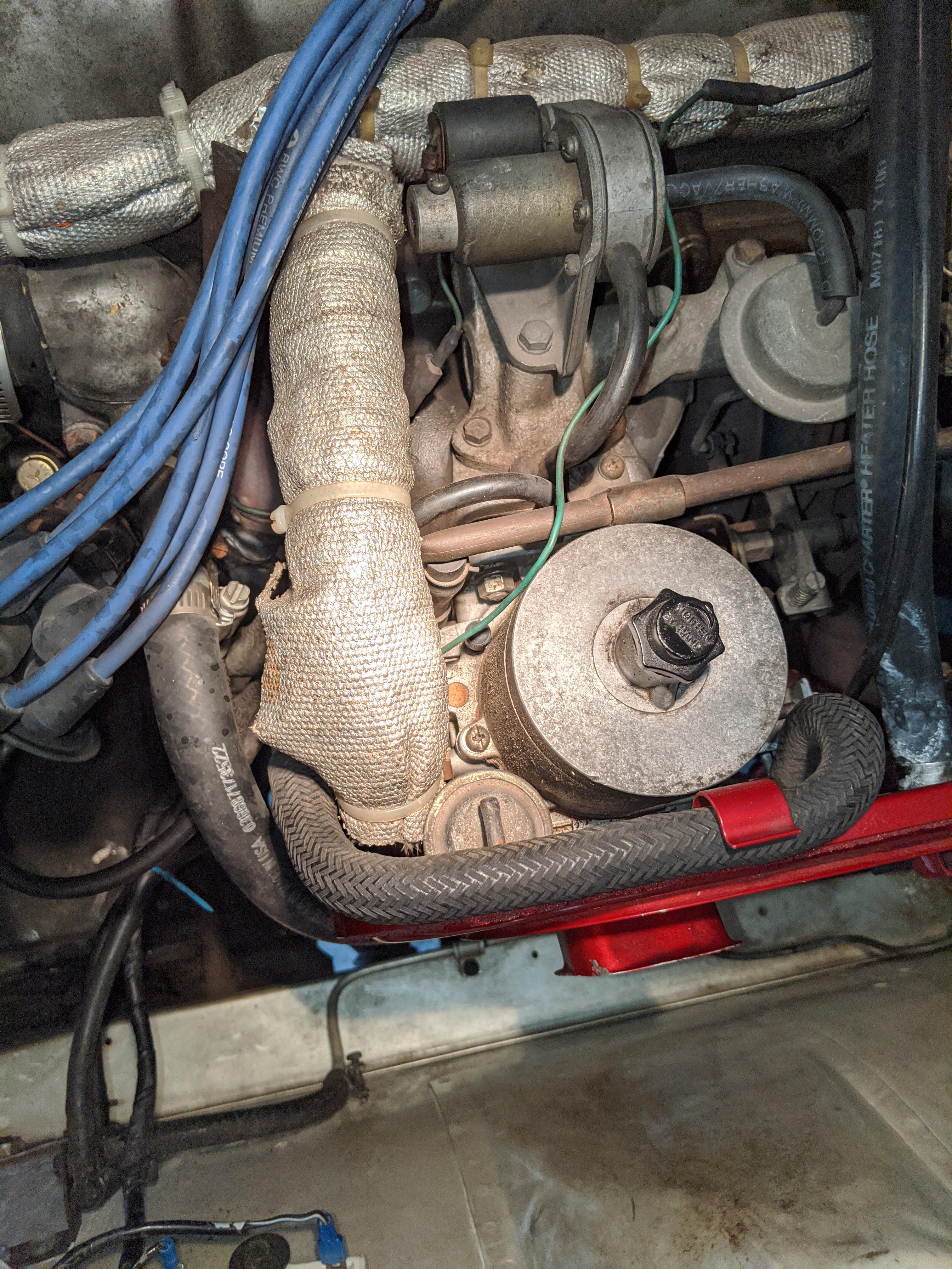

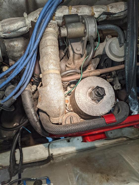

When you get a chance, can you take a pic of the front side of the front carb (the sight glass side) so we can see what type of flat top you're dealing with?

I have no idea.  Feeling a bit overwhelmed on where to start. Here's a few pics of that front carb as requested.
Wow. OK... Well after seeing your pics, I think those are the earliest versions of the flat tops. What's your build date stamp on the door jamb plate? Early 73 probably?
From what I've heard, many of those really early ones were pulled off and replaced with later versions because of complaints. And if the customer returned again with additional complaints, then the whole rack was pulled off and replaced with round tops.
In addition to the very early nature of that set, I also see a number of little things wrong or missing.
So honestly... You guys won't hear me saying this much, but unless it's a labor of love and you just want to be able to honestly say "I'm running the original carbs that came on this car from the factory", then even I would change those out.
At a minimum, if you want to stick with flat-tops, I would change over to the later version. If you're not that interested in fighting the incoming tide of sentiment against the flat-tops, then I would switch over to a pair of round tops. Nobody would hate you for that, and in fact, most people would think it's right thing to do.
