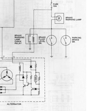

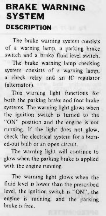

For 78, there are only a couple things that can turn on the brake light. 1) Pulling up on the emergency brake handle. 2) Low brake fluid level. 3) The brake check warning relay.
As Zed Head mentioned, the third one (brake check relay) is tied into the alternator charging system and will light up the brake light if the alternator output drops too low. But it's SUPPOSED to go back out when/if the alternator output rises to normal again.
So, I don't have any conclusive explanation for the latched warning light you experienced, but I would start with the easiest... If your brake fluid level is normal and your parking brake handle switch isn't "touchy", then I'd guess your brake warning relay may be having a problem. They fixed a lot of the electrical gremlins by the time they got to 78, but the earlier years have had issues with that relay.

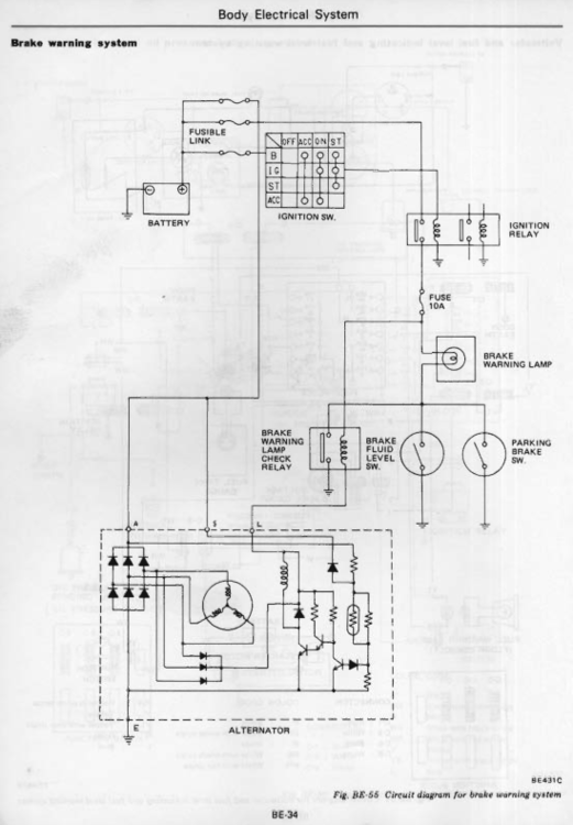

Here's some FSM stuff.  They show the relay locations in there also.

There are three possible ways to light the warning lamp and they are "in parallel". If any of them connects to ground, the light comes on. By disconnecting that relay, you have simply removed one of the possible ways to connect the lamp to ground.
The parking brake handle still works because it's still able to pull the lamp to ground even if one of the other paths (like the relay) have been completely removed. In fact, you said you have disconnected the brake fluid level switch as well, and the parking brake lever still lights the light. Same thing for the warning relay.

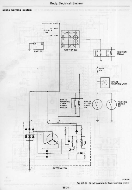

It's shown in the diagram.  There are three possible paths to ground the light circuit so the light comes on.  What you did suggests that the relay is stuck or the alternator "L" circuit is messed up, like gwri8 suggested.  Check the solenoid's circuit to ground on the relay and see if it's stuck.  It should be open circuit when it's unplugged.   If the relay is right then your alternator might be messed up.

Here is a more simple way to check the relay.  Plug it back in, turn the key on and see if the Charge light on your voltmeter comes on.  It should.  If it does not then the ground circuit through the relay and the alternator  is bad.  That would explain two problems.  Could be just a bad connection at the T plug on the alt, or a bad alternator or a bad relay.
