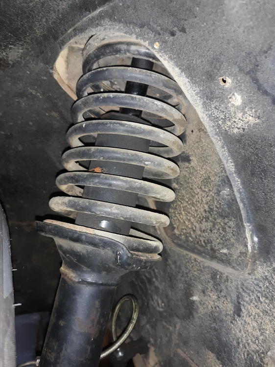

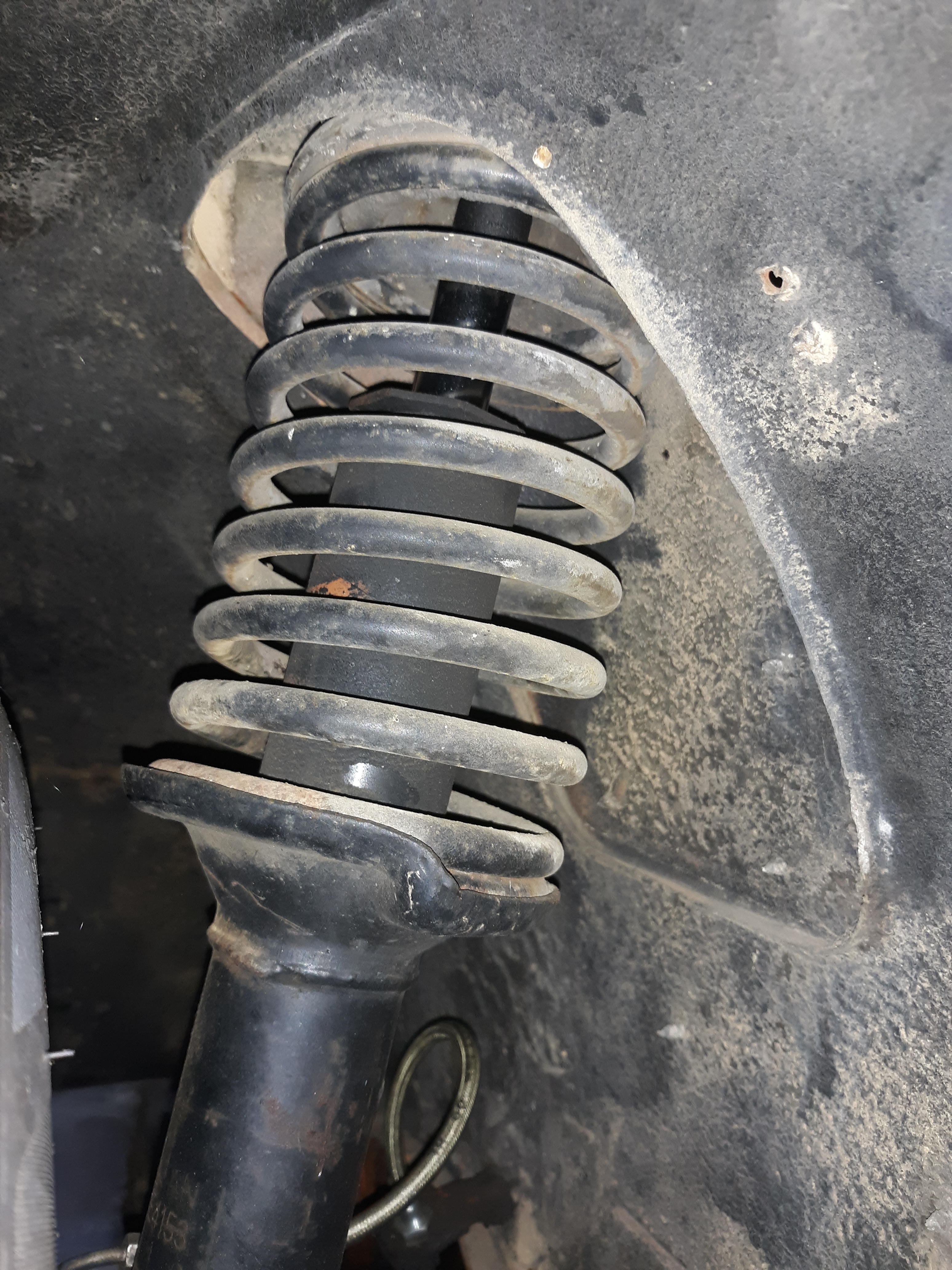

Mine were cut by the OPs mechanic in Huntsville. It rides rough, stiff I guess. They called it "clapsing the coil". It looks good but is harsh driving it.
If I had good struts it'd be okay I bet.

Thanks.  Perhaps you could count the number of coils on a front spring for me, OE is 10 turns from the tip of the wire to the other tip.  No rush on this.

Looks like they "collapsed" 2 of the ten. I'll count them Saturday. I need to rotate my tires anyhow. ?
