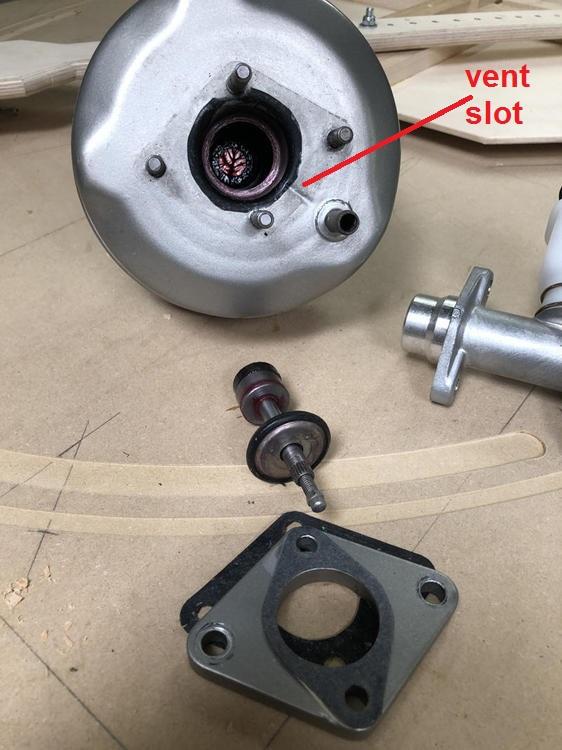

June 27, 20205 yr comment_601840 I believe there is a small dimple on the lower part of the hole the master cylinder bolts into on the booster. I believe it is designed to allow brake fluid to drain out instead of into the booster Link to comment https://www.classiczcars.com/forums/topic/63647-brake-booster-rebuild-help/?&page=2#findComment-601840 Share on other sites More sharing options...
June 27, 20205 yr comment_601842 ToolBoy, You can see the vent passage in one of the pics you previously posted: I thought there was slot in the master cylinder or adapter as well. I looked for pics, but unfortunately don't have any that would help there. Link to comment https://www.classiczcars.com/forums/topic/63647-brake-booster-rebuild-help/?&page=2#findComment-601842 Share on other sites More sharing options...
June 27, 20205 yr Author comment_601844 Perfect, I never noticed that passage before. I'm hoping I can get plate/seal/rod to seal well enough. Link to comment https://www.classiczcars.com/forums/topic/63647-brake-booster-rebuild-help/?&page=2#findComment-601844 Share on other sites More sharing options...

June 28, 20205 yr comment_601857 7 hours ago, ToolBoy said: Perfect, I never noticed that passage before. I'm hoping I can get plate/seal/rod to seal well enough. If the surface of the rod isn't all pitted with rust, it should seal pretty well. In the area where it matters, yours looks pretty good. So about the vent passage... Are you sure the gasket you put on there isn't compressed into the vent and blocking it off? I'm beginning to think that there is NOT another passageway on the adapter plate or the back of the master cylinder. That slot may be the only vent? Link to comment https://www.classiczcars.com/forums/topic/63647-brake-booster-rebuild-help/?&page=2#findComment-601857 Share on other sites More sharing options...
June 28, 20205 yr Author comment_601860 Thanks for the follow-up. The rod does look good although it might have a few tiny chips in it and I don't remember if I used the plate and seal from the kit or the one that came with the car. The first time I checked vacuum it held and the second time it dropped a little. I cut the gasket myself but given the new info I'll leave it off when I reassemble. You're in Philly? My mom's brother lived in Philly for 30 years and my mom is from Beaver Falls. I'm originally from Lancaster. Link to comment https://www.classiczcars.com/forums/topic/63647-brake-booster-rebuild-help/?&page=2#findComment-601860 Share on other sites More sharing options...
