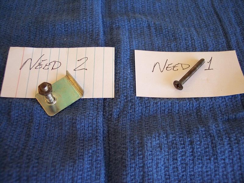

Hey folks,
 As part of my refurb of turn signals and license lights, I am in need of a few parts.  On the left in the pic is the small/outboard bracket (larger one is inboard) that secures the turn signal housing to the valance - needing two of these with nuts.  On the right is the 30mm screw that holds the license light together, needing one.  I'm hoping that one of our more prolific hoarders might have these bits.  Not looking for freebies, will pay.
Thanks,
Jim
2 hours ago, jfa.series1 said:
Hey folks,
Thanks,
Jim

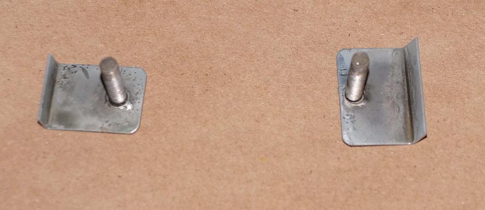

Steve - thanks for your comment and link.  I actually have the two brackets I requested but the studs were broken off on both.  Your link inspired me to salvage them by grinding the heads down flush and then popping out the remaining stud.  Now to follow the rest of your link with replacement bolts.
Jim
I was very pleased with how well my solution worked. I don't do a lot fabricating, so I was flying by the seat of my pants. JB Weld is great stuff when used in the right application.

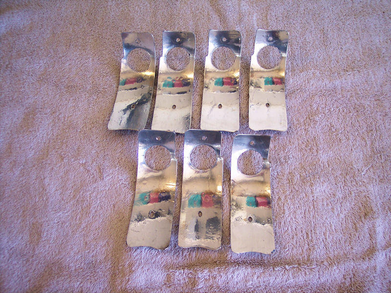

Turn signal reflectors with fresh faces.  The box of turn signals came with some wiring harnesses.  I'm familiar with the T-connector style but not the round one - 260Z?
