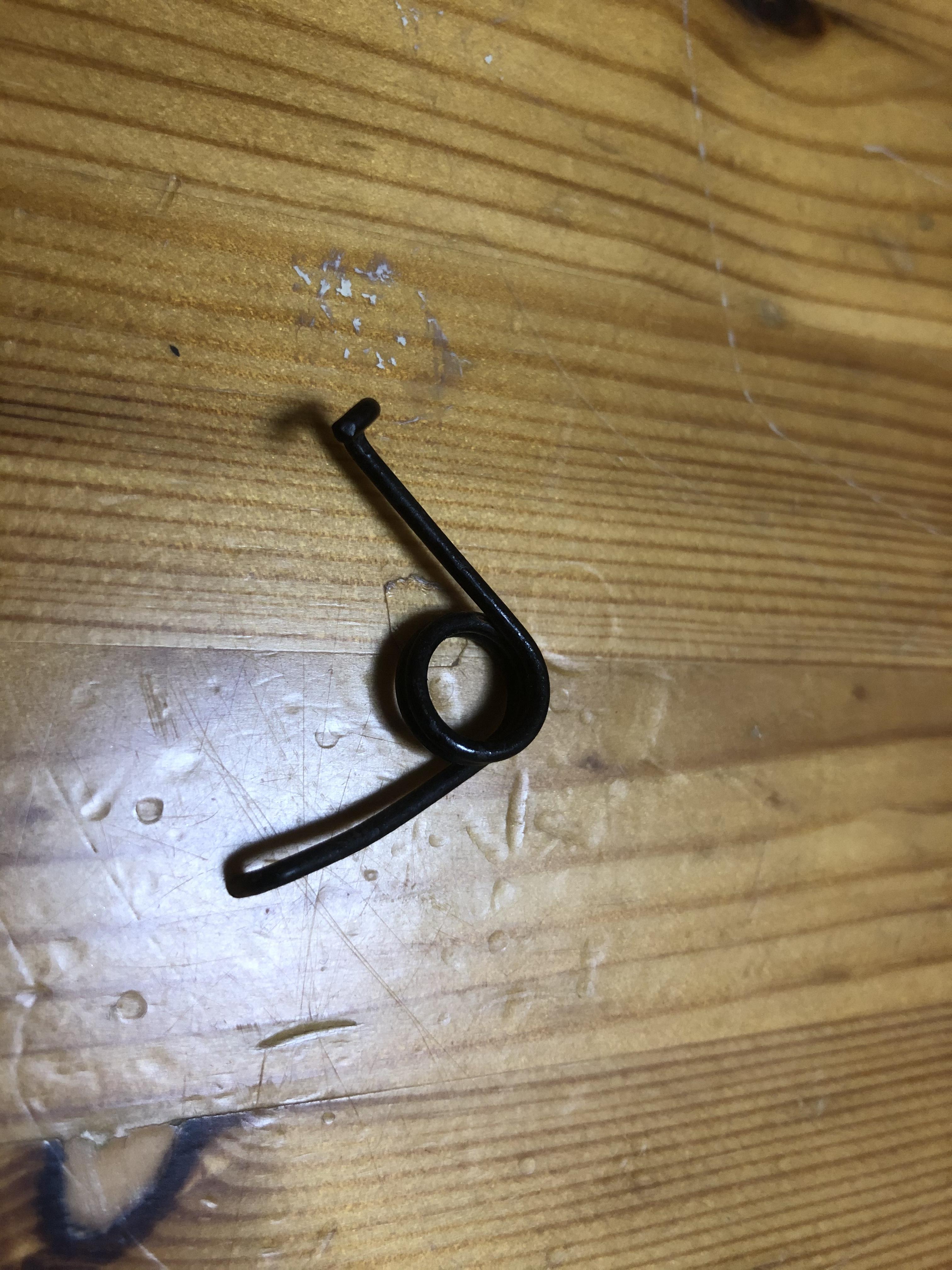

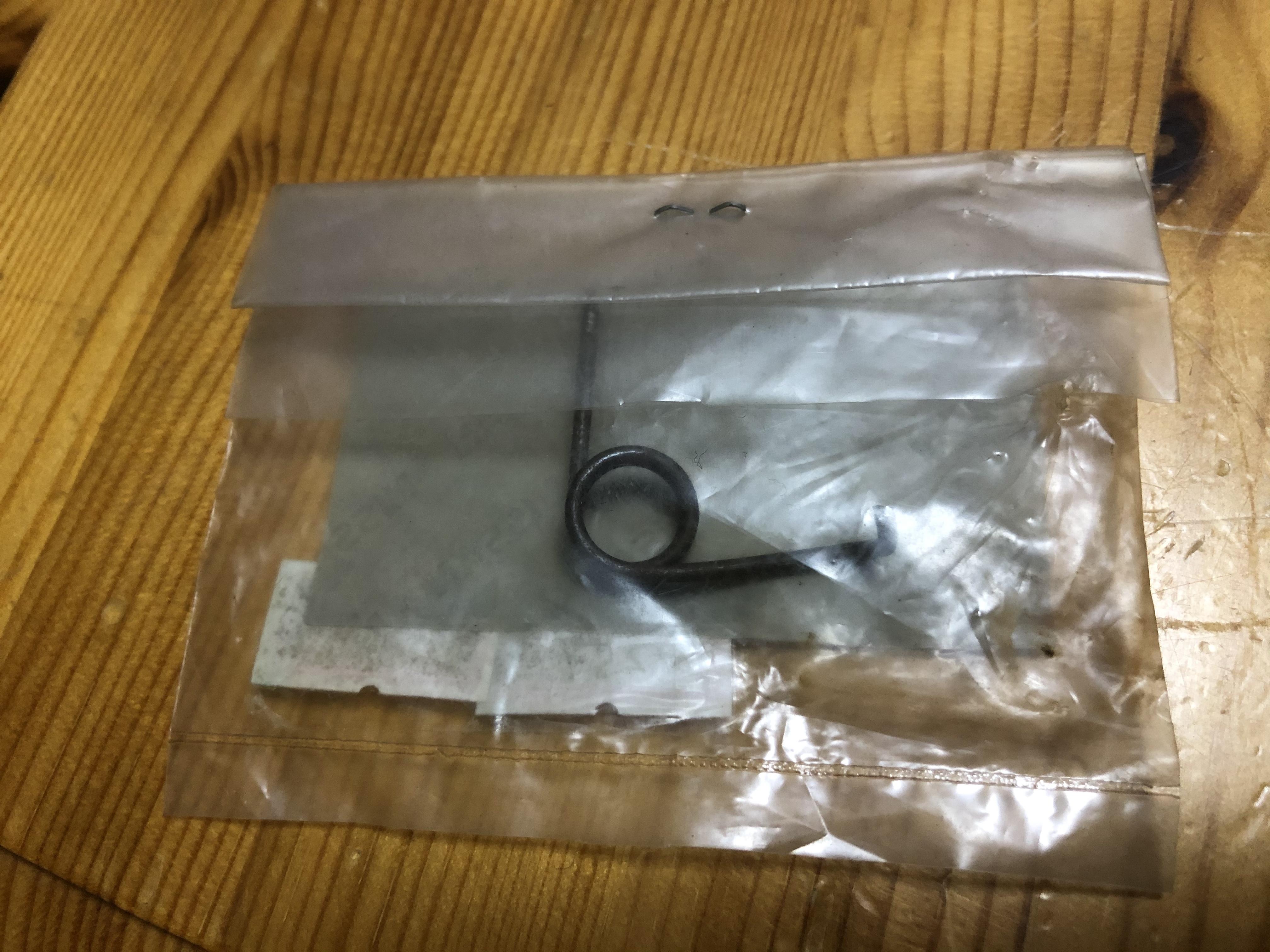

Hi Jerry , is this what you are talking about ?
I pulled this spring from my 1972 Orange 240Z and Fairlady 240ZG . Both fuse door lost one pin to be pushed in . The cause of cracking pin on the console side is too much high tension of this spring .
I can say 90 % of them are broken . I had to repair ( actually I made ) a new pin to match the hole of the fuse door , but I gave up installing this spring because I didn’t want to break the pin once again .
So I hope someone will make a replica of this spring with a lot lowered tension.
Kats
