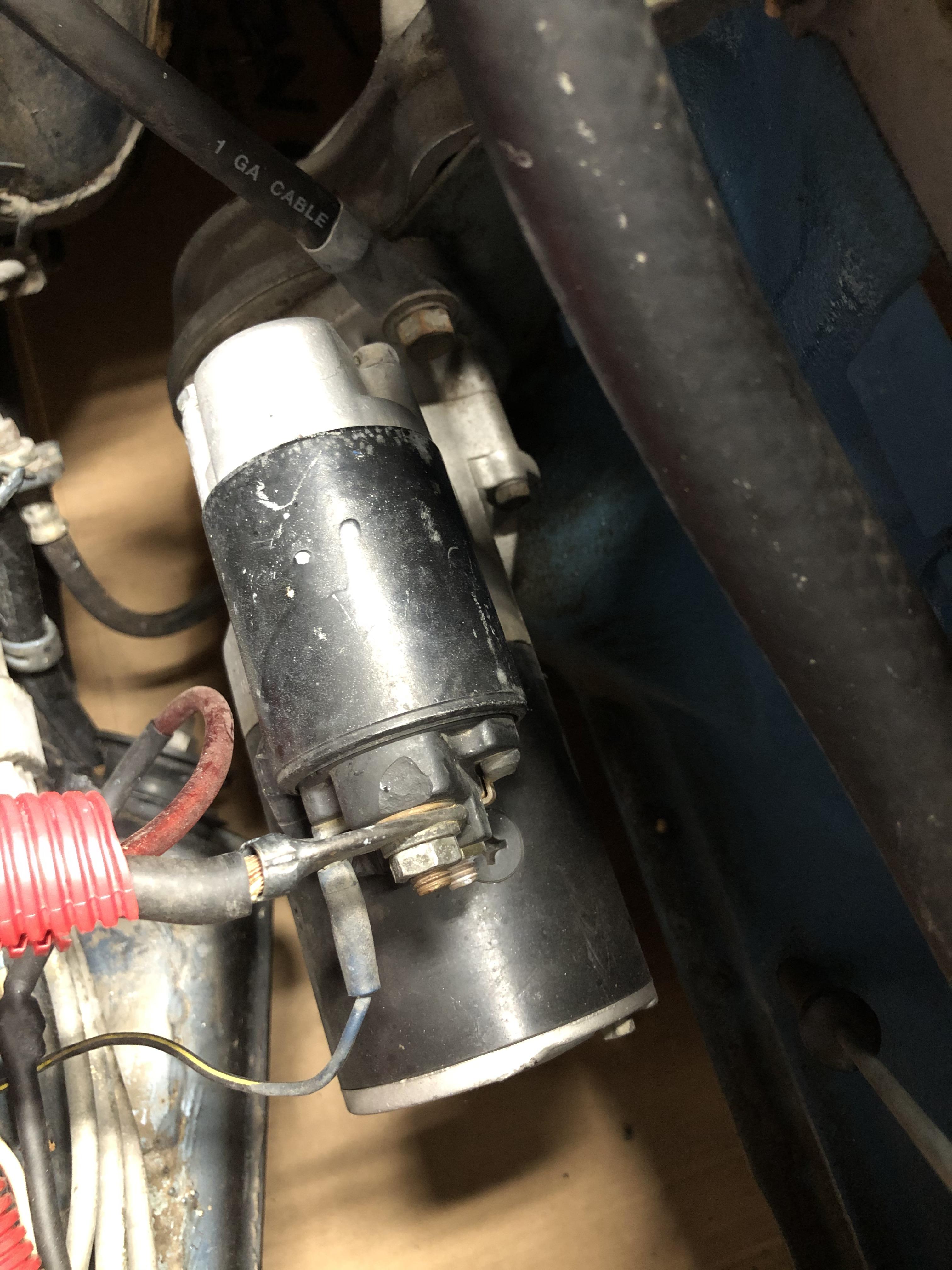

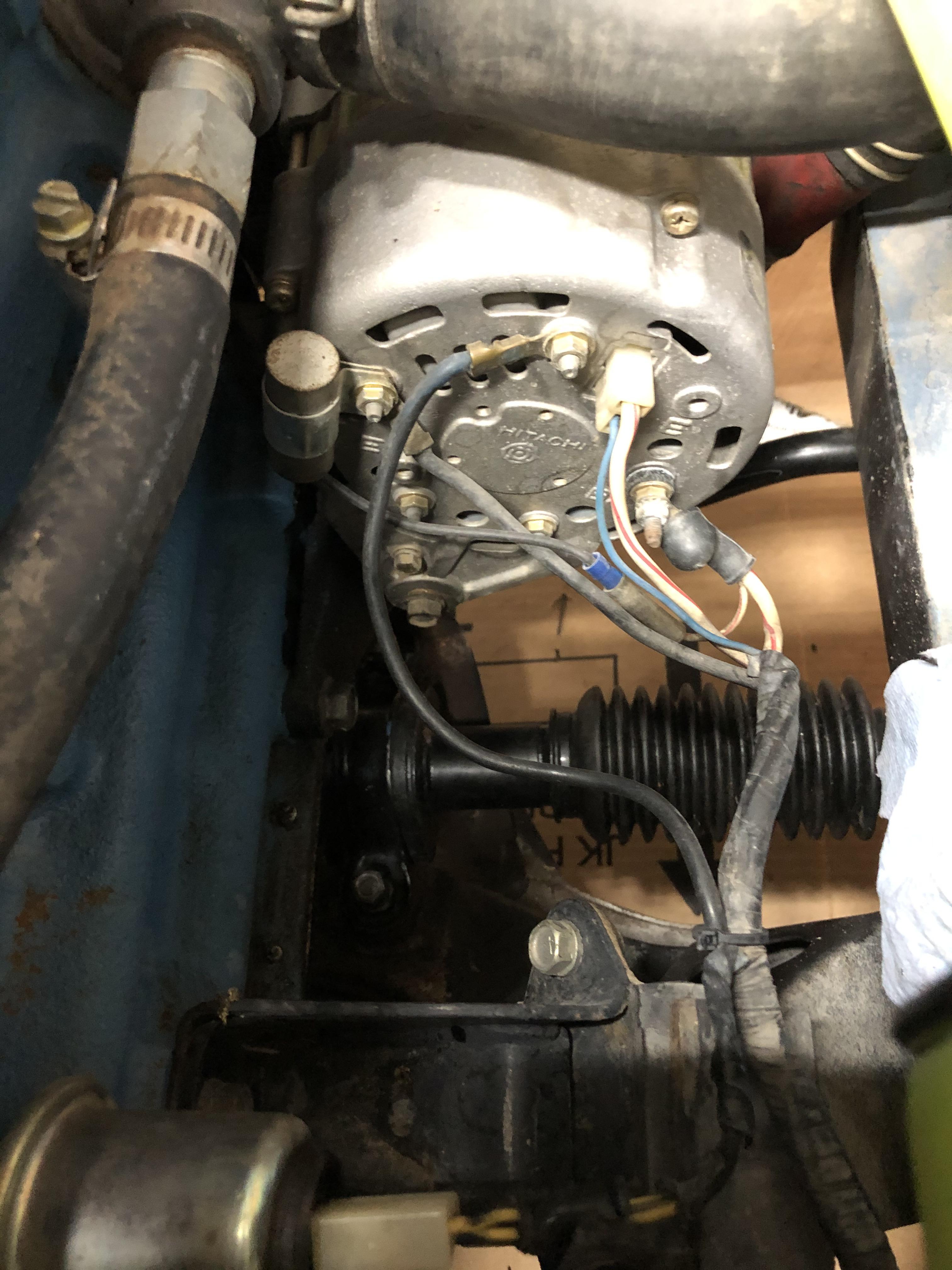

Before trying to start up, I was going to disconnect the starter and see what the fuel pressure looks like just with the fuel pump going. My question is, which wire should I disconnect from the starter? I could just disconnect all of them, but thought I'd ask for advice.
Disconnect the small black wire with a white stripe. Should be a spade connector, and it should just pull off. No tools required.
Don't let the dangling B/W wire short to anything. Put a piece of tape over it if you aren't confident.
1 minute ago, Captain Obvious said:
Uhhhhh... That's not the starter.
The starter is the other big electric thing behind you below the battery.
Ha. Sorry. Wrong picture. I should have just read a book instead of working on the car tonight. Too long of day...
Haha! Yes, black with yellow. not white. Sorry.
That's what I get for relying on memory.  LOL   Glad I got the starter location correct at least.
Pull that small black with the yellow stripe off and then turn your key to START. You should hear the fuel pump run.
Thank you @Captain Obvious for the help. The good news is that the fuel pressure seems much better. Didn't hook up the good gauge, but the inline one is showing around 34 instead of the 14 it was before.
