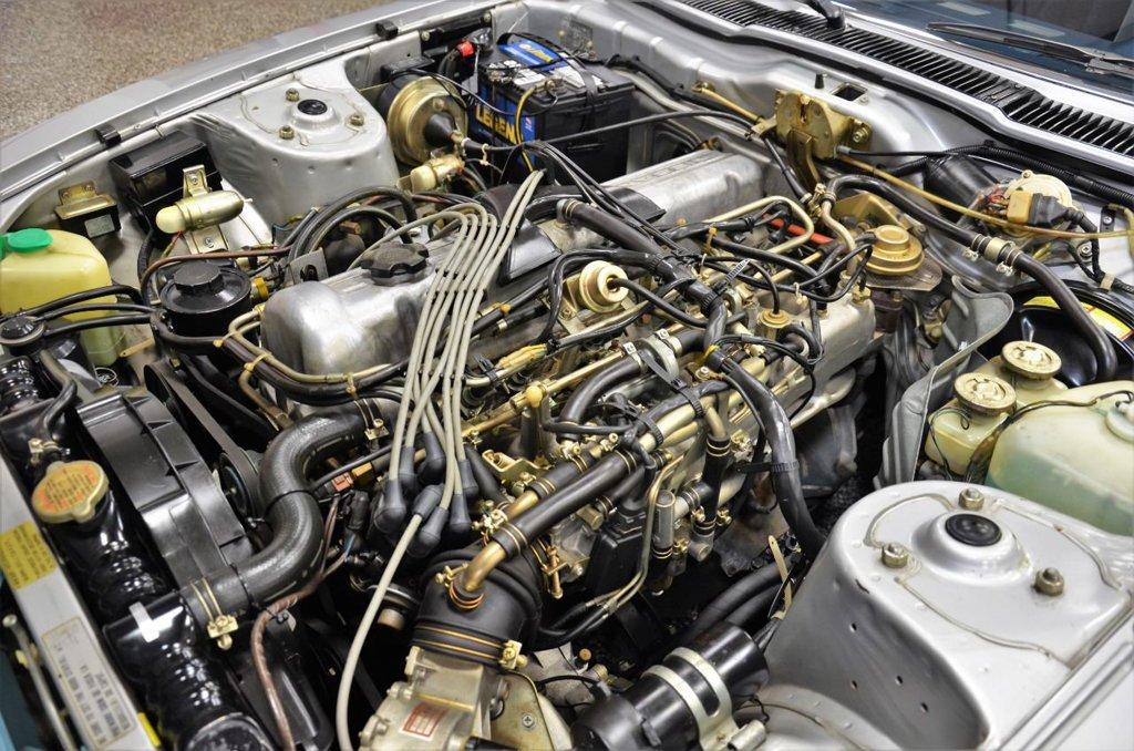

From the photo I posted earlier, see how sharp the engine looks? I had the fuel rail and numerous other parts re-dipped in cadmium. Not painted with the cadmium paint kit. It's the real thing. I had it done in Chicago. Please let me know if you want to know the name of the company. I highly recommend this company. They do a lot of industrial plating.
The only thing is you have to clean the items first. Yes, you need to sandblast all of it, and then plug the ends of the fuel rail. But it comes back absolutely golden.

CAR54280ZX, thanks for the info on the fuel rail.  I have already done than to mine by a plating shop here in LA.  I believe the process is to zinc plate first, then polish that to a high shine, and dip in heated sodium dichromate.  I paid $150.  It looks like its gold plated.  Waiting for improved weather to clear coat the intake manifold, and then begin the assembly.  I also set up a plating line in the hanger to do the small stuff.

From my extensive research on plating, I also believe that your explanation of the process is right-on! I went to the Caswell Store to see if I could do it myself. But after extensive reading about do it yourself blunders, I decided to have it done professionally. Home / garage doers need to perform this process in warm weather temperatures and with lots of ventilation.
But, I’m not sure how they can polish the fuel rail. Hard to do on the fuel rail.
In my case I think they dipped it in another chemical after the zinc plating, but before dipping it into the yellow chromate solution.
In addition to the fuel rail, I had them apply the yellow chromate to several other miscellaneous parts like the hose clamps, small bolts, nuts and washers, and other pieces from the engine bay that had the yellow chromate originally. I believe they put these small parts in a basket for immersion.
I can say that they did a great job and all of the parts carry that irradiance color.
Beware. If you clear coat the intake manifold, it’s considered as a modification and you will lose points in a serious car show. Take it from me. I powder coated the intake manifold, the valve cover and transmission bell housing. Only to discover that I lose points for these minor upgrades.
I hope I don’t get hammered by the web master when I explain that the firm who did the work was RELIABLE PLATING, located in Chicago, in a good neighborhood! Cost me $150 for the entire inventory of fuel rail parts including hose clamps, washers and nuts clamp bars, etc. This company did an excellent job, with a two week turnaround time. This company is a sizable outfit, but they do this plating all the time for small time automotive enthusiasts!

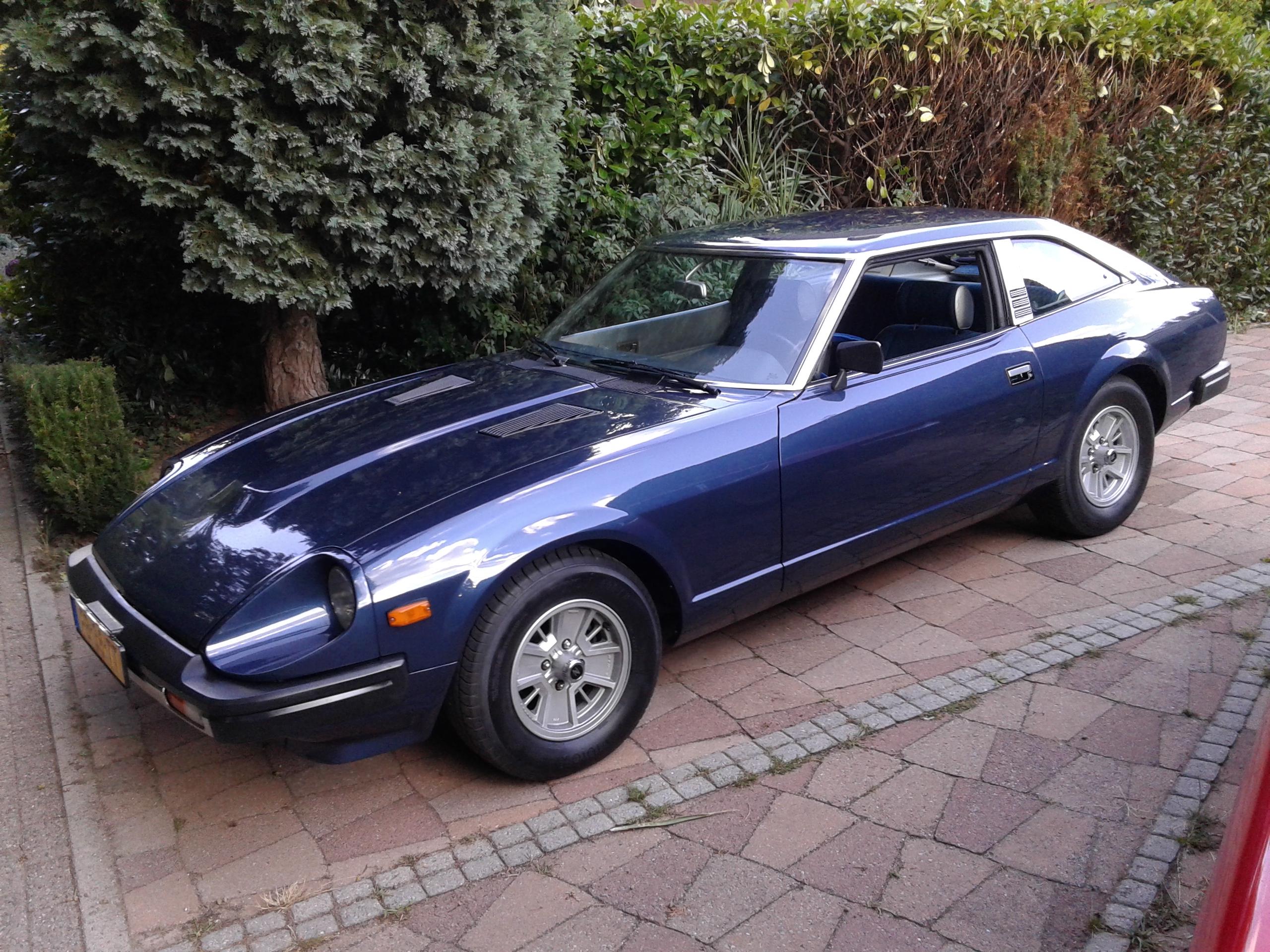

Here a pic of my restored/refreshed car.. a 1979 slick roof 280zx 2+2
Still busy with little things like a restore on the rear window washer pump..  Drove over 500 km. Oil looks still fairly clean!
