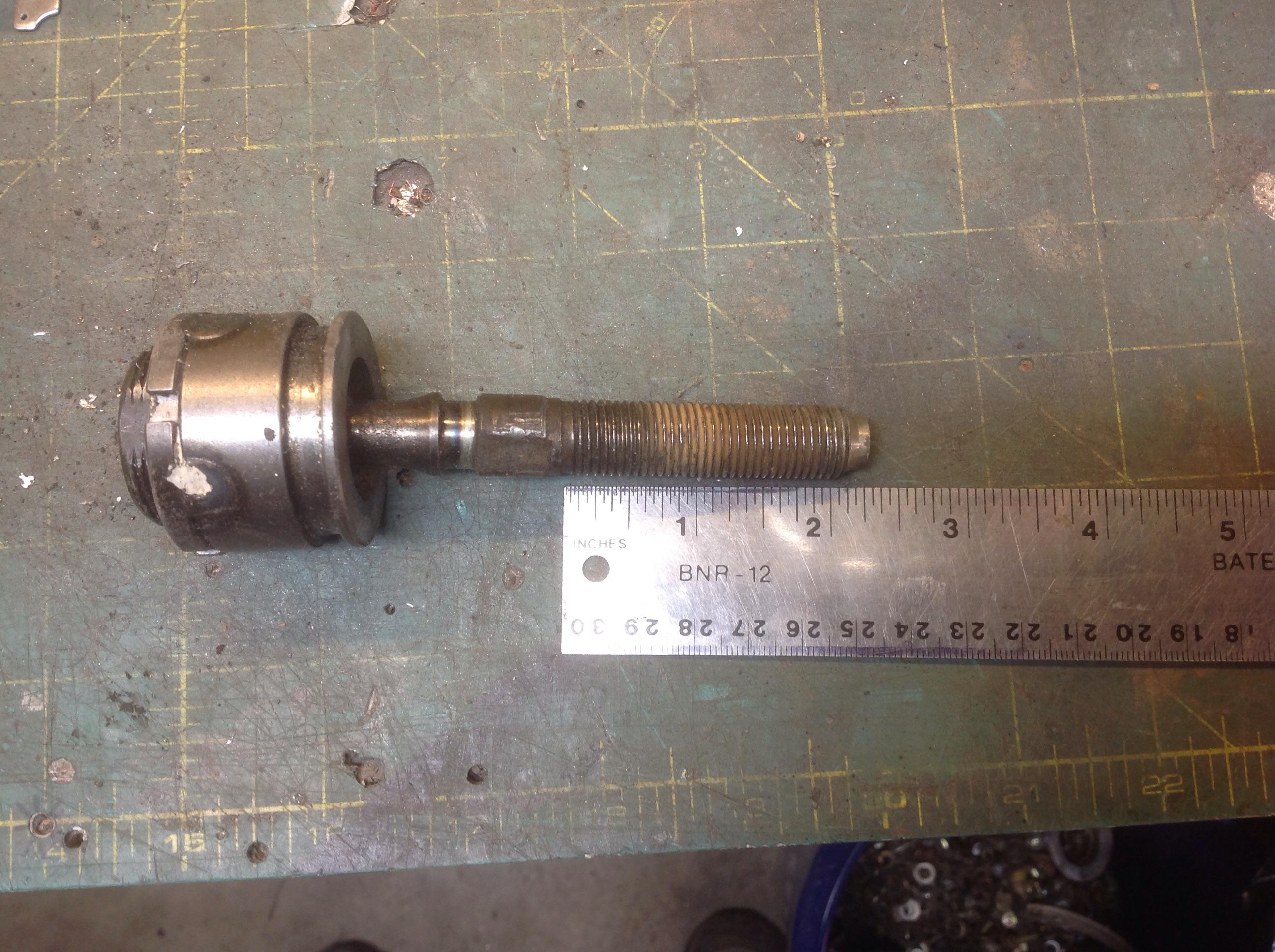

Anyone know offhand how long the threaded portion of the inner tie rod is on a 240Z?
Added camber with new lower control arms and need to adjust toe out quite a bit more.
Want to make sure I do not go too far for safety reasons of course. Thanks.
https://www.classiczcars.com/forums/topic/62645-inner-tie-rod-length/
Super. Thanks zKars. Shows 2".  I have just around 1" out so I am good. I had it all back together and did not measure it,
so that saves me from pulling one end off again. I owe you one.
I ended up with a lot of toe in by lengthening the lower control arms so I needed to crank more toe out to bring it back.
Glad I had one handy.
