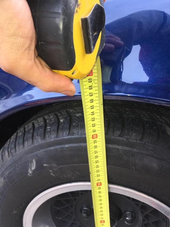

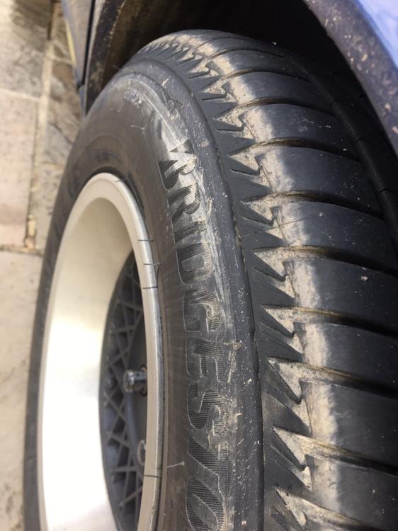

Having put on the new Bridgestone Turanza T005 tyre all round on car, the grip is frankly phenomenal!!! The down side is the occasional rubbing I used to get on the arch lips is now quite frequent as I can load the suspension up a LOT more than with the Michelin “no wet weather grip / easy to slide in the dry” Energy Savers.

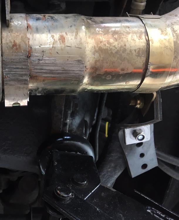

I also have found that despite my gorgeous Z Story exhaust being tightly installed within 5-10mm of the rear cross member, she has been getting flesh wounds with 2 x 75Kg middle aged men/boys in the car driving over fast bumpy roads and loading up the rear under power in a straight line...
809f5247e4765c2a5d988682a91cd020.jpg&key=baa9e1d2d0d0ed00d64bc07d553f81d27dc76bf465ccda439c8383cfbef08403
The suspension is travelling 3 inches or more to get there.
I have what appears to be uncut but lower springs and Tokico HP / Blues installed by PO. The ride height is not silly low either ...

I've been hearing for the past year that the Illumina shocks are no longer available for Z cars, I have a set and they are good but as soon as one fails I'll be going with the Konis.  Eibach lowering springs are one of the most popular springs for our cars for a reason, they work. I used to have a set of the Tokico lowering springs and I was bottoming out just like you describe, but no problems with the Eibach springs.
Bump stops are very important, the hard urethane are practically useless for cushioning, when the shock hits them it really does STOP.  But the newer urethane foam bump stops are a different ball game, they are progressive,  Koni makes a good urethane foam bump stop as well.
