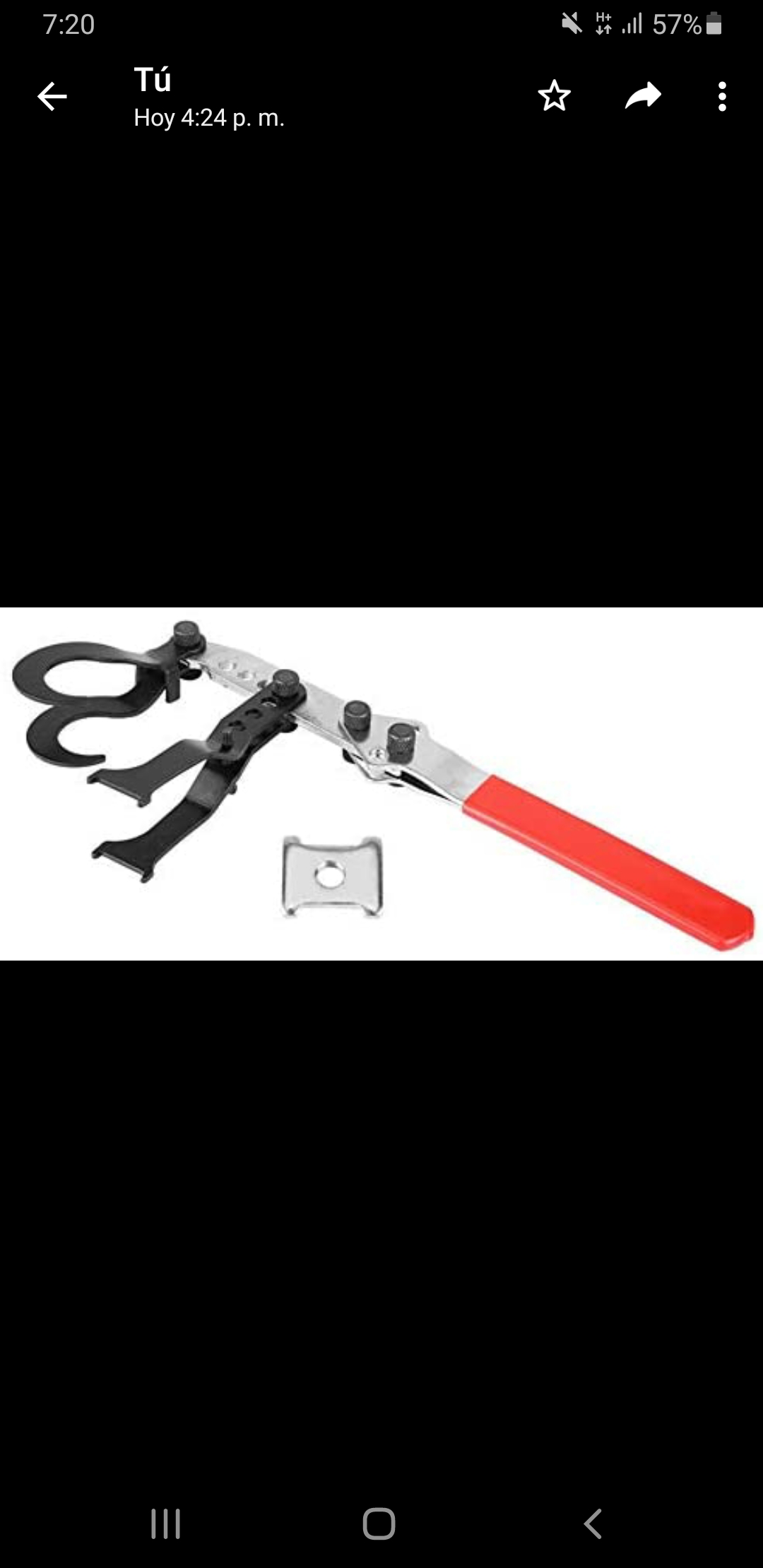

May 18, 20214 yr Author comment_621773 20 minutes ago, Mark Maras said: @jalexquijano Everyone agrees there's no need to remove the head to change a valve seal and if you do you may be opening a Pandora's Box of trouble and expense. The compression is good on all cylinders so we know the rings and valves are sealing. The only problem is a fouled #4 plug which, by process of elimination, we've come to believe is a leaking valve seal. Installing one valve seal is a piece of cake compared to pulling and reinstalling the head. Im trying to get the spring retainer locally and an air compressor to keep the valve from falling. Link to comment https://www.classiczcars.com/forums/topic/62317-random-misfire-while-cruising/?&page=13#findComment-621773 Share on other sites More sharing options...
May 18, 20214 yr comment_621776 18 minutes ago, jalexquijano said: Im trying to get the spring retainer locally and an air compressor to keep the valve from falling. Good man! You're doing the right thing! 👍 Looking forward to hearing about your successes. Link to comment https://www.classiczcars.com/forums/topic/62317-random-misfire-while-cruising/?&page=13#findComment-621776 Share on other sites More sharing options...
May 19, 20214 yr Author comment_621806 7 hours ago, AK260 said: Good man! You're doing the right thing! 👍 Looking forward to hearing about your successes. I need to buy this spring retainer prior to anything. Which brand would you recommend or will this one suffice? What happens if the valve falls and i need to take the cylinder head out? Should i also order some bolts and extra gaskets to complete this job successfully? Link to comment https://www.classiczcars.com/forums/topic/62317-random-misfire-while-cruising/?&page=13#findComment-621806 Share on other sites More sharing options...
