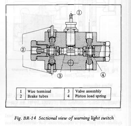

June 8, 20196 yr comment_577191 When one of the brake circuits (front or back) fails, there is a piston in there that slides and illuminates the brake light in the speedometer Link to comment https://www.classiczcars.com/forums/topic/62225-brake-booster-problems-with-heat/?&page=2#findComment-577191 Share on other sites More sharing options...
June 8, 20196 yr comment_577196 The fluid passes right through it. Front and back are separated. The piston in the middle moves if there's a pressure differential. Link to comment https://www.classiczcars.com/forums/topic/62225-brake-booster-problems-with-heat/?&page=2#findComment-577196 Share on other sites More sharing options...

July 3, 20195 yr comment_578930 When one of the brake circuits (front or back) fails, there is a piston in there that slides and illuminates the brake light in the speedometerThe brakes need to be “pumped” to actuate the piston in this device. The piston then blocks the defective line and shuttles all fluid to the working brakes. Quite ingenious really. ... as long as you remember to pump the brakes when they fail! Link to comment https://www.classiczcars.com/forums/topic/62225-brake-booster-problems-with-heat/?&page=2#findComment-578930 Share on other sites More sharing options...
