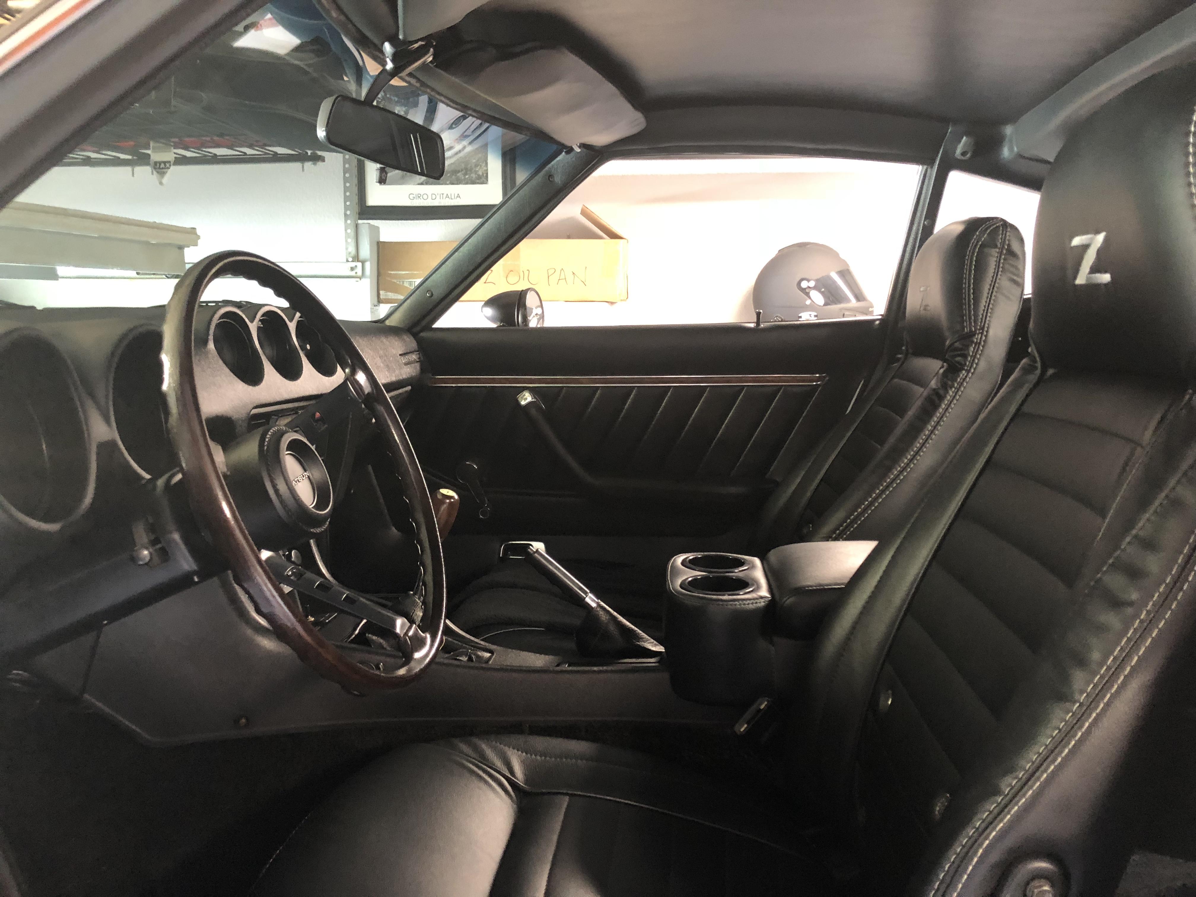

May 24, 20196 yr comment_576165 I used a stain on mine and it’s much to dark. I sprayed it with a couple coats of polyurethane. Would like to sand it bac down to a lighter tone Link to comment https://www.classiczcars.com/forums/topic/62221-steering-wheel-restoration/?&page=2#findComment-576165 Share on other sites More sharing options...
May 24, 20196 yr comment_576184 7 hours ago, Jaymanbikes said: I used a stain on mine and it’s much to dark. I sprayed it with a couple coats of polyurethane. Would like to sand it bac down to a lighter tone It still looks beautiful! Great work! Link to comment https://www.classiczcars.com/forums/topic/62221-steering-wheel-restoration/?&page=2#findComment-576184 Share on other sites More sharing options...

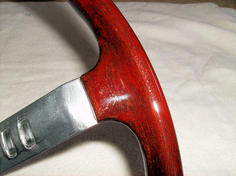

May 24, 20196 yr comment_576186 12 hours ago, bingo said: I think the "wood" on the steering wheel is actually a resin of sorts that looks like wood. I would be surprised if it accepted stain or other treatments made for wood. The rim is wood impregnated resin - it readily accepts stain. Link to comment https://www.classiczcars.com/forums/topic/62221-steering-wheel-restoration/?&page=2#findComment-576186 Share on other sites More sharing options...

May 24, 20196 yr comment_576188 22 minutes ago, Av8ferg said: What color stain did you use for that. I like the reddish tint. Sent from my iPhone using Tapatalk Red mahogany. Link to comment https://www.classiczcars.com/forums/topic/62221-steering-wheel-restoration/?&page=2#findComment-576188 Share on other sites More sharing options...
May 24, 20196 yr comment_576189 8 minutes ago, jfa.series1 said: Red mahogany. Did you apply polyurethane afterwards? Red Mahogany is the color I recently purchased but was afraid it would be too dark. Link to comment https://www.classiczcars.com/forums/topic/62221-steering-wheel-restoration/?&page=2#findComment-576189 Share on other sites More sharing options...

May 24, 20196 yr comment_576195 1 hour ago, Jaymanbikes said: Did you apply polyurethane afterwards? Red Mahogany is the color I recently purchased but was afraid it would be too dark. I applied multiple coats of lacquer that held up for about 5 years. Ultimately the oil from my hands caused a breakdown. Its time to redo it, will likely use poly. Link to comment https://www.classiczcars.com/forums/topic/62221-steering-wheel-restoration/?&page=2#findComment-576195 Share on other sites More sharing options...
