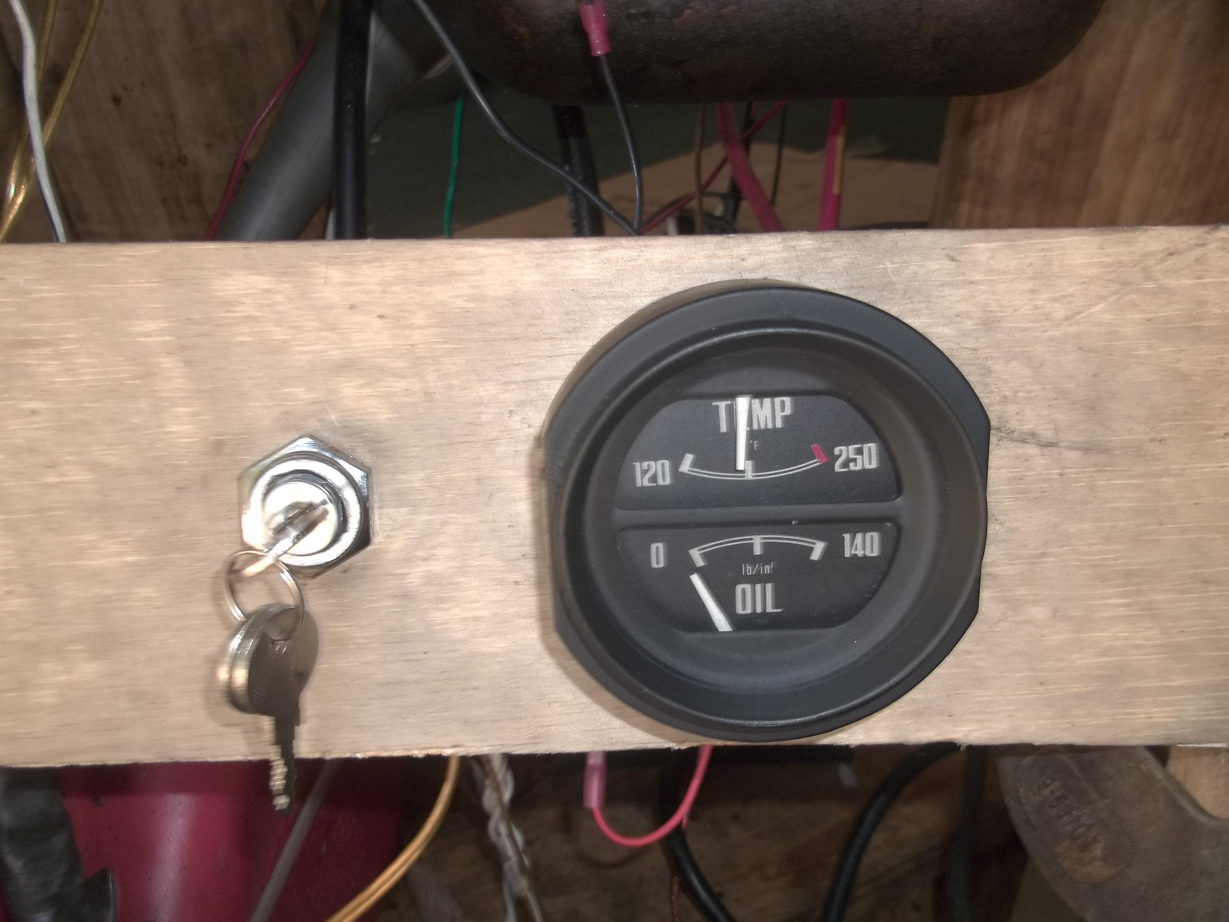

test completed, no gush, some gas, video to be posted later, but I wanted to show Jeff his gauge, I did not do a before shot, but it came out pretty nice. Must be earlier on, has the 140psi oil gauge
