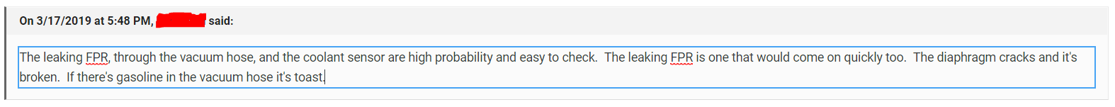

On 4/14/2019 at 4:15 PM, Zed Head said:
The checklists in this book will tell you a lot.  Good news on the FPR, although you do have an extra one now.  Weird that you know what I'm cooking for dinner...
Sorry, couldn't resist.  One last dig...
Edited by Zed Head
