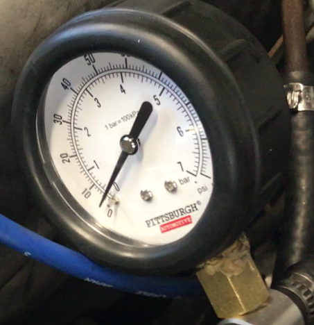

OK I did the Fuel Pump only to FPR test and got 42 psi with key on and 38 psi with key off. ( said 40 psi in the video but couldn't get a good reading until I saw the video).
To be sure I got the test set up and performed correctly.....
See video #1 for test results.
See video #2 for test set up & configuration.

Just for reference, most of us would connect up a gauge, get the pump running, and the needle would jump to 36 - 38 psi and just sit there.  Nice and steady, within seconds.
I get it..... I need to borrow a gauge from Manny, Moe & Jack and see what results I get with a different gauge.

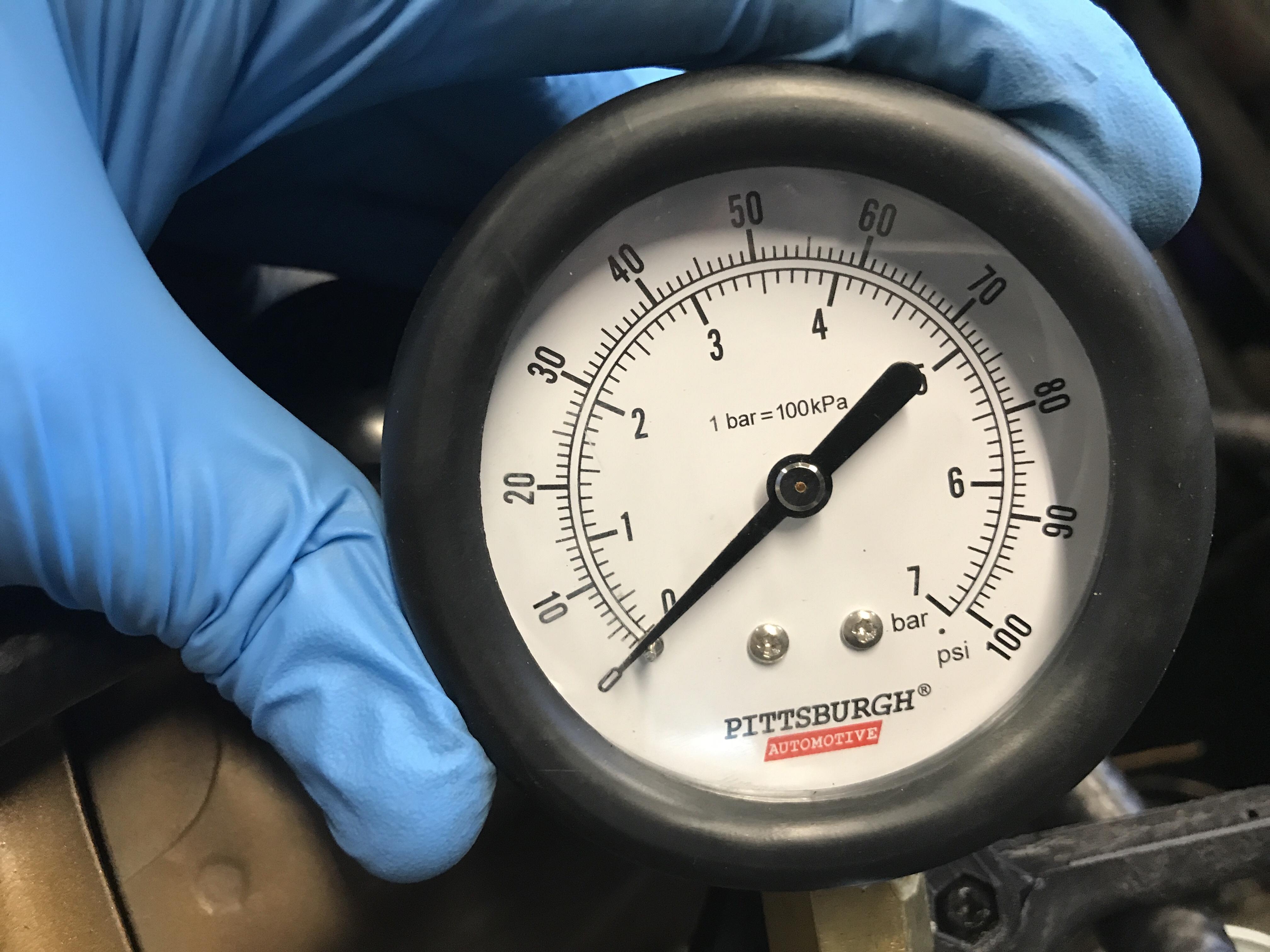

Your gauge has a 2-3 psi offset from the beginning.  Have you ever seen the needle on zero?
Yes it goes to zero, it's just the angle of the dangle in the photo that's making it look like it's starting at 2-3 psi.
The silver thing is the needle stop.  It's set at zero.
Zed for your edification, here's a head on, dead on shot of the gauge at zero.
I agree with Zed Head on the 2-3 psi, needle is not on zero. I would get a new gauge
Haha! mbz, Glad you posted that. Optical illusion.
