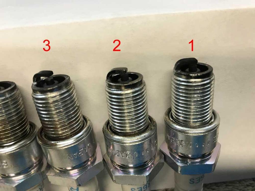

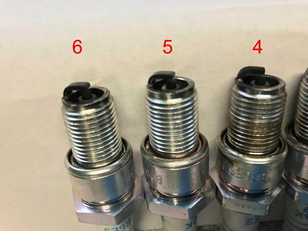

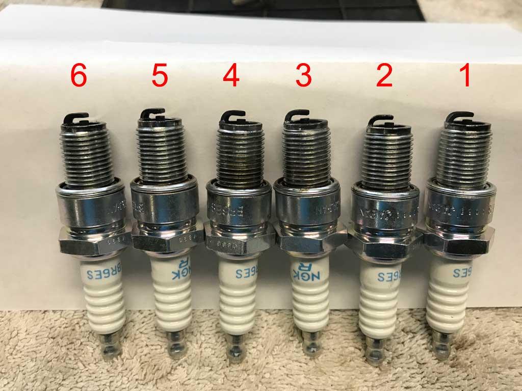

March 19, 20196 yr Author comment_571331 OK here are the photos of the new spark plugs. I have to get to work, so please review photos and let me know your questions and/or comments, I will review & respond later this evening. THANK YOU ALL! I APPRECIATE THE HELP & INPUT VERY MUCH! ? (ps: MadKaw - I did a quick visual inspection of the outside of the distributor cap and saw no cracks, will do a more thorough inspection when time allows). Link to comment https://www.classiczcars.com/forums/topic/61841-1976-280z-engine-runs-rough-then-dies-will-not-idle/?&page=4#findComment-571331 Share on other sites More sharing options...
March 19, 20196 yr comment_571338 if that was just a short time run, seems too rich. Those insulators should come out nearly white. I suspect an overly rich condition. I recommend the FPR test (pressure engine off, pressure eng on, gas leak from vacuum line, then the Temp Sensor Test, then the CSV (make sure its not leaking for firing, prob warm enough that it should not). Link to comment https://www.classiczcars.com/forums/topic/61841-1976-280z-engine-runs-rough-then-dies-will-not-idle/?&page=4#findComment-571338 Share on other sites More sharing options...
