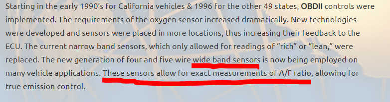

http://www.walkerproducts.com/o2-sensor-training-guide/history/
The so-called wide-band sensors aren't compatible with Arduino electronics.
If you buy one and send it to me, I might consider using it.
