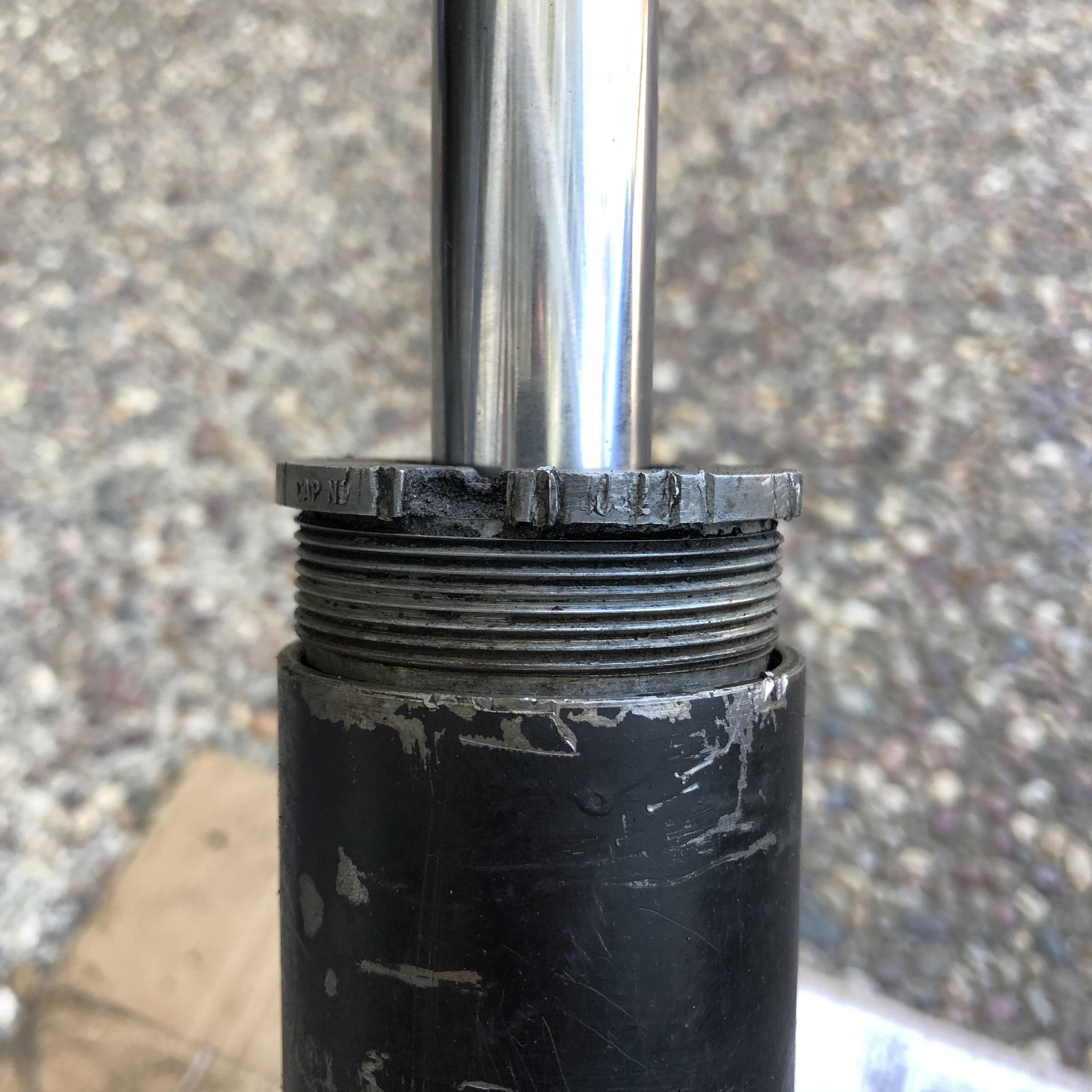

Thanks for the great clarity @KONI Lee. I got the Koni 8641 1031Sport yellow strut cartridges for my 240z (December 1970 production date). Installing the front passenger side now. Diameter is fine but they seem to sit a tad higher than the cartridges they are replacing (it's like there's an extra little shoulder) and I'm not able to get the strut gland nut to catch the threads inside the strut cartridge. Does anyone know if there is a trick I'm missing? Or, are different types of gland nuts that might account for this? I ask because the driver's side was also challenging but I did get the gland nut threaded on. However the glad nut seems like a slightly different design on the outside (it didn't occur to me to check the design of the the inside).
Thanks for any advice.

Hello @fyrst.z, like Zed said, the gland nuts definitely are specific to the struts, and you should use the Koni gland nuts. If you have one side of the front that threads and the other side that doesn't, that definitely could be, also as Zed said, decades of dirt and oil that create a "spacer" down there, so check that as well. The only other options would be non-matching strut cartridge heights, which will be fairly easy to check, or damaged/modified/mismatching strut housings. Struts, whether Tokico, KYB, Koni, are different heights, and they all have different gland nuts to go with them. You show an image of a strut installed with what looks like a KYB gland nut, we assume you are not using those gland nuts on the Koni's.
When you're certain there isn't a buildup to scrape out of the bottom of the housing tubes (it isn't easy, unfortunately), and if then using the Koni gland nuts you are not able to torque them down to a 4mm gap, regardless of side, just give our sales technicians a call at (800)633-6331 or (714)639-2620, or email if you prefer at info@motorsportauto.com, and we'll get things figured out.

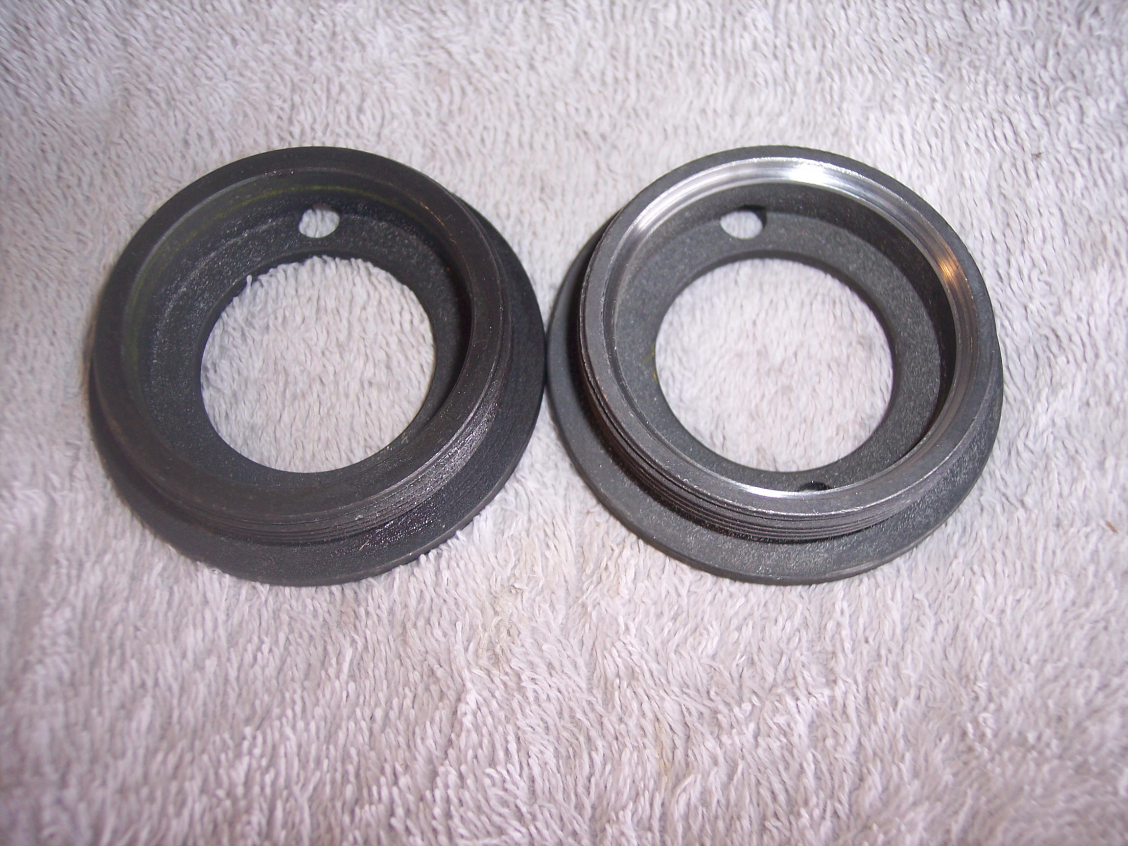

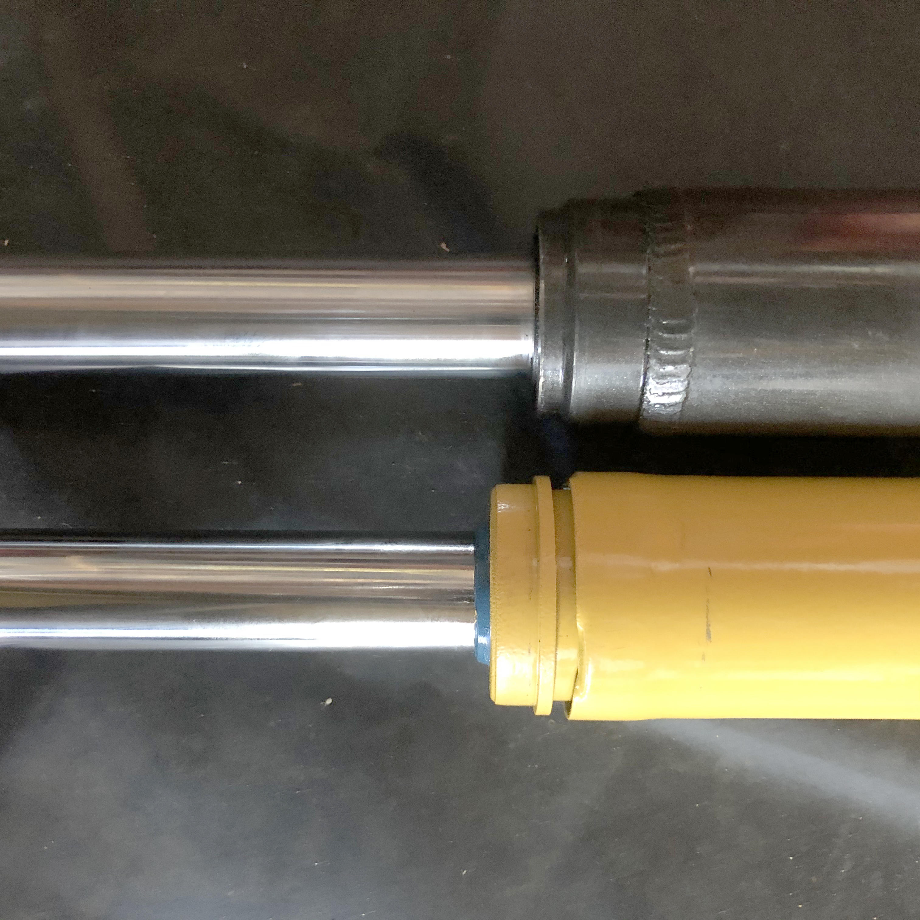

A very big thanks for outstanding customer service from MSA and KONI! Like a few others, I could not get the gland nut to adequately thread into place because the shock was not seating properly. My struts are squeaky clean inside with no foreign debris. As recommended above, I contacted MSA about the issue. @Joseph@TheZStore quickly responded and identified a Nissan mfg. anomaly where the bottom cap on the strut has an internal shoulder. Chipped paint on the bottom of the new KONI shock confirmed the interference. MSA had modified gland nuts on hand for this problem and sent a pair to me at no cost. Note the machined internal relief shoulder on the gland nut on the right vs. stock on the left. The relief allowed the gland nut threads to fully engage and get the gap well under 4mm.  One front strut down this morning, one to go for tomorrow and then on to the rears.

After I swabbed out the oil I could see the shoulder with a flashlight and feel it with a long tool. No fiber optic tool so no pics. Now its all back together and on to the other side. Might or might not find the same situation.
