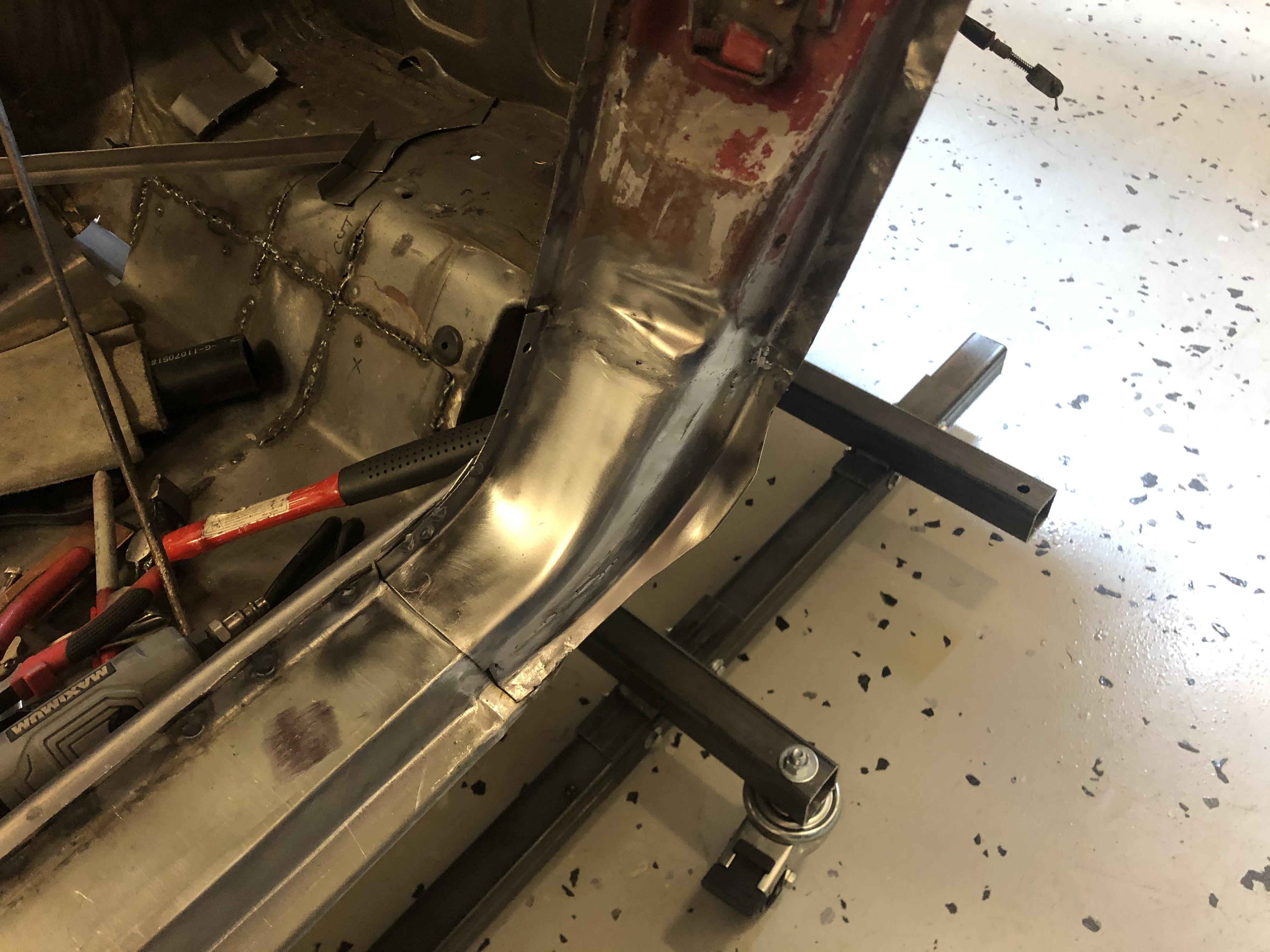

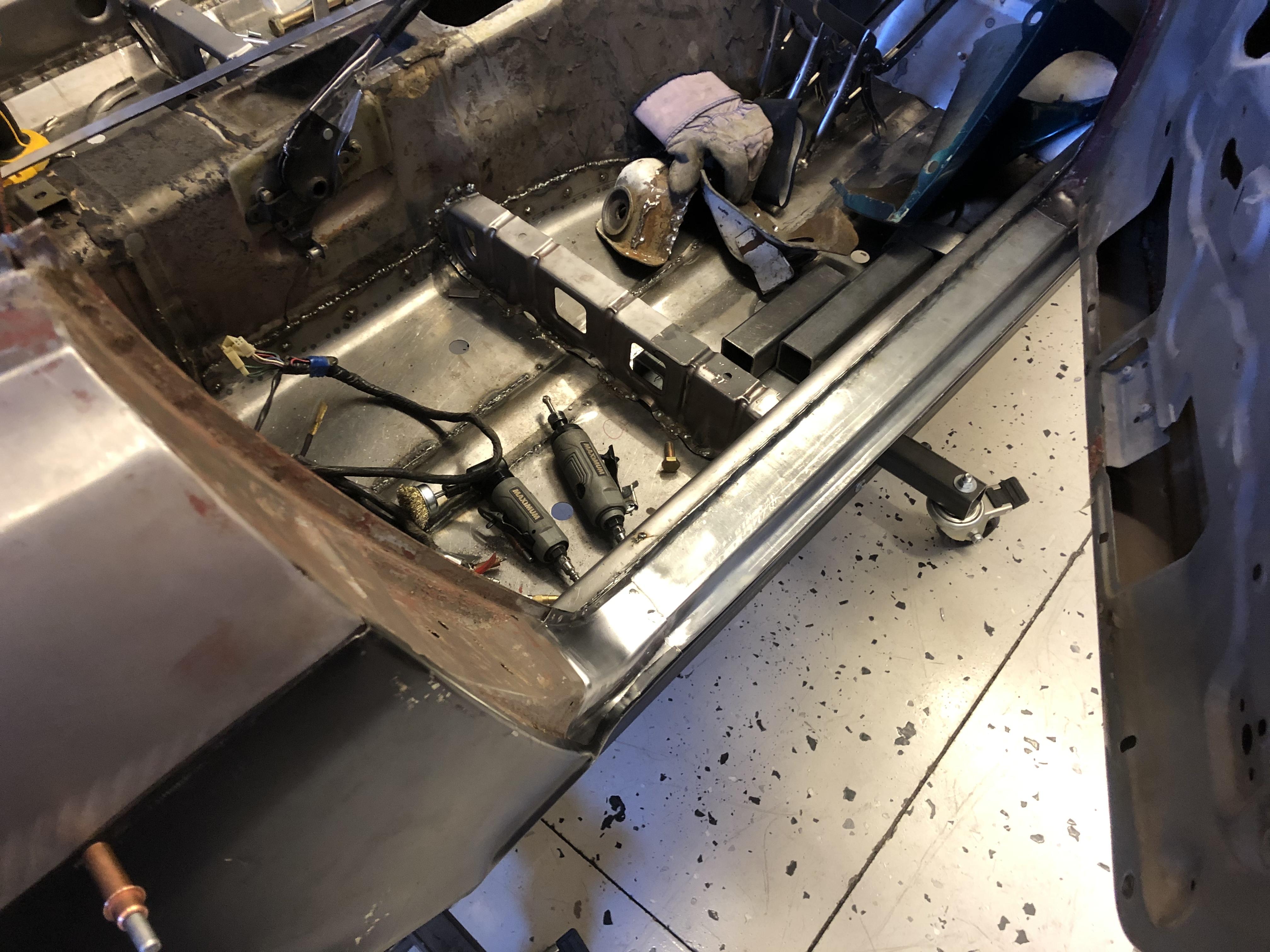

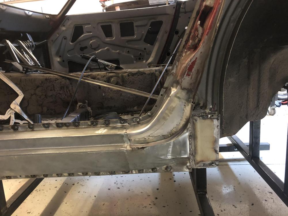

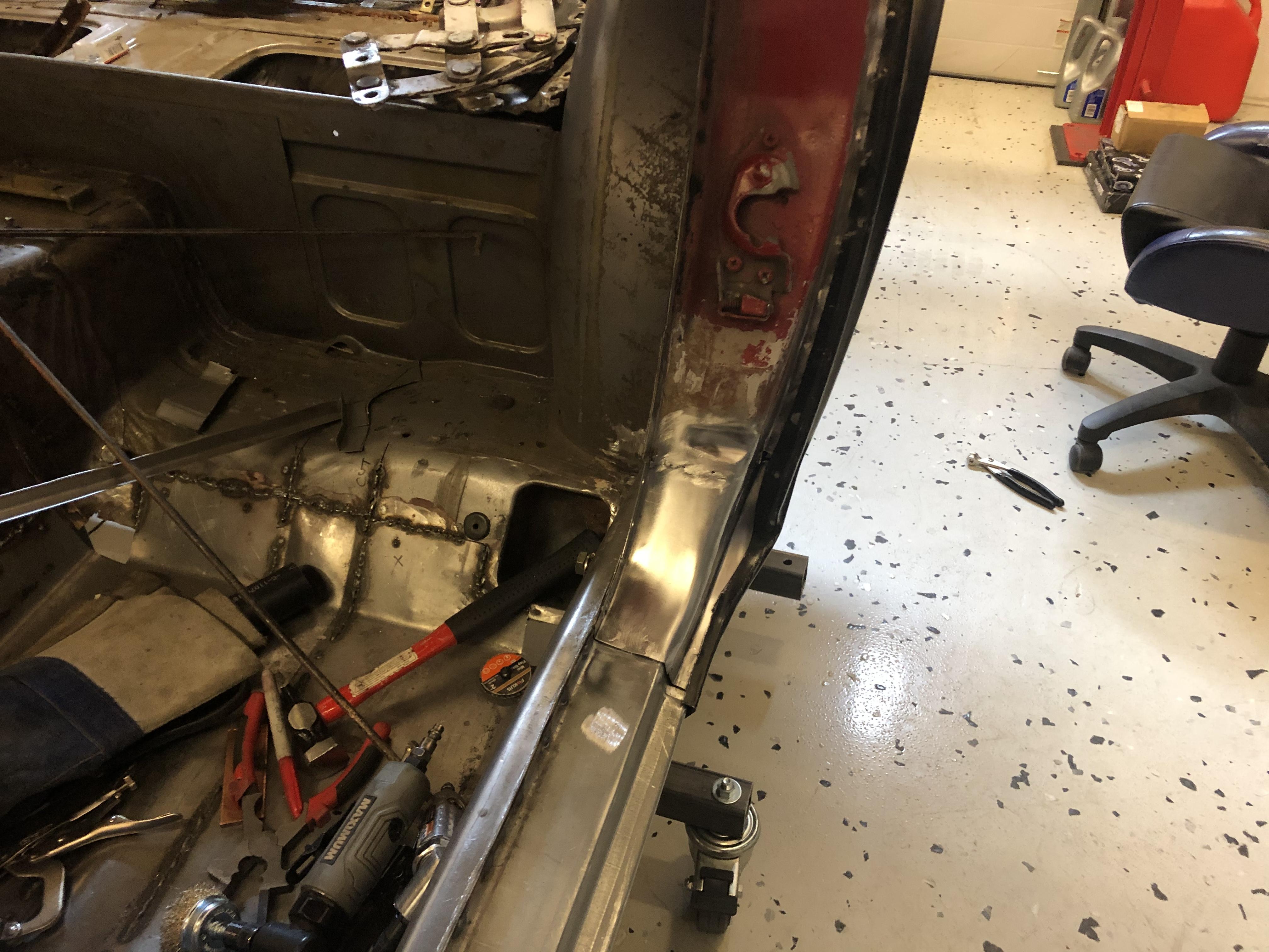

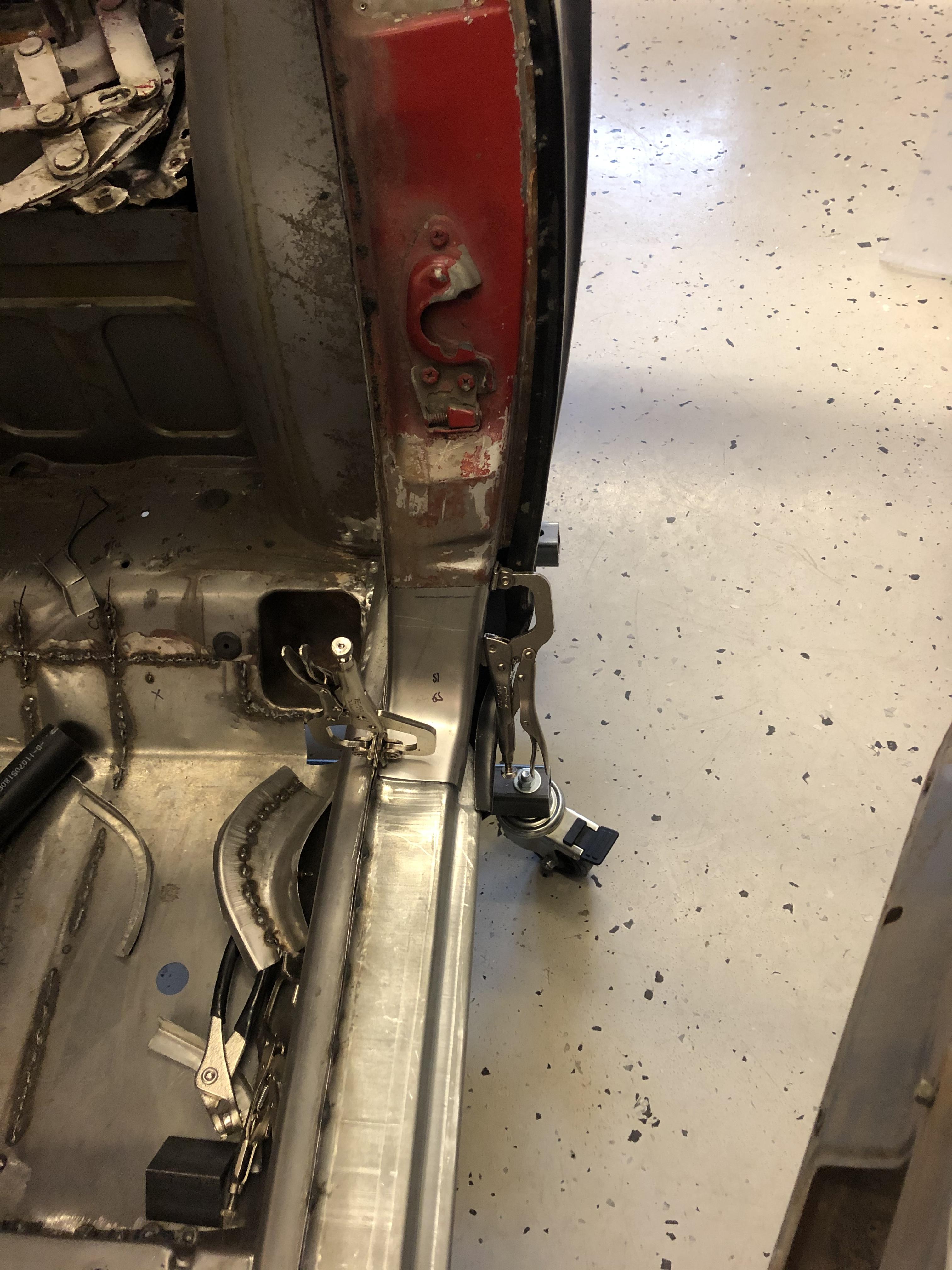

Man ... this took a lot longer than it should have ...
for @wheee! - failed attempt laying on the floor pan ?
Just about there....Sorry I didn't take more pics.
The process is pretty straight forward - basically measure, bend, shrink, shrink, shrink, stretch, stretch, stretch, test fit, ???, stretch, stretch, shrink, test fit, more ???and so on till ???
Still have to work the PS tomorrow ...

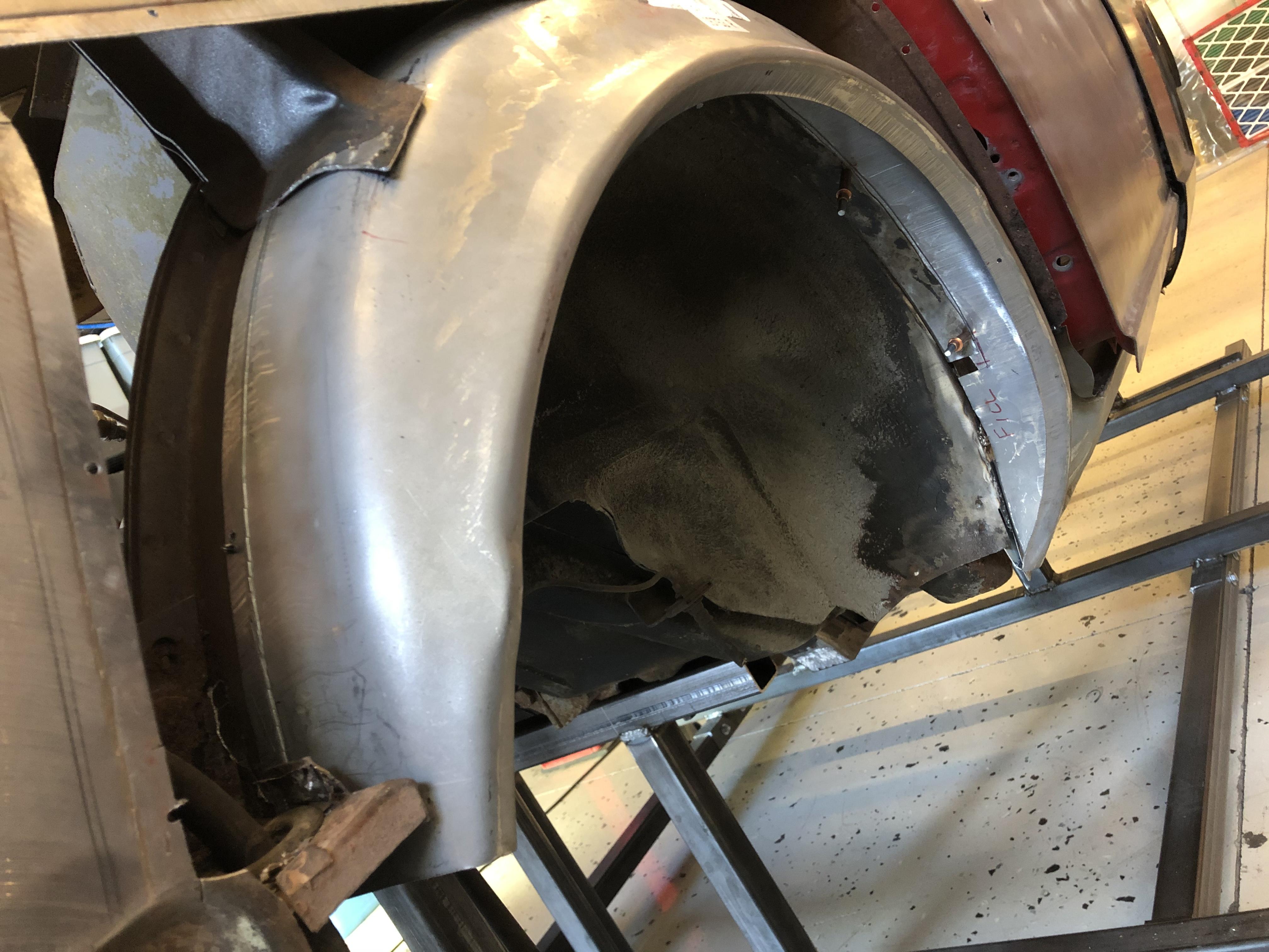

So now that the dog legs are fixed, I can final fit the rear quarters and the wheel house repair panels.   The plan is to fit them and Cleco them in place and then weld and panel bond them in place when the car is on the rotisserie.  It's tricky because the quarter panel and the door edge and the wheel house all need to line up perfectly...

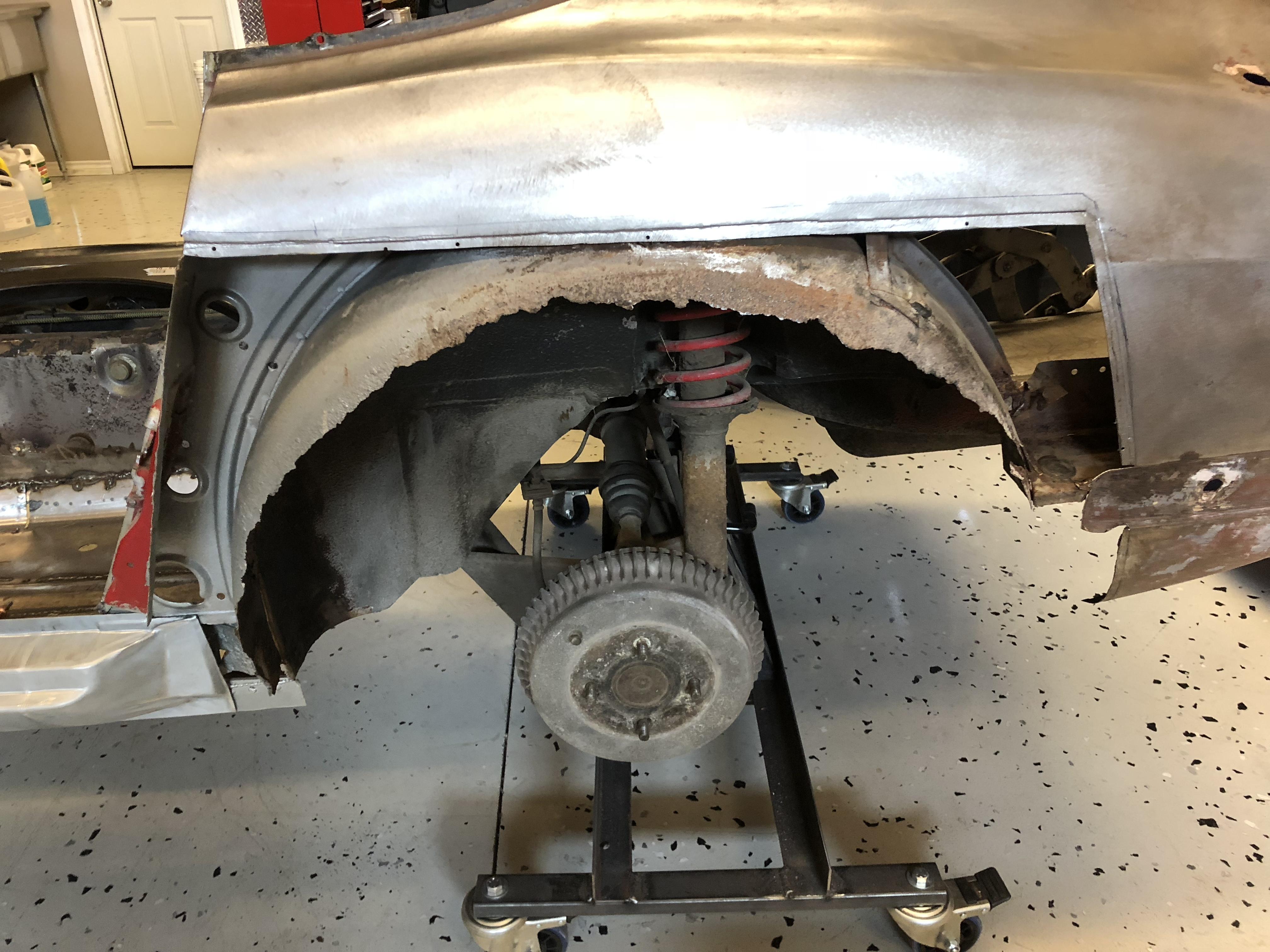

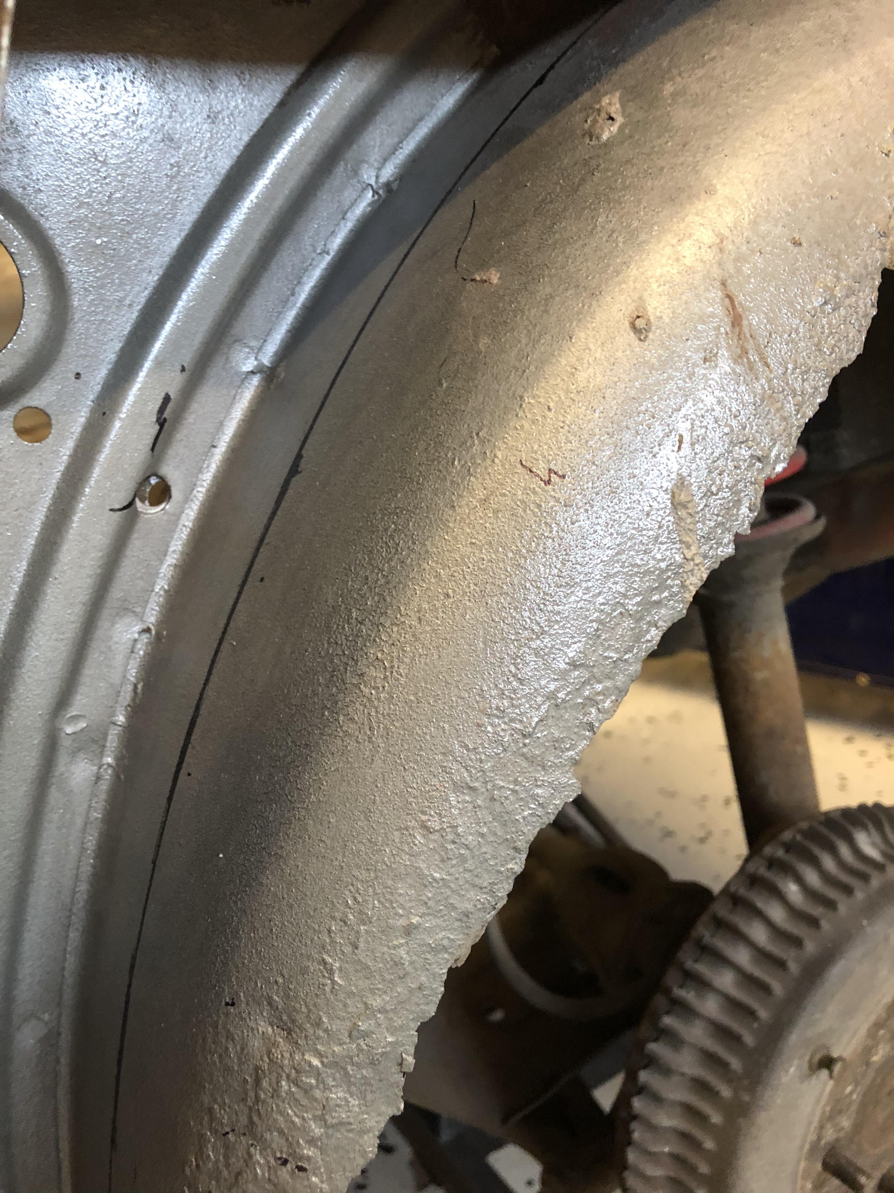

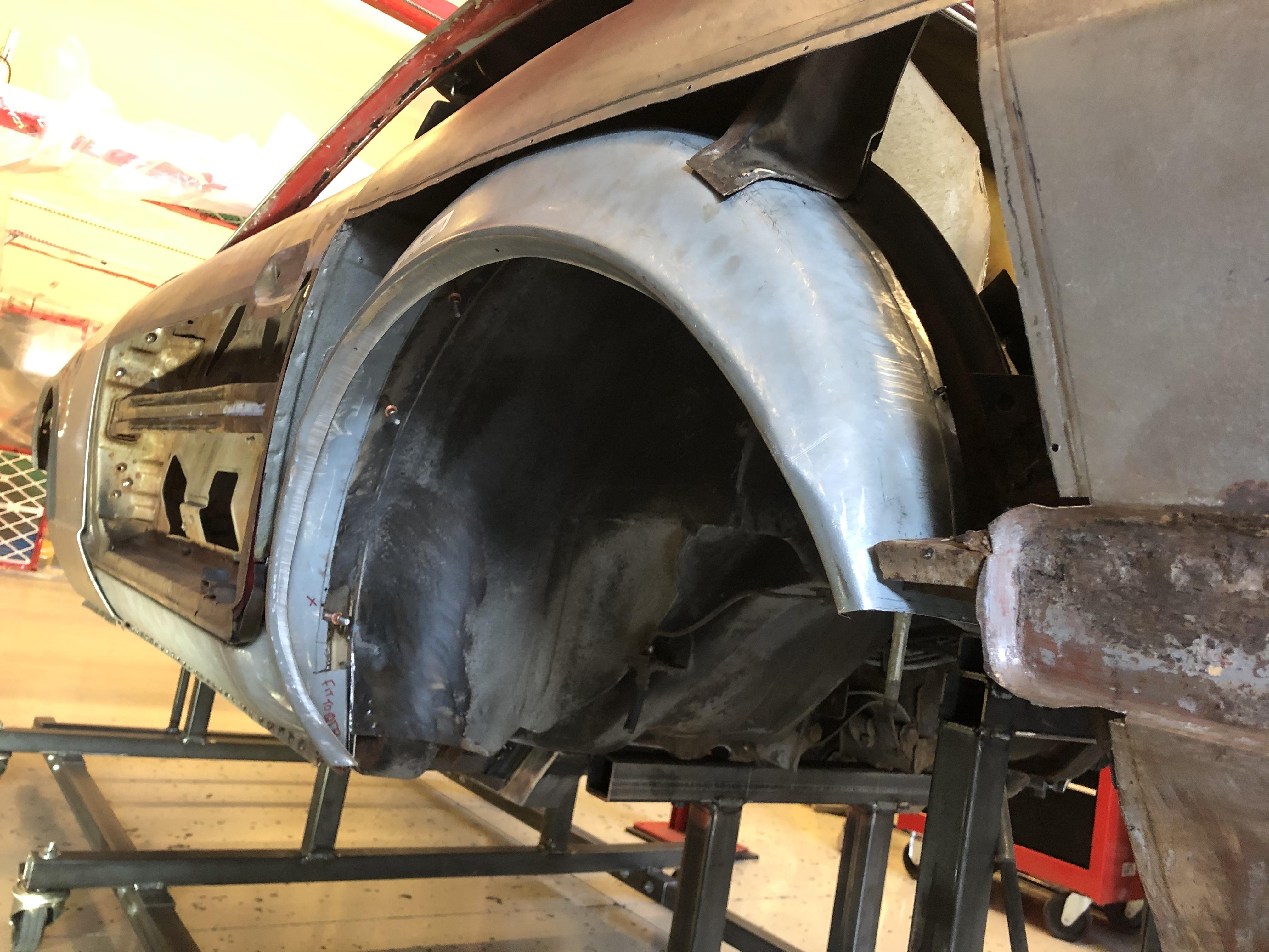

First, the wheel house ....
before...pretty rotted ...

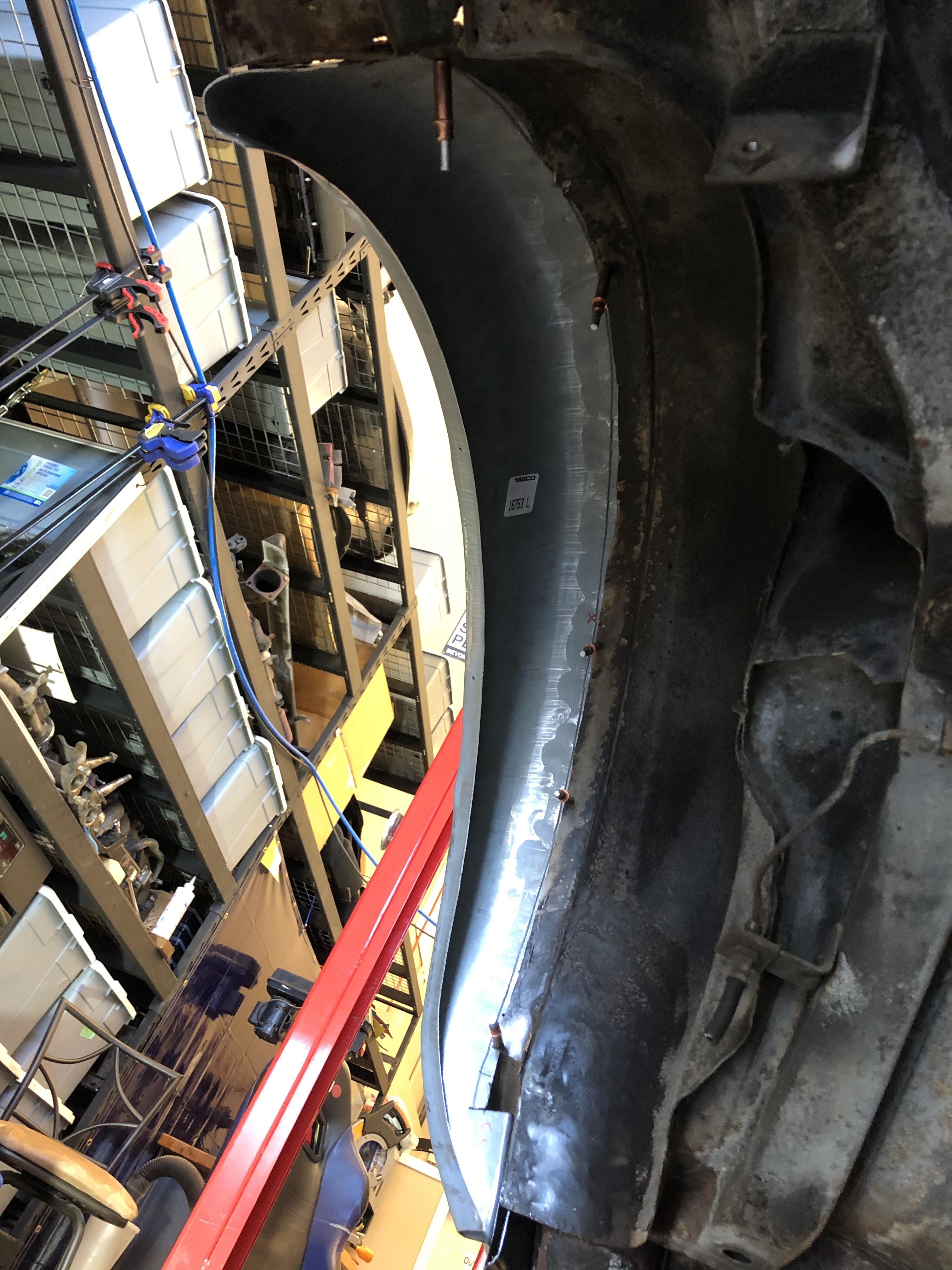

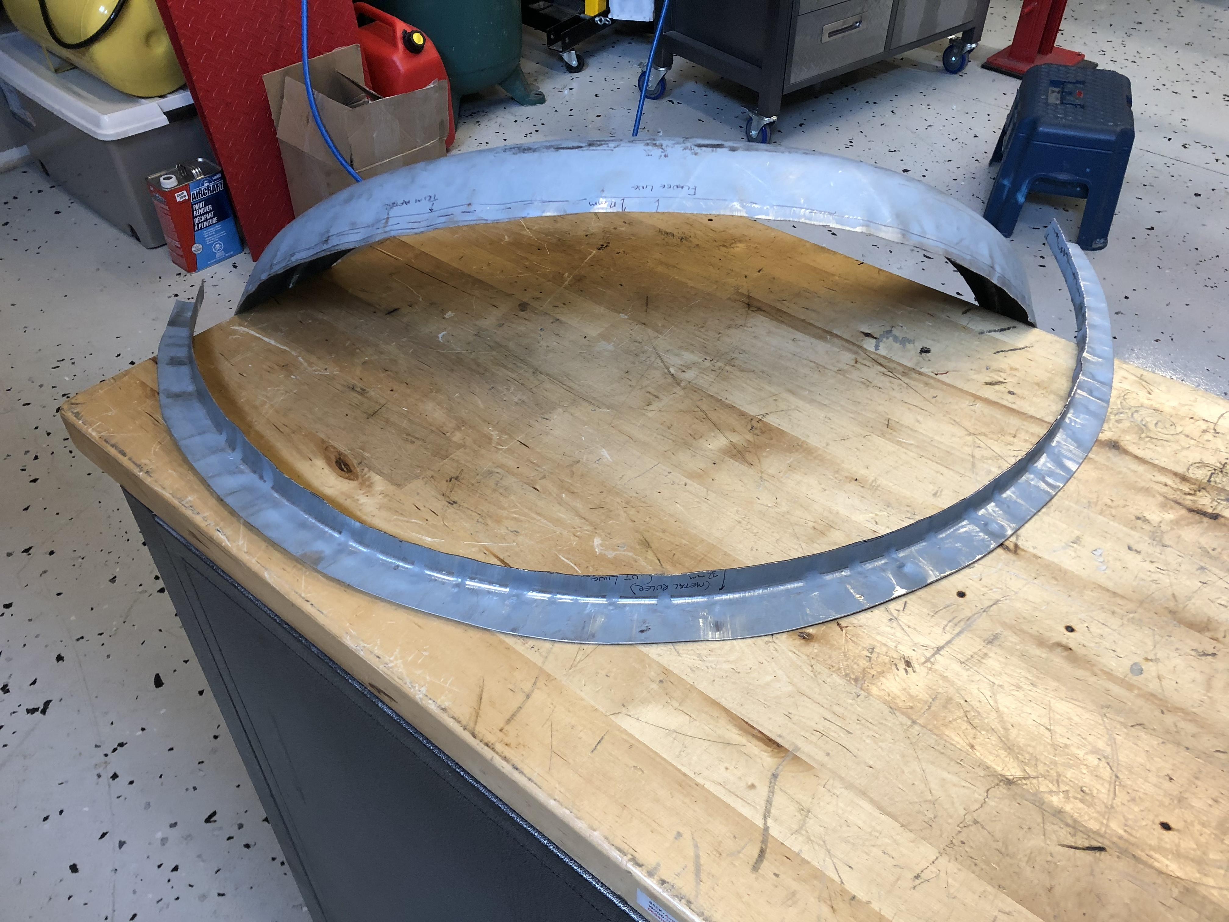

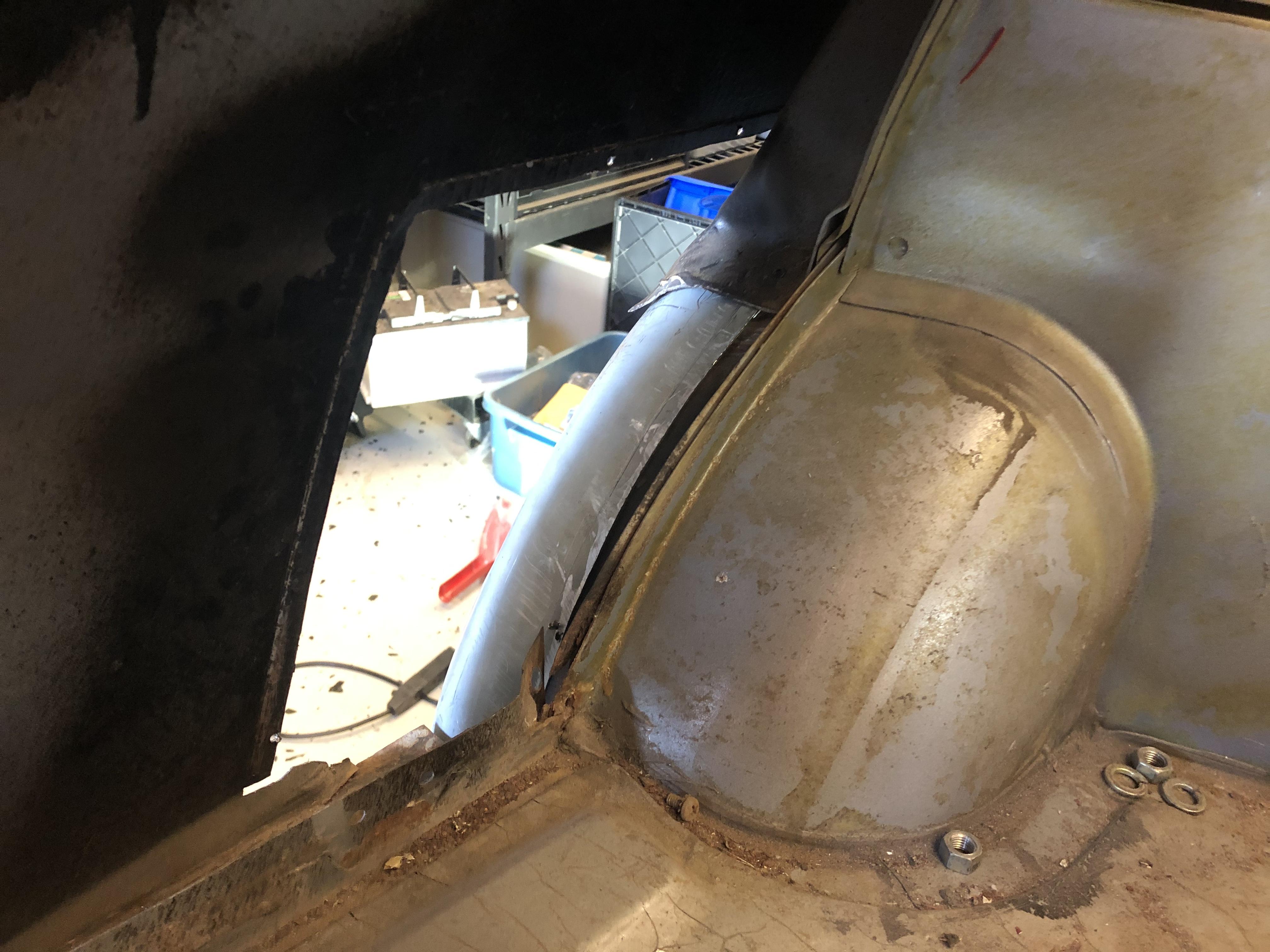

I decided it would be simple to cut back to good metal and section in the new wheel house.  Cut line (one metal ruler width from the flange)...
Same width cut on the new wheel house patch ...

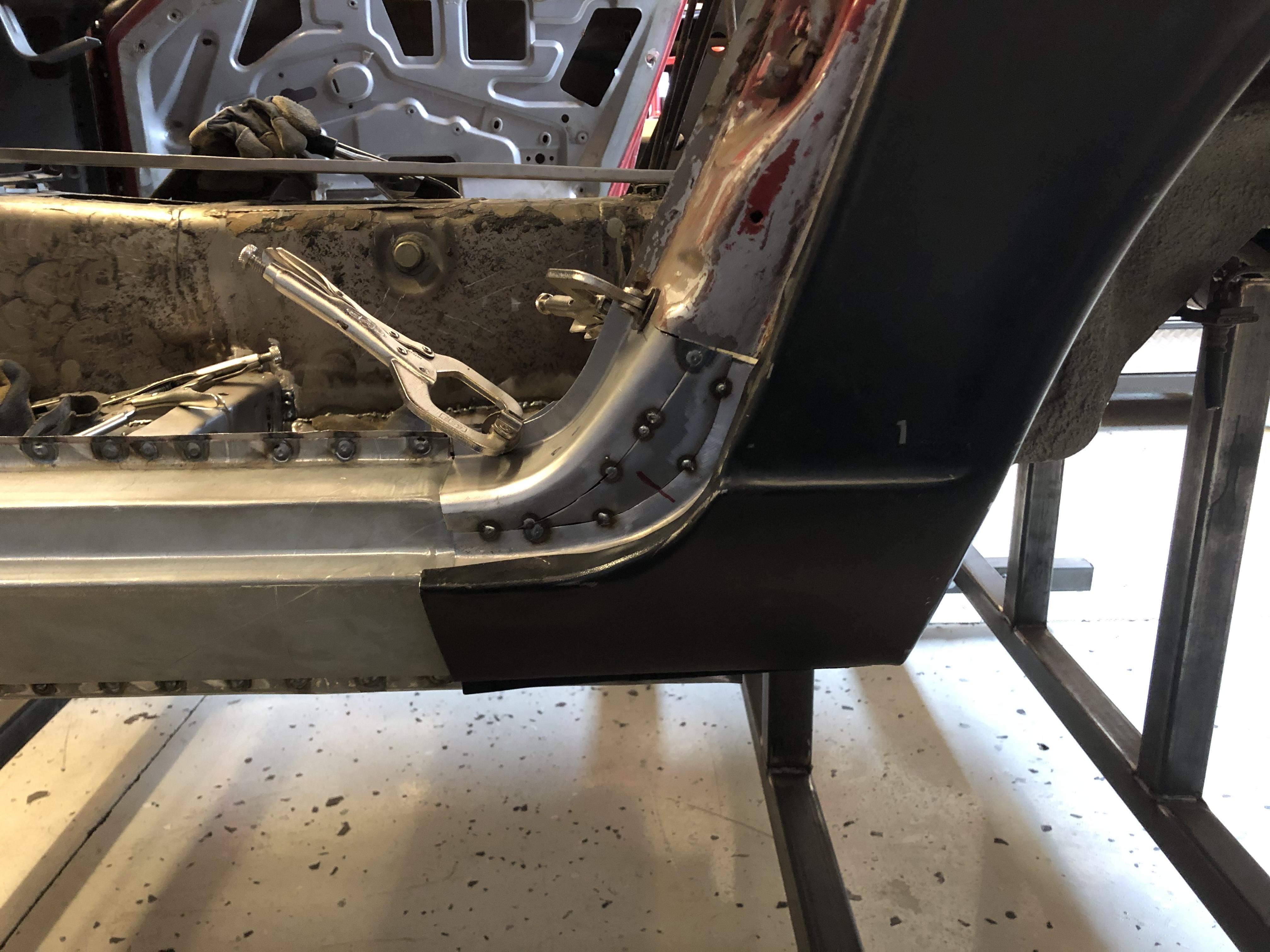

I put a flange on the new sections and Cleco'd them in.  They will get lap welded in place once the car is on the rotisserie....
Edited by ConVerTT

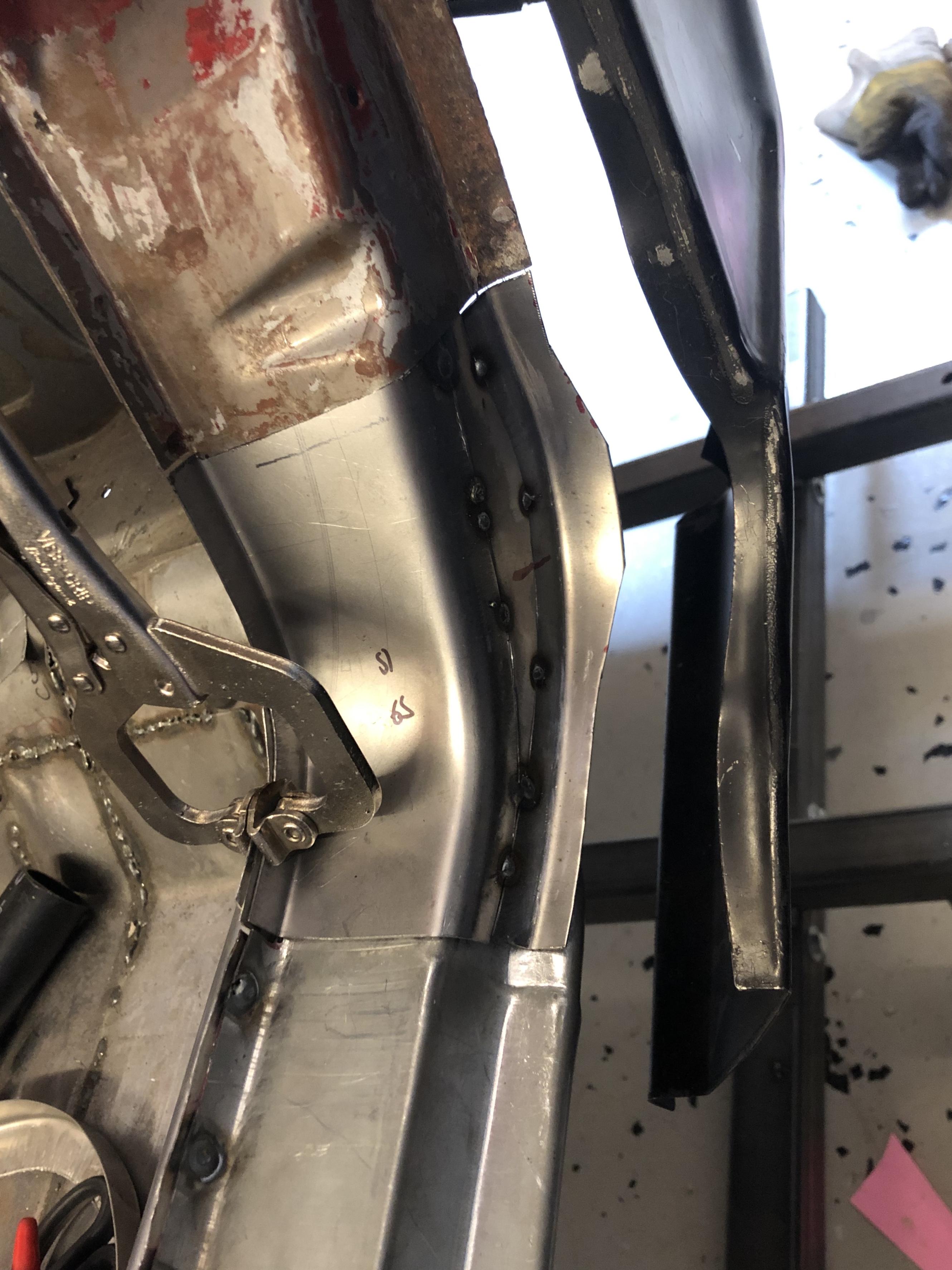

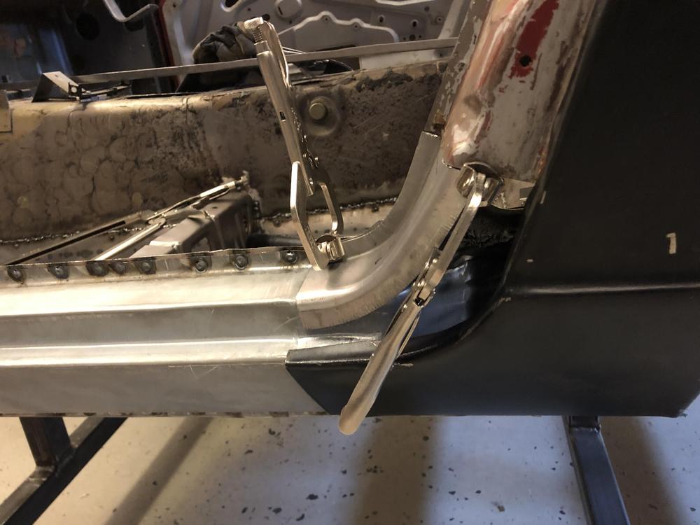

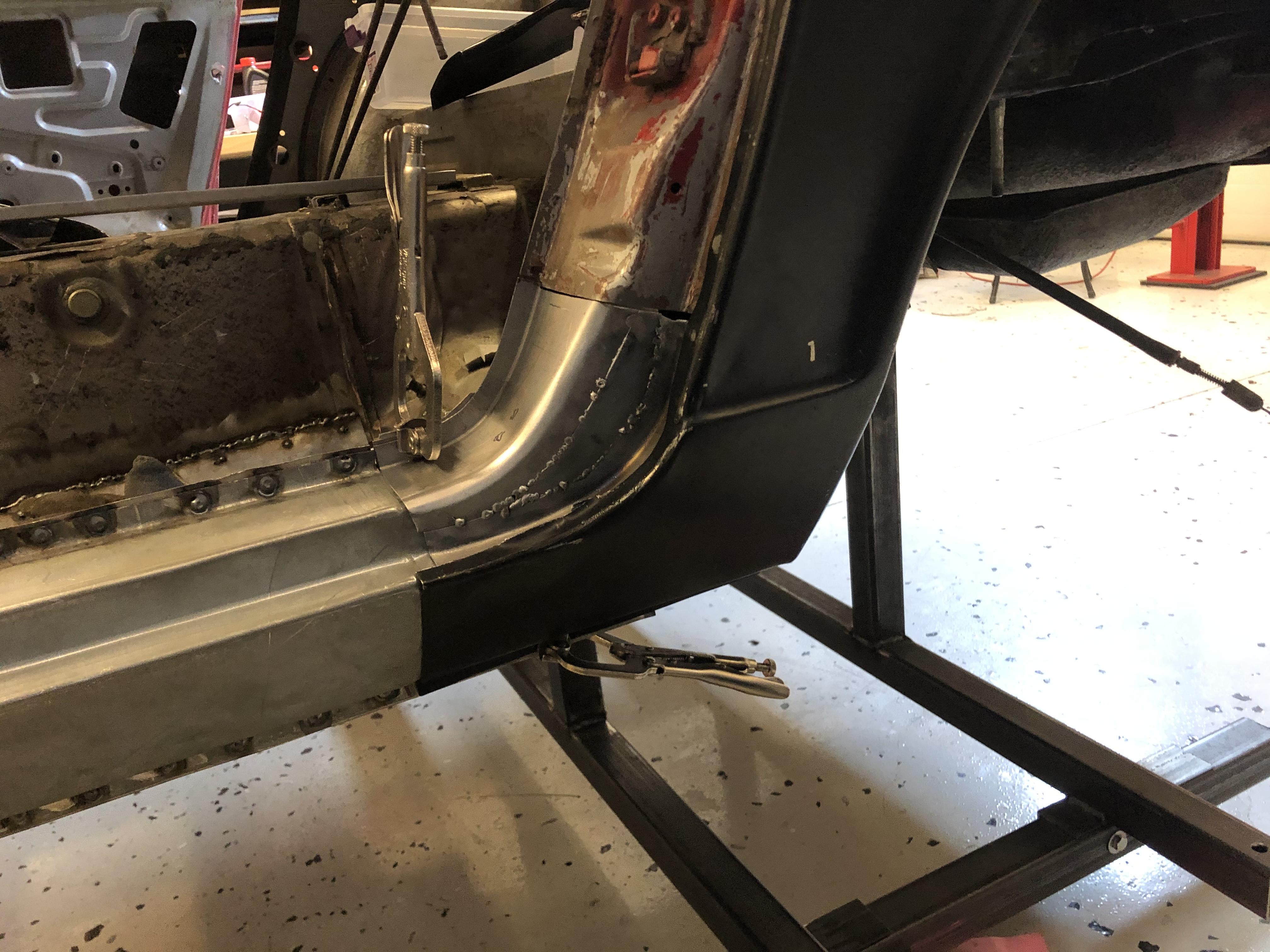

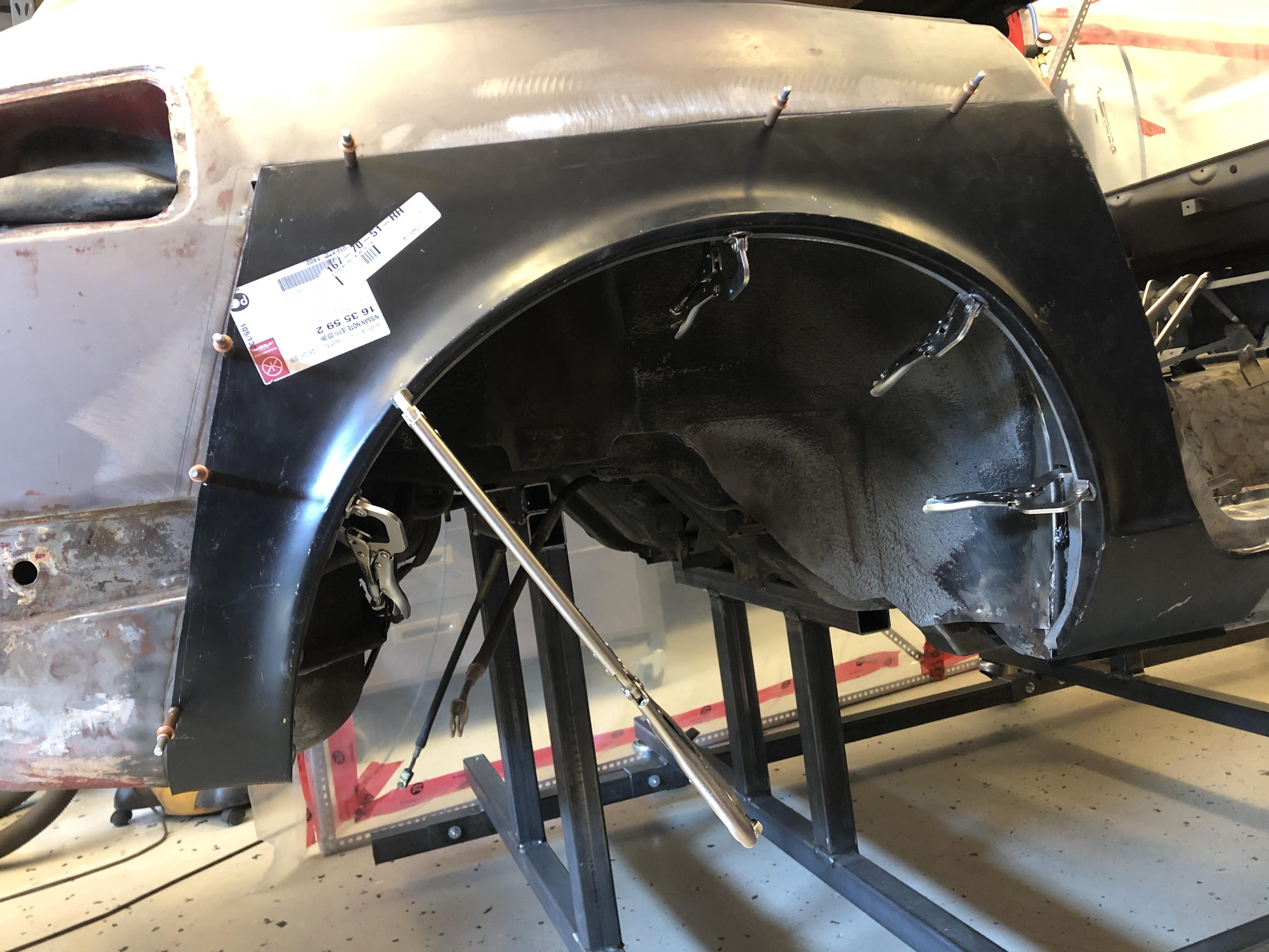

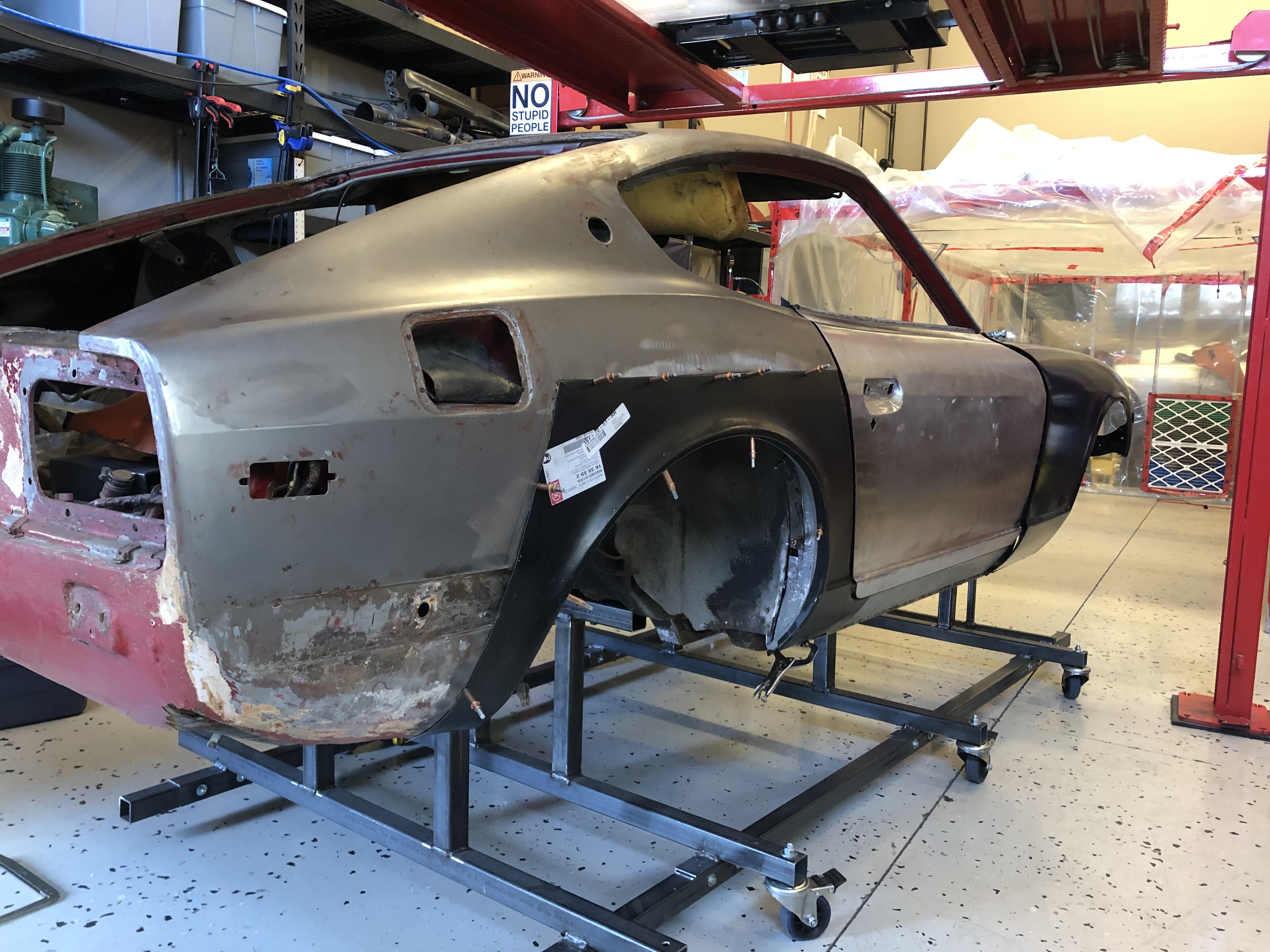

Lined up and clamped the rear quarter panels in place ...
and then replaced each clamp with a Cleco ...
Then same drill on the driver's side ...
It's starting to feel like working on an actual car ...???

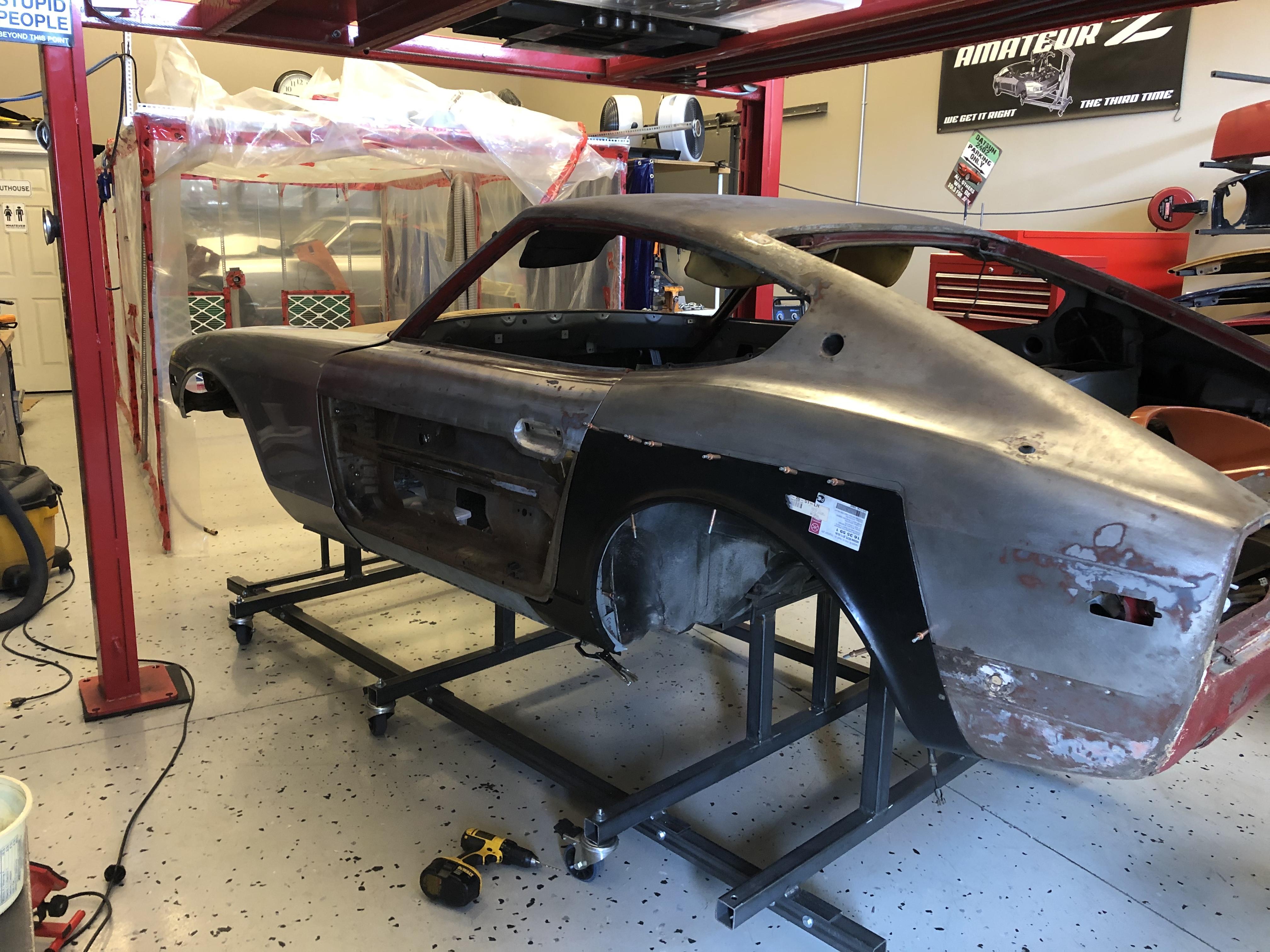

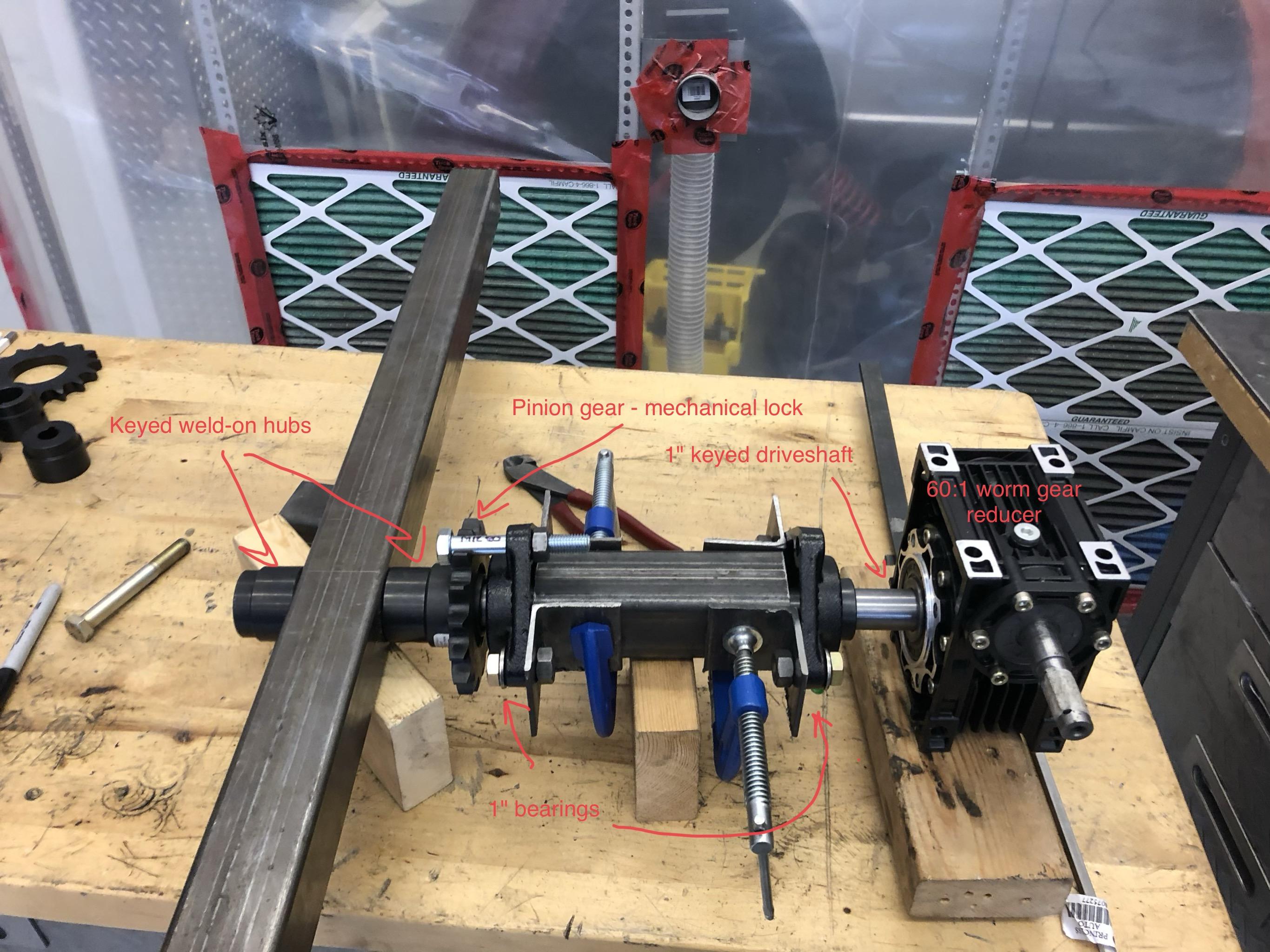

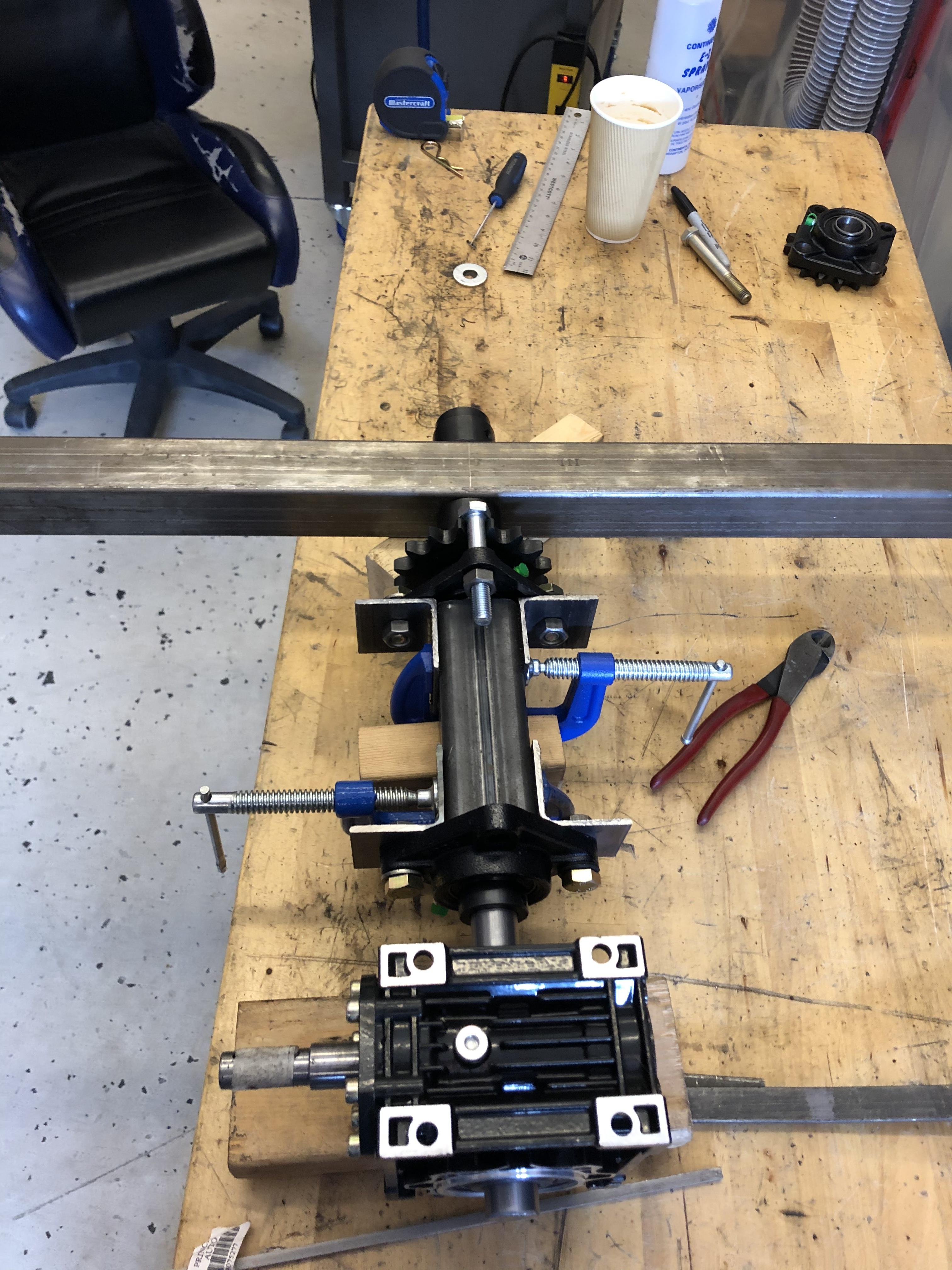

So I am pretty disappointed with the US Car Tool design...the rotating head is "inelegant" let's just say, and the mechanical locking mechanism comes with built in finger pincher/skin rippers IMO...

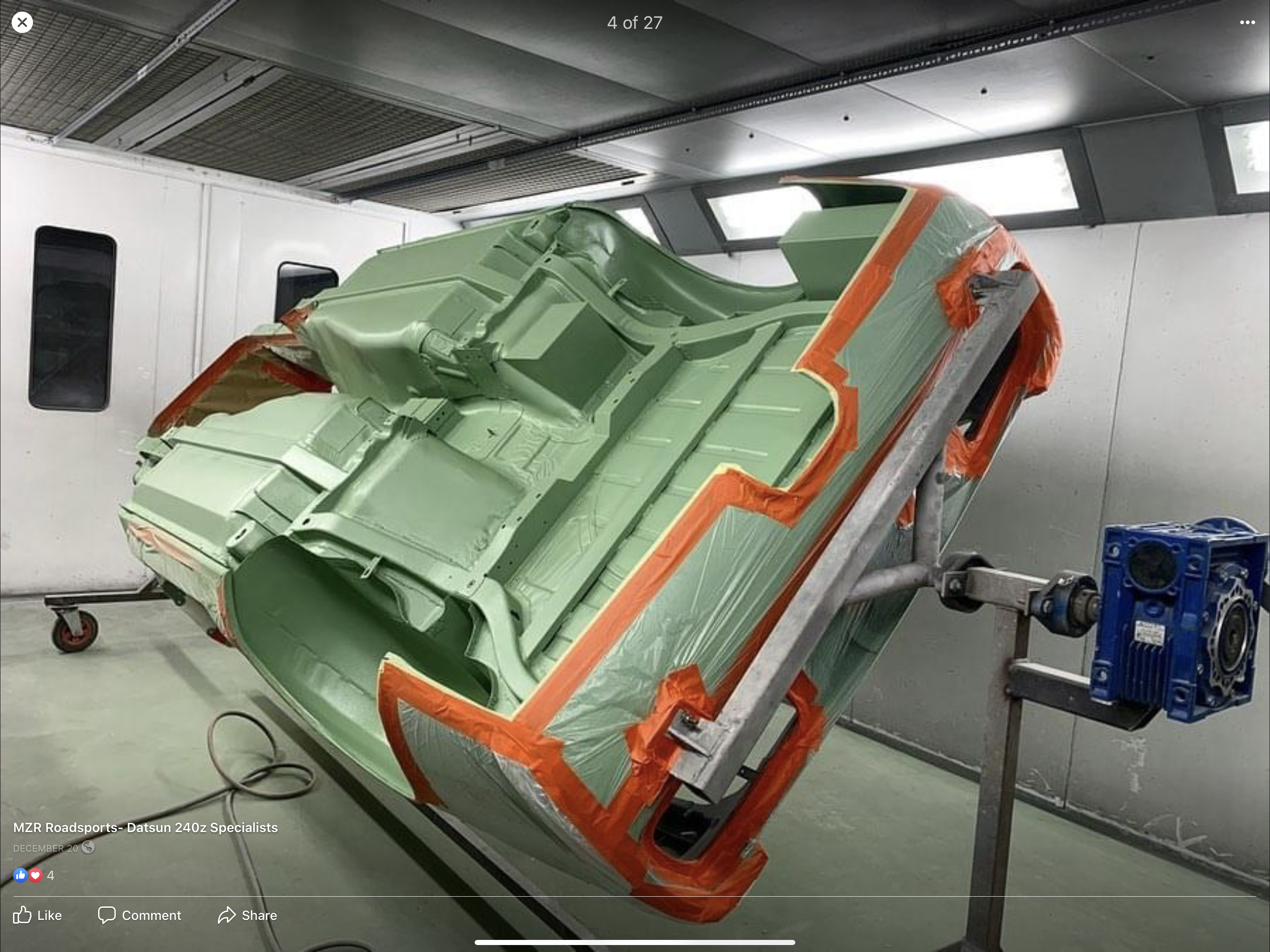

So, since I am a DIY kind of guy, I started looking for better alternatives.  I saw this one on MZR Motorsports FB page and thought "Hmmm... Yes!"

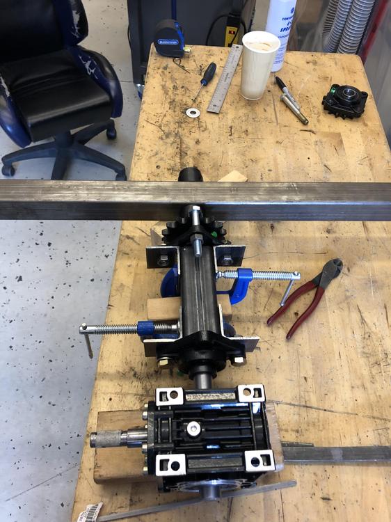

Soo .. off to Princess Auto and the hardware store ....
And a few hours later I think I have a working prototype of the rotator head...
It based on a 1" drive shaft with a 1/4" key.  Very standard stuff, so adding "options' is literally just like building with Lego.  The worm gear should hold the car in position, but I have added a simple mechanical lock (basically a pinion gear and bolt) for added security.   Also I do prefer that the hubs are welded to the rotator arm and so the driveshaft goes right through the arm (as opposed to being just welded to the arm - again extra safety factor).
Unfortunately - no time to weld until Monday so this is just a mock up / teaser for now ....?
