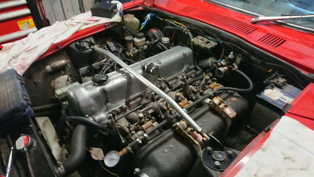

I have a couple of these between my linkage and the valve cover to ensure it all closes.

That's the sort of spring. But you don't have to use it like that.
Here's how mine is setup with 2 of those springs. You can see them on the linkage by the filter on the cam cover.
