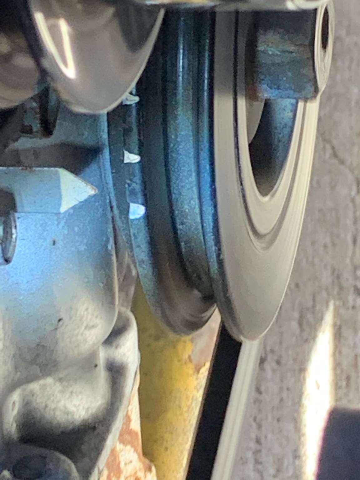

Cans someone tell me if the first mark is 0 or 10? There are 5 white marks in total and a smaller mark between each of those totaling nine marks. I’m assuming first white is 0.
And the next one might be 5.  From 1972...

That would be unusual, to have a damper marked to 40 degrees.  20 is more common.  Seems more likely that the small marks are 2.5.  Maybe 7too can measure between his marks.  Diameters should be the same so a measurement should correlate.

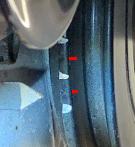

 @Zed Head I believe the white marks on his dampener are 10 degrees apart. In his pic the bottom white mark is TDC. Moving up, the next mark is 5 degrees and is not white. Moving up, the next mark is 10 degrees and is white, etc. The top white mark is 20 degrees.
Never mind.  I don't know.  Measuring and comparing to 7tooZ's would help.  Can't tell if the small marks are small or just not white.

 [mention=19298]Zed Head[/mention] I believe the white marks on his dampener are 10 degrees apart. In his pic the bottom white mark is TDC. Moving up, the next mark is 5 degrees and is not white. Moving up, the next mark is 10 degrees and is white, etc. The top white mark is 20 degrees.
I agree. Just needed a confirmation.
