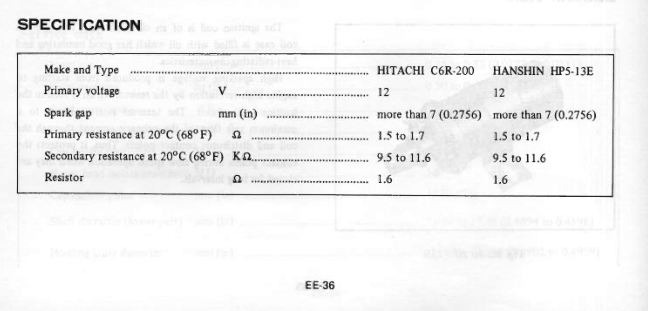

I'm going to guess that your new coil is different than the old coil.  Can you give specs on the two, take a picture, and/or measure resistance across the primary circuit?  Might be a clue there.

Right, the Tach in the earlies is "current sensing" so the wiring path to the ballast and coil is very specific and it requires a coil with the same value as stock.  There are two B/W - one that goes to the ballast and one that goes to the coil.  Be sure to reference the full circuit diagram because there are simplified diagrams in the BE and EE sections that don't show all the wiring involved in the ignition and Tach circuit...
Just a follow-on to cgsheen's post - the ballast resistor is in play while the engine is running.  So if you had the ballast wiring wrong, bypassing the ballast like the Start circuit does, you might get too much current through the tach.  You can get the diagrams and/or you can see which post on the ballast has power with the key on, then measure resistance from it to the negative post.  Resistance should be the ballast plus the coil.  Or it might be that you used a "Blaster" or some other low resistance coil.  72 uses a pretty high resistance for the coil.  Or you used a 3 ohm coil and don't have enough current through the tach circuit.  Many possibilities.

Tach worked fine on new coil for months.  Re-installed OEM type coil and no difference.  Neither coil had any internal resistance and requires the ballast resistor.  I can provide resistance measurements across the primary winding.
Might be that the tach (edit - wrote coil before) was damaged by too much current.  Good resistance measurements might tell something.  Only superconductors have no resistance and they require liquid nitrogen and/or helium.
