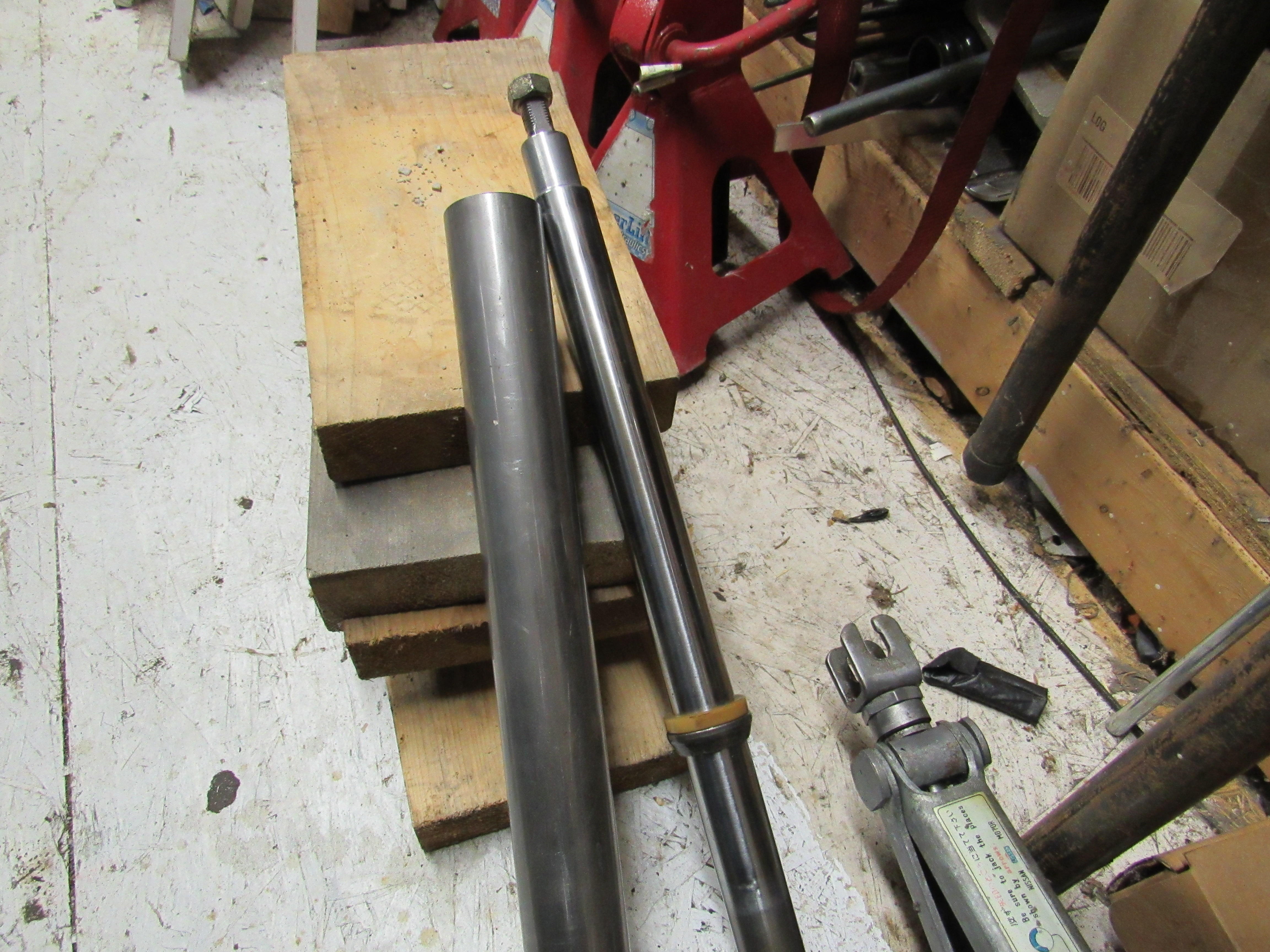

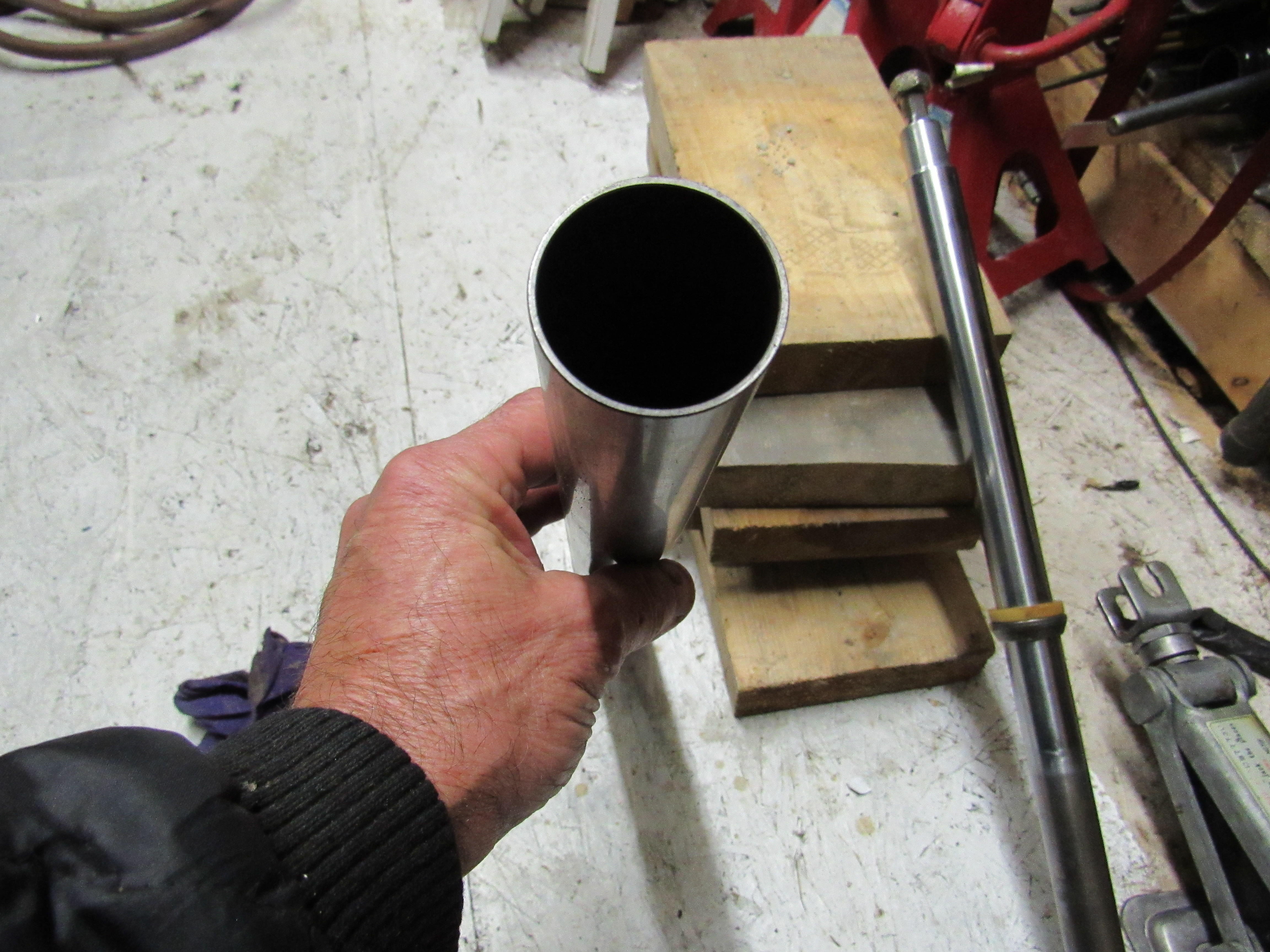

That shouldn't be the case, maybe that rust on the inner walls is causing it or the outer tube of the original shock was rusted in and didn't come out. You can see from this pic of shock from a 77 280z the outer shell is very thin, just noticed that lip inside of your strut tube and thought that might be a possibility.

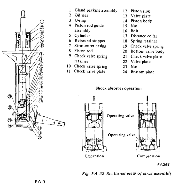

wait so on the OEM design, the internal strut is in 2 parts?, The tube that you are holding is an internal tube that the piston sits inside, then that hole assembly is placed inside the strut tube? I believe that lip is infact stuck inside.
