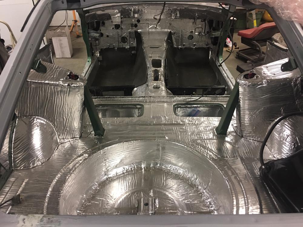

I am interested in seeing how some of you guys who have installed Dynamat or similar materials in your 240Z did it.  I am particularly interested in the rear of the cabin.  Did you stop at the edge of the 2 compartments or did you install it over the doors?    Pics would be most appreciated.  Thanks!

I will have carpet over the entire back end but I lined the inside of the cubbies.
I did scroll back through your build thread and saw this pic.  Wow; how many ft of mat did you use?  You audio acoustics should be fantastic!
So far about 36 sq ft. I still have the doors and hatch to do.
