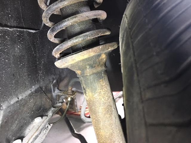

August 17, 20186 yr Author comment_555506 I guess I understand what your saying but as of now the car doesn't roll because the tire is against the spring plate and I've actually tries loosening all the bolts and tightening with the control arm jacked up to see if that helped. Â I have to think this is something stupid. Â Maybe there are some key measurements I can take to see if something is bent? Â anyone have pictures of their 2 sides, maybe that will provide inspiration. Link to comment https://www.classiczcars.com/forums/topic/60602-front-suspension-and-tire-clearance-problem/?&page=2#findComment-555506 Share on other sites More sharing options...
August 17, 20186 yr Author comment_555507 So doesn't it look like the spring on the side that is touching is indexed wrong?  Looking at the "good" side the coils follow the angle of travel but it looks like on the side that rubbing that the coils are spun 90 degrees.  I guess I'll check and see if thats even possible but something is weird with that assembly. Link to comment https://www.classiczcars.com/forums/topic/60602-front-suspension-and-tire-clearance-problem/?&page=2#findComment-555507 Share on other sites More sharing options...

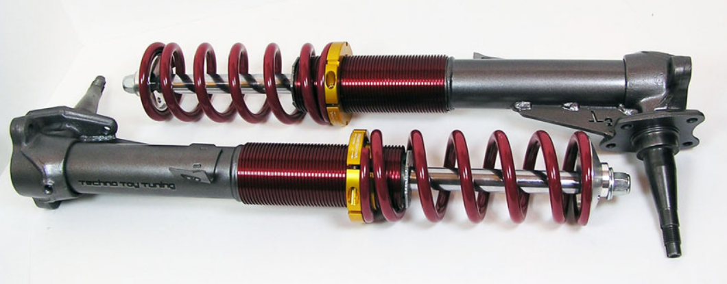

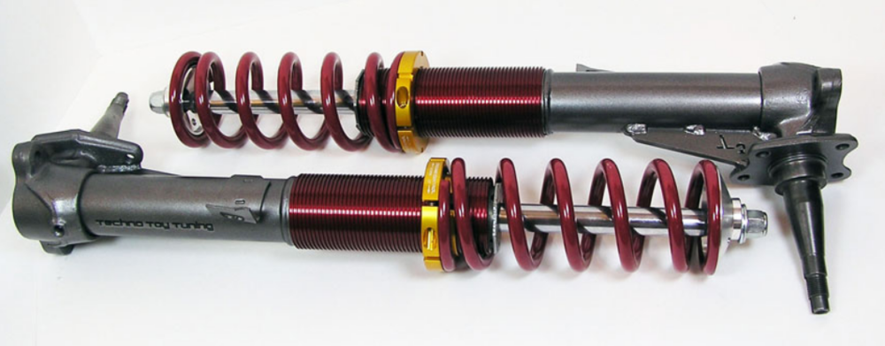

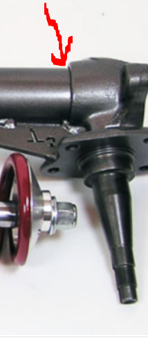

August 17, 20186 yr comment_555537 The spindle that the bearings and wheel sit on are welded to the tube. At this point I think that you're looking for the cause of the damage. Here is an interesting picture from T3 showing the structure, but with a reinforcing gusset added. Maybe they know something. The only other possibility, it seems, is deep seated bearings. https://technotoytuning.com/nissan/240z/front-coilover-conversion-datsun-240z Link to comment https://www.classiczcars.com/forums/topic/60602-front-suspension-and-tire-clearance-problem/?&page=2#findComment-555537 Share on other sites More sharing options...
August 17, 20186 yr Author comment_555563 ok gang this is where I'm at. Â I've tried everyones suggestion minus the rolling since the car is one casters right now. Â I tried spinning the top bushing, lowering the shock and reinstalling, switching tires. Â Attached is the clearance I managed to gain. Â At this point I'm pretty confident the assembly is tweaked. Â At the base there is a tab that extends just above where the cartridge inserts and on the good side there is about an 1/8 inch more separation from the spindle than on the bad side. Â So at this point I guess my options are, go with the narrower tire in the front, I'm getting new wheels all around so I could get a set with less offset, leave it if it looks like enough clearance, replace the assemble since I doubt it could be bent back. Â Input is appreciated. Link to comment https://www.classiczcars.com/forums/topic/60602-front-suspension-and-tire-clearance-problem/?&page=2#findComment-555563 Share on other sites More sharing options...

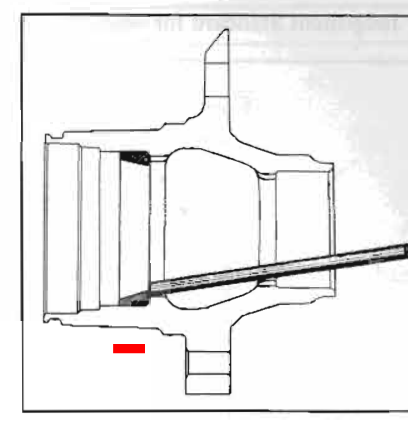

August 17, 20186 yr comment_555566 The fact that you got a change in that gap, to me, says that the base and tube joint is loose. It's supposed to be rigid, you shouldn't have been able to make it move at all. I'd get the angle right and have it rewelded. Maybe add a gusset like T3 does. Even if it doesn't fall off it's going to move while you're driving. Probably break eventually. I would not "leave it". Grab the top of the wheel and shake it or just shove the front of the car side to side and see if the gap changes. Maybe it will just fall apart and you'll have an easy decision. You should be able to see a clean gap at the intersection of the tube and casting, at the bottom, where the tube is moving in the casting. Use a bright light and take a look. Link to comment https://www.classiczcars.com/forums/topic/60602-front-suspension-and-tire-clearance-problem/?&page=2#findComment-555566 Share on other sites More sharing options...

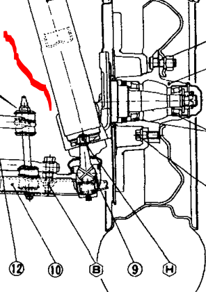

August 17, 20186 yr Author comment_555568 Any chance you can show me on a diagram where your thinking the problem is? Â I can weld so that's an easy fix if I know where and can get the angle. Â You bring up a good point with shoving the car since I usually have to give it a good shove to get the casters to rotate and I just moved it so that could all be related. Link to comment https://www.classiczcars.com/forums/topic/60602-front-suspension-and-tire-clearance-problem/?&page=2#findComment-555568 Share on other sites More sharing options...
August 17, 20186 yr comment_555570 The strut is a tube pressed in to a casting. Actually I might be wrong on the welding. They say that the spindle is attached to the "casing" then welded. Might be a translation error. Maybe the tube is just a press fit. Can't be sure. But that's where you want to look closely. The bottom drawing is from 1976 because it's more clear. Link to comment https://www.classiczcars.com/forums/topic/60602-front-suspension-and-tire-clearance-problem/?&page=2#findComment-555570 Share on other sites More sharing options...
August 18, 20186 yr comment_555588 11 hours ago, Zed Head said: The strut is a tube pressed in to a casting. Actually I might be wrong on the welding. They say that the spindle is attached to the "casing" then welded. Might be a translation error. Maybe the tube is just a press fit. Can't be sure. But that's where you want to look closely. The bottom drawing is from 1976 because it's more clear.   The strut tubes are indeed welded to the spindle casting/forging. If you invert a strut and look at the end where the knuckle is bolted onto it, you can clearly see the welded joint. I can't imagine a tube being welded on at the wrong angle and passing quality control.  Link to comment https://www.classiczcars.com/forums/topic/60602-front-suspension-and-tire-clearance-problem/?&page=2#findComment-555588 Share on other sites More sharing options...
