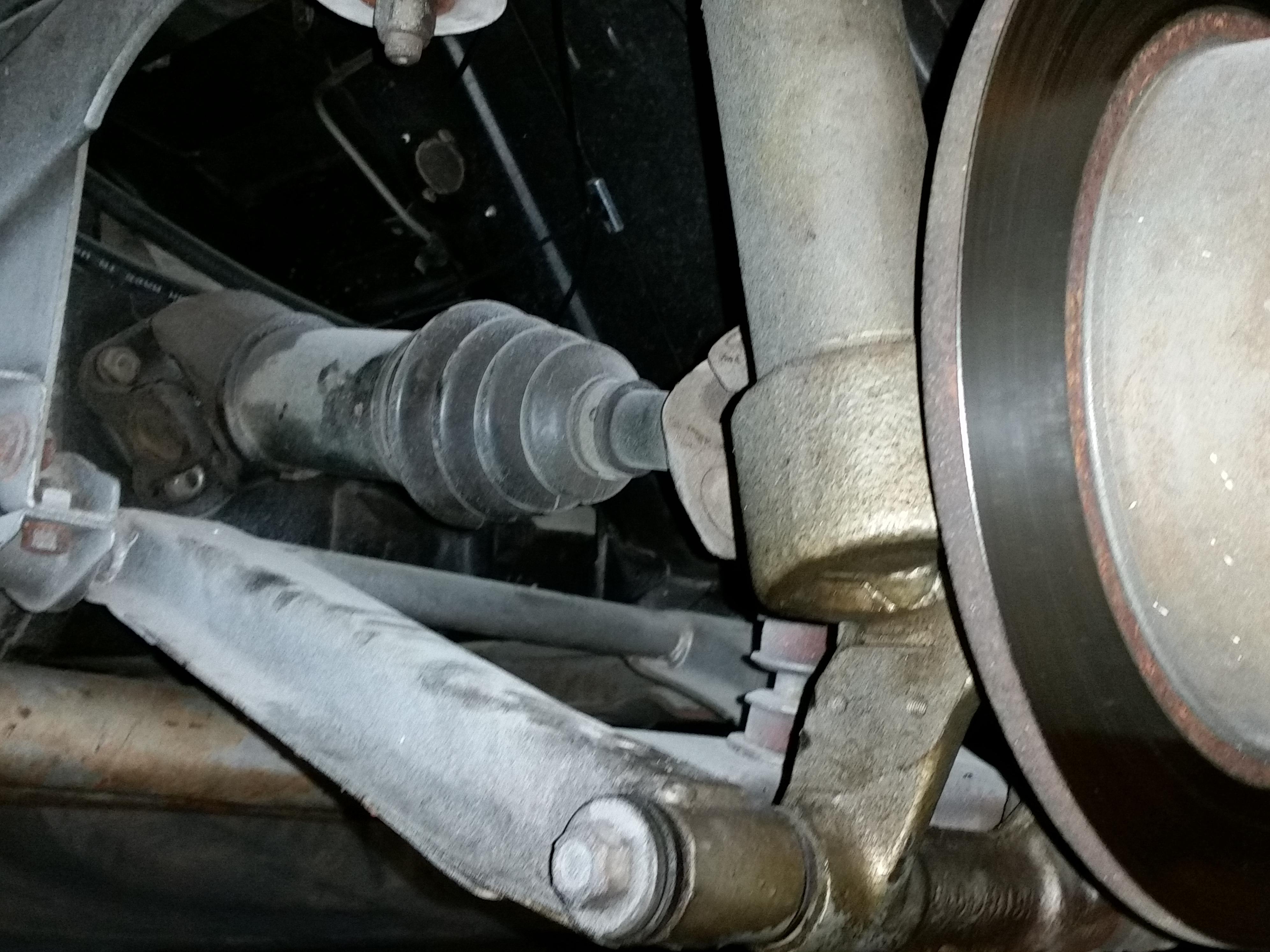

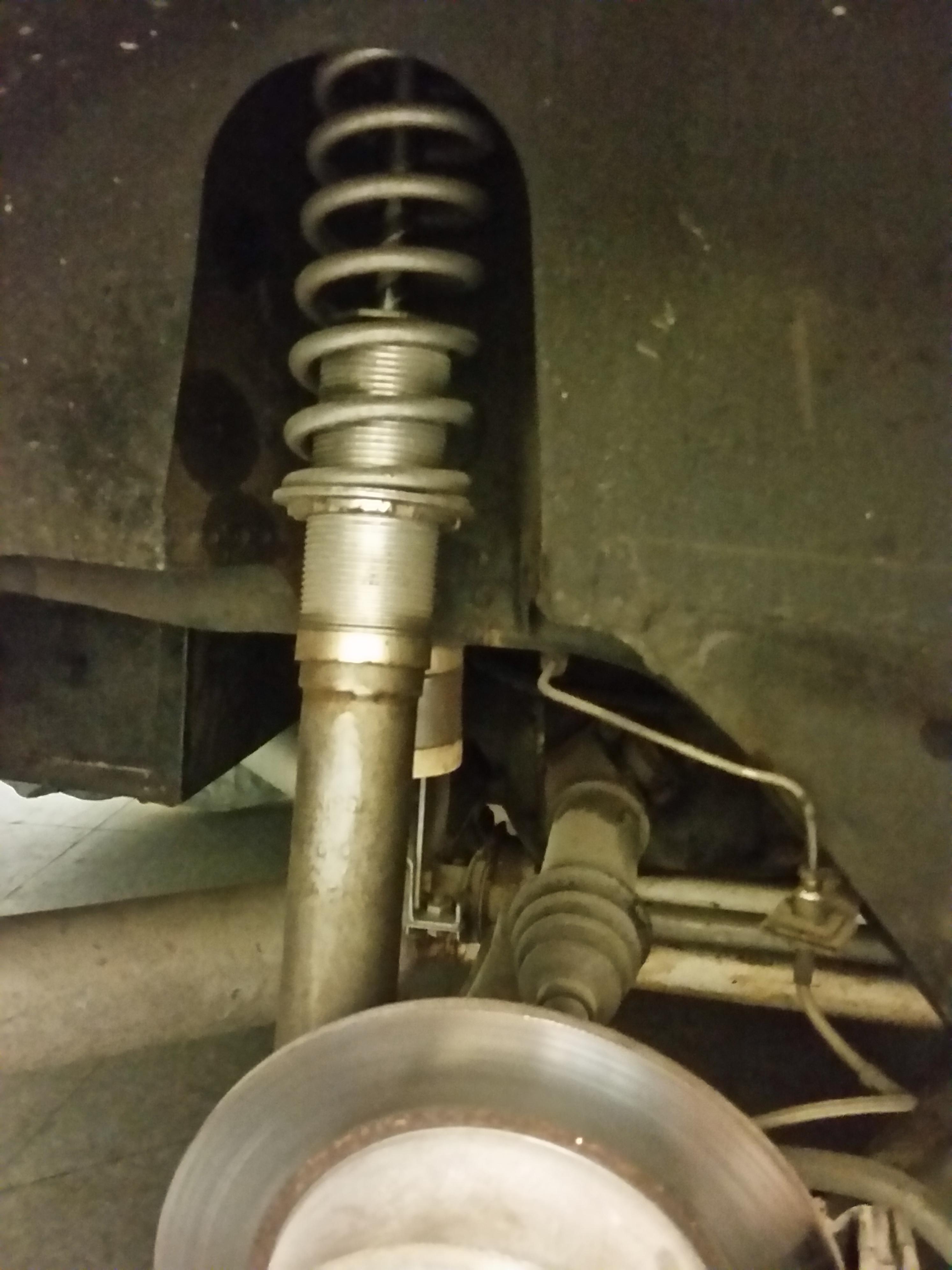

I have a re-bodied 240Z. The VIN says it is a 1973.  After a couple of years of restoration it is now on the road and shake down has begun. I discovered the right rear strut was leaking so I started looking for replacements. Am I correct that a '73 has a straight axle and if so then what do I have in my car. See pictures

All 240/260/280 Z's have Independent Rear Suspension.  So...  I don't know what you mean by "straight axle"...
Your suspension has been modified - that's not a stock rear strut.  The strut has been "sectioned" or an adjustable lower spring perch has been added.  You would have to take it apart to see if the stock strut insert (damper) is still there or if the insert has been changed (which is what usually happens when someone modifies the strut that way)  The stock rear brakes were not discs - they were drum brakes.
I think he meant "live axle".  Which is an odd name in itself.  https://en.wikipedia.org/wiki/Beam_axle#Live_axle_vs_dead_axle
To add - your suspension is already adjustable, the rear is at least.  You can either raise the rear by moving the threaded perch stop, or lower the front.  Assuming that whoever modified the rears also did the fronts.  Take a picture of the front suspension.
Edited by Zed Head
Loks like someone did a adjustable coil over "upgrade" and a disc brake "upgrade". The disk brake upgrade looks like a maxima disc and cailper upgrade, but not sue because Ican't see the cailper.
As for the strut modificatie. 20 year ago there were a lot of options out there for agjustabe coil overs. The one in your photo does not look firmiliar to me.
If you remove the cartidge, you may find the original manufacturer and order acreplacement. Or it could be a situation wear they don't make the cartidge anymore. Maybe a parts store can match it with an alternative. Most of these adjustable coil over manufactures source their cartrides from a reputable manufacturer.
Can you post a photo of the front strut? A photo of the rear caliper would be nice for curiosity.
