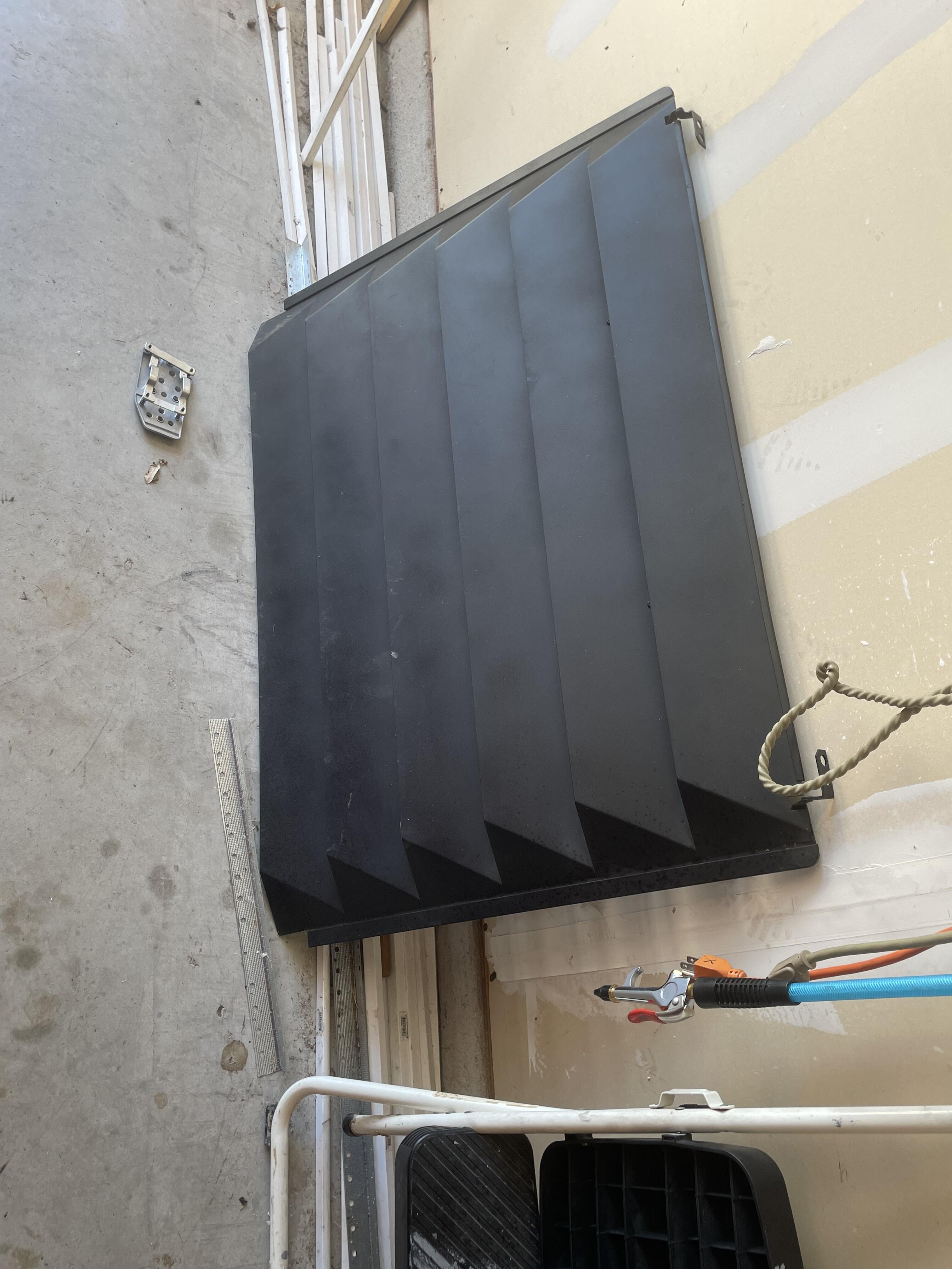

Finally back stateside. Dug through the old part boxes and found an old interpart mount I could use. Had to beat it with a hammer, since it was a bit beat up on the metal mount. The louver is back in the car.

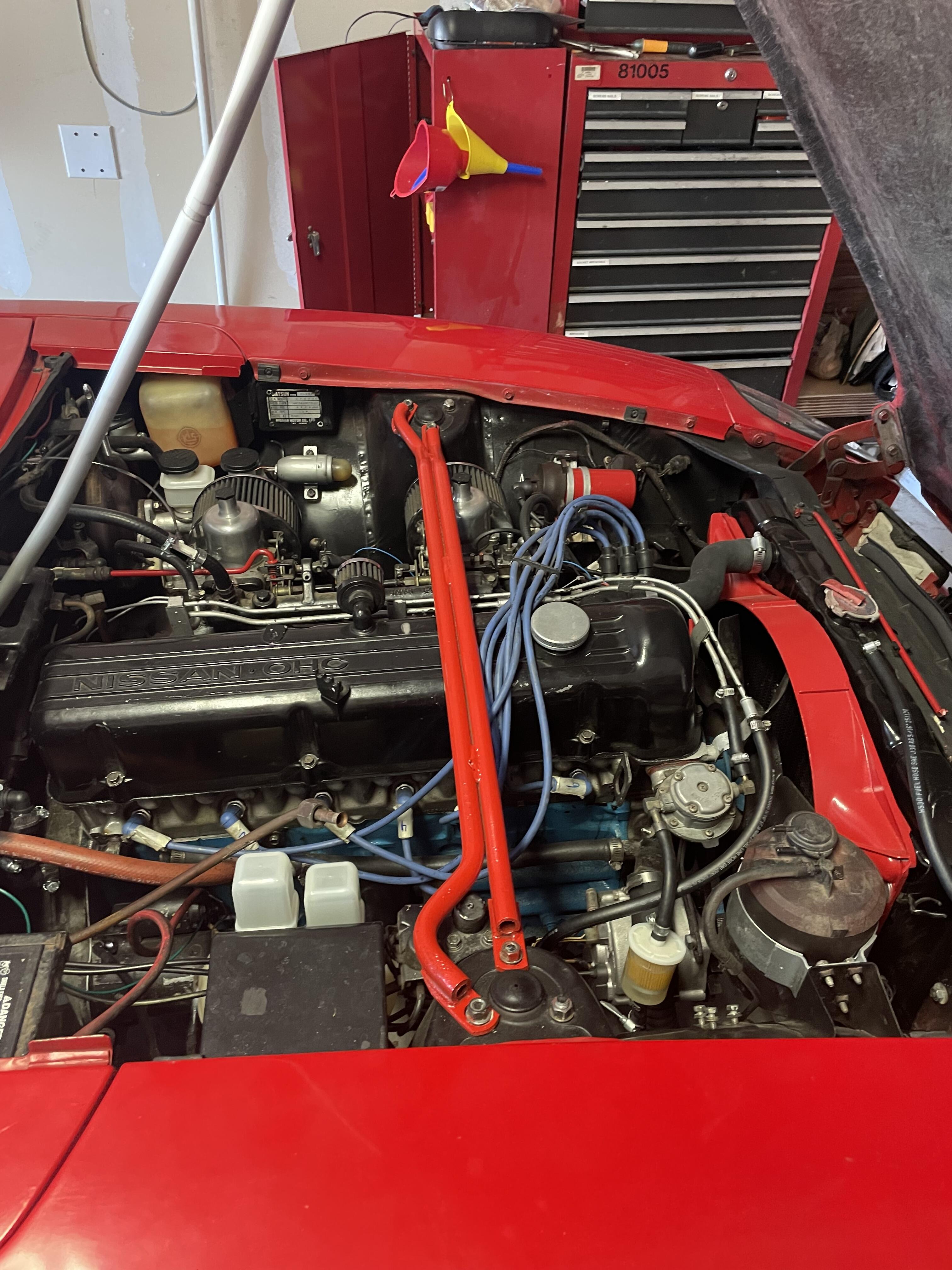

Installed a front sway bar I got off a guy from S30 World on FB. Already noticed a significant change in handling.
currently investigating the pop sound when I kill the engine. I think it may be a backfire, and I think the car is running a bit rich.
A small thing. I wouldn't call that a sway bar. I would call that a strut tower brace. Sway bars are normally connected to the wheel swing arms
