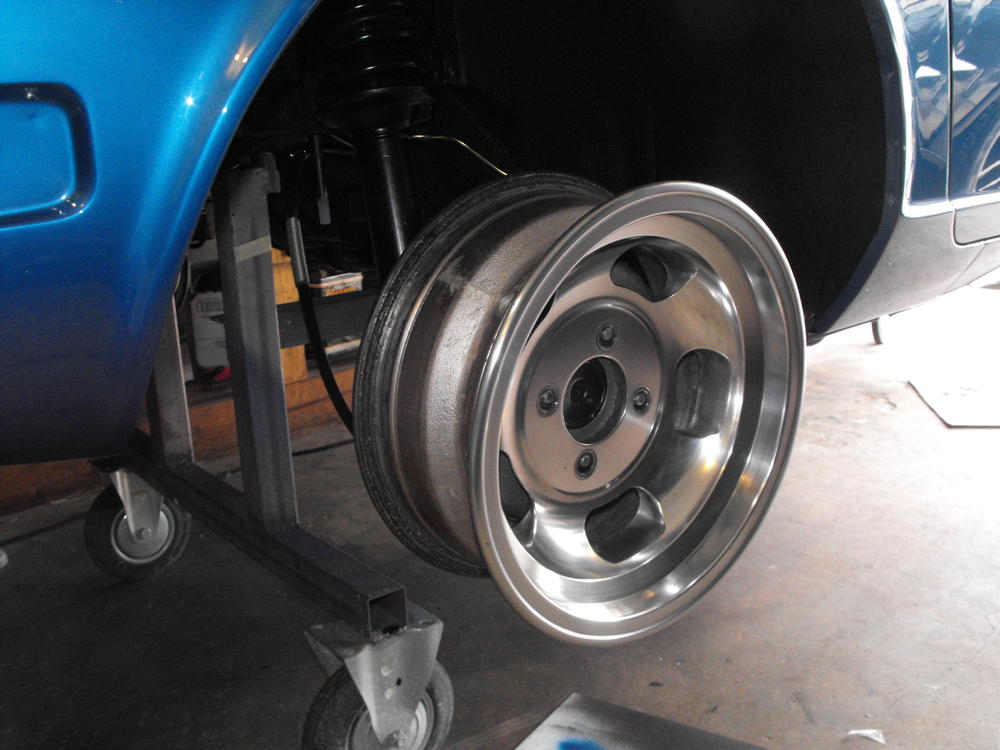

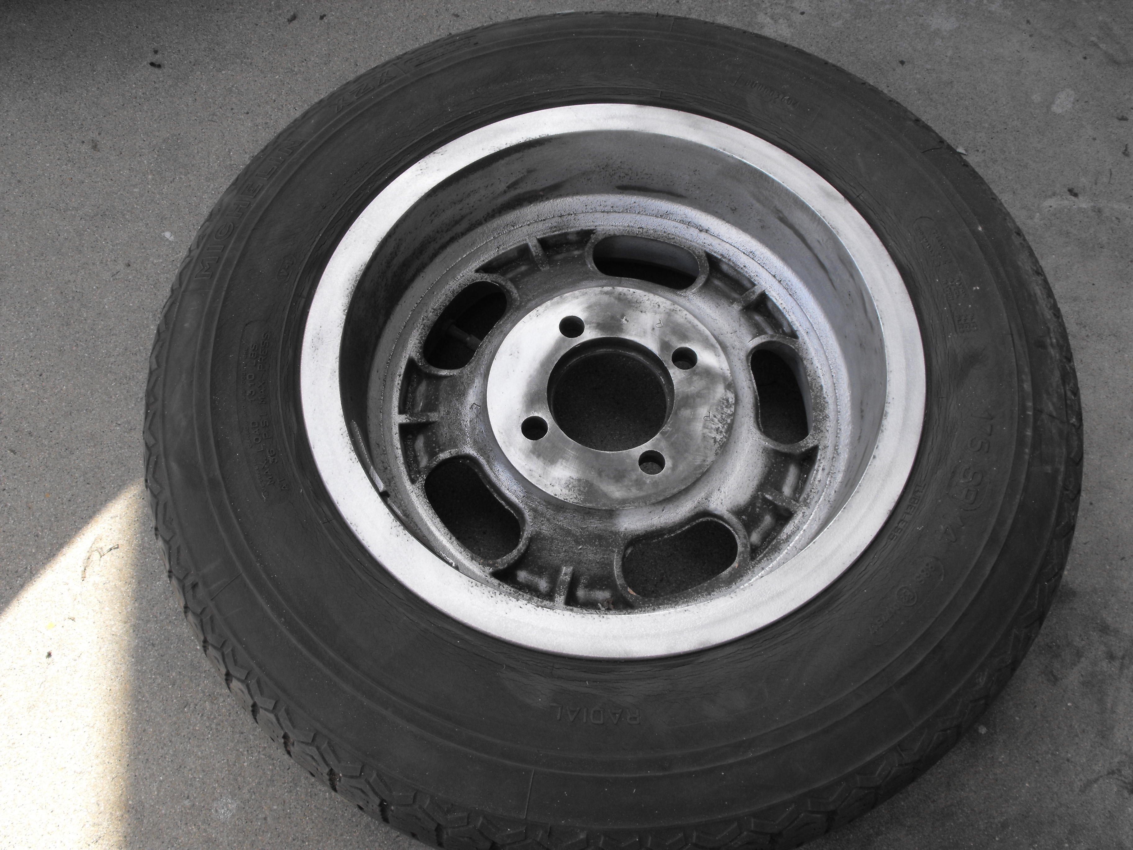

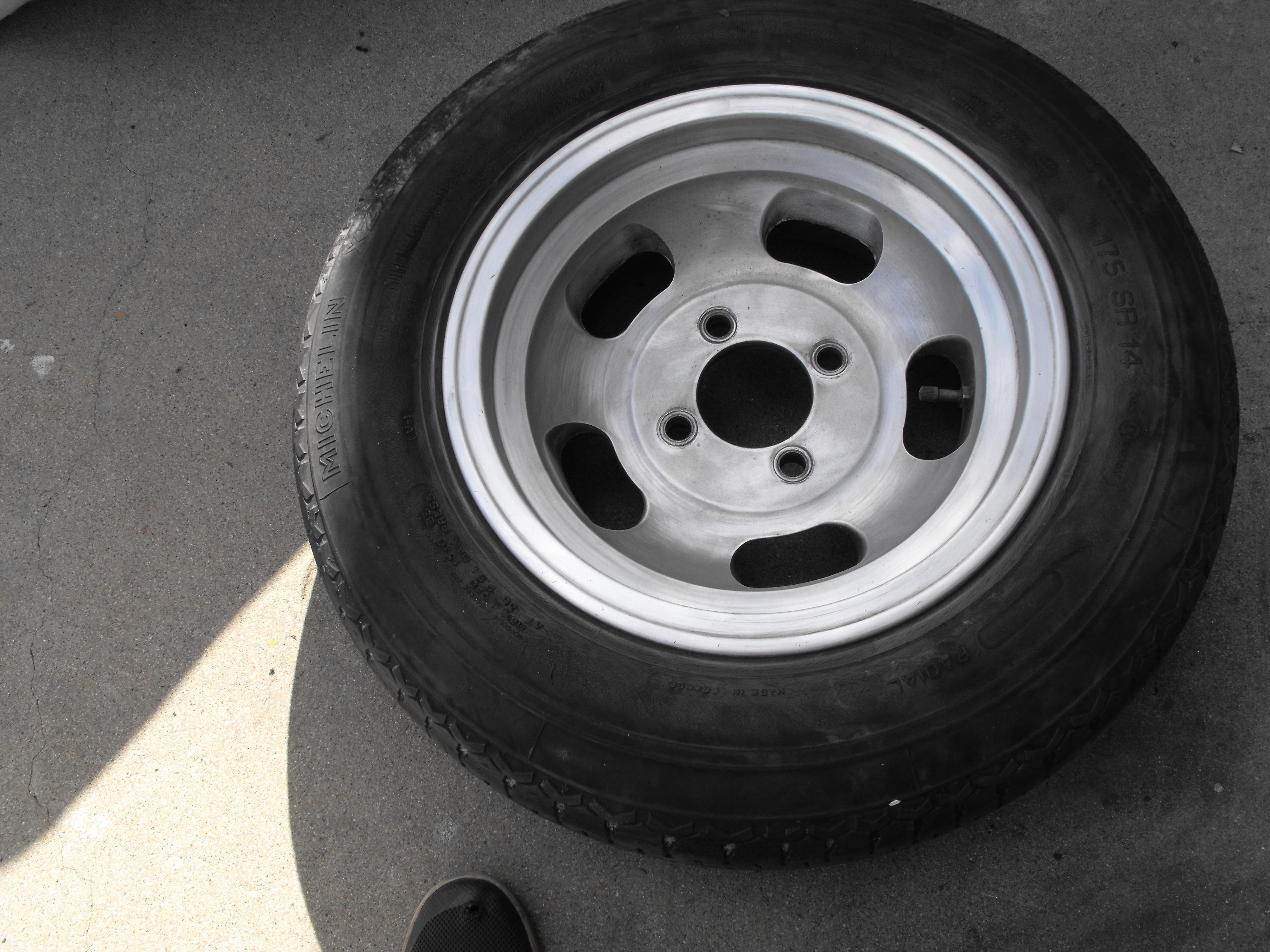

Cleaning and polishing the aluminum mags now.  The back side was pretty corroded.  Cleaned it up a bit before taking to Discount Tire to have the old tires removed.  With the tires removed, I will start polishing these up.

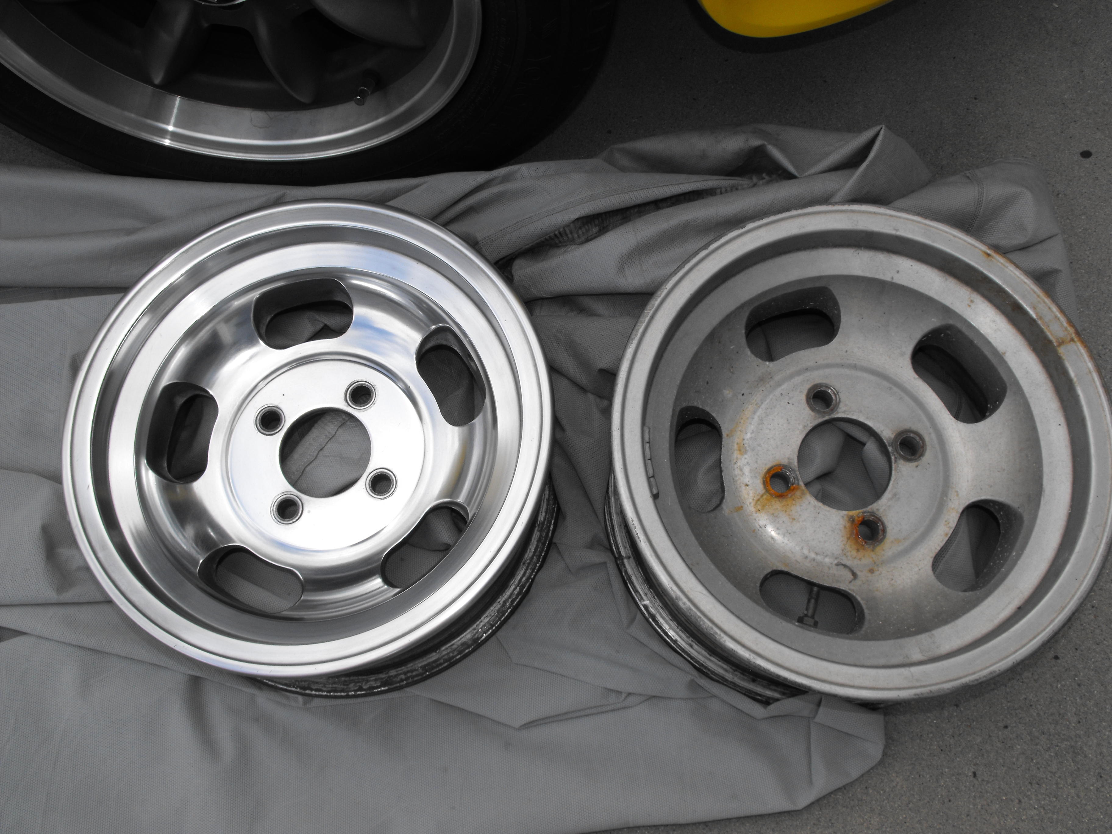

Technique is pretty old school.  No vapor blasting here.

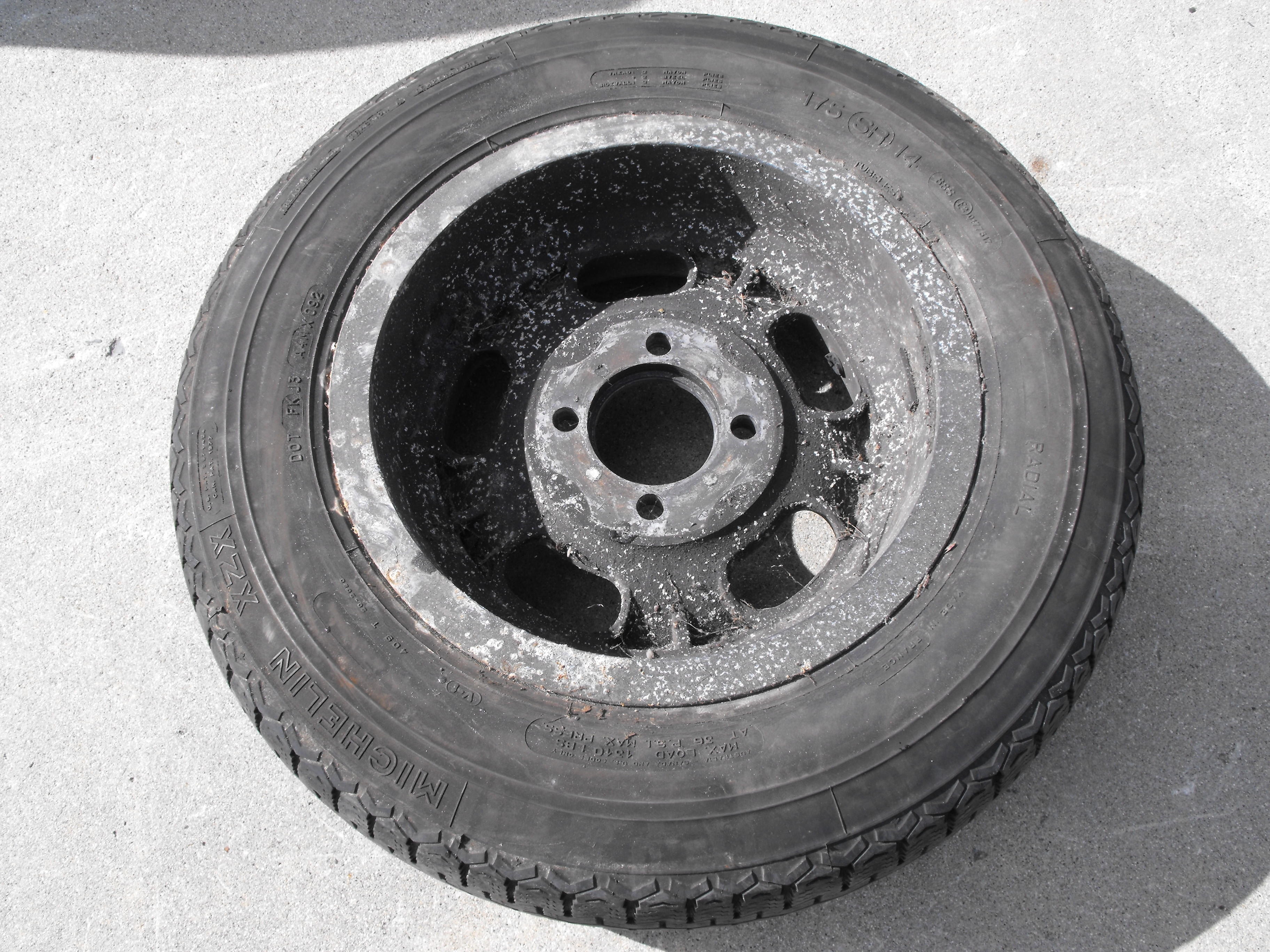

For the Back side which was pretty caked, I attached an old wire wheel from my bench grinder to my Makita angle grinder.  It worked great.  Plenty of power and RPM's.  It cut through the corrosion pretty quick without eating up the aluminum.  Then I Used my cordless drill with the little conical wire brush attachment and got the crevices.
For the front, I used small wire wheels on the slots.  Then I used sandpaper, then polishing compound, then Mothers Power Ball to finish out.   I used 220 grit on the road rash that was on the lip.  Otherwise it takes forever to smooth things out.  Then I used 500, then 1000, then 1500 grit on the entire front of the rim.  I sanded mostly in a radial direction.  Then used the Dark Gray polishing compound with polishing wheel attached to my $18 Harbor Freight 3000 RPM corded drill.  After that I went over it again with the finer white polishing compound.  After that I used the Mothers power ball along with the Mothers polish and then wiped clean.  It takes about 2 hours per wheel going through the whole process.  Also use the sandpaper and polish on the slots.
So, that's it.
Any concerns about using a steel brush on the aluminum wheels and causing rust stains?
Never thought of that. (not sure if I've ever seen that) Would only be an issue for the back side. Maybe I'll hit it with some gloss clear just in case. Wouldn't hurt and would actually make it easier to clean

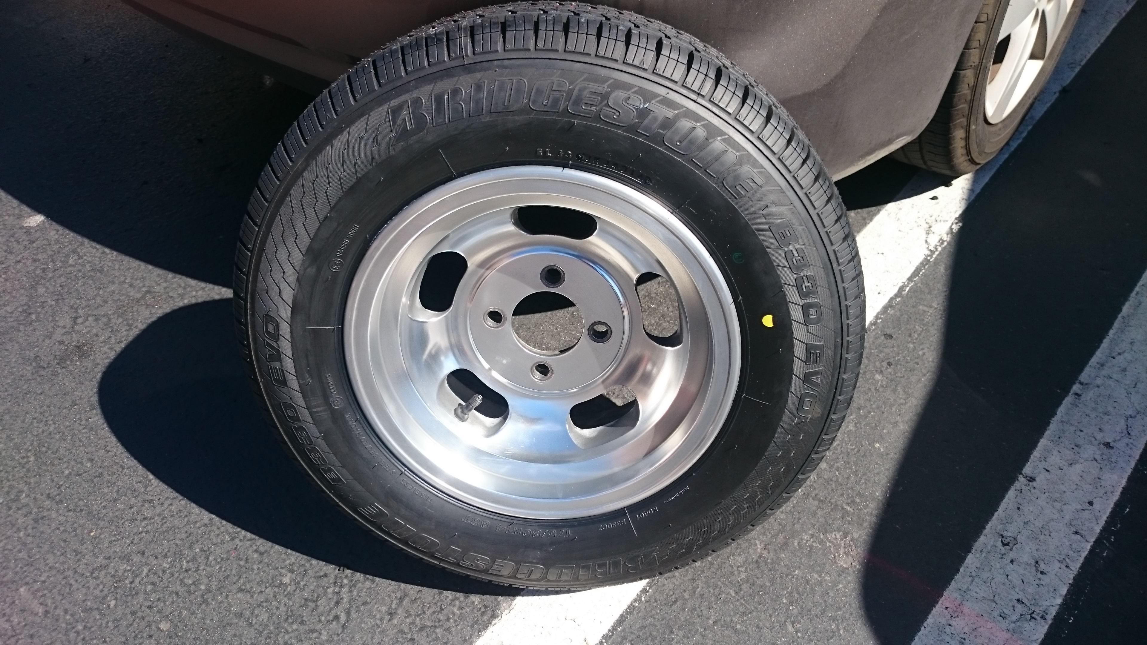

Got two of the Bridgestones mounted, 175/80R14's.  That's pretty hard to find.
For those that are curious,  when I purchased this Z new in 1973,  it had Bridgestone RD150 175SR14 tires (per the original spare Motorman7 has just cleaned up).  In my desire for authenticity,  and since Bridgestone no longer makes the RD150, I started searching for any Bridgestone tires of the correct original size.
Bridgestone does not sell that size in the US anymore, but they do in Europe and Australia.  (B330 EVO 175/80 14 models)  I contacted several sellers in the UK, but none would ship to the US.  Finally found a seller on the eBay UK site, who would ship from France!  Only took a couple of weeks to get here.  I have the other two at my home in N. California, and will be taking them to Motorman7 in a couple of weeks.
In my signature block below is the car in 1973 with those beautiful shinny wheels and the RD150 175/80 14 tires:
