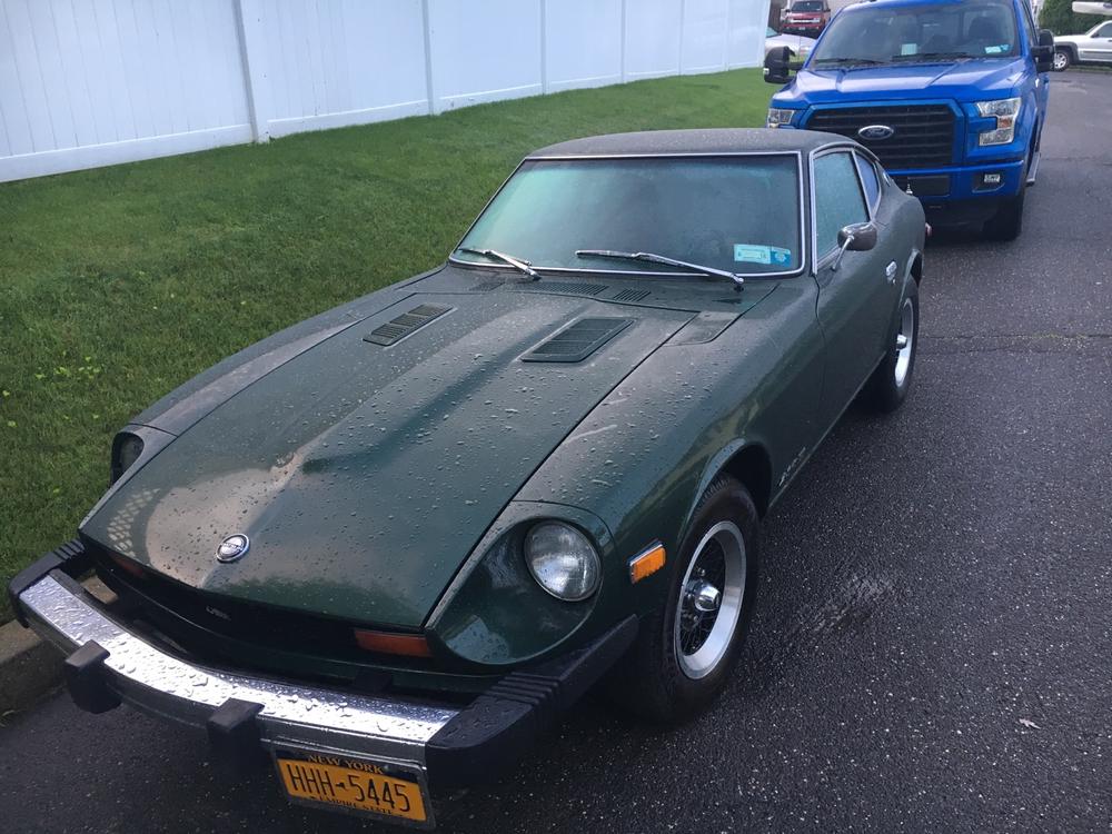

I thank everyone for their comments and help. I have thought about this a lot and although I am a novice and my setup is no where near ideal I am going to save this car. It’s un-drivable as it is so what do I have to lose? The worst thing is I find out down the road I need to part it out. Besides it will be a great learning experience. I hope I can continue to count on this community to guide me through the process

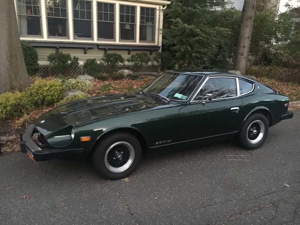

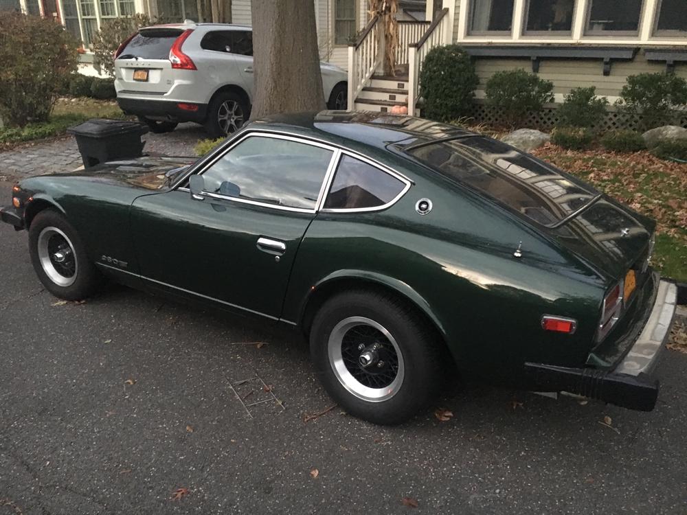

Got to admit- the car looks nice !

Were here for you,  my comments are just cautionary.  The PO's took excellent care of the top half of the car, very smart looking Z, the joys of salt eh?
The strange thing is that all the damage appears on the drivers side only.  I made some wood jack stands this weekend to better support and level the car.  I will post pictures this week.  Thanks for all the support.  They rest of the car looks so good I cant choose the parts car option just yet without giving it a try.
