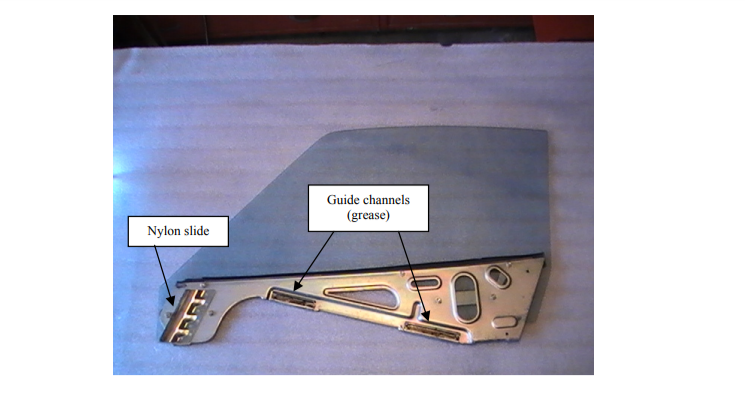

I am pretty sure that there are pictures of 1976 windows in a Technical Article written by Escanlon.  Not sure of spelling and didn't look for it, but I remember it from the past.  It's in the Downloads area somewhere.
I think it's this one.  The Resources page is all wacked out, I can't figure out what's what.  I used Google to find the original page, with its own broken links.
https://www.classiczcars.com/forums/topic/41403-article-s30-door-window-problems-and-troubleshooting-procedures/
https://www.classiczcars.com/files/file/57-enriques-s20-door-window-problems-troubleshooting/?do=download&csrfKey=ac8102f4e253cc3512ec9e84a85d68e9
Apparently it's 1972, not 76.  Snipped a picture.

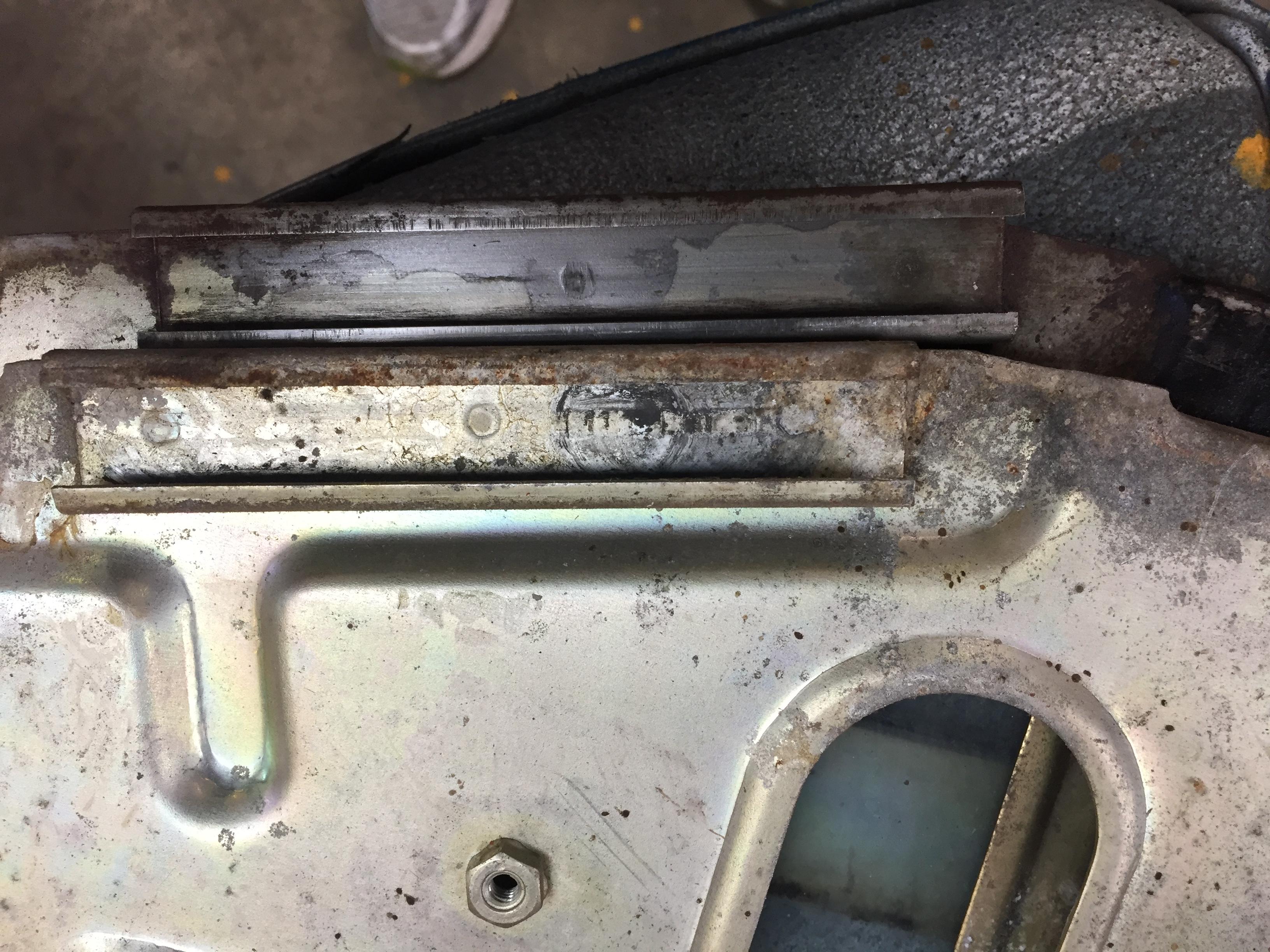

Ok, here are two side by side.
First thing to note, the most useful I think, is that the GLASS is IDENTICAL on the 240 and 280 windows, at least up to 77-78 which are NOT interchangable.  If you break yours, you can get a glass from any year 70-76 and just swap it on your frame. The metal frame the glass is attached to is definitely NOT identical. Very similar yes, easy to confuse, yes.
Here is the difference. Both C-channels that hold and guide two of the regulator rollers are different in length and relative position on the backing plate.
I lined up the two frames front and back, then took pictures of the two sets of C-channels. The underneath one is the 280 frame. 240 on top (no glass in the frame)
Here is the rear channels. They are about the same length, but offset ~ 0.75".  Note that the regulator wheel could be inserted at either end of either channel.

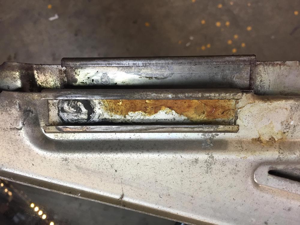

here is the front one. The 280 (bottom) is farther back and shorter.  Note that the regulator wheel could be inserted on both ends of the 280 only. The top 240 channel is too close at the front to the stamped indentation to allow the wheel in. To me this is the "best and fastest" way to tell them apart if they aren't together. If there is no access for the wheel one the front channel, it's for 240.

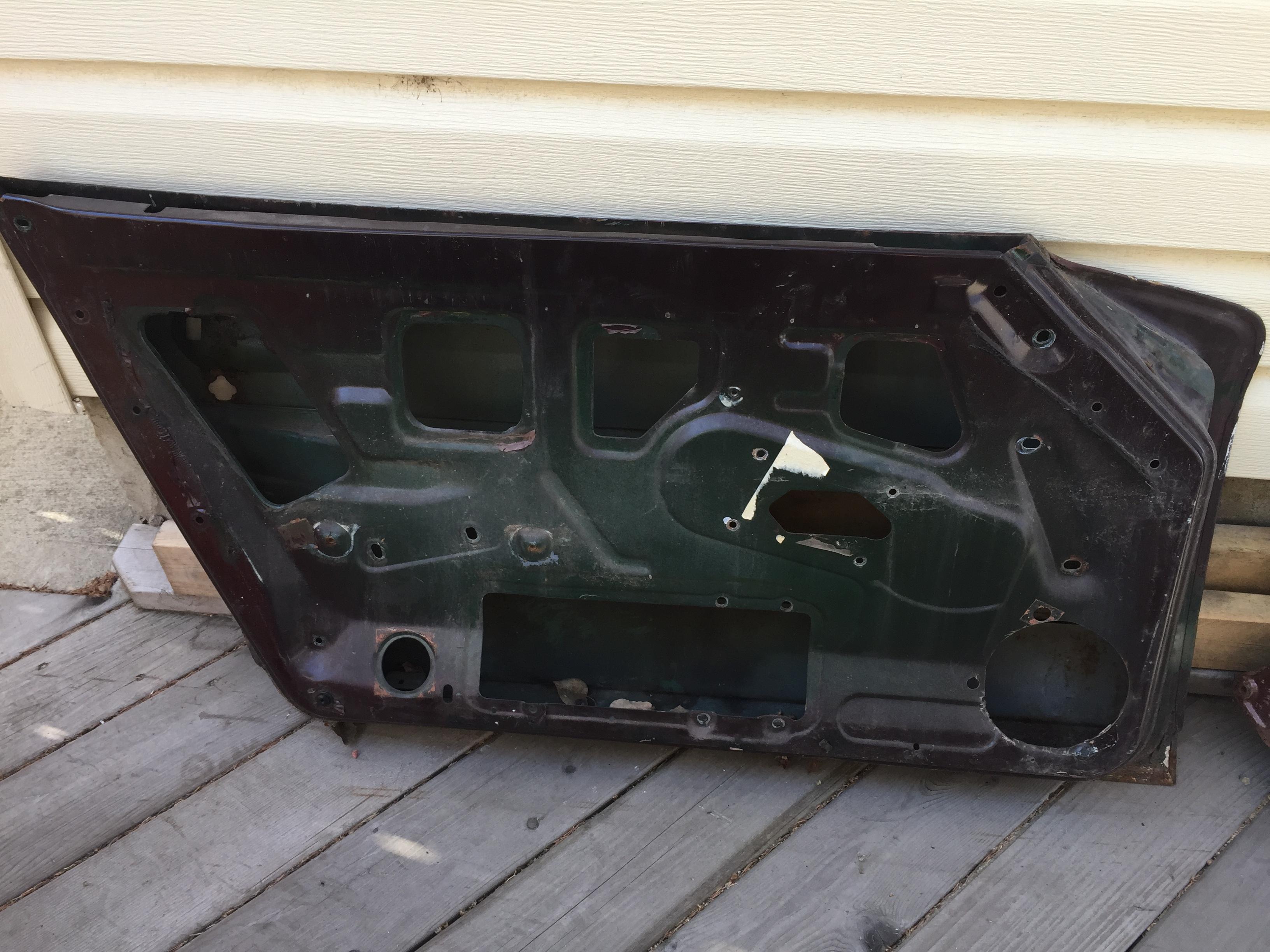

75-76 280 door. Note the "outy" area around the regulator crank spline area.

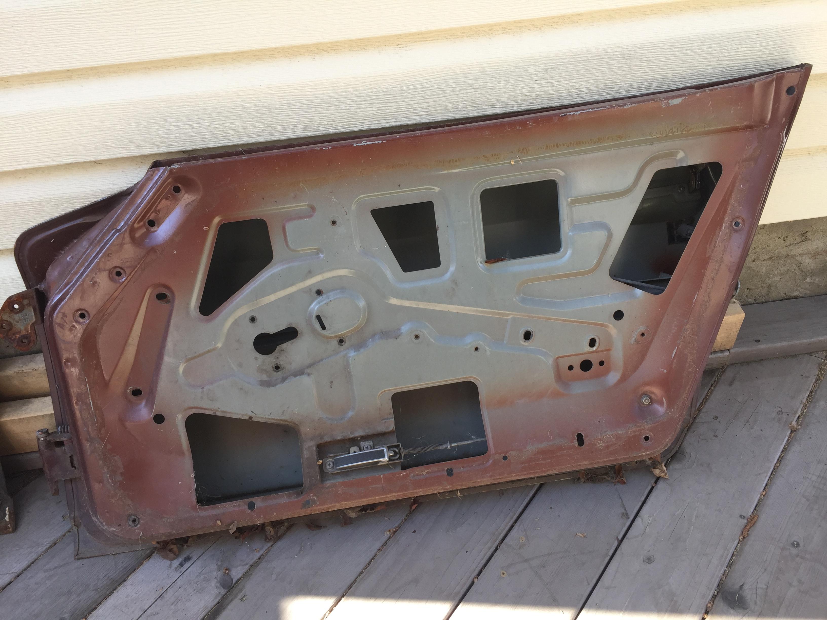

240 door. Not the indented "inny" area around the regulator crank spline area.
Also notice the welded in area around the door release area that is open and a separate piece on the above 280 door (not there in the picture...).
Othe than the speaker hole, how many differences do you see? I see at least 5 uniquenesses.
