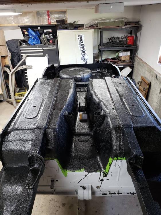

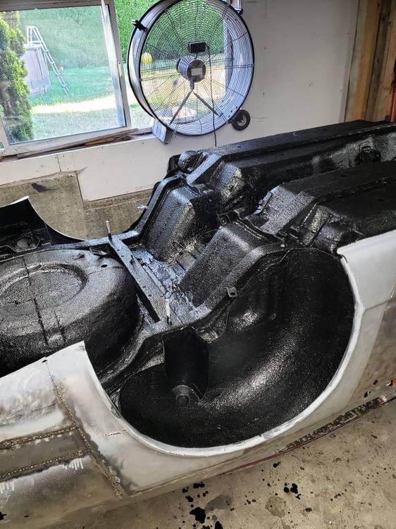

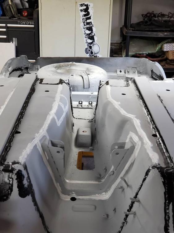

August 29, 20195 yr Author comment_582898 Holy hell boys! Been awhile , update is..... All rust is removed and repaired. Epoxied the bttm and seam sealed er up and today I put on the final 2nd coat of undercoating (herculiner) I chose this stuff because I had used it on my bro co and I a used that thing hard in the bush, she held strong so I assume in this application under a car instead of a beast she will hold up fine. Pretty friggen excited to bolt on a few suspension pieces and get this thing off the stand and on ots wheels. Next up is a bit of a break from it, then set and adjust door gaps and hood /tailgate stuff. Should be ready to epoxy the body and start in on skim coats of bondo by the fall. Yay! Sent from my SM-N960W using Tapatalk Link to comment https://www.classiczcars.com/forums/topic/59909-where-to-go-with-this-rusthole/?&page=17#findComment-582898 Share on other sites More sharing options...

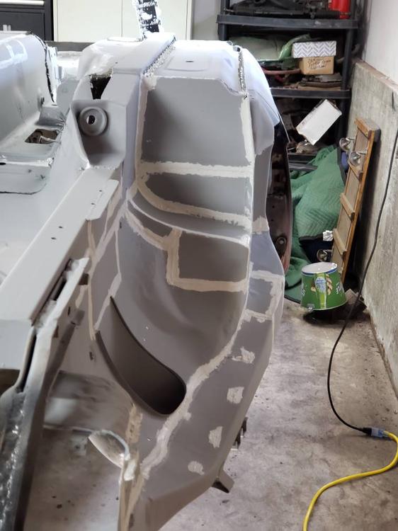

September 7, 20195 yr Author comment_583434 Alright ghys I'm now officially into the world of unkown haha. Panel fit up and the beginnings of body work. Drivers door is pretty good but the passnger door/fender is odd, the fender from PO is not straight down the edge vertical with the door, you'll see what I mean in the pics. I will shim the door out a bit to the side to mate up nice with the fender but what to do about the door gap. I can't do a lot more in terms of alignment with the door itself. I mean I could but I'll have to gri d and weld the lip at the back I think.... What's your guys thoughts on this bit of muckeryI gotta put the latch on too. Before I finish working this should I be checking how it closes and fits with the wetaher strip on or just do my gaps and ensure it all lines up nice then epoxy er up! Sent from my SM-N960W using Tapatalk Link to comment https://www.classiczcars.com/forums/topic/59909-where-to-go-with-this-rusthole/?&page=17#findComment-583434 Share on other sites More sharing options...
September 7, 20195 yr comment_583435 The gap at the very top is normally large like that. There is some inconsistency right above the body line. My way of going at that is grinding off metal or adding weld bead along the edge to build it out. I think I would strip the front fender to make sure what the rear edge looks like Link to comment https://www.classiczcars.com/forums/topic/59909-where-to-go-with-this-rusthole/?&page=17#findComment-583435 Share on other sites More sharing options...
