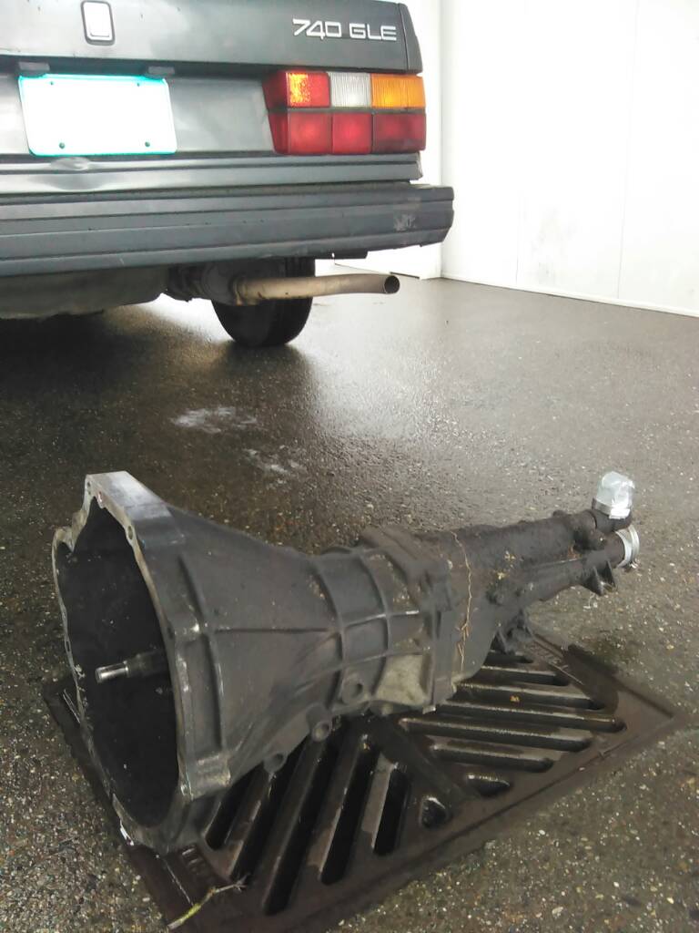

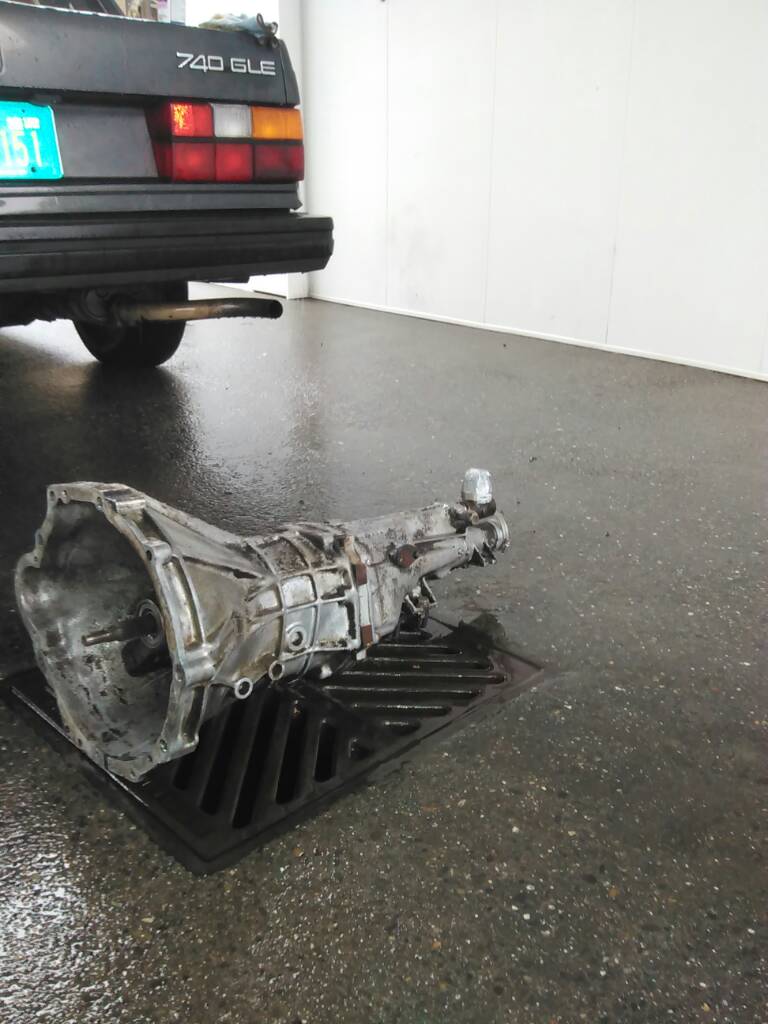

May 1, 20187 yr comment_548403 A trick that@siteunseen taught me was to cover the input, output, gear selector areas with plumbing pipe end caps, clamped with hose style clamps. Then cover it with oven cleaner for an hour or so. Once its soaked in spray it down with high pressure water. It works great. You can then easily detail the remaining gunk with a wire brush. Sent from my [device_name] using http://Classic Zcar Club mobile Link to comment https://www.classiczcars.com/forums/topic/59810-5-speed-swap/?&page=5#findComment-548403 Share on other sites More sharing options...
May 1, 20187 yr Author comment_548405 Thanks for the tips. Link to comment https://www.classiczcars.com/forums/topic/59810-5-speed-swap/?&page=5#findComment-548405 Share on other sites More sharing options...
May 1, 20187 yr comment_548416 I used cheap Walmart oven cleaner on this one, then high pressure washer. Link to comment https://www.classiczcars.com/forums/topic/59810-5-speed-swap/?&page=5#findComment-548416 Share on other sites More sharing options...

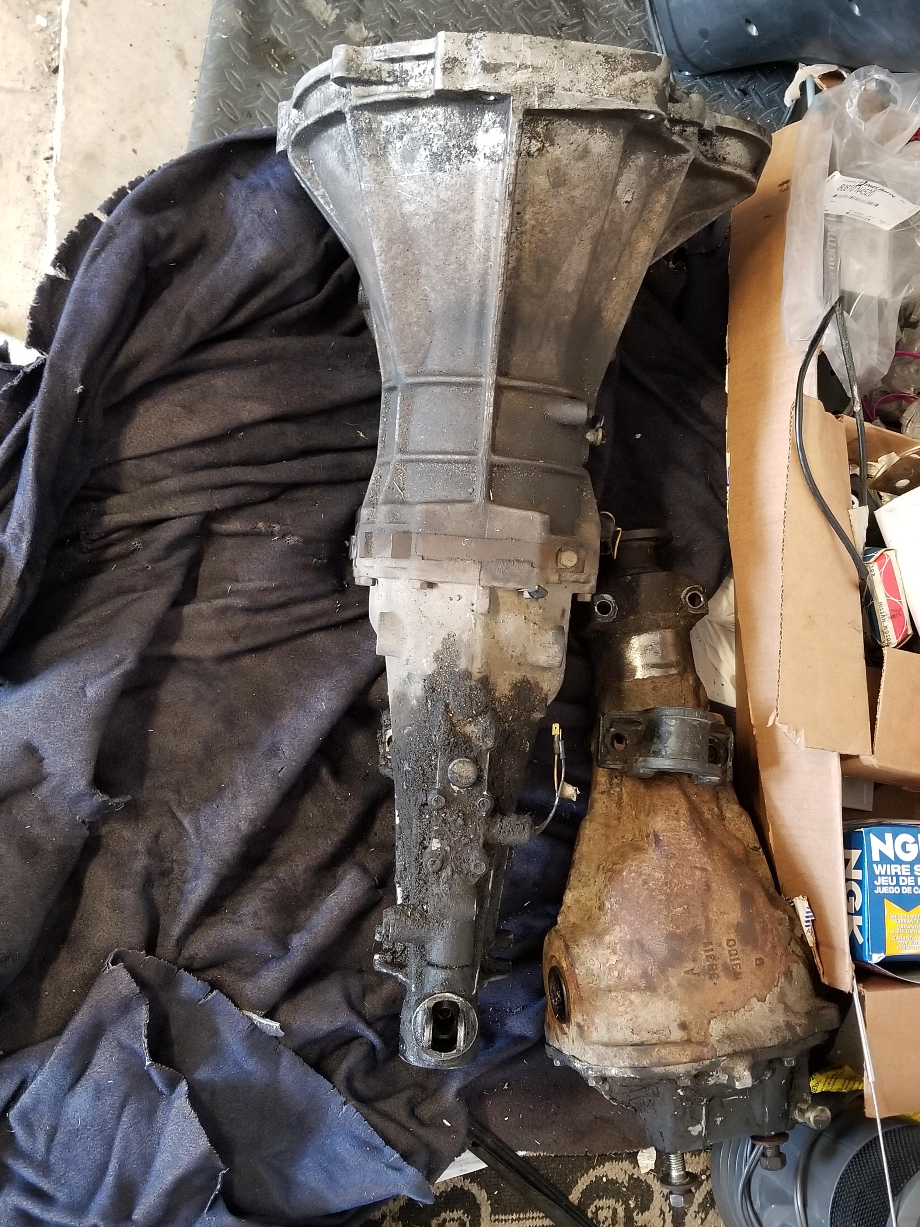

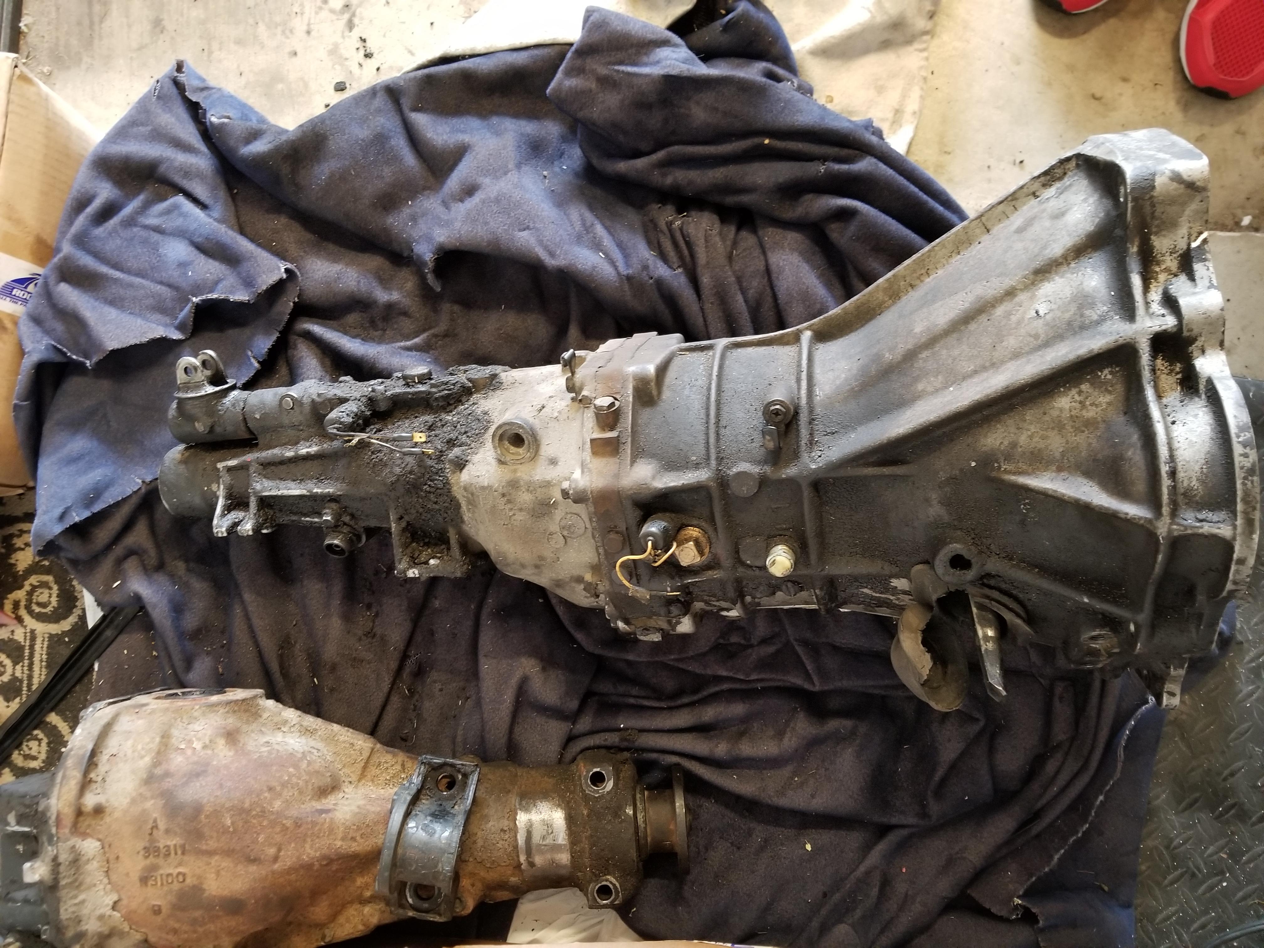

May 1, 20187 yr Author comment_548430 Looks good. Here is what the 4 speed looks like I removed. Link to comment https://www.classiczcars.com/forums/topic/59810-5-speed-swap/?&page=5#findComment-548430 Share on other sites More sharing options...
May 1, 20187 yr Author comment_548431 @Dave WM see the 3 connectors I have on the side? The one missing the leads is for the backup lights. They broke off when I unplugged them. The one in the back leads me to believe it's for reverse lockout. I guess the 83 280zx 5 speed is mechanical instead. Link to comment https://www.classiczcars.com/forums/topic/59810-5-speed-swap/?&page=5#findComment-548431 Share on other sites More sharing options...
