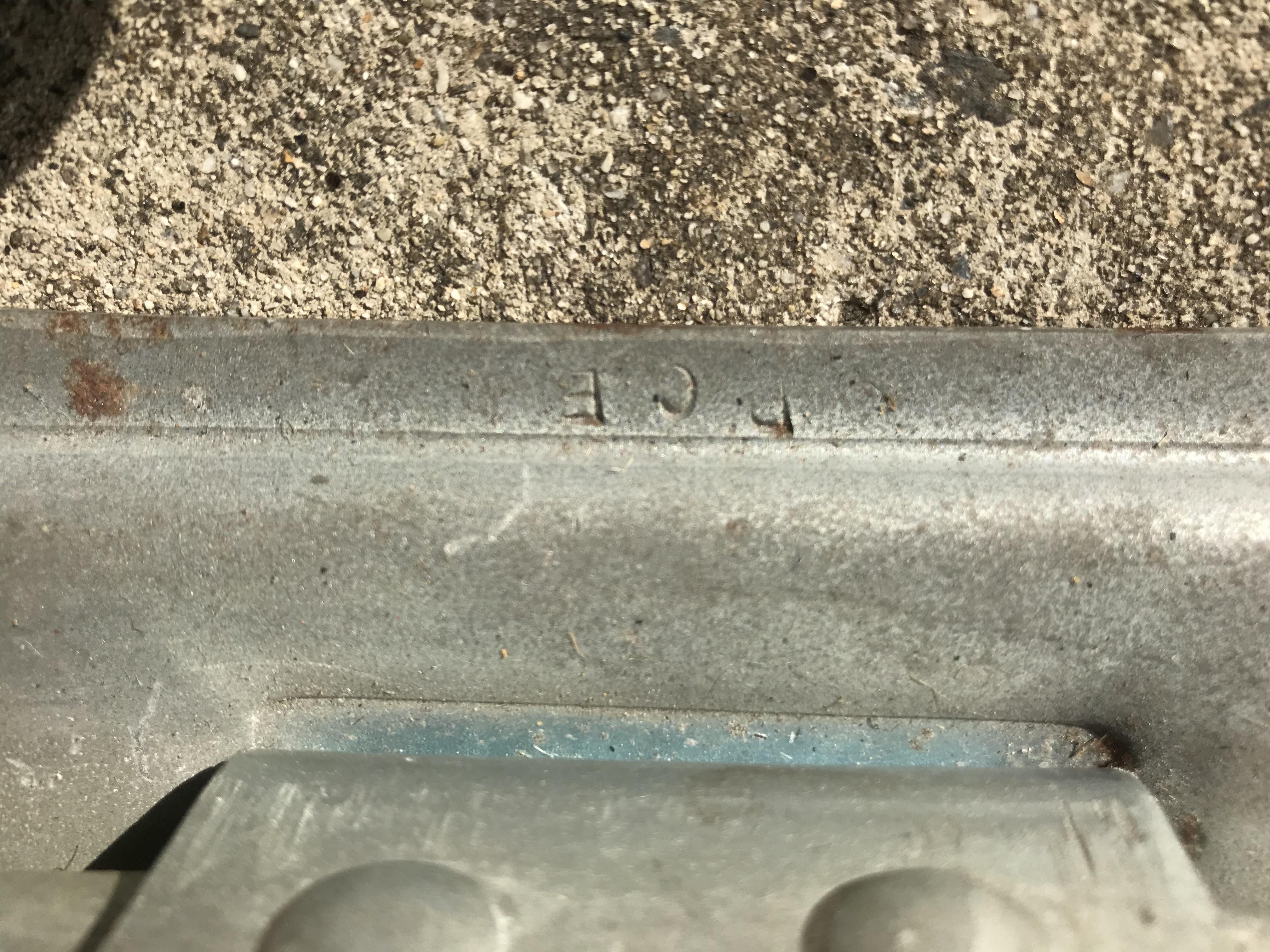

Hi,  have we discussed about this before?
I want to know the answer of these coding.

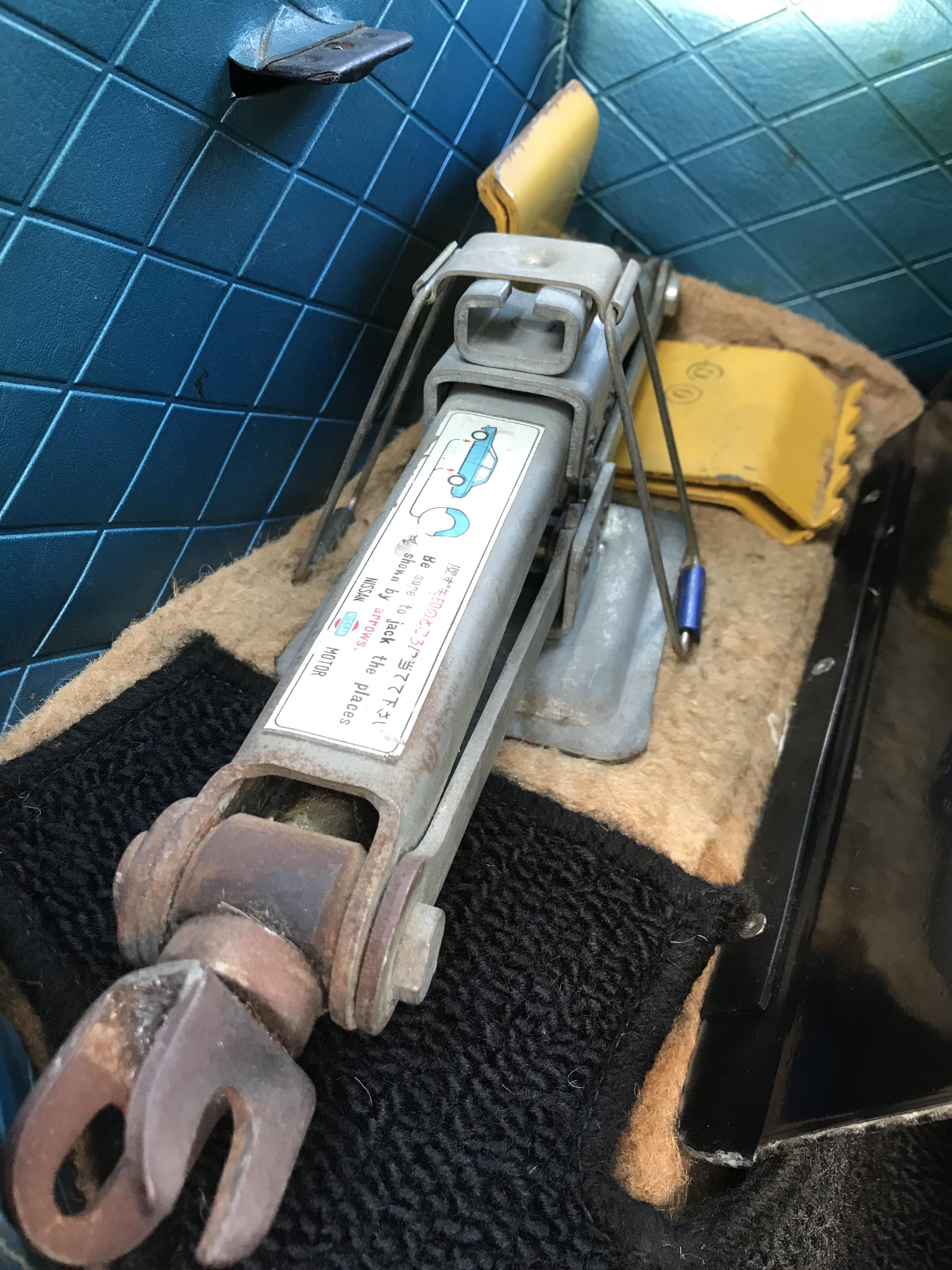

Each jack  has alphabetical code,
I have a jack ,
’ P. C. E ‘
Could it be made 1970 March 5th ?

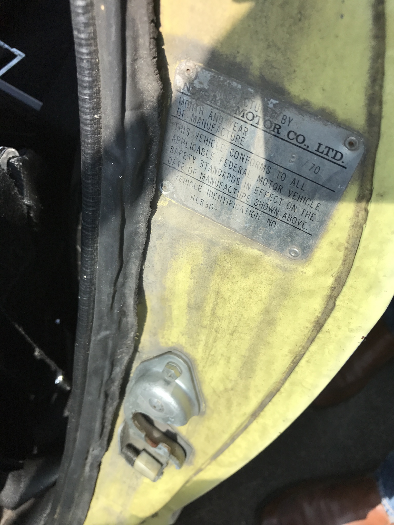

This jack is in my 03/1970 240Z.

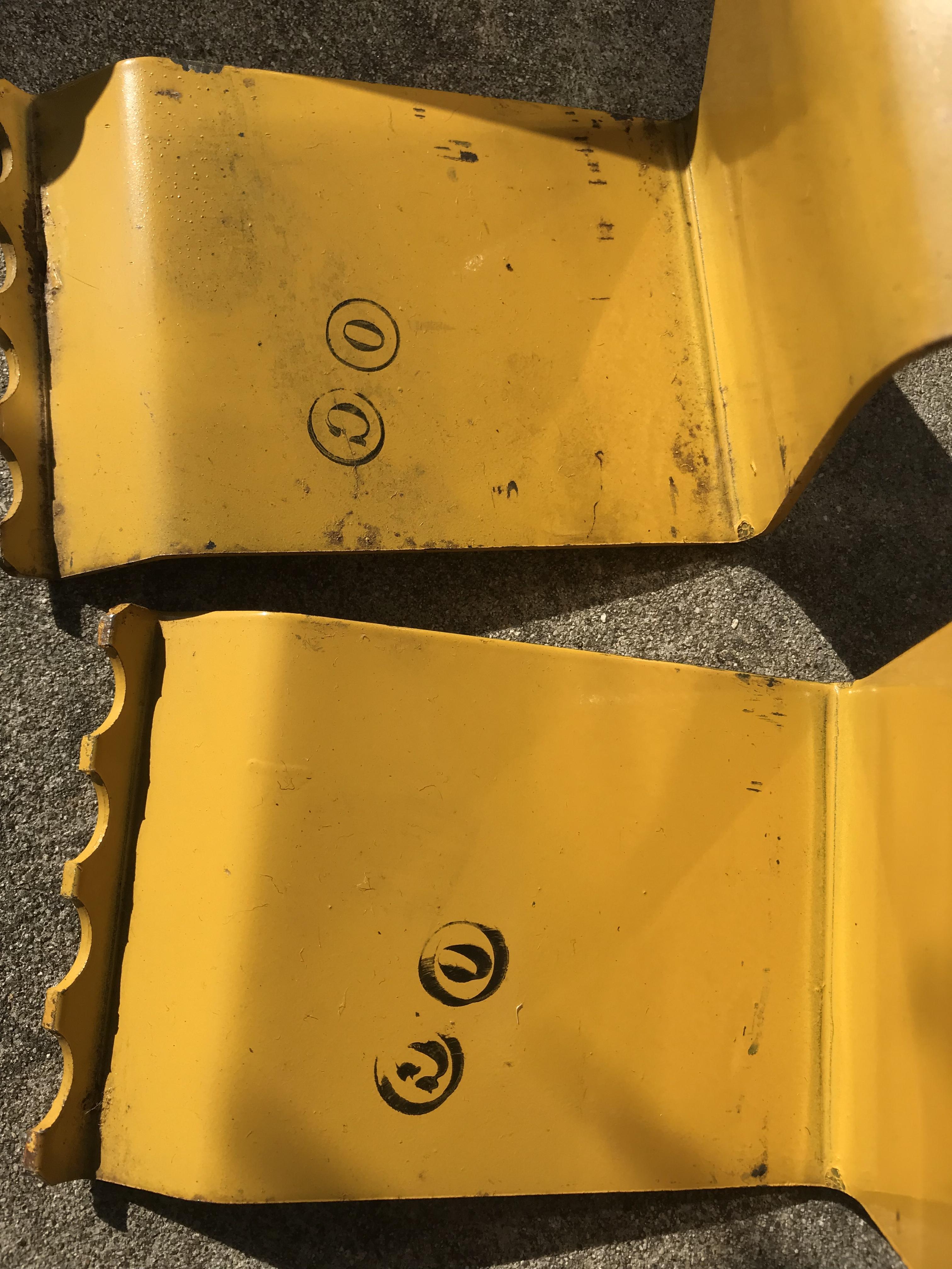

And olso the car has ‘ 0.  C ‘  stamp on a tire stoppers , I guess it could be 1970. March.
I saw a 09/1970 car has
‘ P  H  Y’ , this means  1970  August 25th ?
This car still has a paper list in a tool bag,
with a stamp ‘ 45   9   10’ ( 1970  September 10th)
And I found some 1969 cars have ‘ O ‘ for
their jack,
O  I   A  , 1969 September 1st ?
O  G  S ,  1969 June  19th ?
These cars have these on their tire stopper s.
‘  9.  I ‘  1969  September?
’ 9   K  ‘  1969  November?

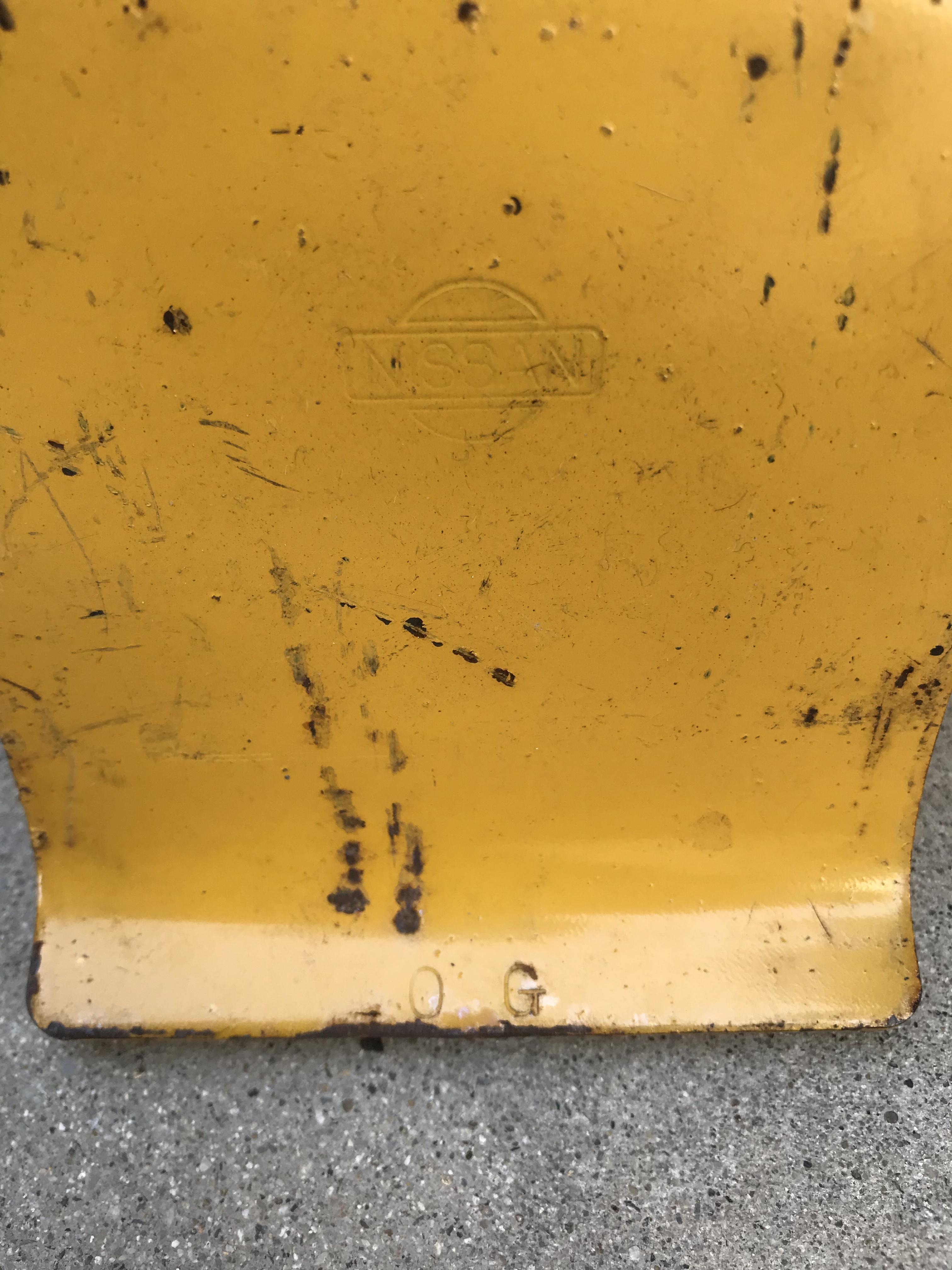

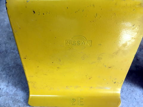

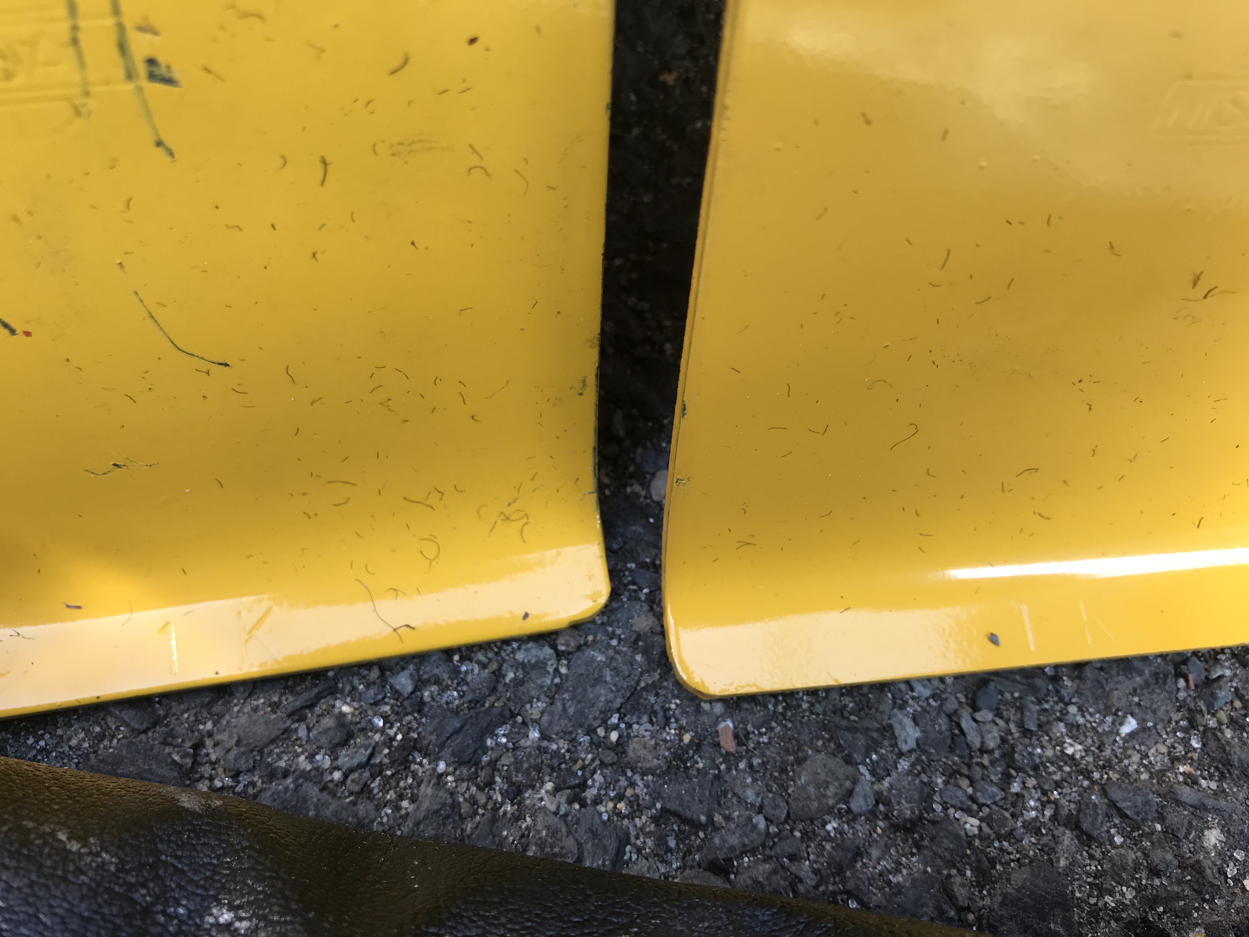

How about these , I think
Tire stopper,
0. G.  1970. July
2   E    1972   May
‘C ‘  is stamped, however ‘ G ‘ is engraved, so the change would be happened around April to June 1970 .

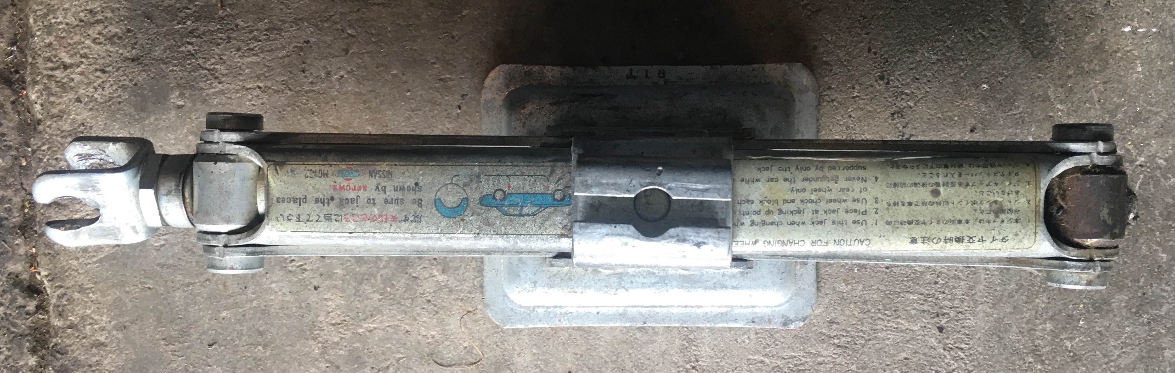

Jack ,
Q. F.  V.  1971. June 21st
R  E  DD   1972 May  30th

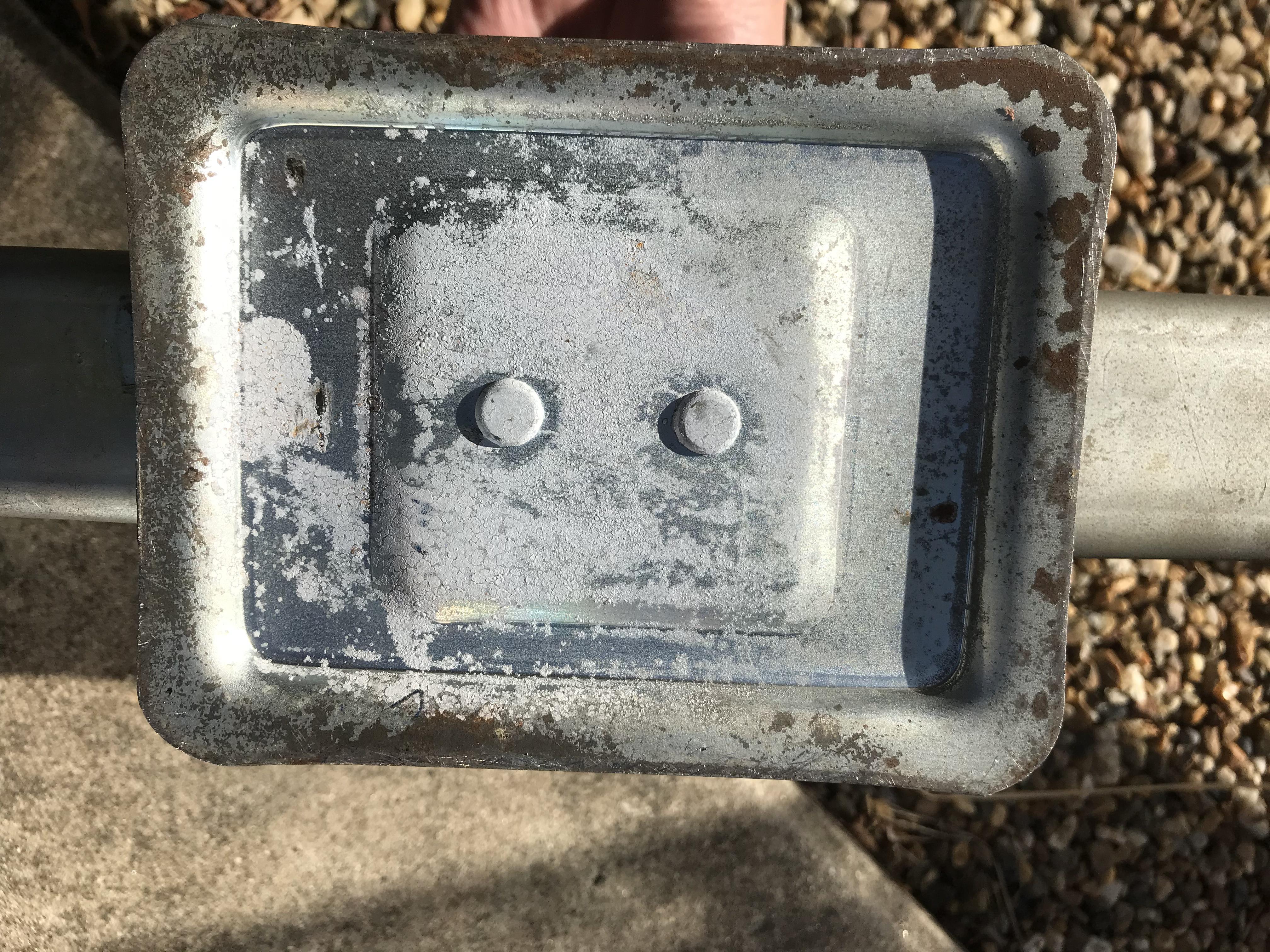

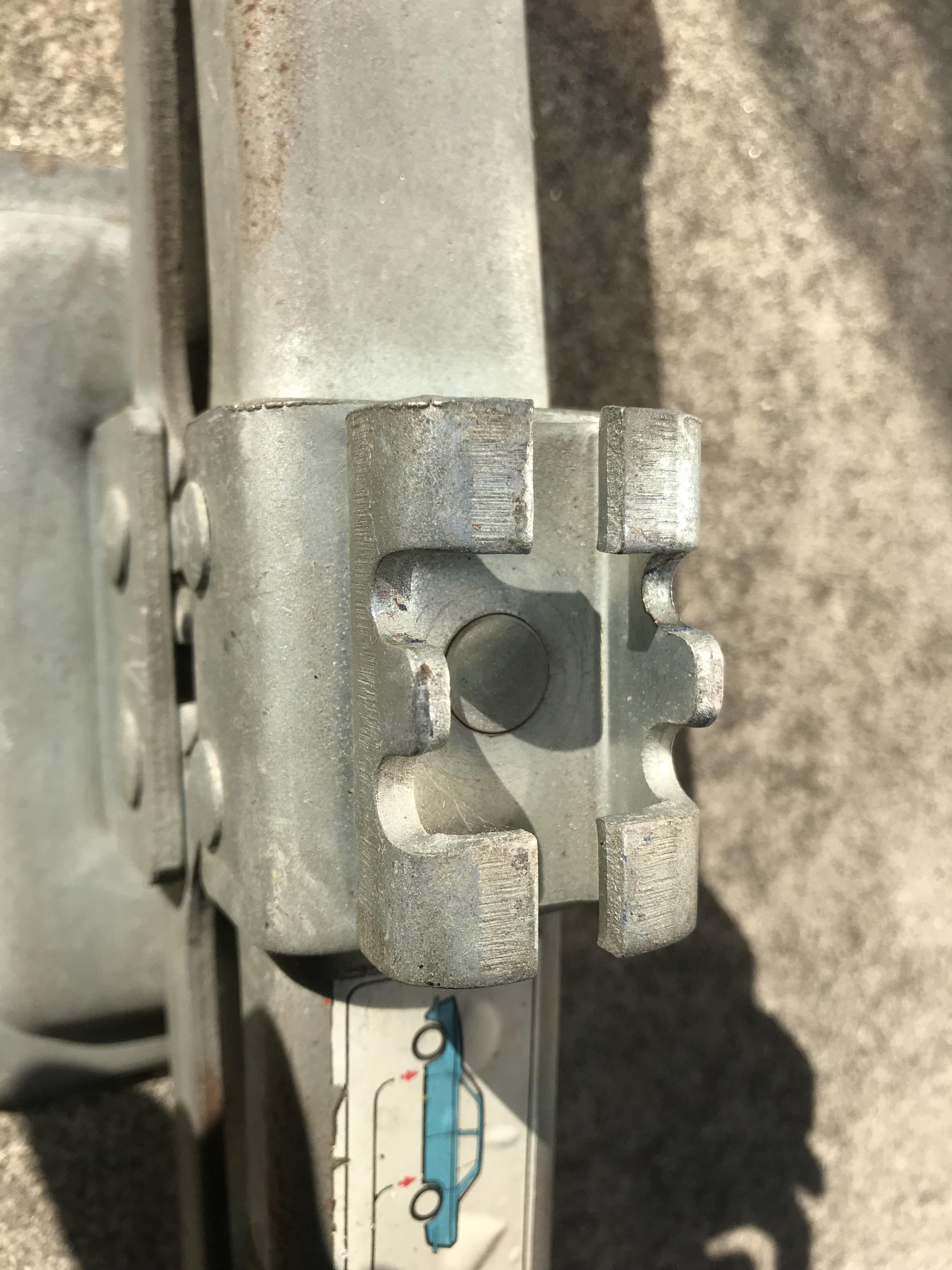

Somewhere around 1971 , jack has changed its comportments . Early one has unique contact piece and only two rivers applied to hold the basement while later ones has four .
If this is true,  ‘ A’  means 1954 . At that time
Nissan was making Datsun sports DC-3 .
I think this is one of the easiest way to guess when my car had left from the factory.
And it is nice to have ‘ munching numbers ‘
those factory items.
How about yours ?
Kats

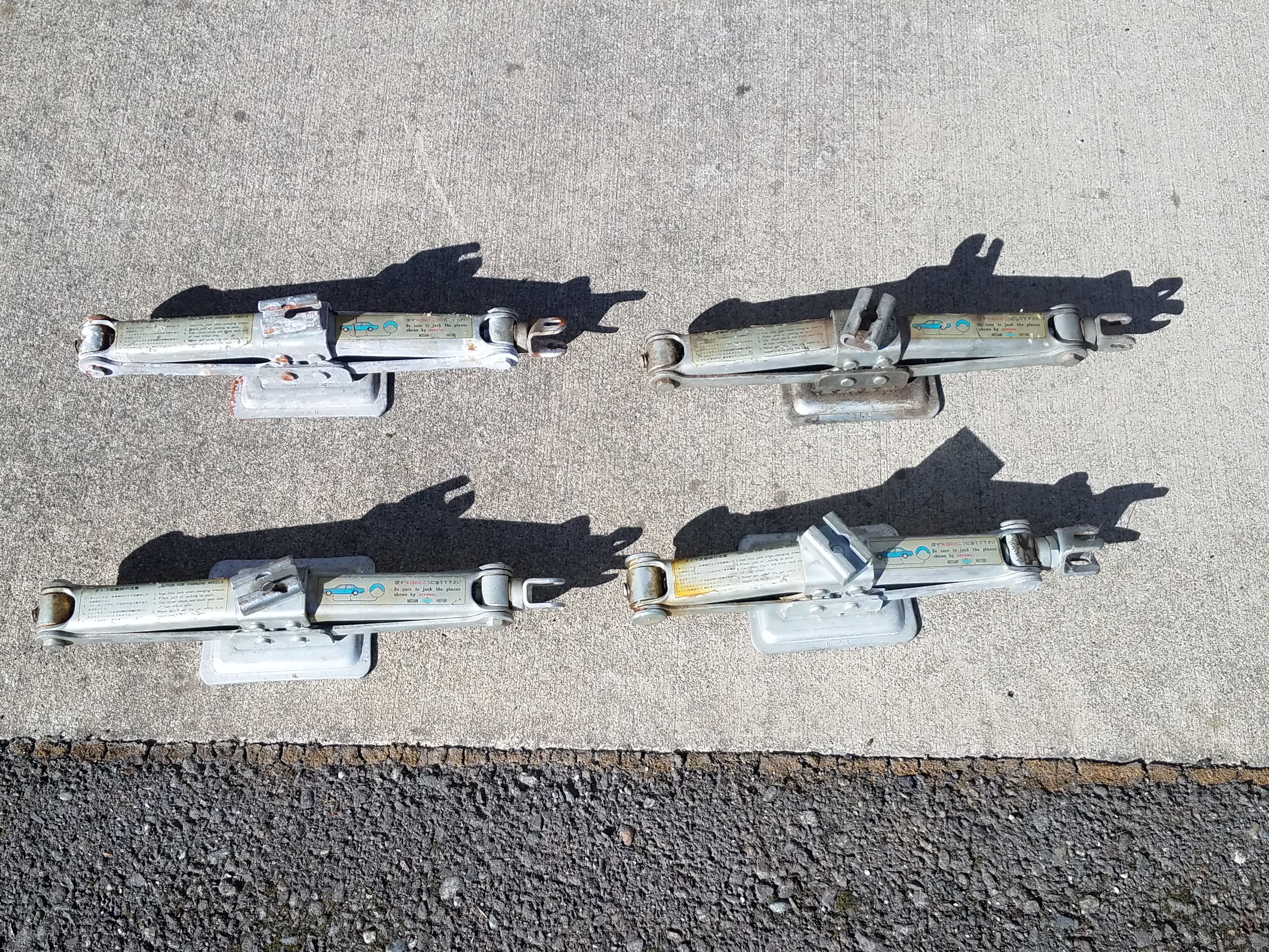

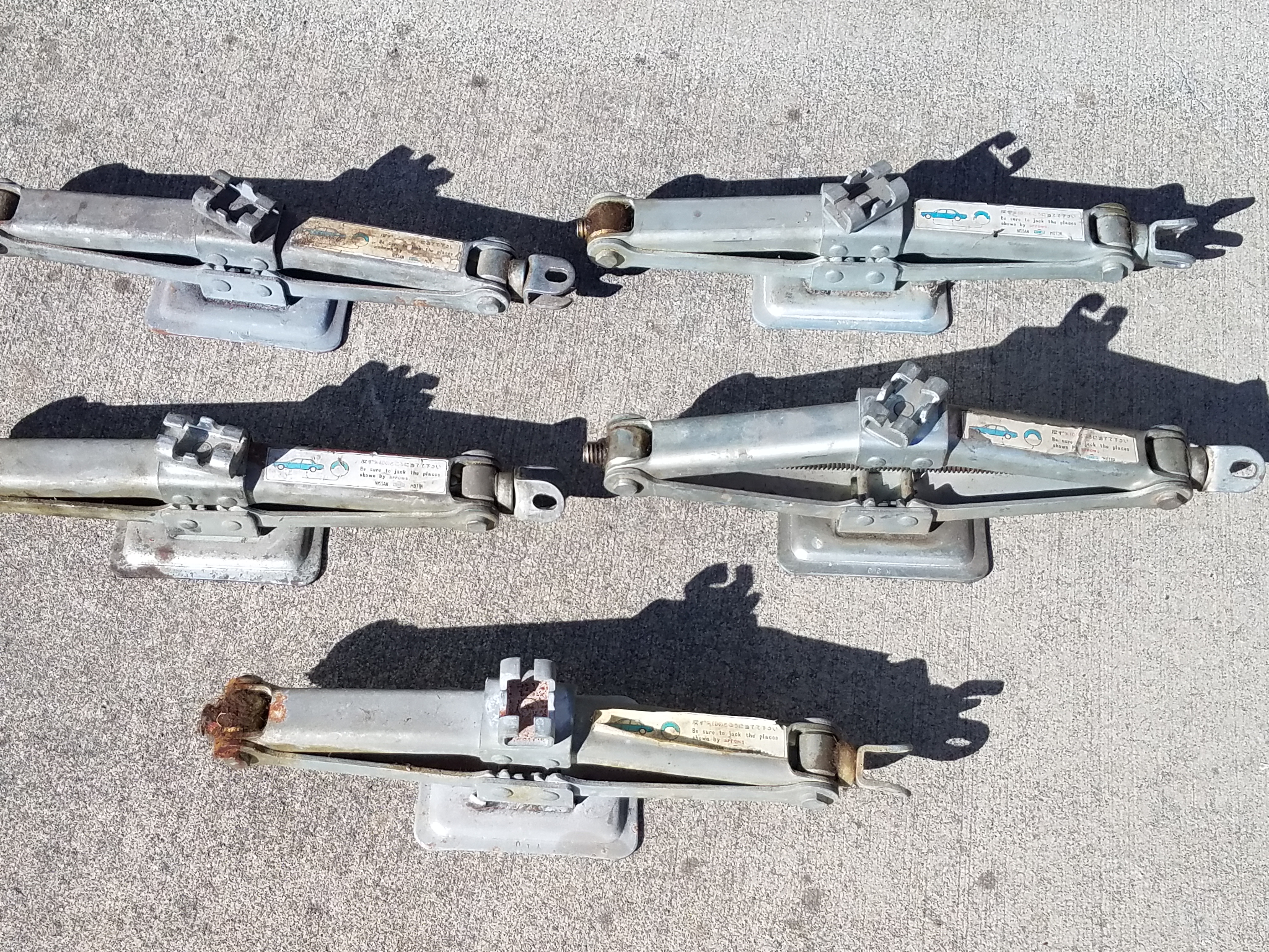

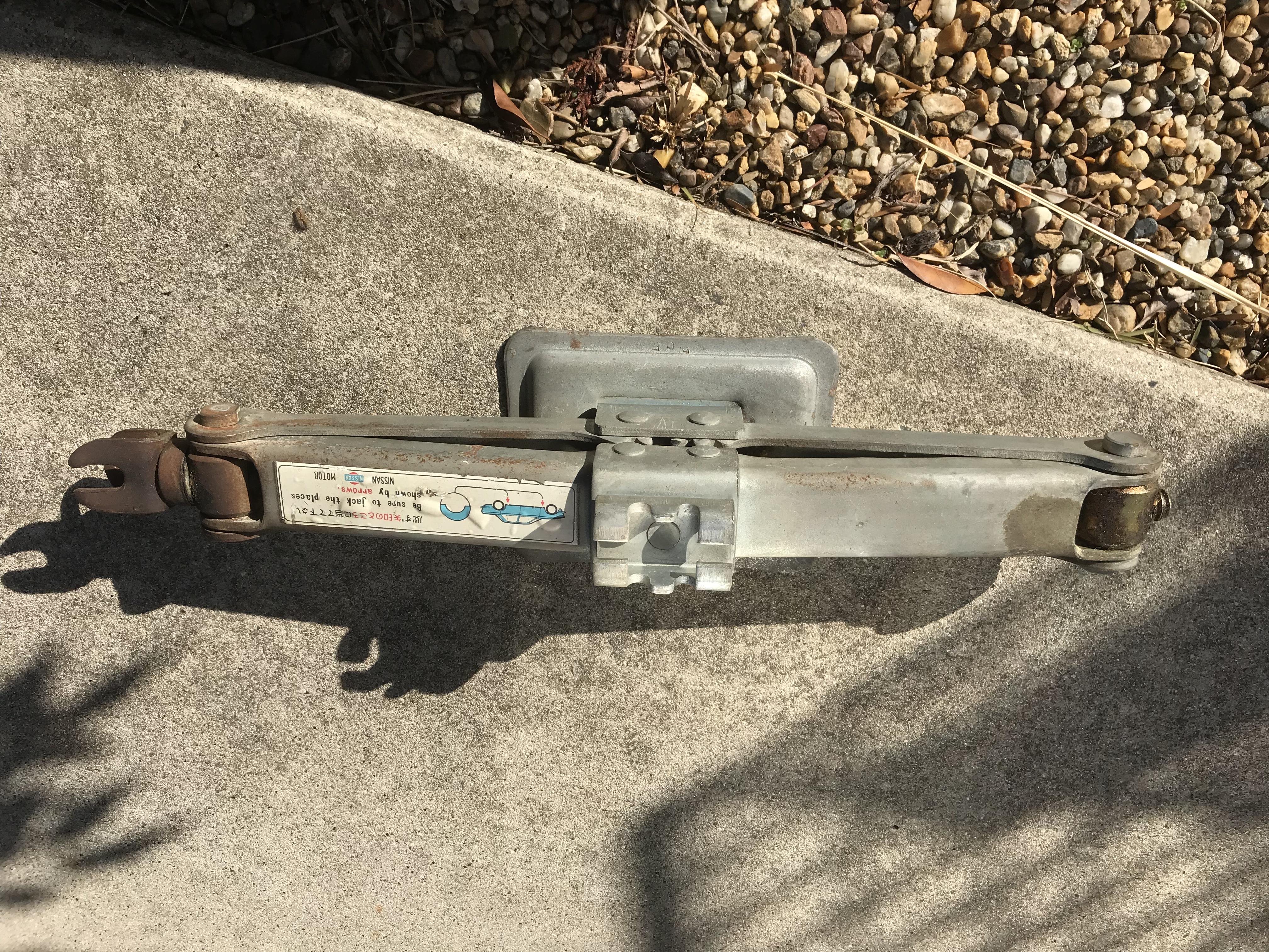

Ok Kats, this is what I have using your codes:
Jacks:

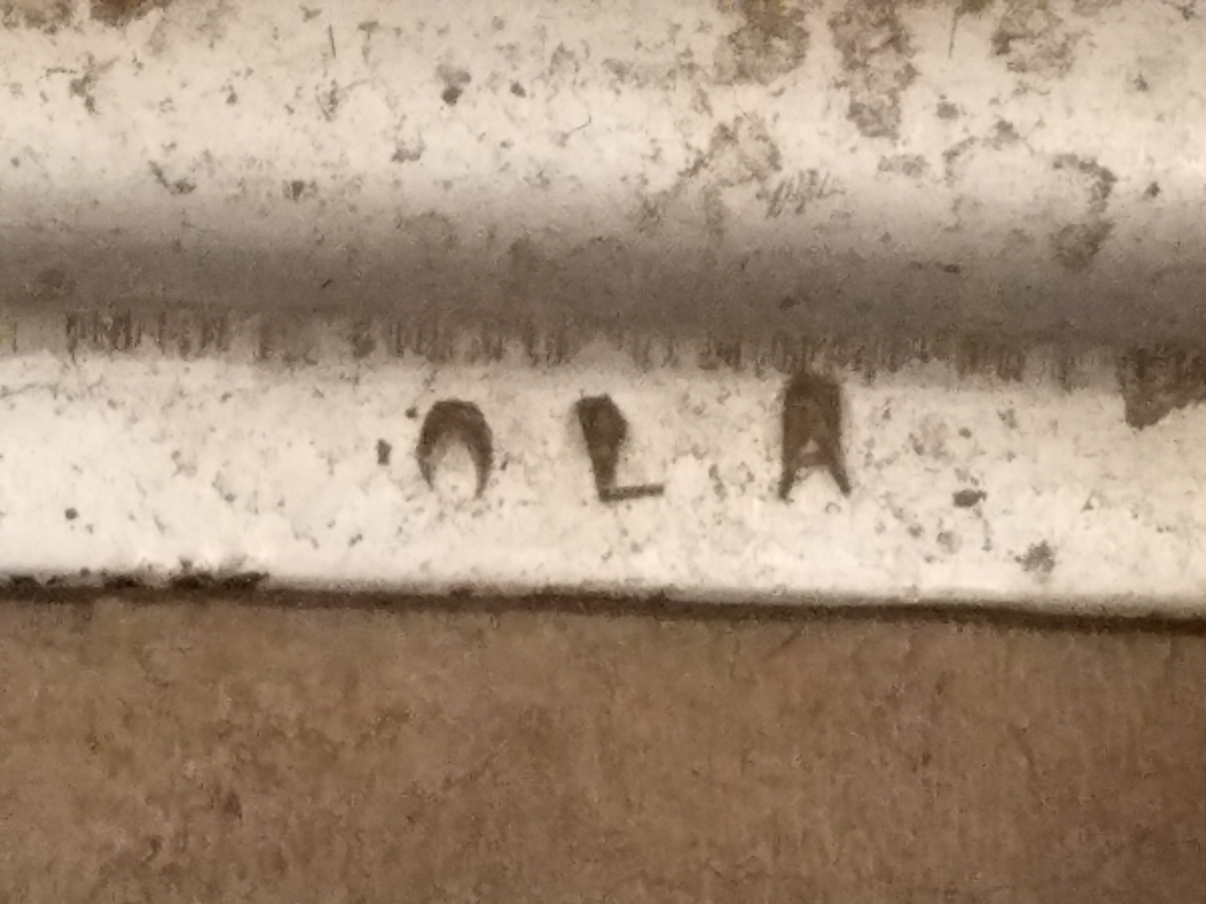

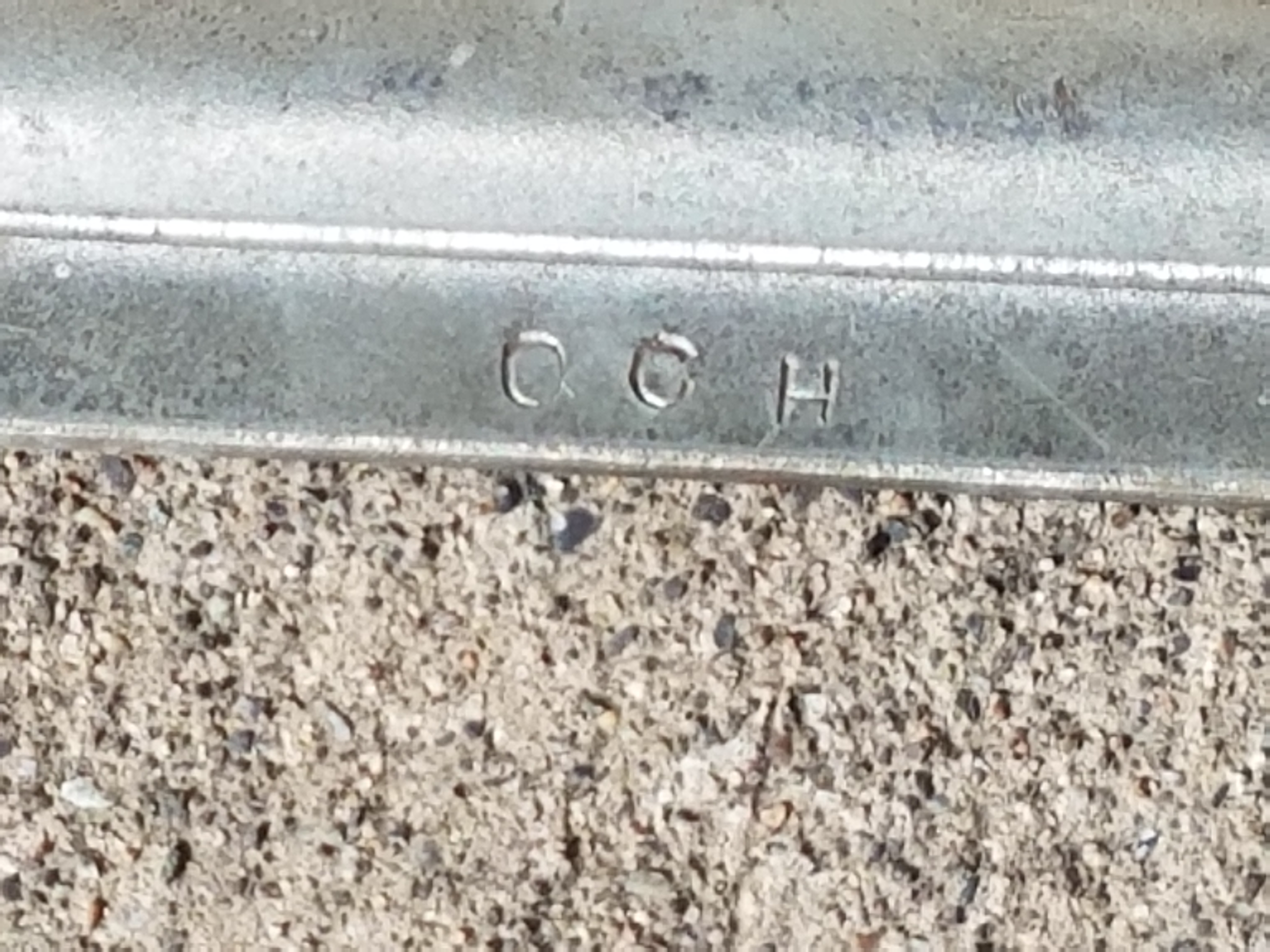

OCH - March 8, 1969

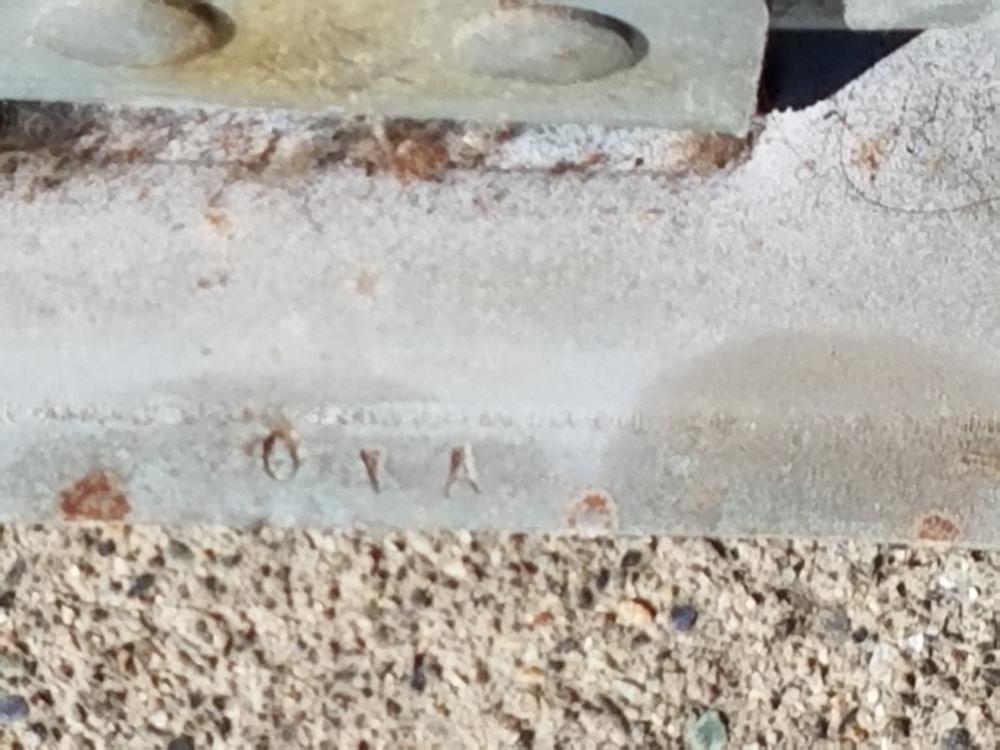

OIA - Sept 1, 1969
OKB - Nov 2, 1969
OLA - Dec 1, 1969
OLA? - Dec 1, 1969  (this one is difficult to read the 2nd and 3rd letters, so this is my best guess)

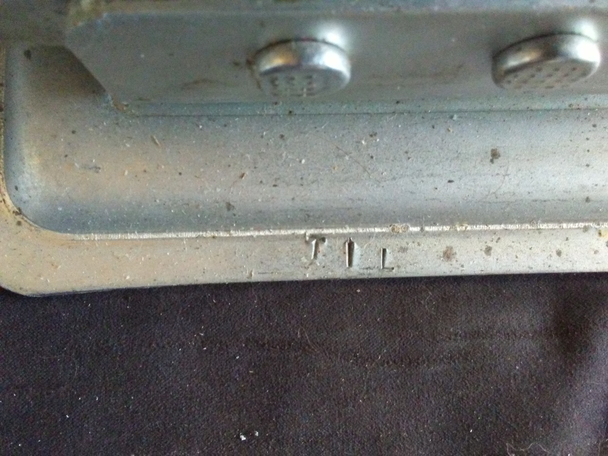

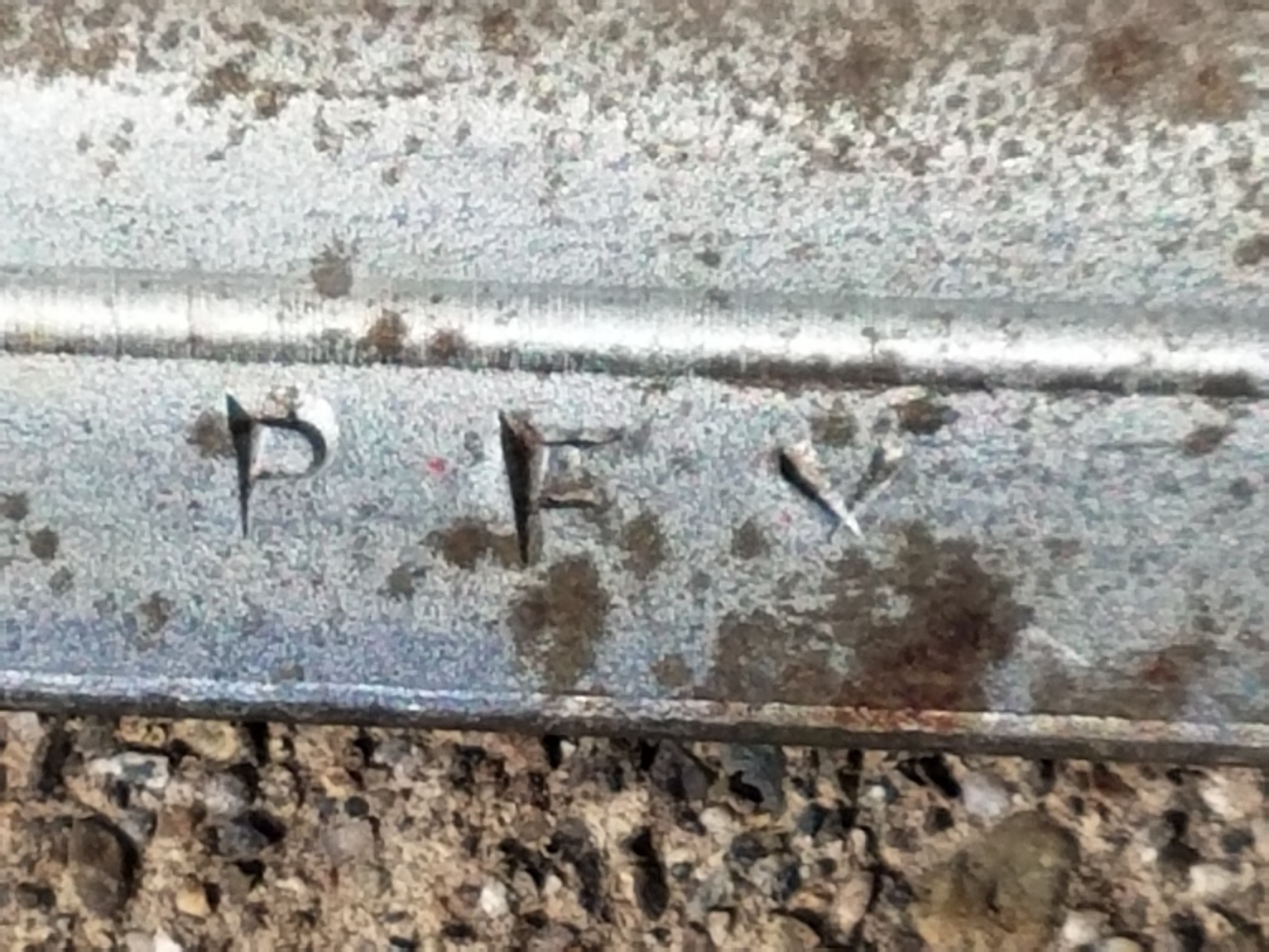

PFX - June 24, 1970

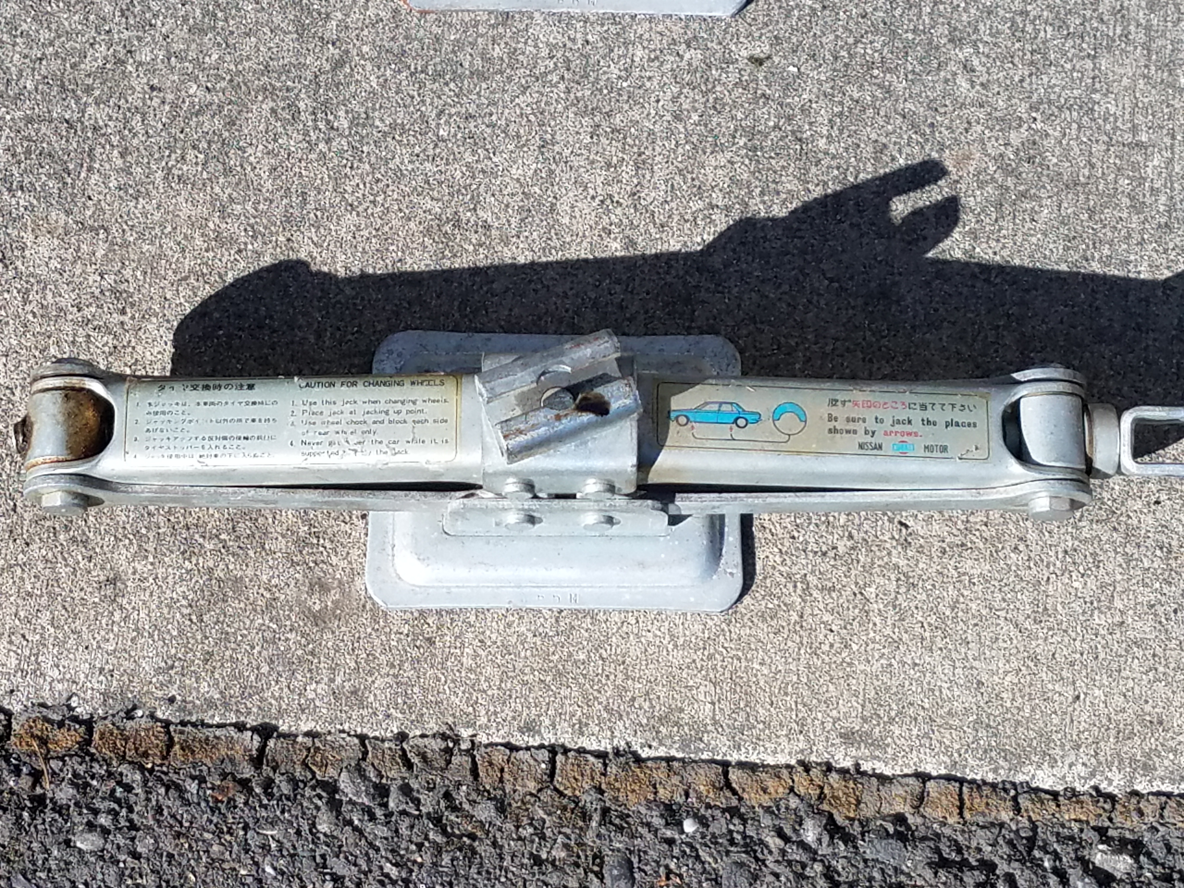

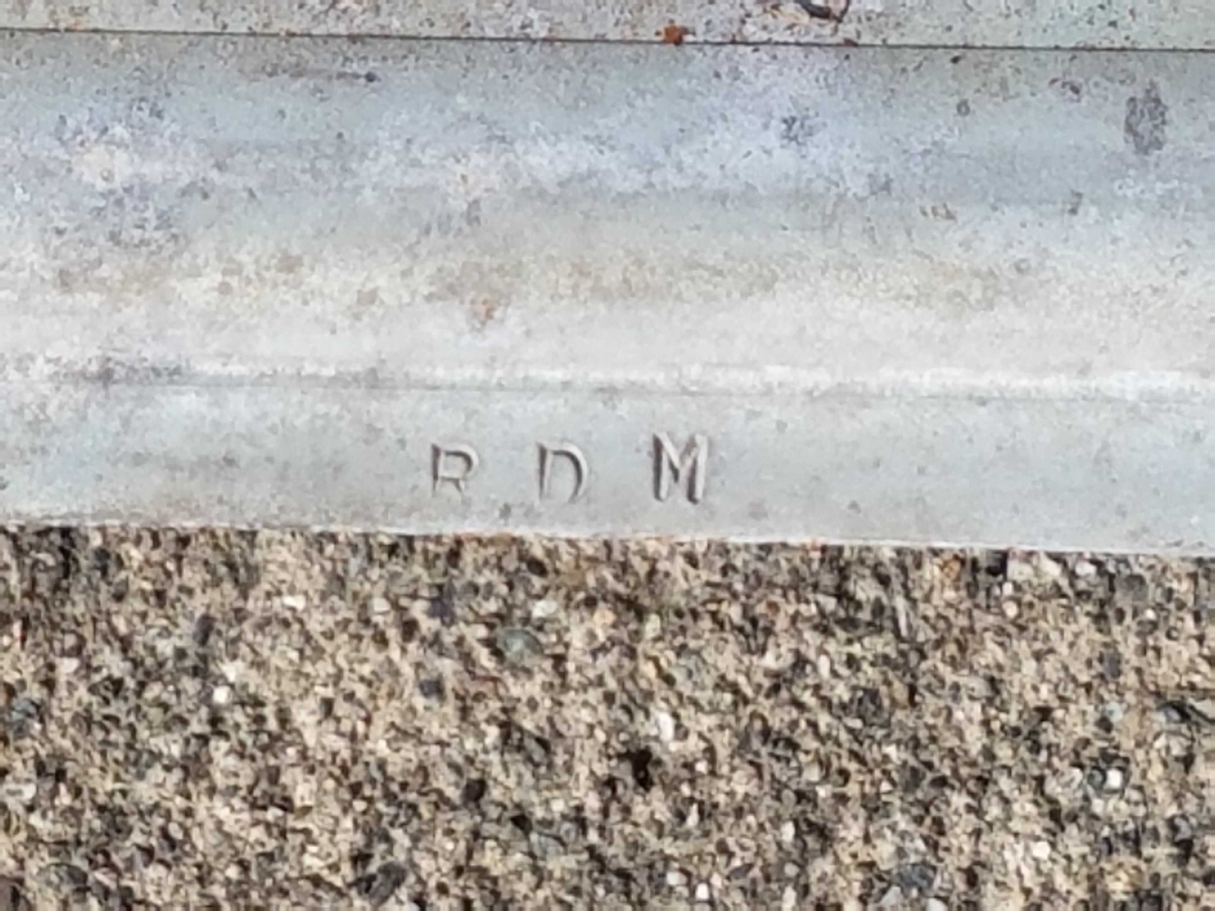

RDM - April 13, 1972
RDN - April 14, 1972

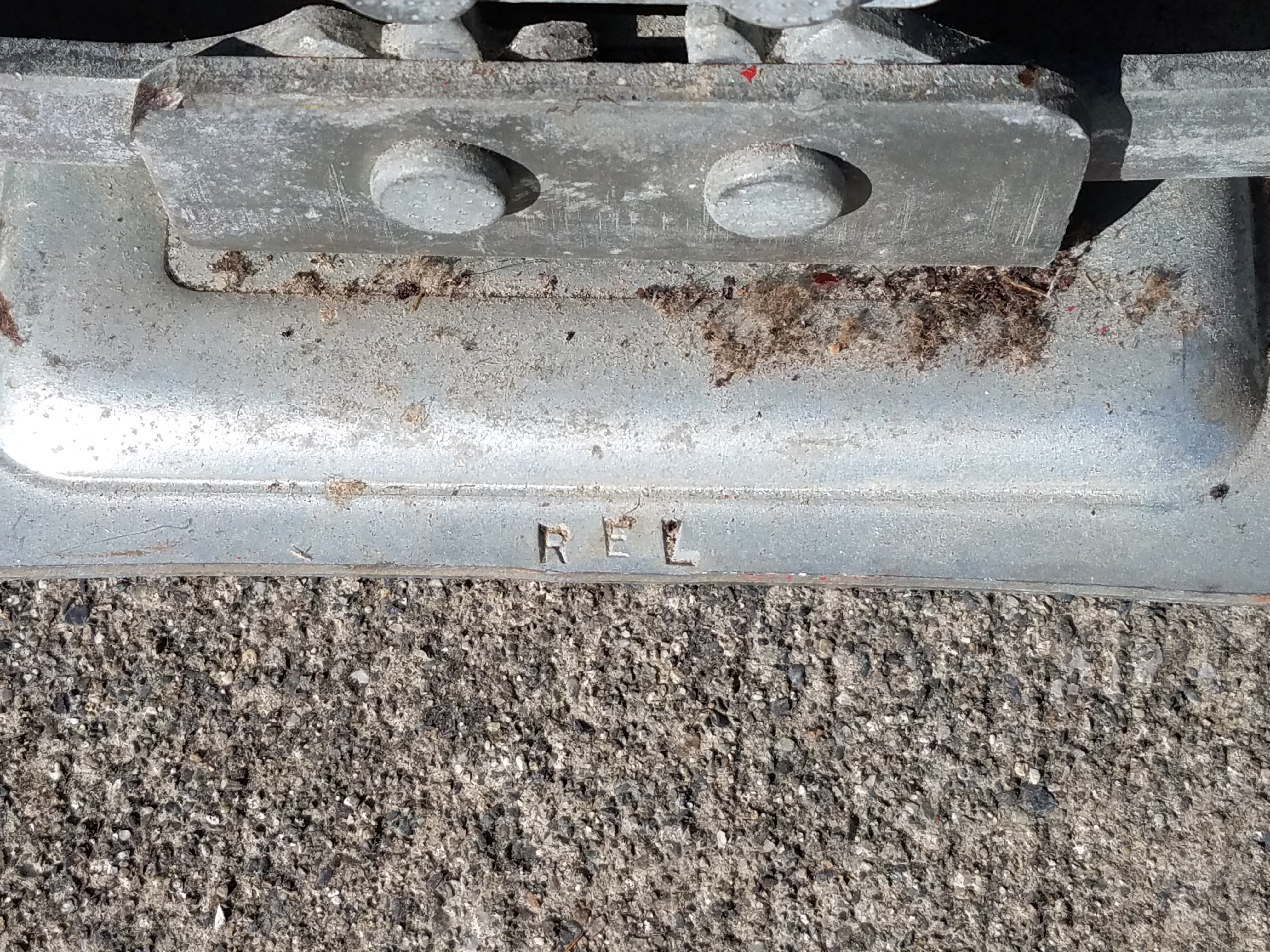

REL - May 12, 1972

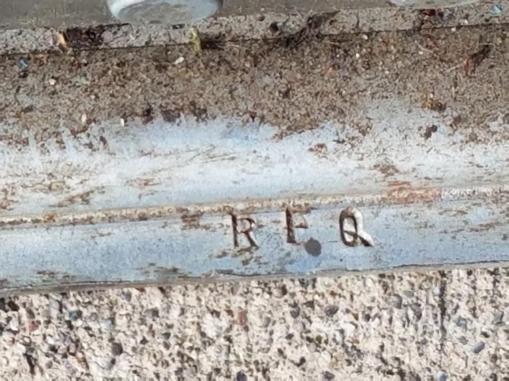

RFQ - June 17, 1972

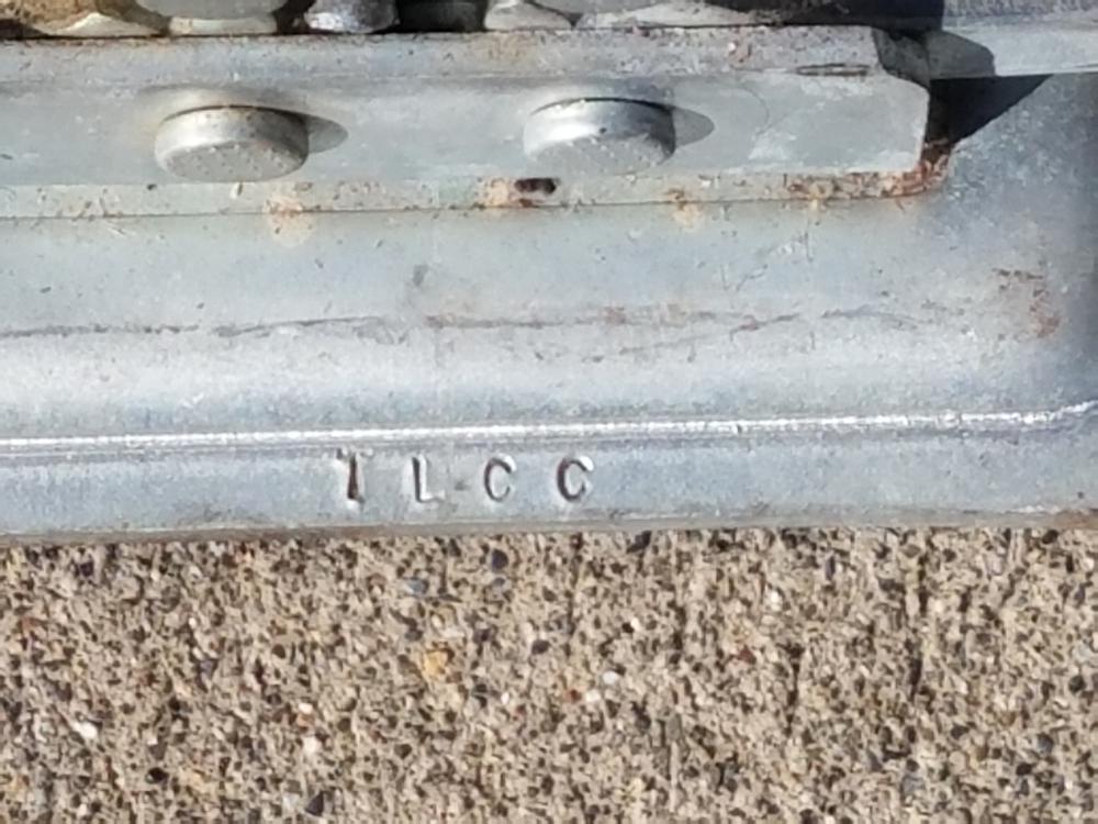

TLCC - Dec ??, 1974

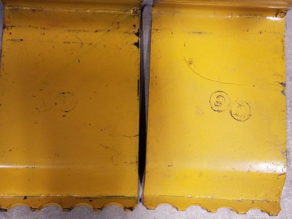

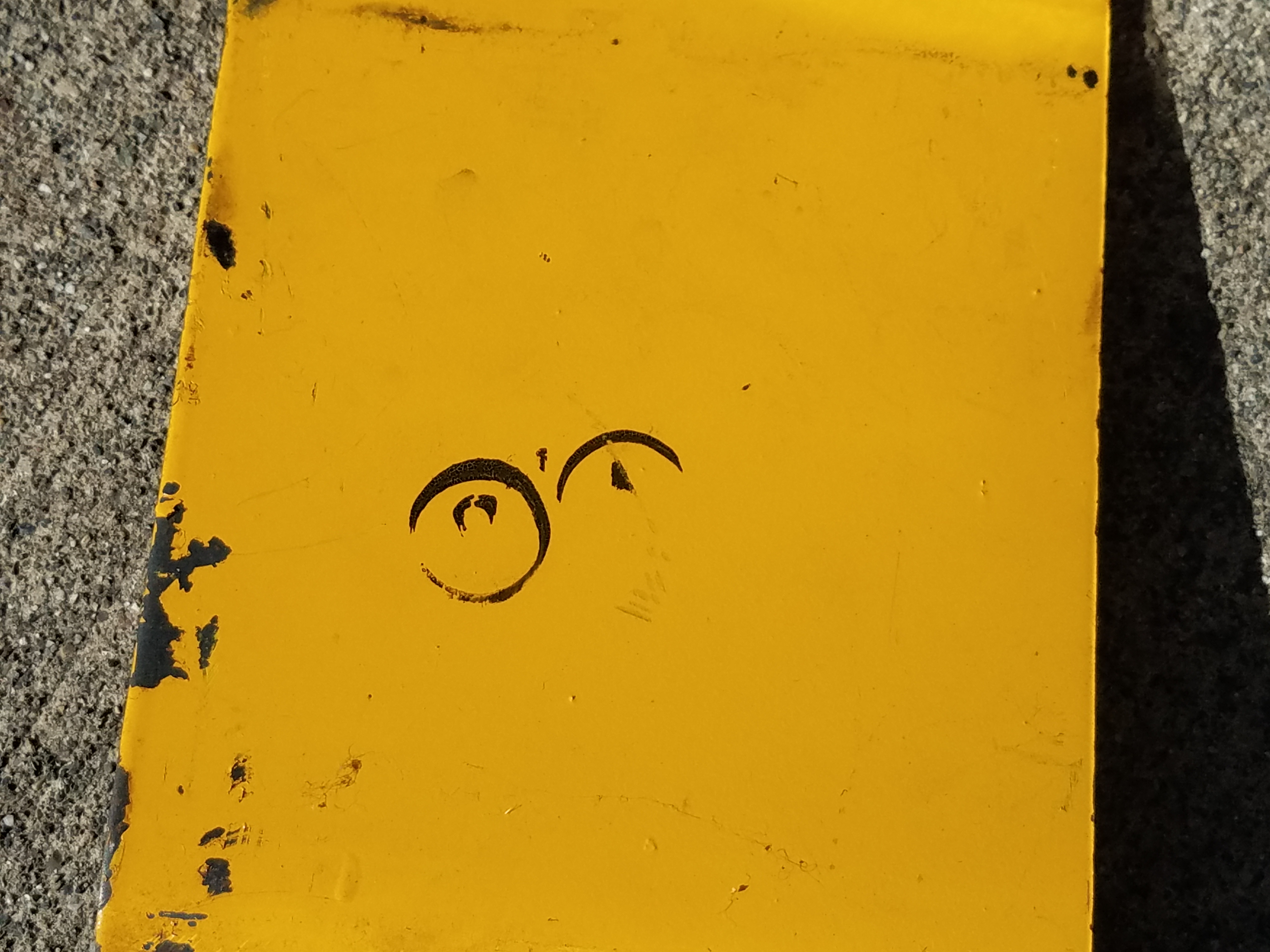

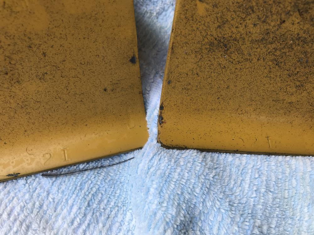

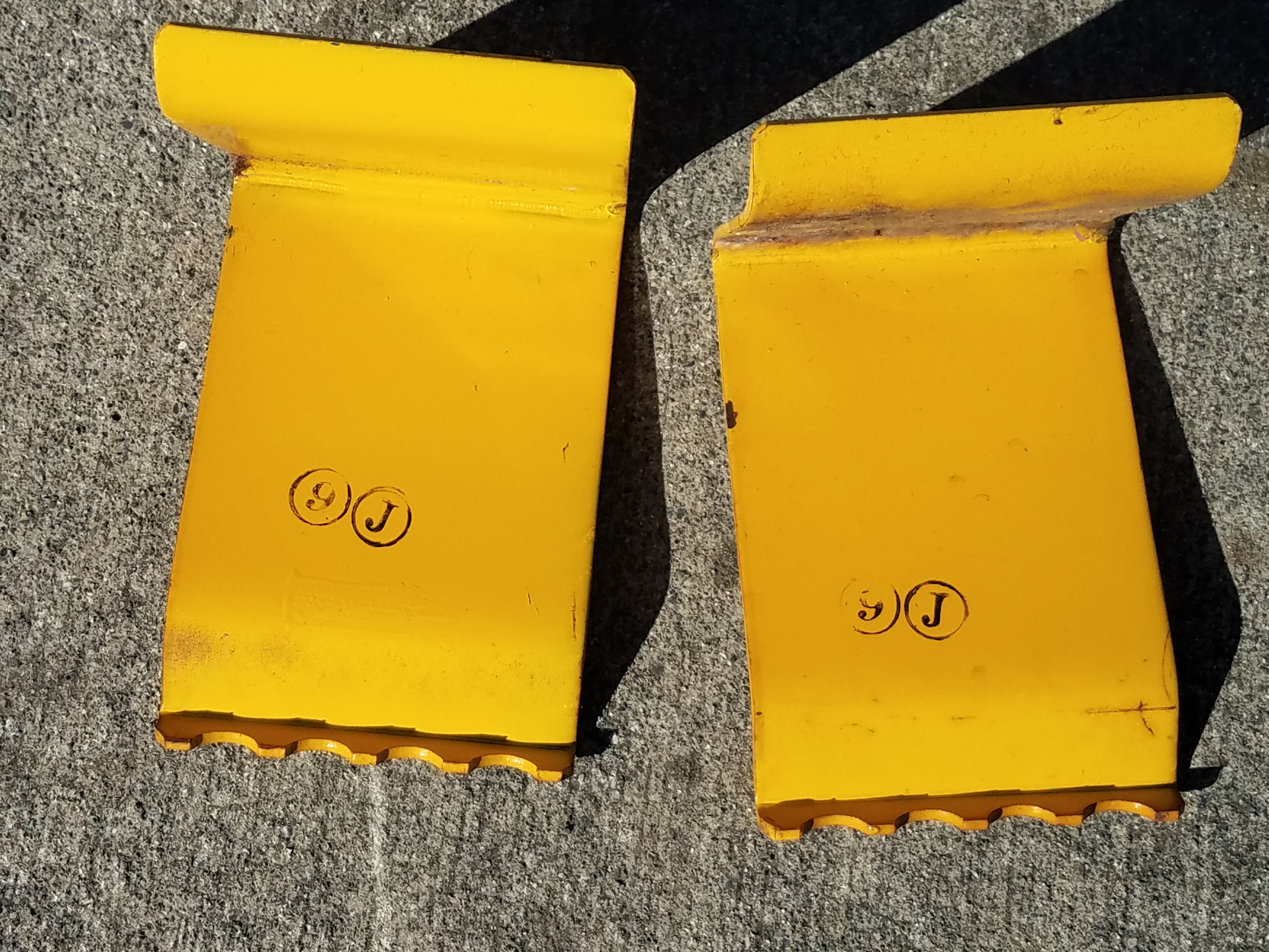

Wheel chocks:  Note I was looking for only for the black ink stamps not the punched letters .  I only have a couple with the black ink stamps, so will have to look for punched letters the next time I go to my garage
9J - Dec 1969
9L - Oct 1969

Rubber stamps on the wheel chokes are so cool , they are 1969 pieces !

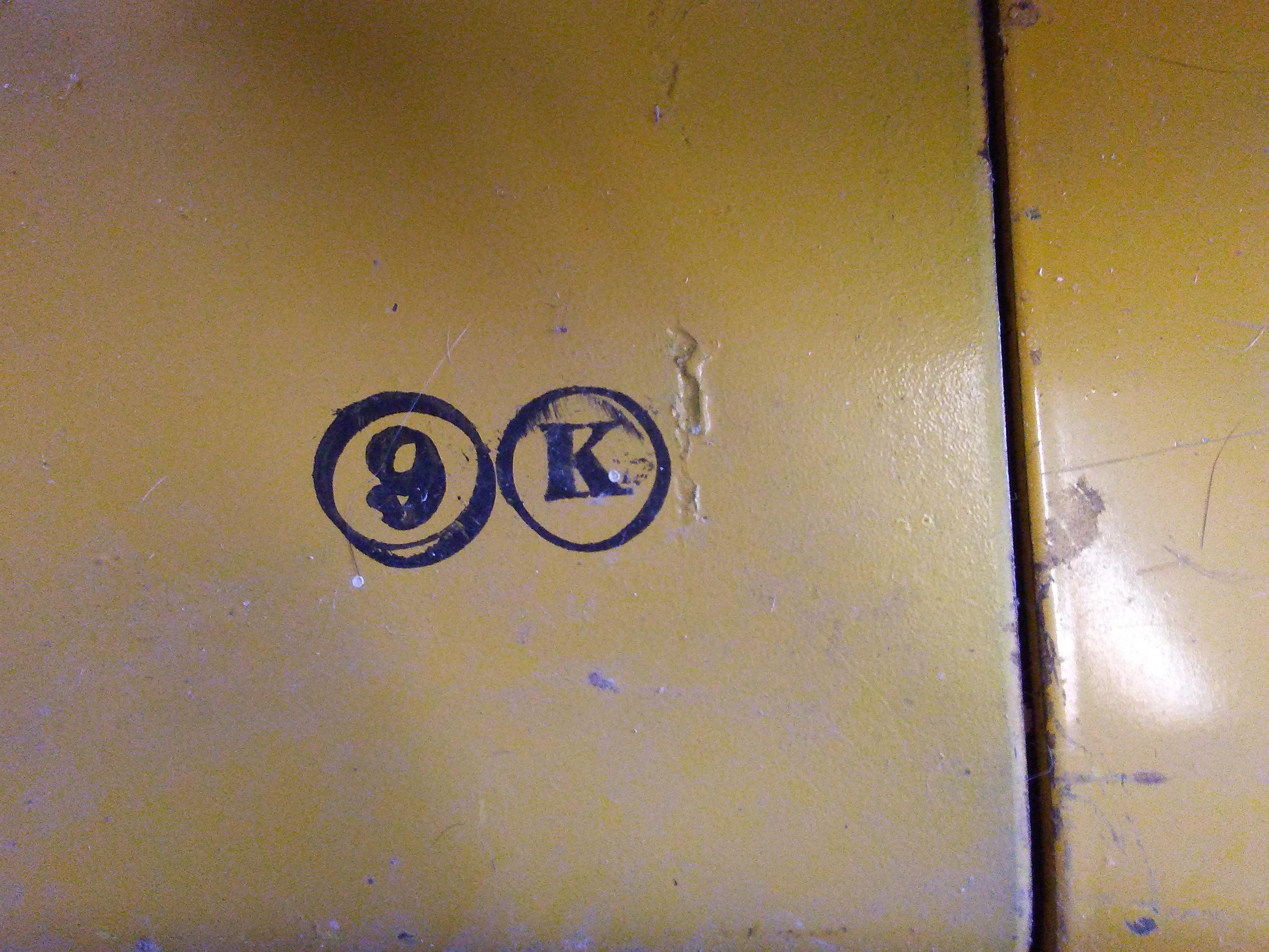

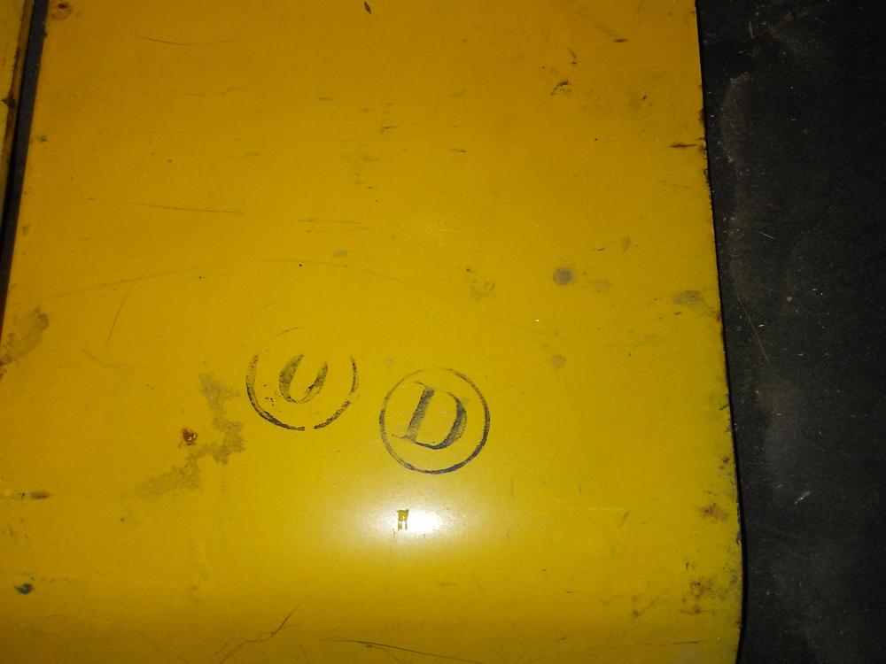

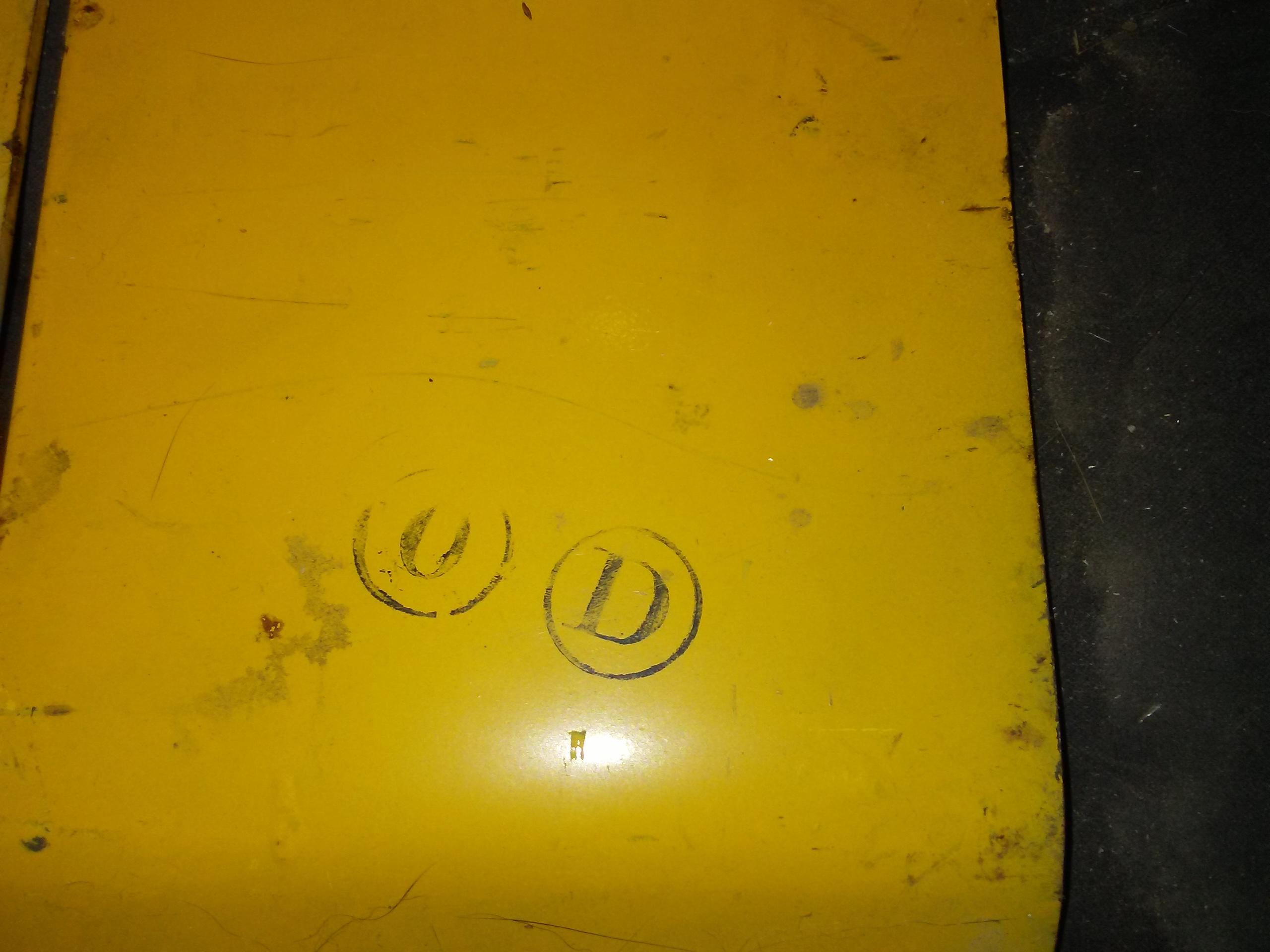

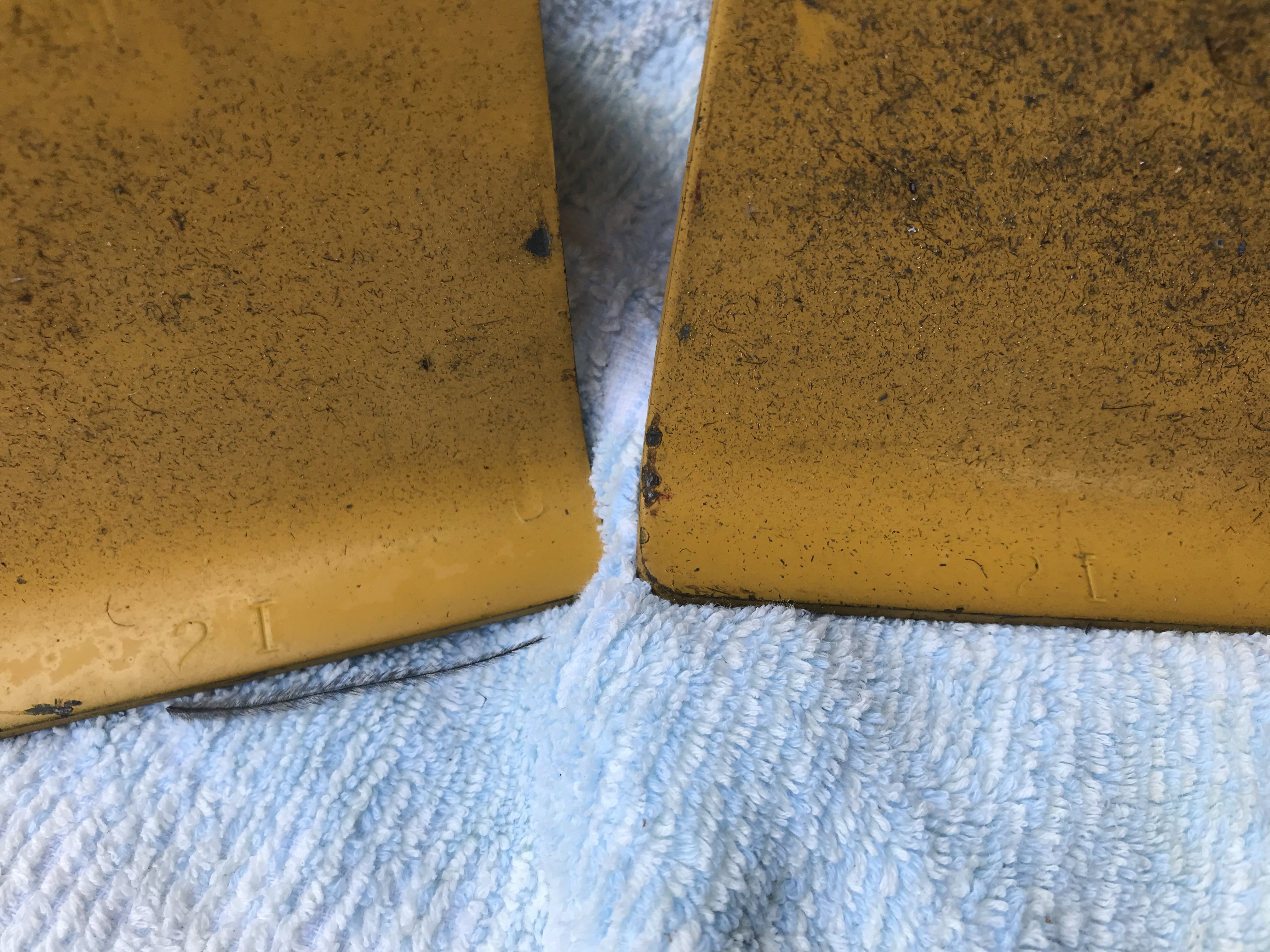

Finally pulled out my wheel chocks from storage.
Here's what I found in the 2 sets that I remembered having. :ermm:
9K and OD   neither have punched markings

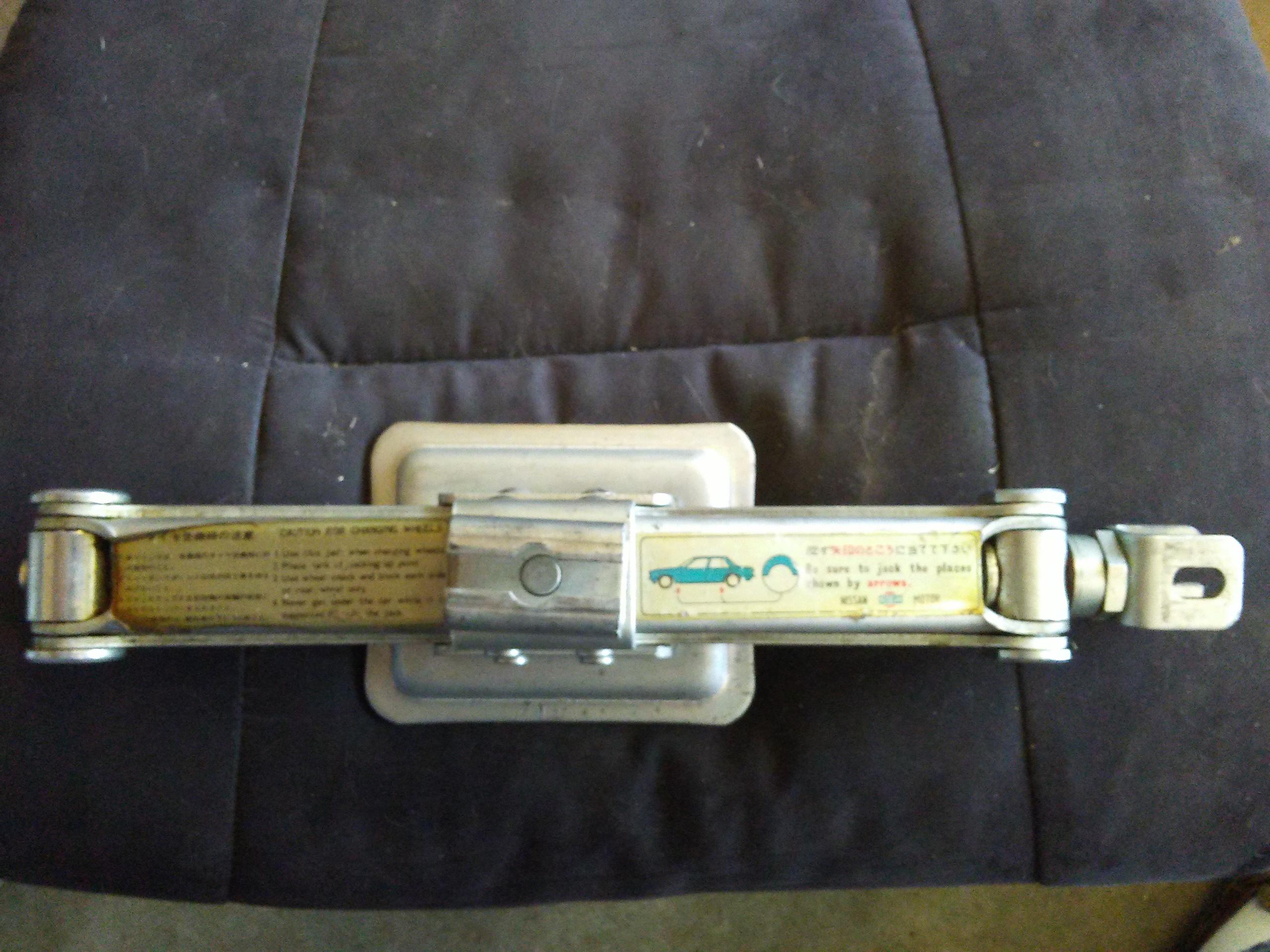

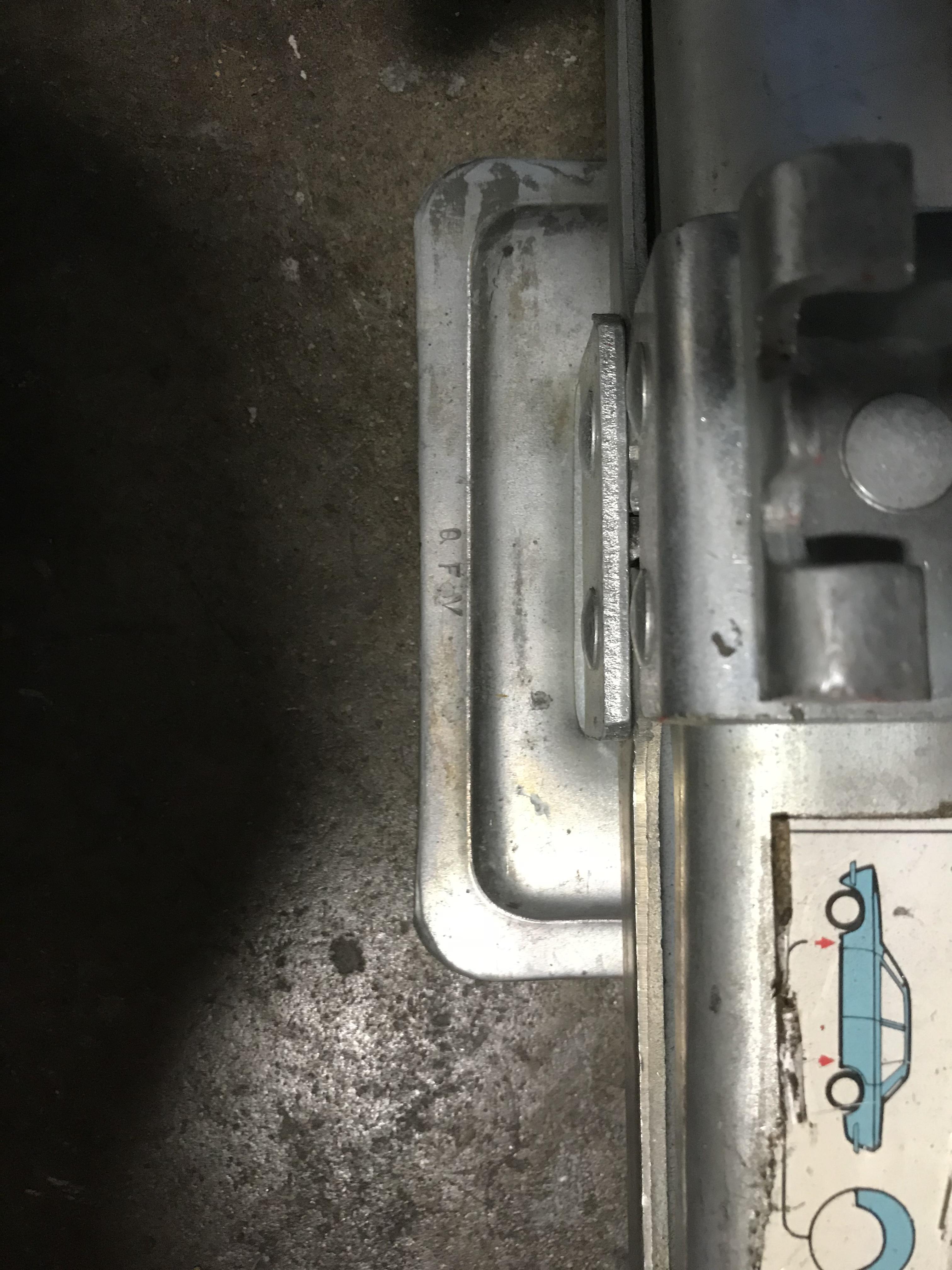

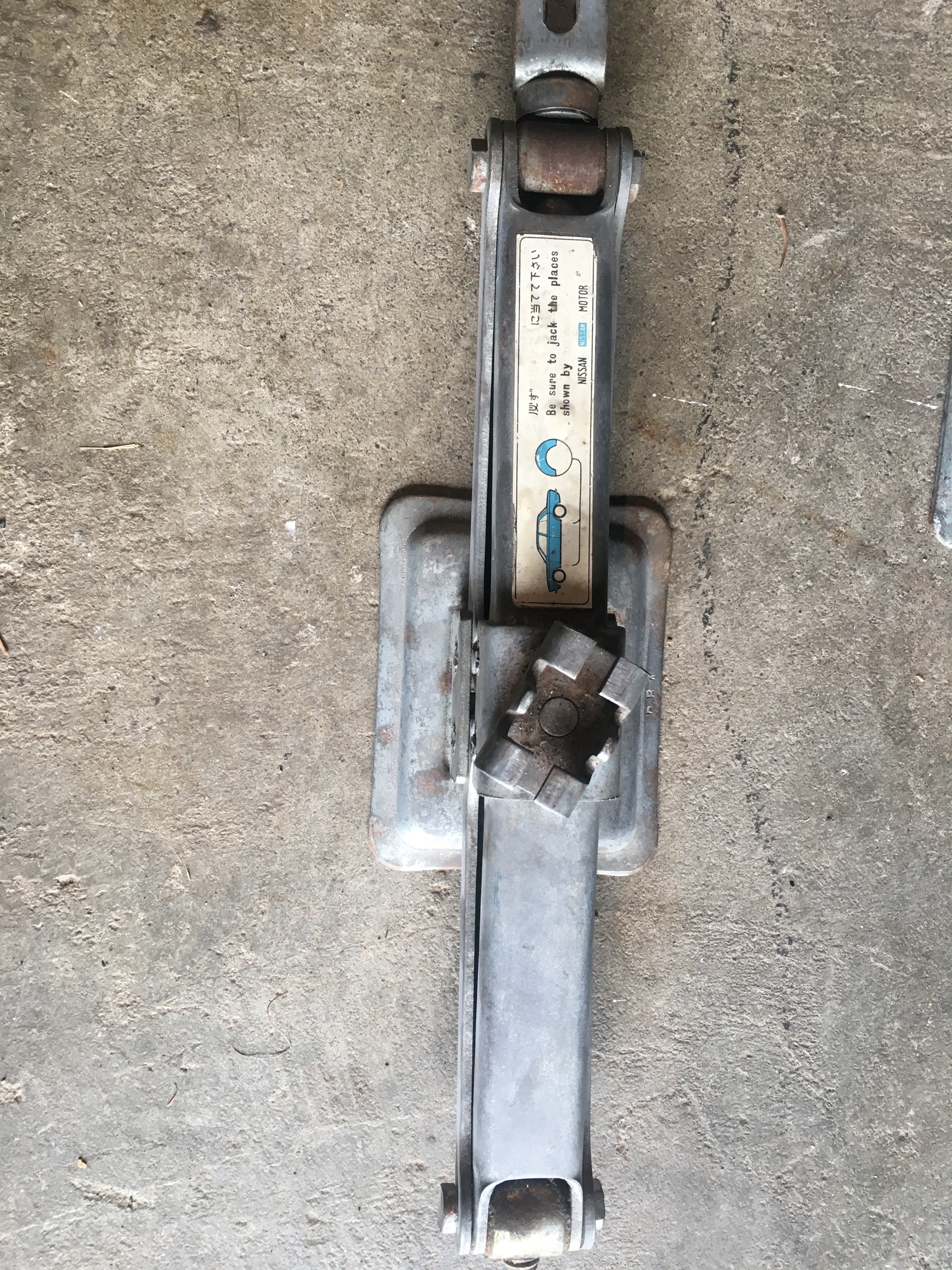

Found one jack.Still looking for the other jacks------buried in a box somewhere-------

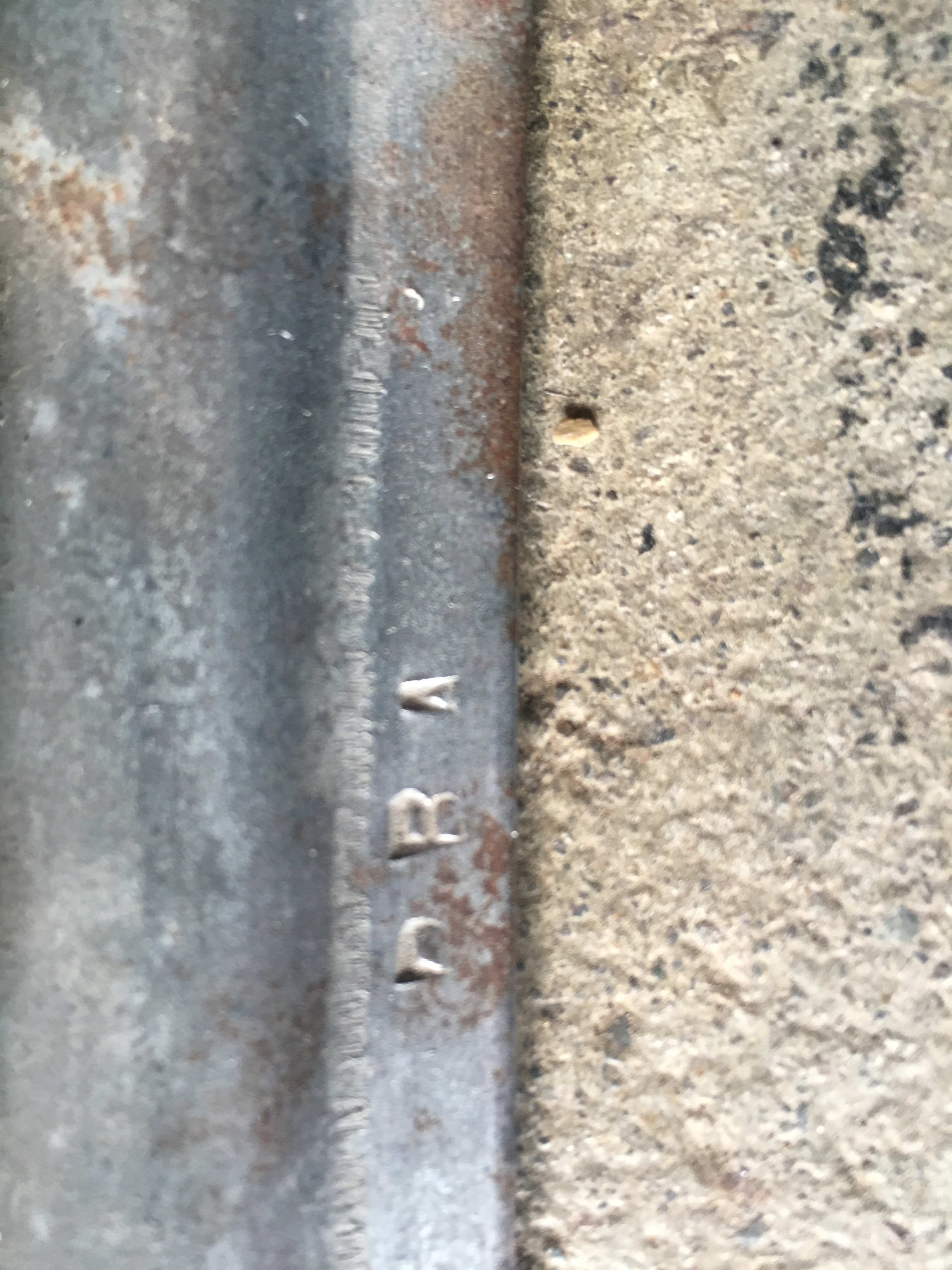

My jack is stamped S D X, which is April 24 1973 if I'm doing the decode correctly.
My car build date is 12/70 and I know that the engine was swapped to a '73 sometime before I bought it.  So it looks like the jack helps date the engine, if it came from the same car.

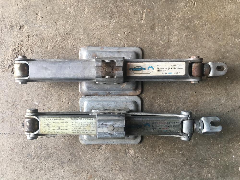

Interesting thread @kats I have a pair of wheel stops  0 B and a set of O D
The jack in my 70 was a newer one R 1 T
I also have a jack from a 3/70 which I can't make out the letters.
An interesting observation is the two are different lengths. I was going to swap out my newer jack for the older and it would not fit.

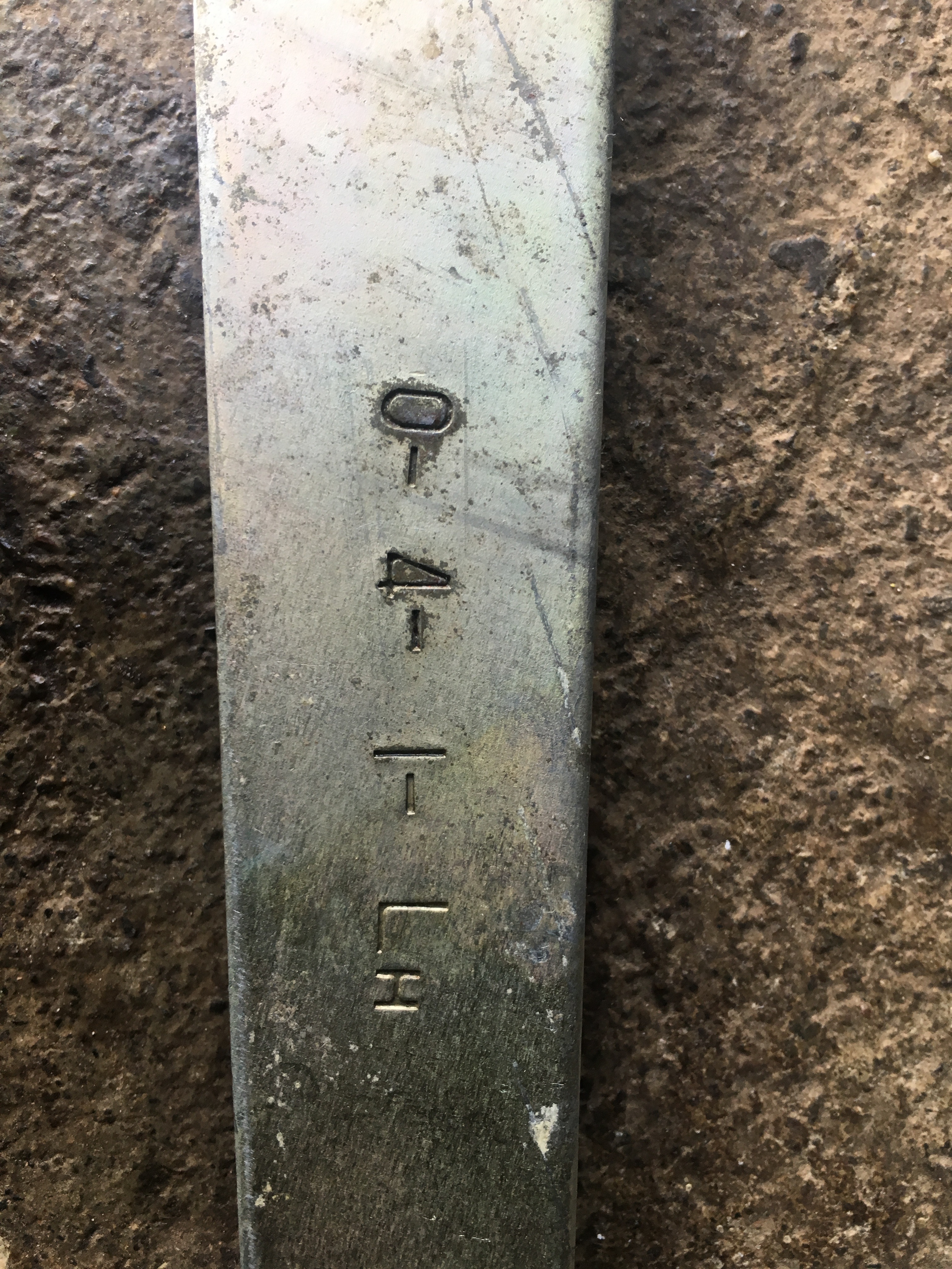

Also I was working on my window regulator today and saw it had a date stamp as well  0 4 I

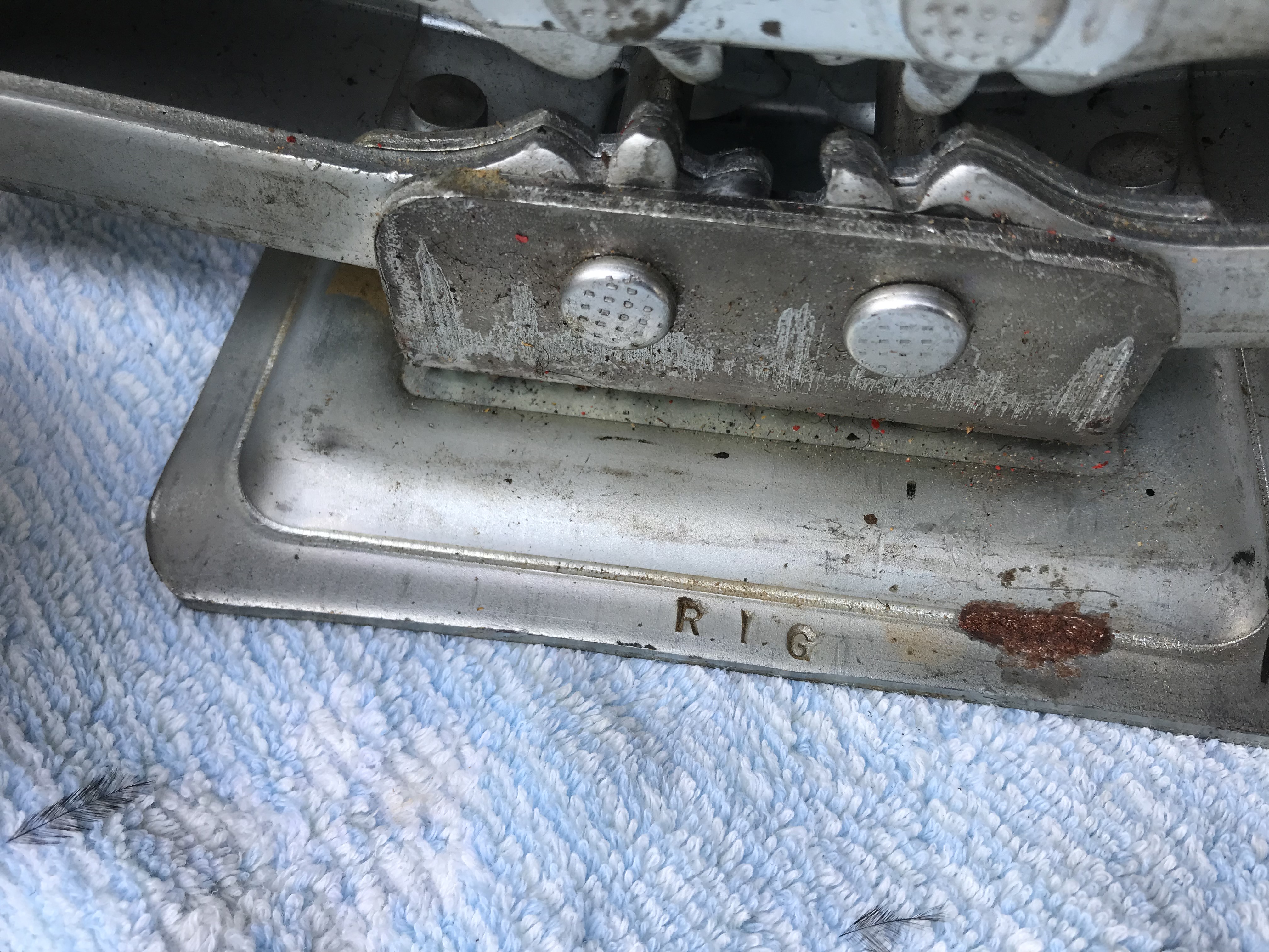

My friend Mr. Shimoura has a super clean genuine Fairlady 240 ZG  (9/ 1972),
we checked her pockets and there you go, matching numbers jack and choke !
You can see R. I. G. on the jack, “1972 September 7th “
And 2. I. on the choke, “1972. September “
Please note the seat, from September 1972, interior materials were changed to “ flame retardant” , this made the seats looked slightly different from former design and shape.
Kats

Does anyone can sell his/her a set of 9K or 9L or 0A choke ?
I am asking this for my Jan 1970 Z432.
I found my Z432 has 0G which is Jul 1970.

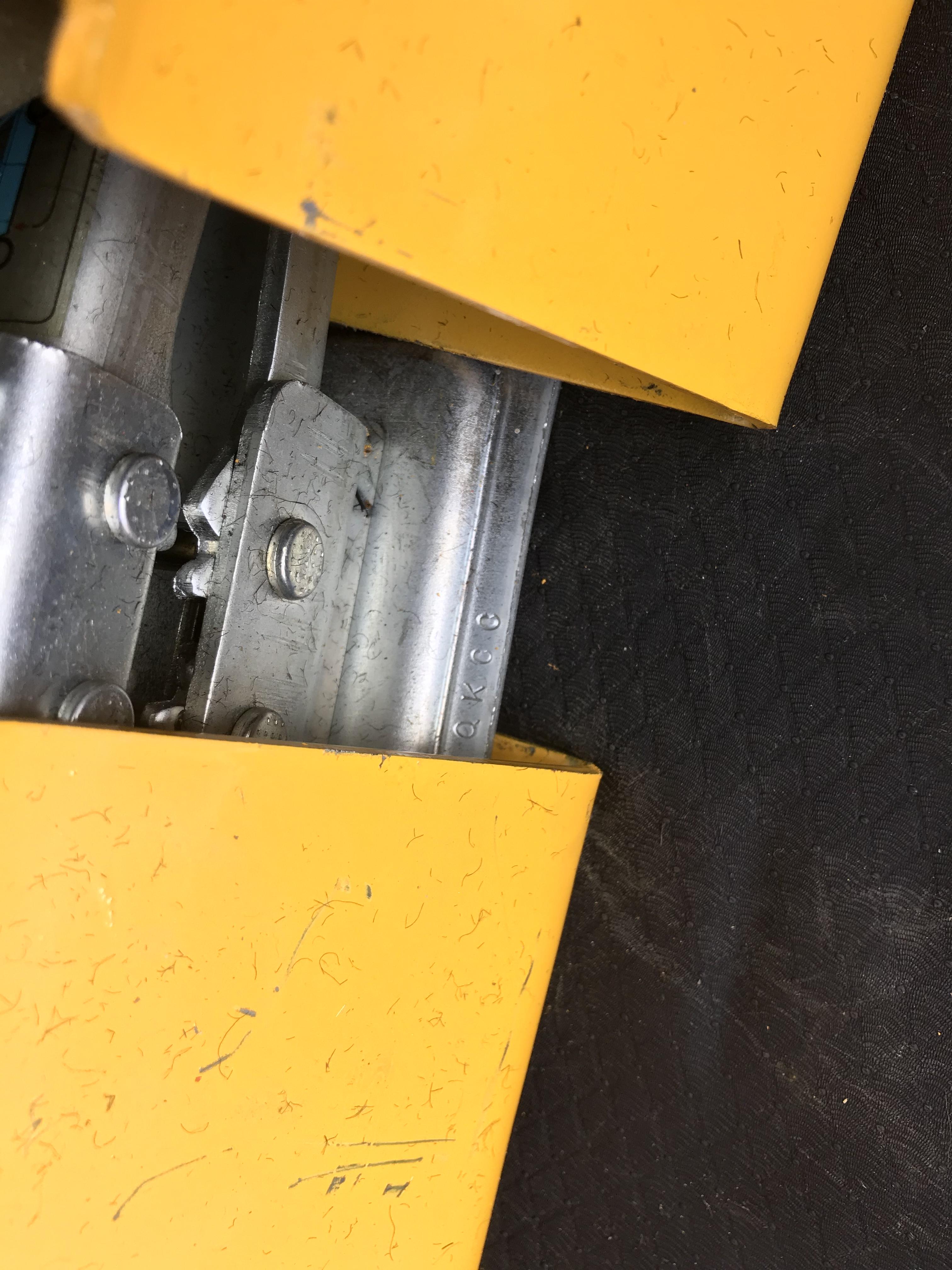

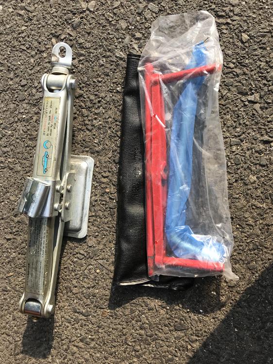

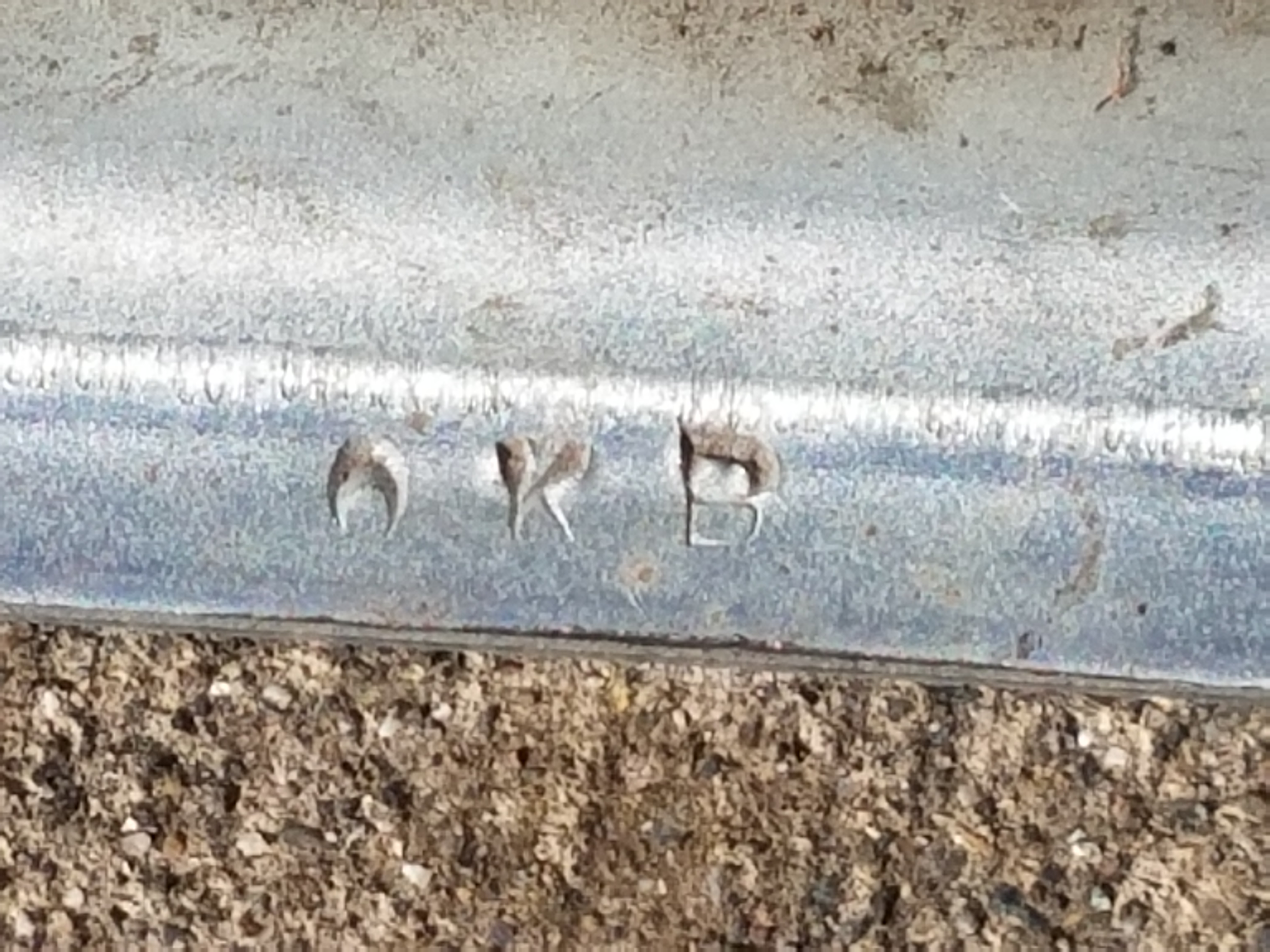

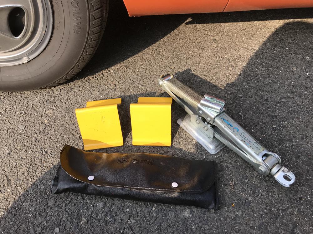

Hi !

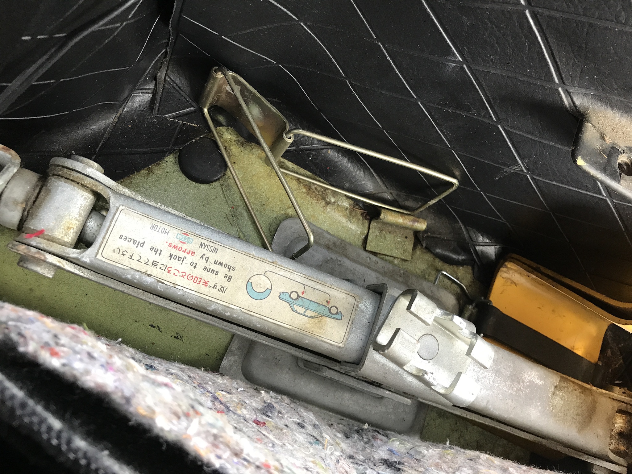

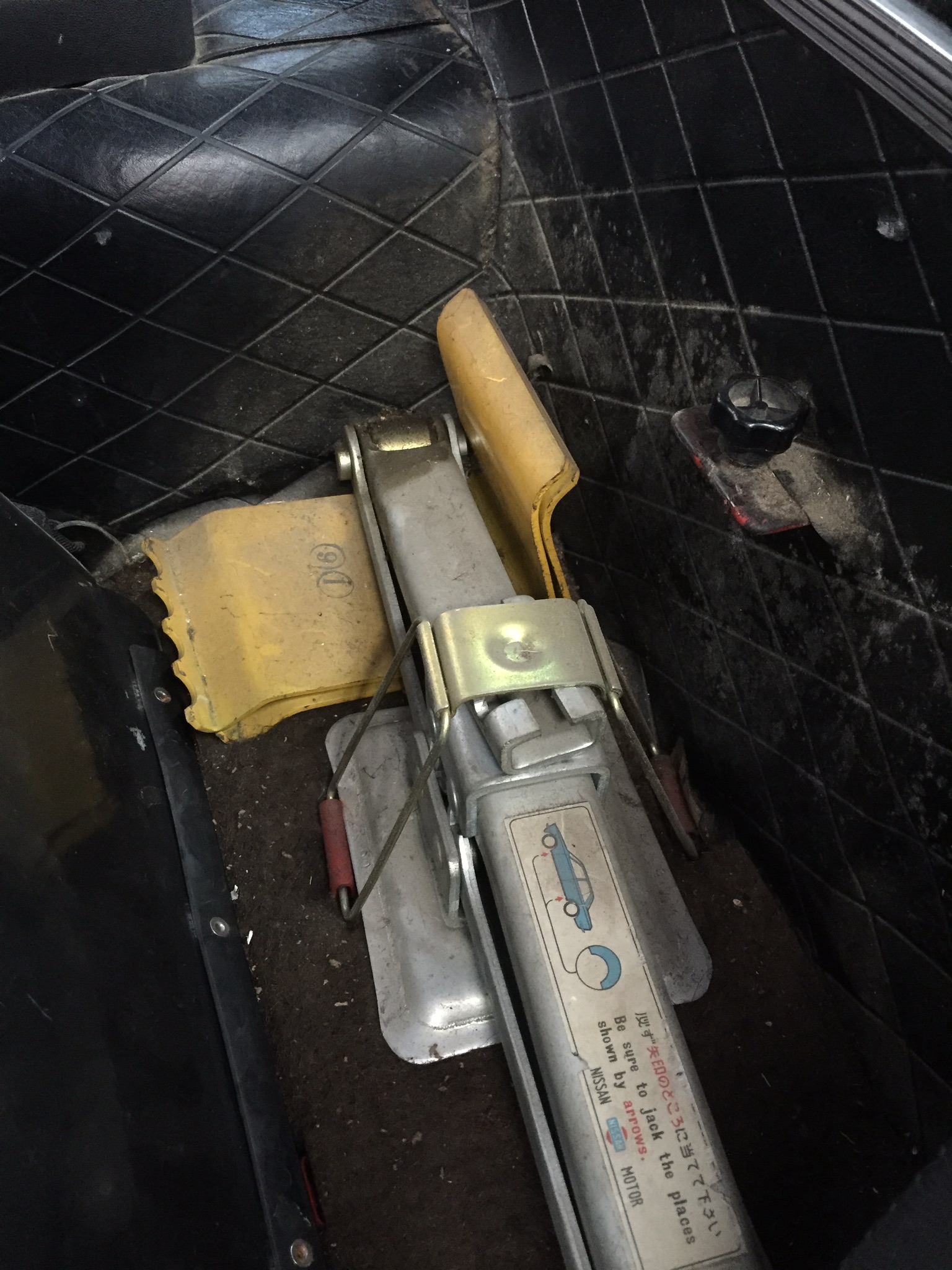

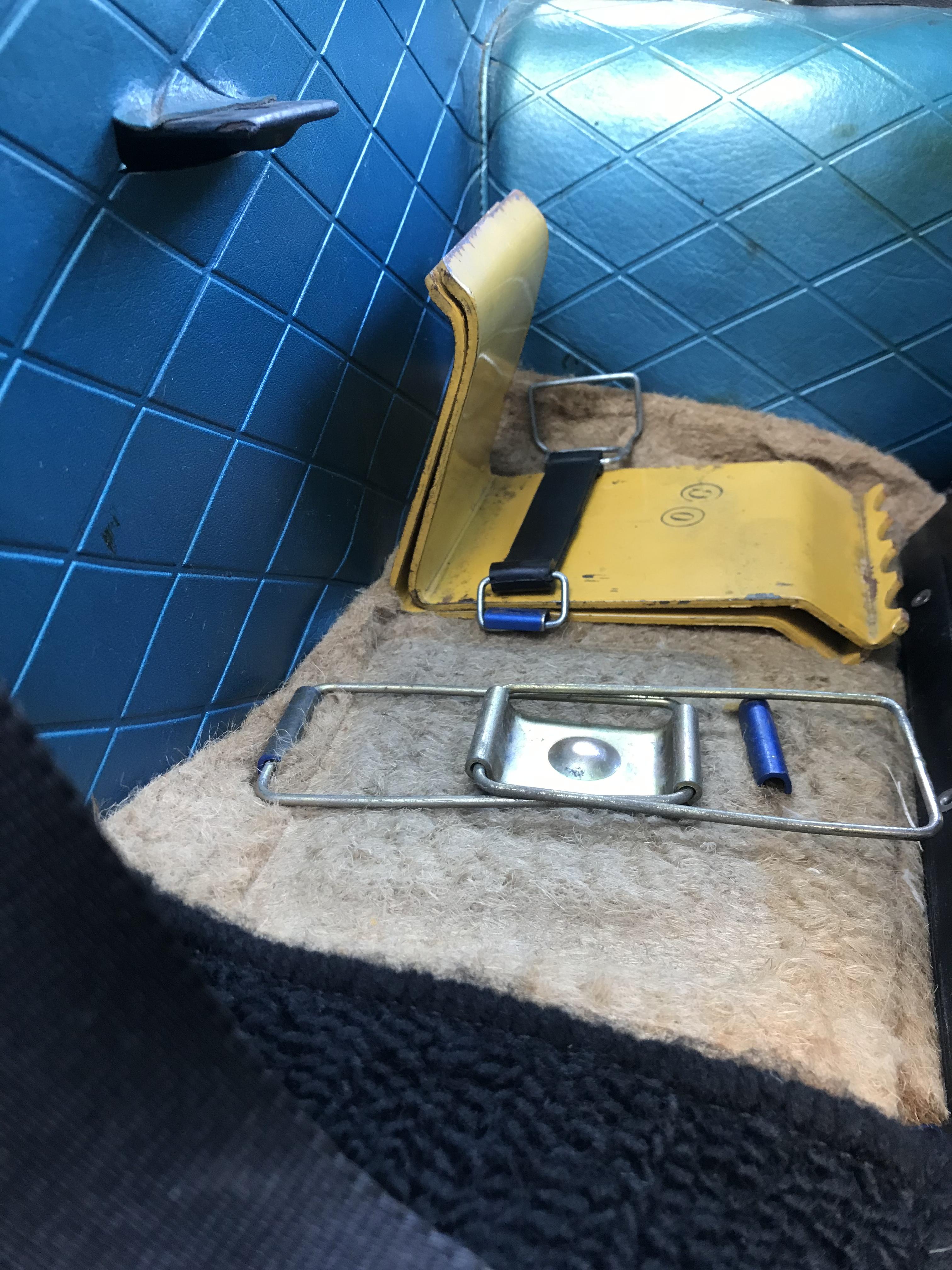

Here is my Dec 1971 240Z, I am now very for sure our decoding is correct,
The tire chockes “ 1 K “ (71 Nov)
The jack “ Q. K. C. C “ (. 71 Nov 29th )

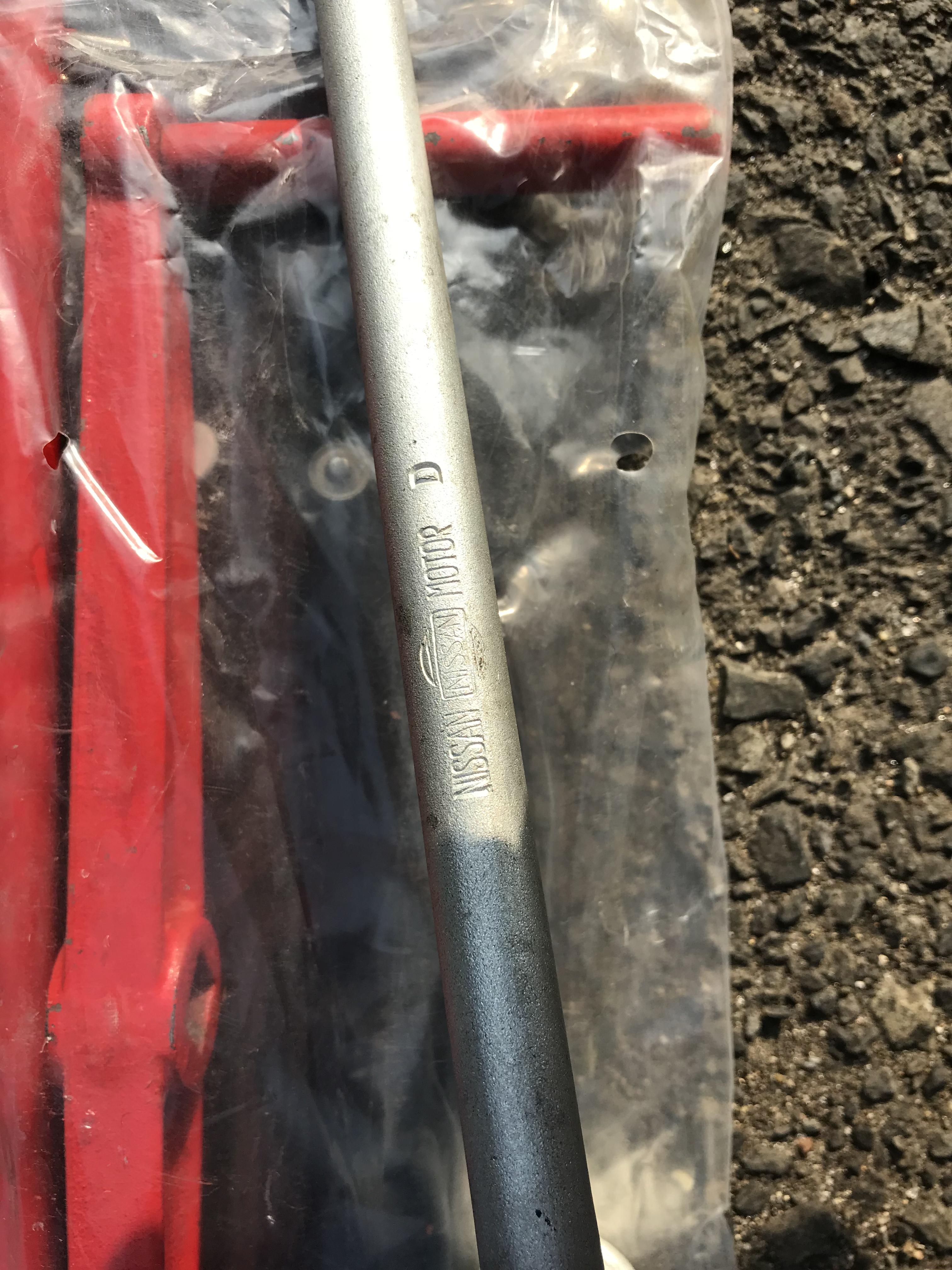

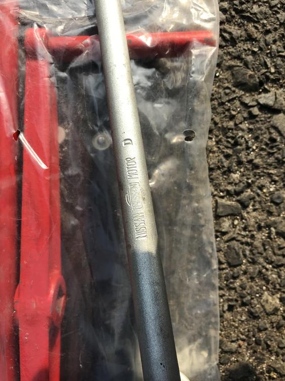

What does  “ D “ on the wheel nut wrench mean ?
I stowed them “ as directed “ into the bin.
Tomorrow I will drive this orange 240Z from my mother’s house to my house , 550 miles trip !
Kats
