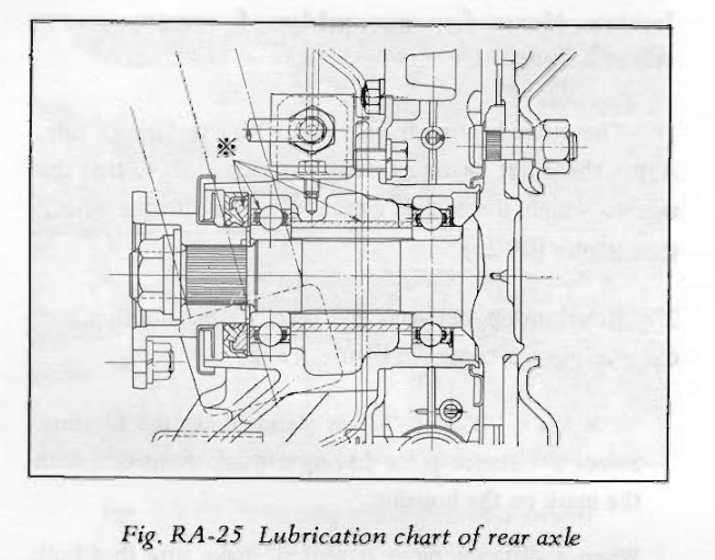

Do you have the FSM?  Check out the 'Wheel Bearing, Oil Seal, and Rear Axel Shaft' section in the RA Rear Alex section of the manual.  You need to set the bearing preload per that section.  You may need to check which distance piece and hub you have also.
Thanks for reply and Yes i have referred to manual. When setting preload on the bearing how do go about doing that? Are the distance pieces different for driver or passenger side? Maybe thats what im missing.
The distance pieces were the same both sides and the hubs were stamped the same on my car. I do not know if they could be different.  I seem to remember a thread stating most were all the same and it is rare to see the other sizes.  I also do not remember which is the most common.
Torque is listed in Haynes manual as being 180 lb/ft up to 240lb/ft.  Then use a spring balance to a wheel lug and check the point where the the hub will rotate.  Should be between 25 and 30oz,
It it's binding at 100ft/lbs you have some problem.  Make sure every thing is assembled correctly  and check (measure) the length of the distance piece.  It could be worn allowing it to bind the bearings.  I have heard of them being shimmed to get the correct preload.

You said you used the FSM.  It's in there, with a big picture.  Dimensions for the distance piece also.  It's all in there.  I'd measure it even if you find the letter.  Which bearing part numbers did you get?  Maybe you got the wrong bearings.  Did you compare old to new to see if they match?
It looks like Nissan went with high precision on that assembly.  The axle rides very close to the casting.  A short distance piece might allow the inner race to pull in at high torque.  If it did though, you might have damaged the races.  The torque is supposed to clamp the two inner races against the distance piece.  You're putting all of the load on the balls and races.
