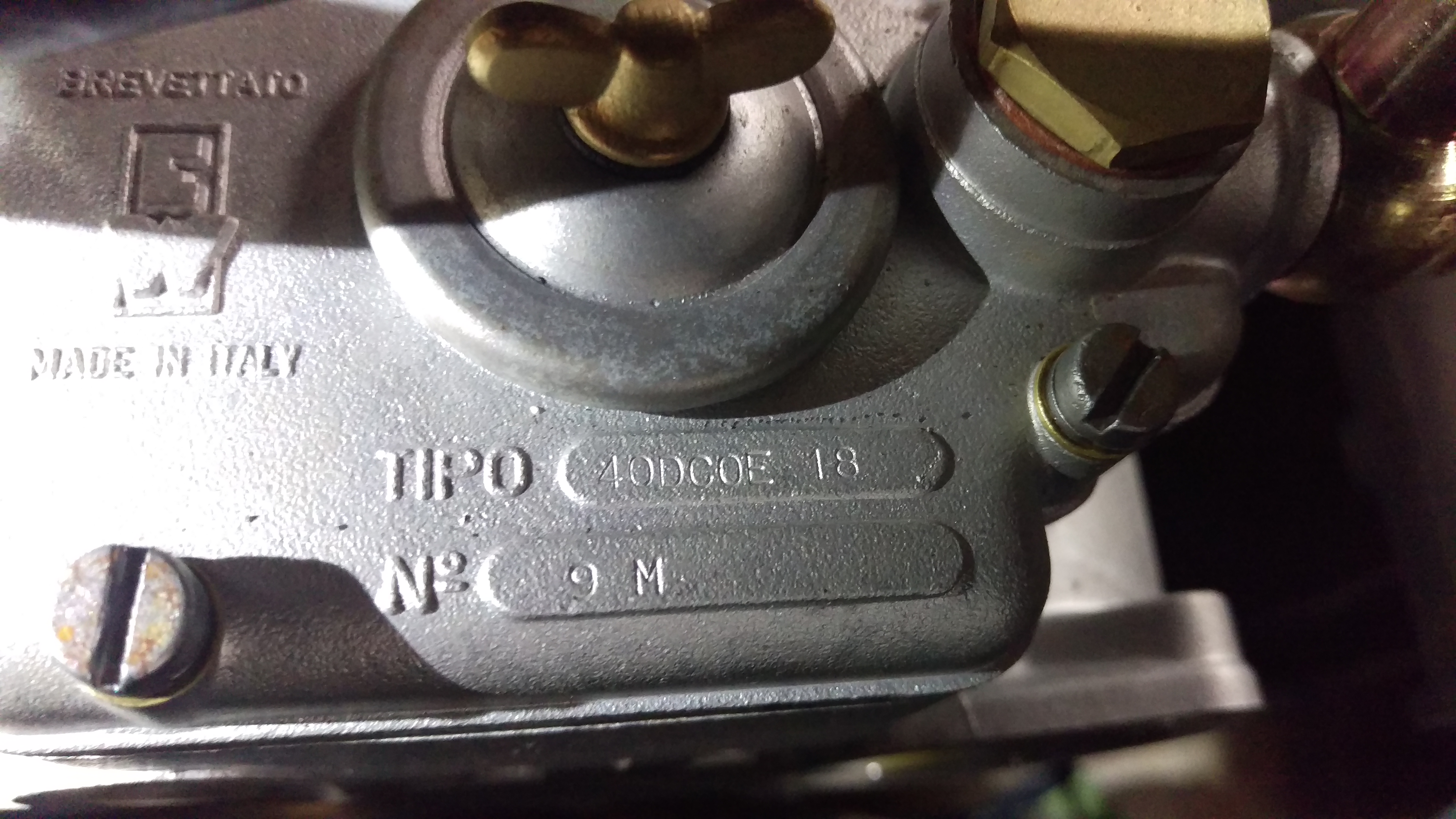

Thanks for the help,  I checked and adjusted valves but when the engine was cold.   The linkage is all new and equal length.   They are Dcoe 40.  On the top they each read   Dcoe 40 18 and 9m
Can you write the full tipo and no for each carb like below?

All carbs are the same as picture below

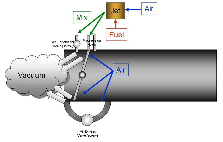

 No, thank you for talking it out with me and taking the time.  I have disconnected the push rods, they are completely closed.   I'm confused how the engine still runs with plates closed.   Is there a seperate opening for idle circuit?  Excuse my ignorance

At idle, the only places for air to pass to the cylinders are:
On Carbs:
1.  Idle enrichment screws.  If these are open too much or if the idle jets are too large (have too much air and fuel passing through large drillings)
2. Throttle plate air bypass (built into 40DCOE 151 and 45DCOE152 carbs). Early carbs like your 40DCOE 18's may have holes drilled in throttle plates.
3. Twisted throttle shafts (one plate closed but the other is partially open...usually on early carbs with brass rods).
On Intake:
1. Poor sealing between carb and manifold (loose hardware where softmount grommets/thackery washers are located).
2. Poor sealing between head and manifold.
3. Air leak from brake booster.
4. Other (such as you PCV fitting).
What are your idle jet sizes?
For a next step, I would recommend that you check for all of the manifold leaks then if no leak is found:
Keep push rods off and, with engine running, start turning in idle enrichment screws in to full stop then back out to 1/2 turn (gentle pressure at full stop is fine).  For early DCOE's like yours, the taper on the idle enrichment is rather abrupt so a small turn lets a lot of air and fuel pass.  Most early carbs work between 1/2 to 3/4 turn out.   Yours at 3/4 are way out there.
