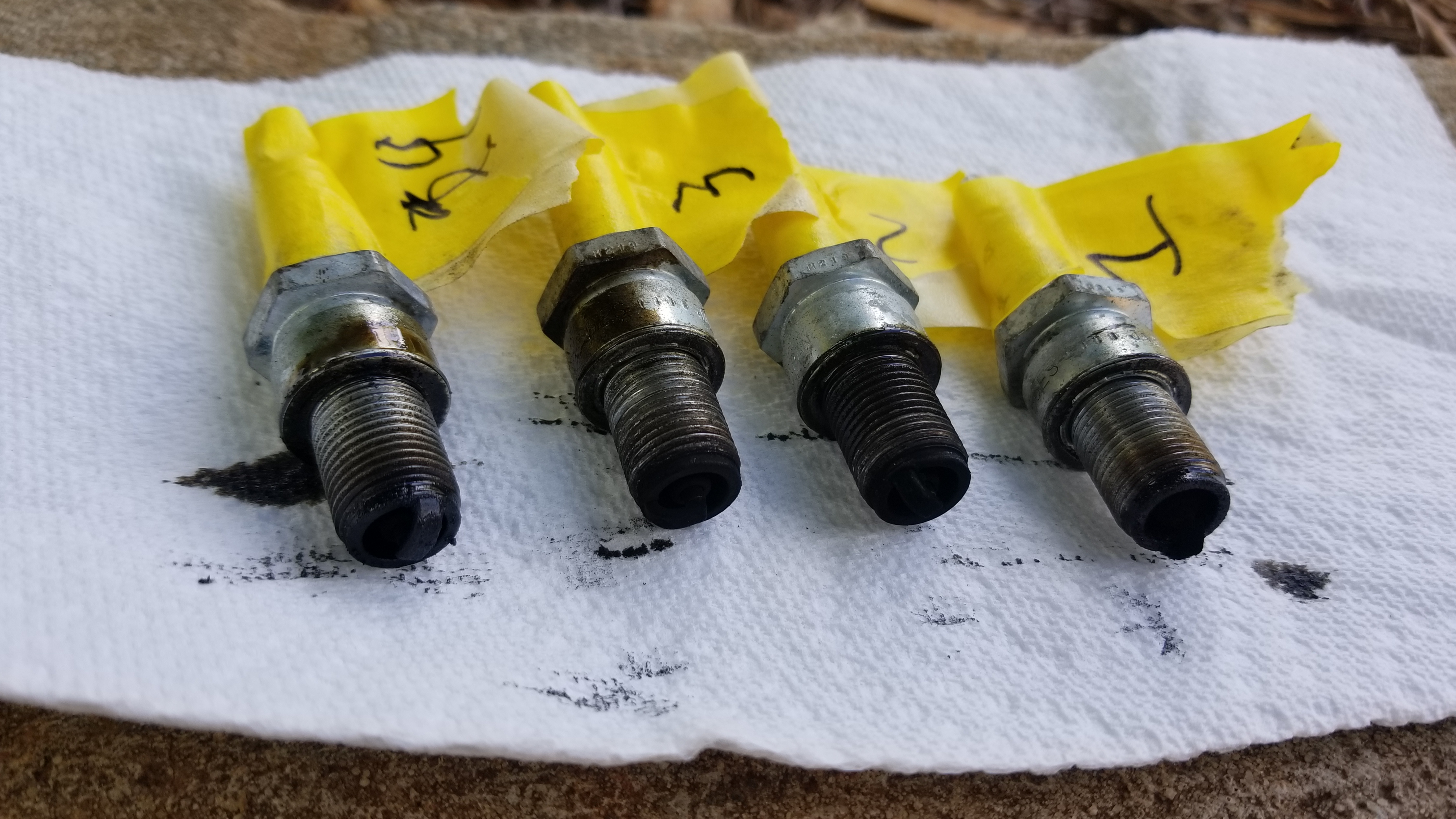

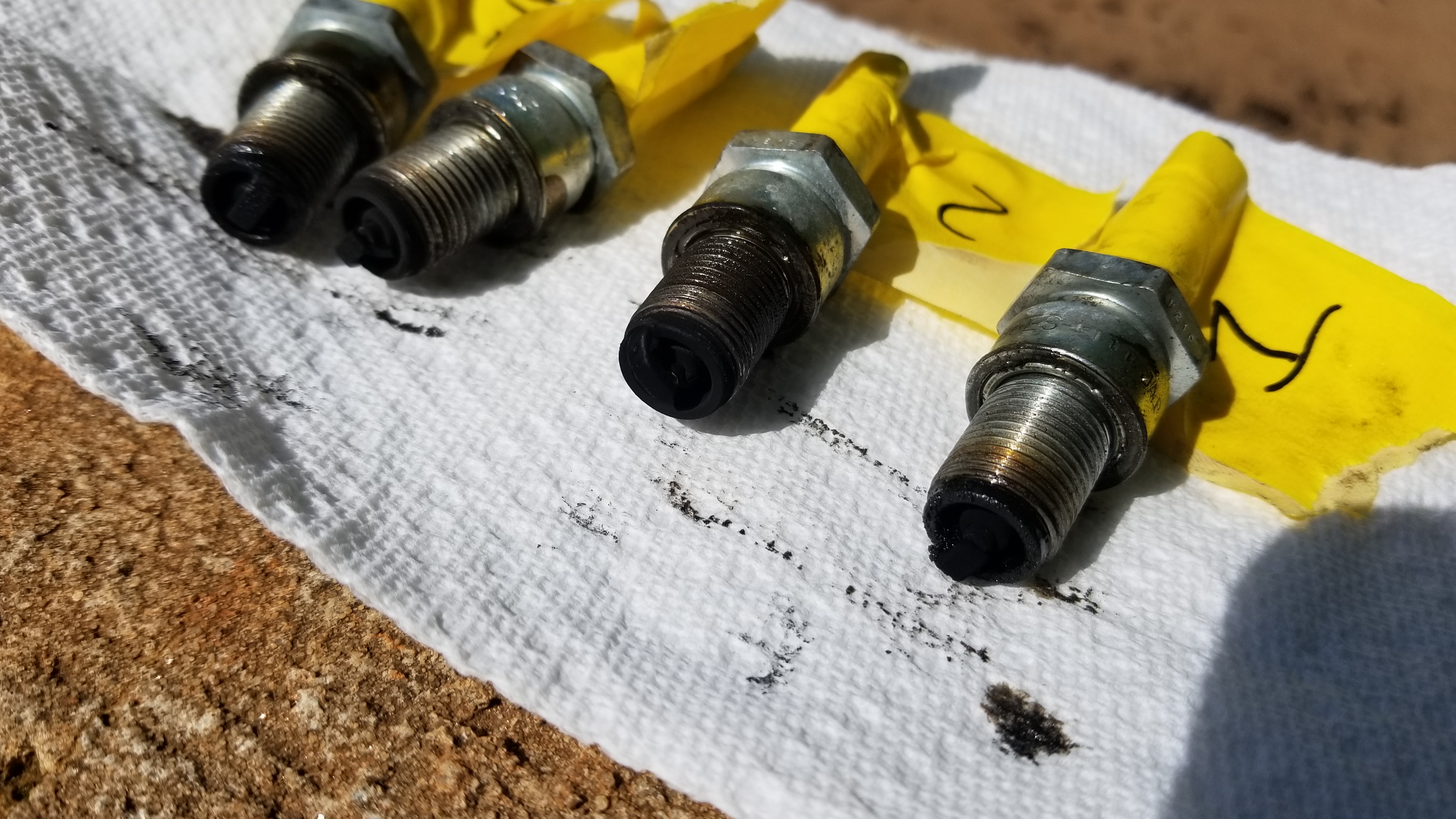

April 27, 20187 yr Author comment_548123 So I pulled the plugs after work Pig rich and 1 & 4 are wet. Oil wet I believe. We cleaned them good and put them back in. Ran it at idle for 15 minutes or more. Never really warmed up. so I sent him around the block. He overheated in less than a mile turned around and got home. We still haven't looked to see how low it is. Looking for a pressure tester now... Link to comment https://www.classiczcars.com/forums/topic/59089-codys-goon/?&page=5#findComment-548123 Share on other sites More sharing options...

April 30, 20187 yr comment_548251 wet 1 & 4 could have the water. Link to comment https://www.classiczcars.com/forums/topic/59089-codys-goon/?&page=5#findComment-548251 Share on other sites More sharing options...
April 30, 20187 yr Author comment_548252 11 minutes ago, 240260280 said: wet 1 & 4 could have the water. That seems counter intuitive since they had the best compression numbers Link to comment https://www.classiczcars.com/forums/topic/59089-codys-goon/?&page=5#findComment-548252 Share on other sites More sharing options...
April 30, 20187 yr comment_548260 better sealing from oil or water (liquid)... is it oil? Link to comment https://www.classiczcars.com/forums/topic/59089-codys-goon/?&page=5#findComment-548260 Share on other sites More sharing options...
