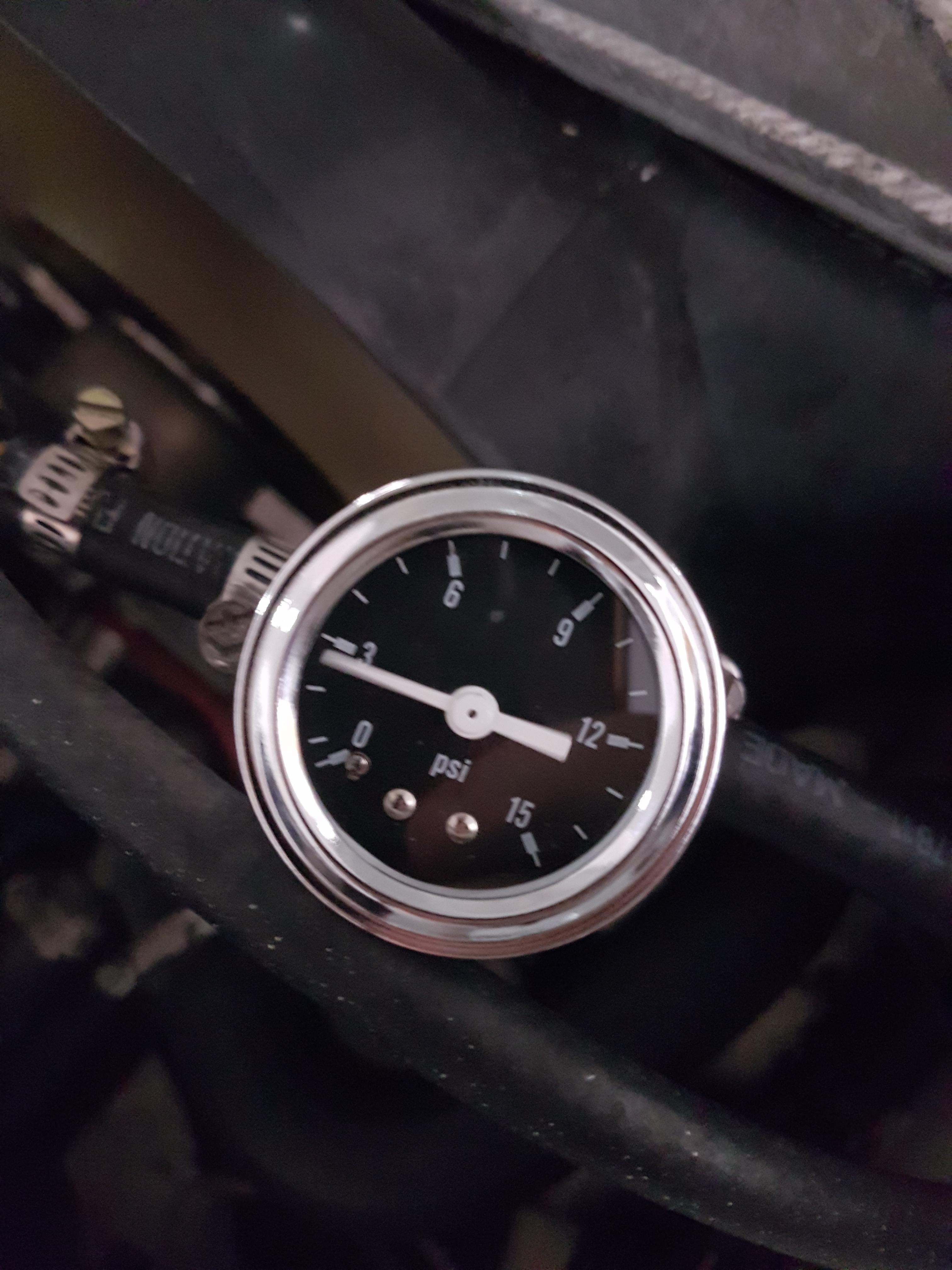

I read that you need a mimimun of 3.4 psi. I have both of my su carbs set at 2.65 turns clockwise and the car is starving at idle. Did a test with a gauge near the cam and it did not reach to 3psi.  Could my pump be defective? I have bought 3 of these lousy electric pumps and always finish ditching them for the same cause.

 Don't know what to make of the slightly low pressure but if the engine was starved for fuel, you'd notice it when accelerating, at higher RPM's and when pulling hills. That's when the engine is using the most fuel. At idle the engine is only sipping fuel. Keep in mind that the fuel mixture doesn't rely on fuel pressure. The pressure is only to deliver fuel to the float bowls. The engine would run fine at any speed if one eliminated the pump and used a gravity feed to supply the bowls with fuel.
 What symptoms make you think the mixture is too lean at idle?

Okay speed up nice but at idle the rpm tend to fall from 1100 to 500. If i go up a hill from 1st gear position i need to pull the choke so the rpm does not fall. Could there be some clog in the line?
 No clog. If pulling the choke instantly gives you more power, (the engine is warm, right?) Increase the mixture from 2 .65 turns to 2.75 turns and try the same route again. I still want to see the plug colors. You could still have one carb lean and the other rich. Also what weight oil are you now using in the carbs?
