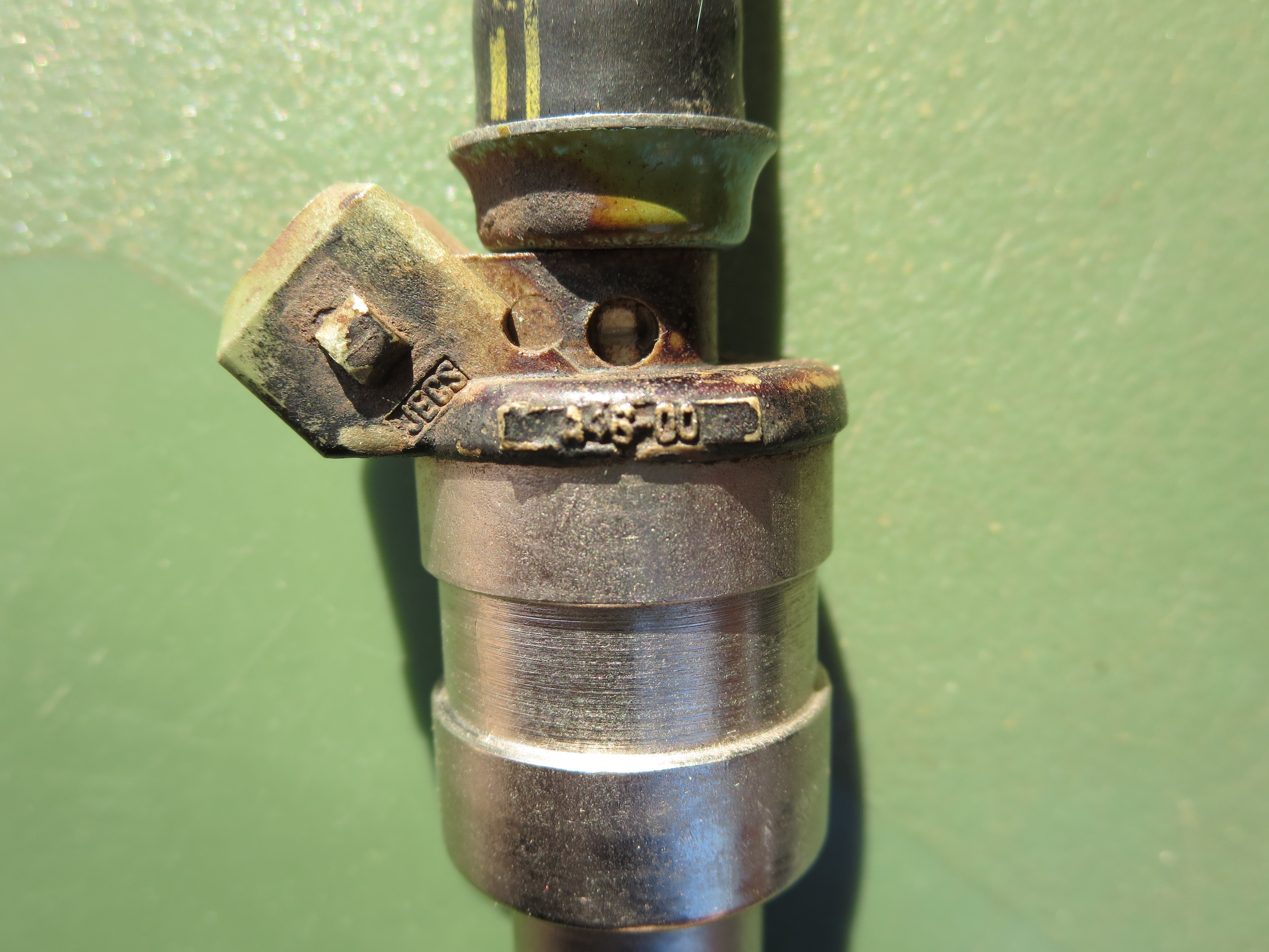

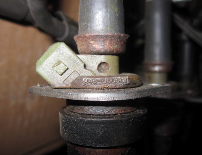

Yours don't have any numbers or letters molded in to the plastic at all?  No A46......1?  The colors fade over the years.
I have a bunch of old injectors.  Here's a picture of one of a set of six, that look awful but were perfectly balanced on my little full-rate wide open flow tester.  The other side says Made in Japan.  I had them on my car for a while but took them off when I started trying to solve the heat soak problem.  They're still on the rail.  They came from my 1978 parts car, the rusted hulk that keeps on giving.  I have some of the Bosch injectors also.  You can have either of them if you can use them.
Edited by Zed Head
Made in Japan

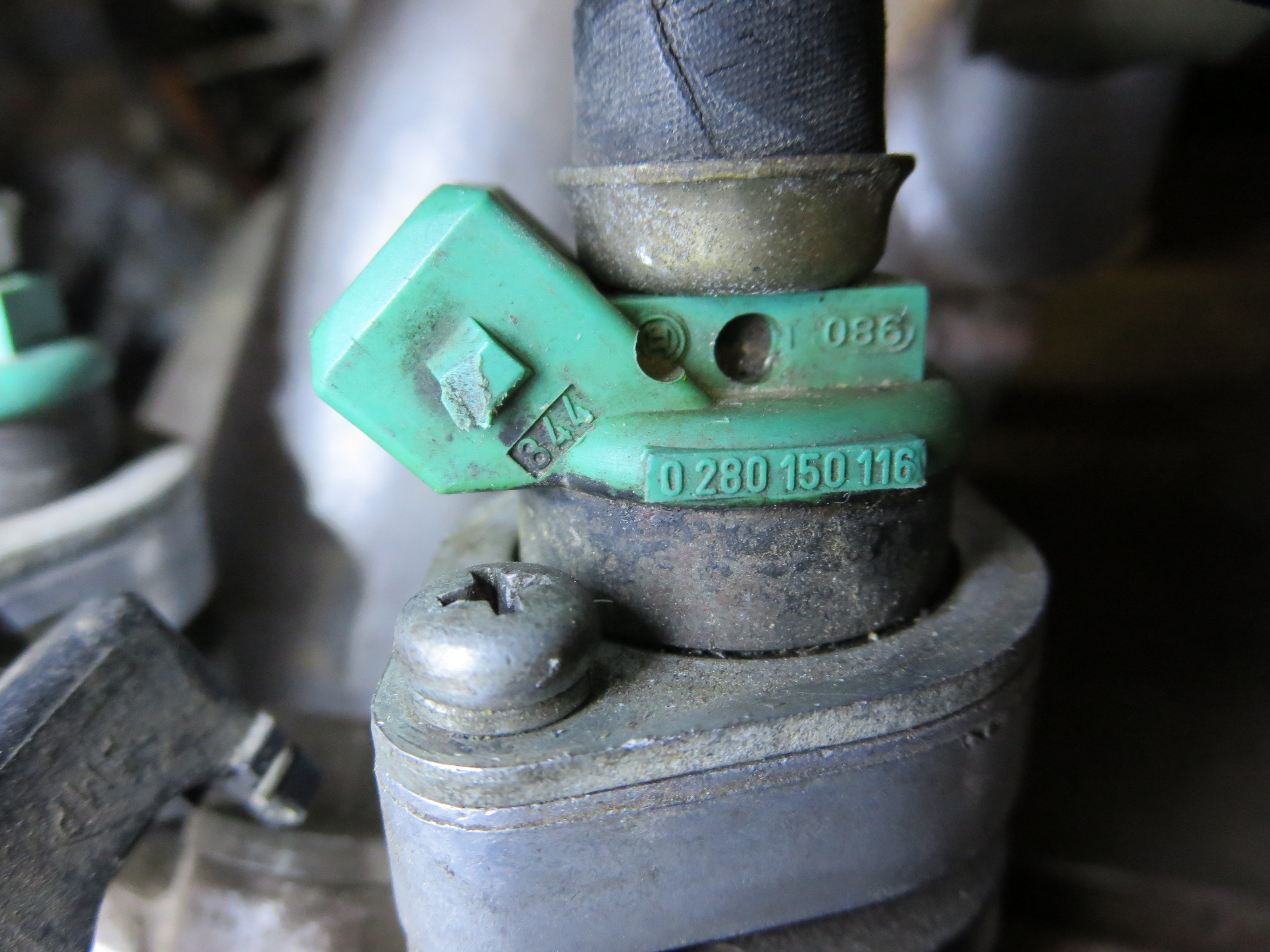

A lot of the JECS I have seen have A46-00. The Bosch injectors that I have seen and use in my 280Z are 0 280 150 116.

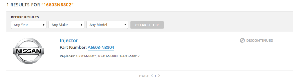

Here's some internet fun.  I took one of your Bostech pdf file numbers and Googled it.  I got some 280Z references.  So I put it in to the CourtesyParts site and it comes up, but is discontinued and undefined.  Looking like Nissan did not identify more than the package for their injectors.  Lose the paperwork or package and it becomes unknown.
