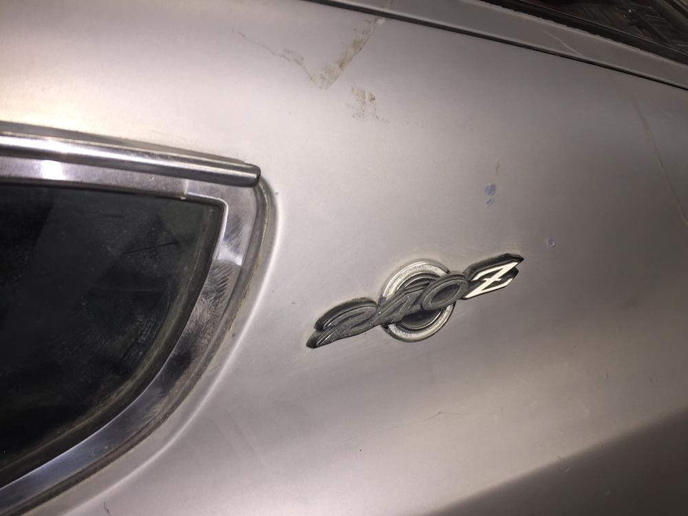

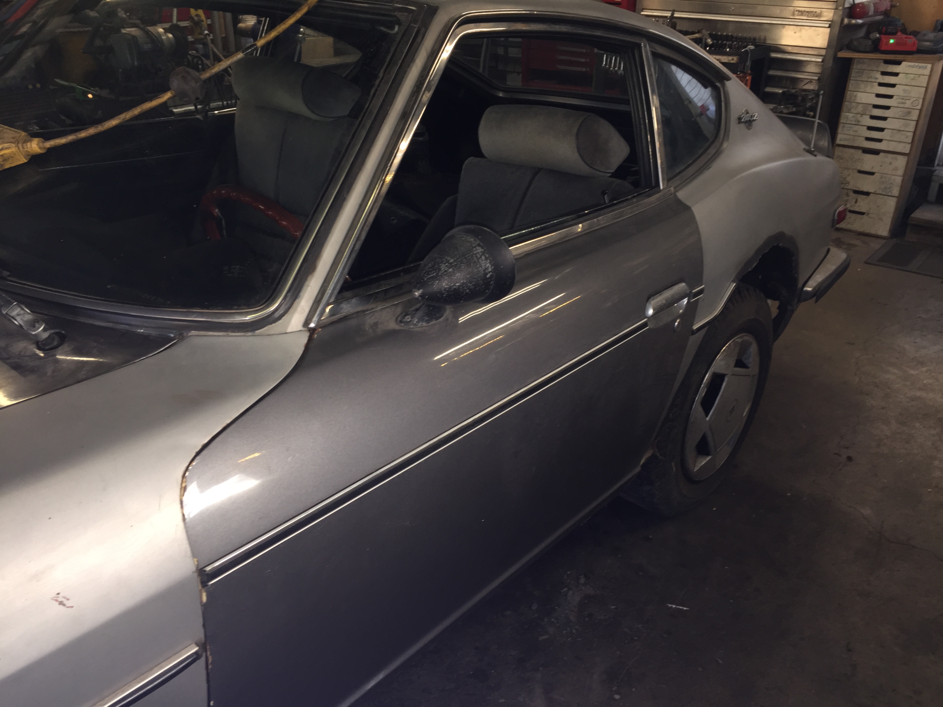

Ok, I bet you already know where this story is going. Yes I went to see it, yes it followed me home. The VIN is 3798, 5/70 build date. Rusty old dog, few things missing, but hey, it has a cool sun roof! (See other recent thread about SEMA and Sun Roofs and being cool).

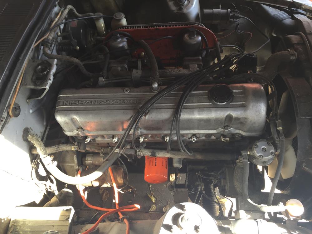

Series 1, (Sorry), Canadian import, no air pump, no air injection holes in the exhaust manifold, super smooth balance tube. Single groove harmonic balancer
Been stored inside for 26 years. Not started. Not heated.  Fired right up with only simple fuel system and electrical system clean up. Runs stronger than my damn stroker. Well, not quite...
Engine number match engine bay tag

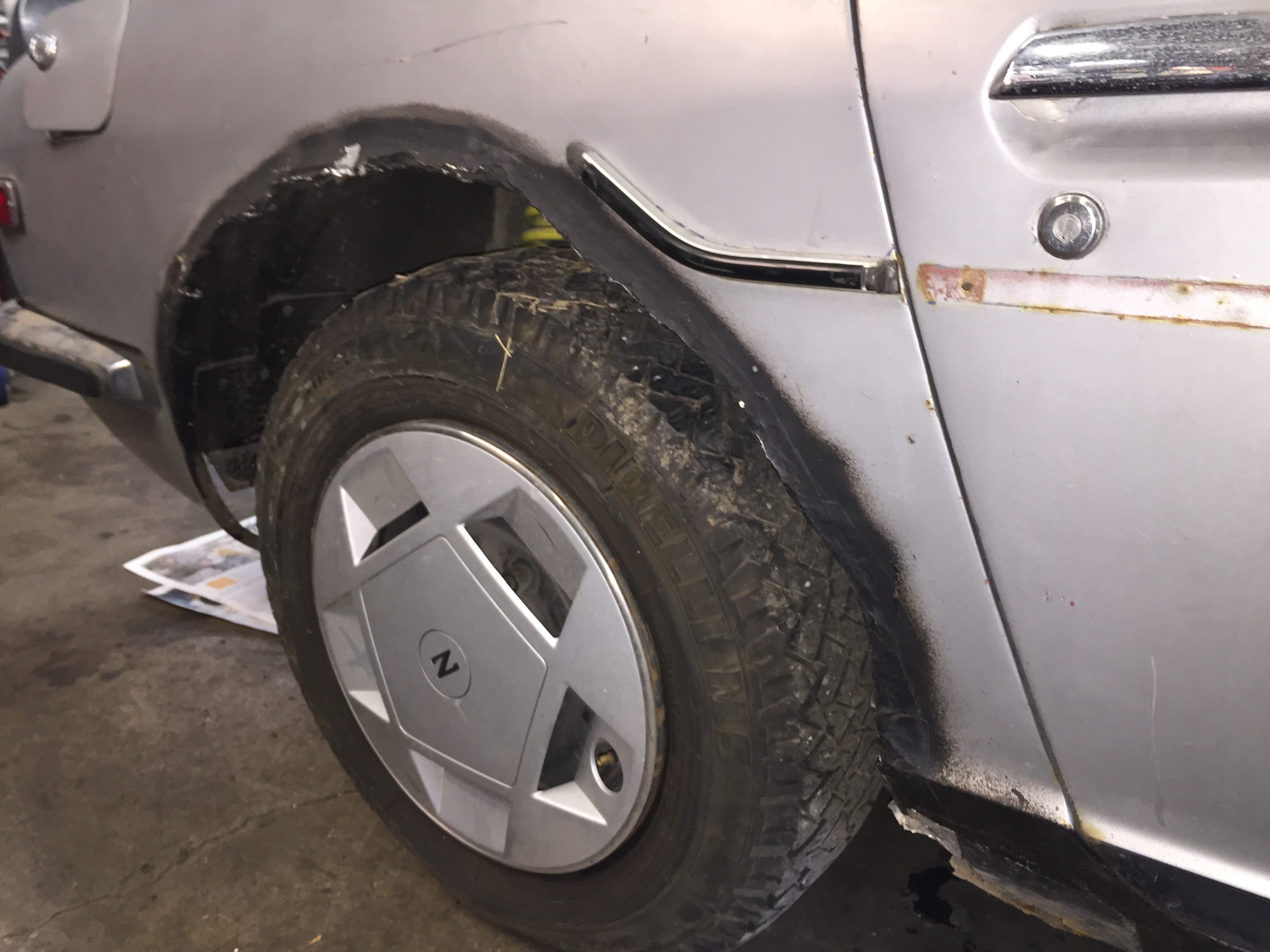

Rust. Dog legs, battery tray, rear arches, front of floor pans, nothing really serious.
Wheels and tires are from an early 300 zx. Nice + offser... not. Winter tires!

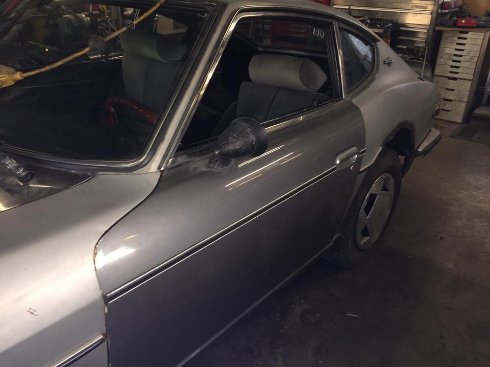

Seats from some 80's sporty thing.

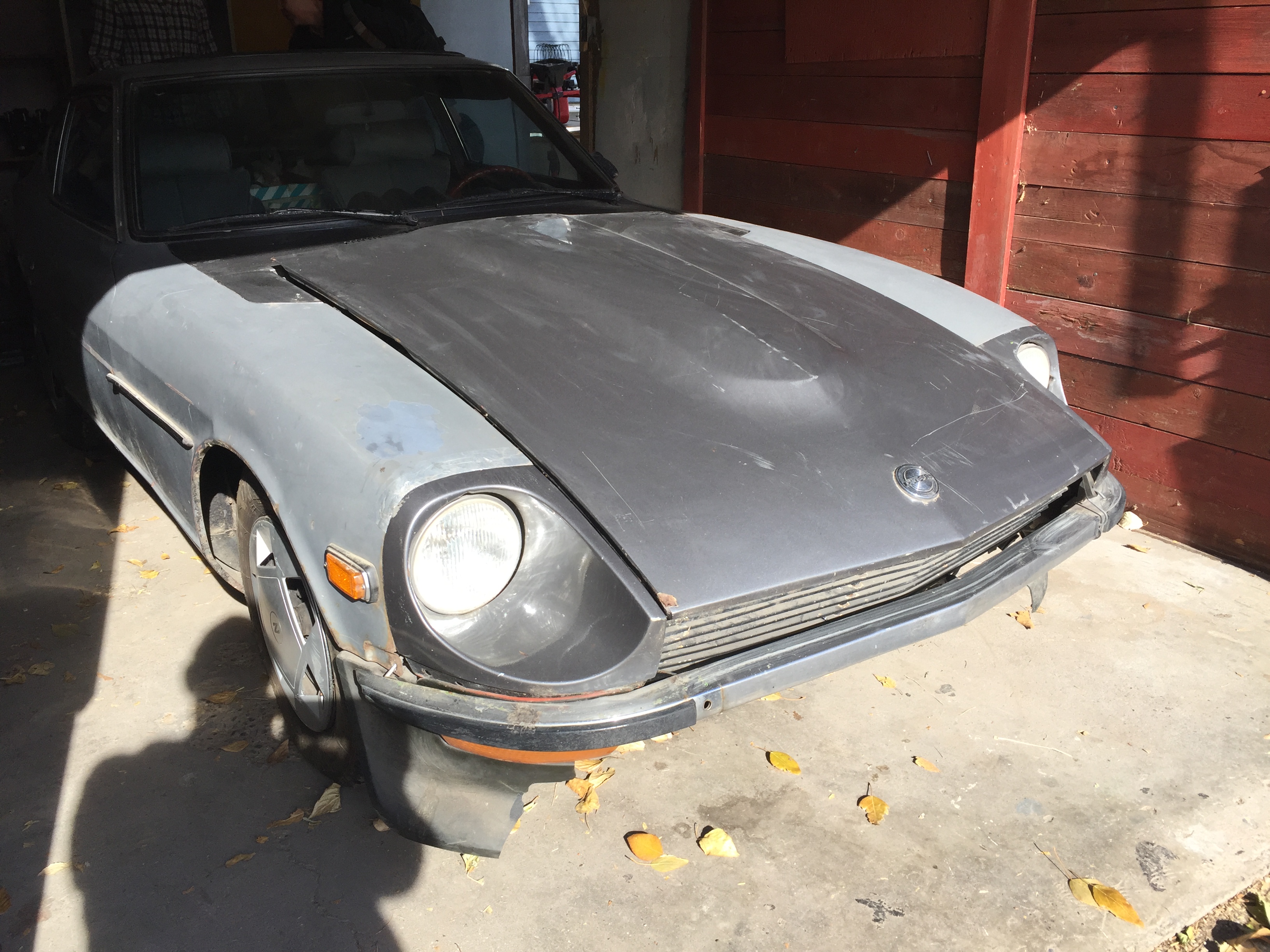

The dash is from a 71, VIN 25xxx. Wheel has spokes with holes. Thus no idea what the chassis mileage is, but at least 100K. The clutch pin is about 1/2 the diameter it used to be.

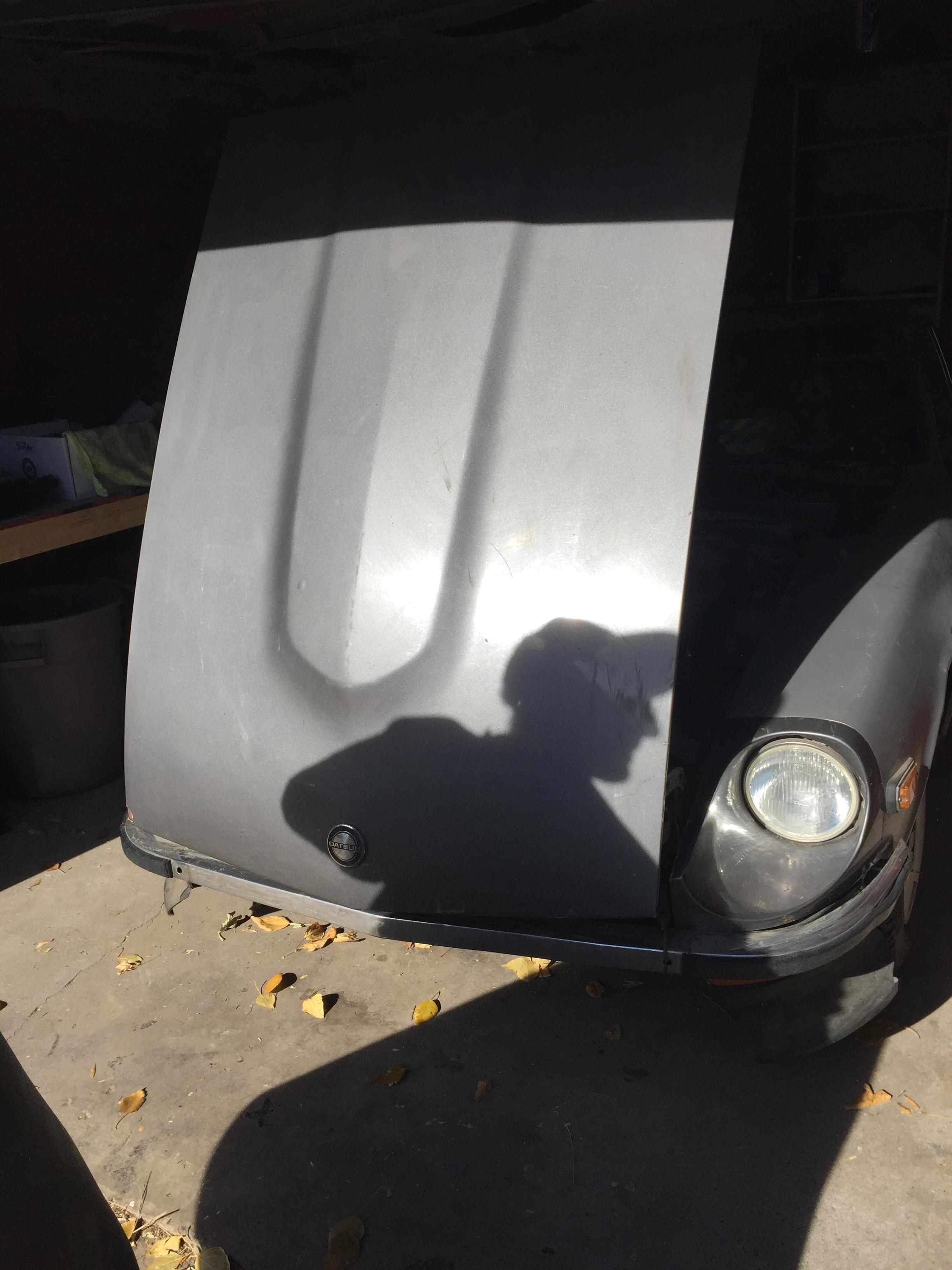

The hood, inspection doors, cowl, head light sugar scoops, are all not original. Likely from the 71.
3 minutes ago, JSM said:
Oh man you've got your work cut out for you!!! What seats are those?
"Cut out", perfect yes, cutting out of rust and schmegma.

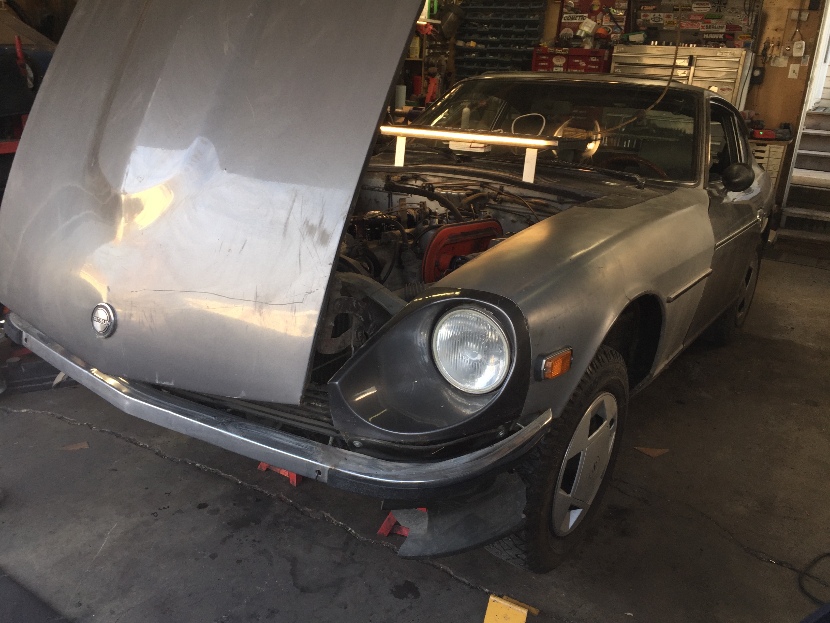

Fuel system clean up, which was drain the 2 or 3 litres of that lovely smelly 26 year old fuel left in the tank, blow out the fuel lines (nothing there), change the fuel pump, clean up the SU's a bit, new fuel filter. Add battery, clean up primary electrical supply and grounds. Put 15 litres of fresh hi-test in tank. Change wires and plugs. Sand down arced points, replace coil. Change oil and anti freeze (which was still clean and good to -20F). Turn key. Fight to get pump primed (cheap can style pump, crap) Start car. (Chokes work just fine). Warm up. Good oil pressure, temp stable.
Replace clutch hydraulics. Clutch works fine on first try.
Rear wheels are stuck on rusty drums. Drive it back and forth in garage until the wheels turn. (Have cute drag marks on floor now!)  Get drums off (heat and BIG hammer) and, oh god, thats disgusting,...  just take it all apart and replace with new hydraulics, lines, shoes etc. Yeah! Rear brakes! Oh for heavens sake the e-brake works just fine!
Hummm. Clutch works, engine works, have some brakes,  drive??  Hell yes! Open garage door.  What the hell is the white stuff in the lane???? Snow!!!?!?!?!?   YES!!!!!!  Go for drive. Not always in a straight line, foot on floor quite a bit,. Just around the lane, really.   It's already rusty, driving in the snow (and sluch and salt tomorrow) how is this a bad thing!
