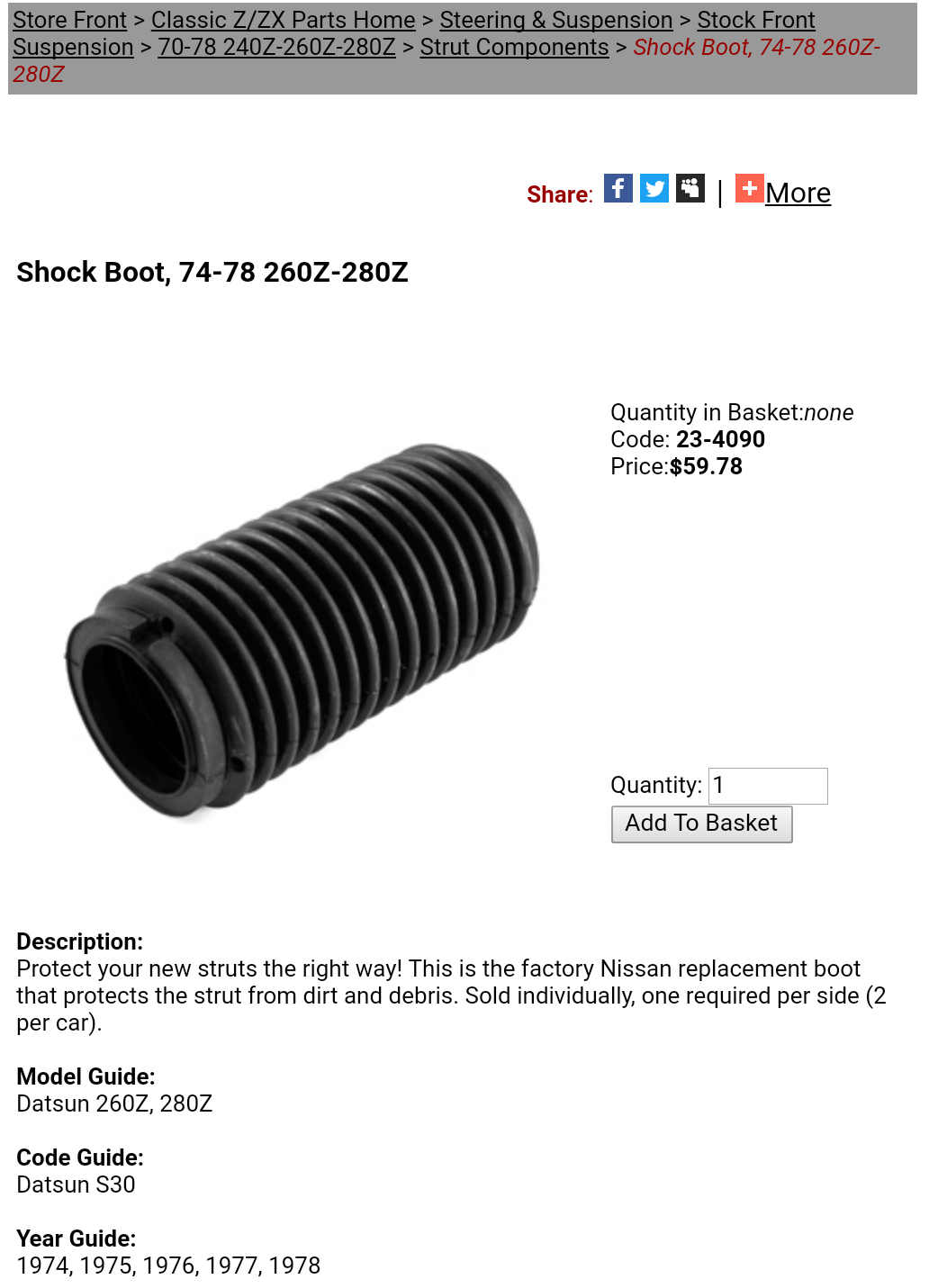

MSA shows the Nissan bellows in stock for $60 each.

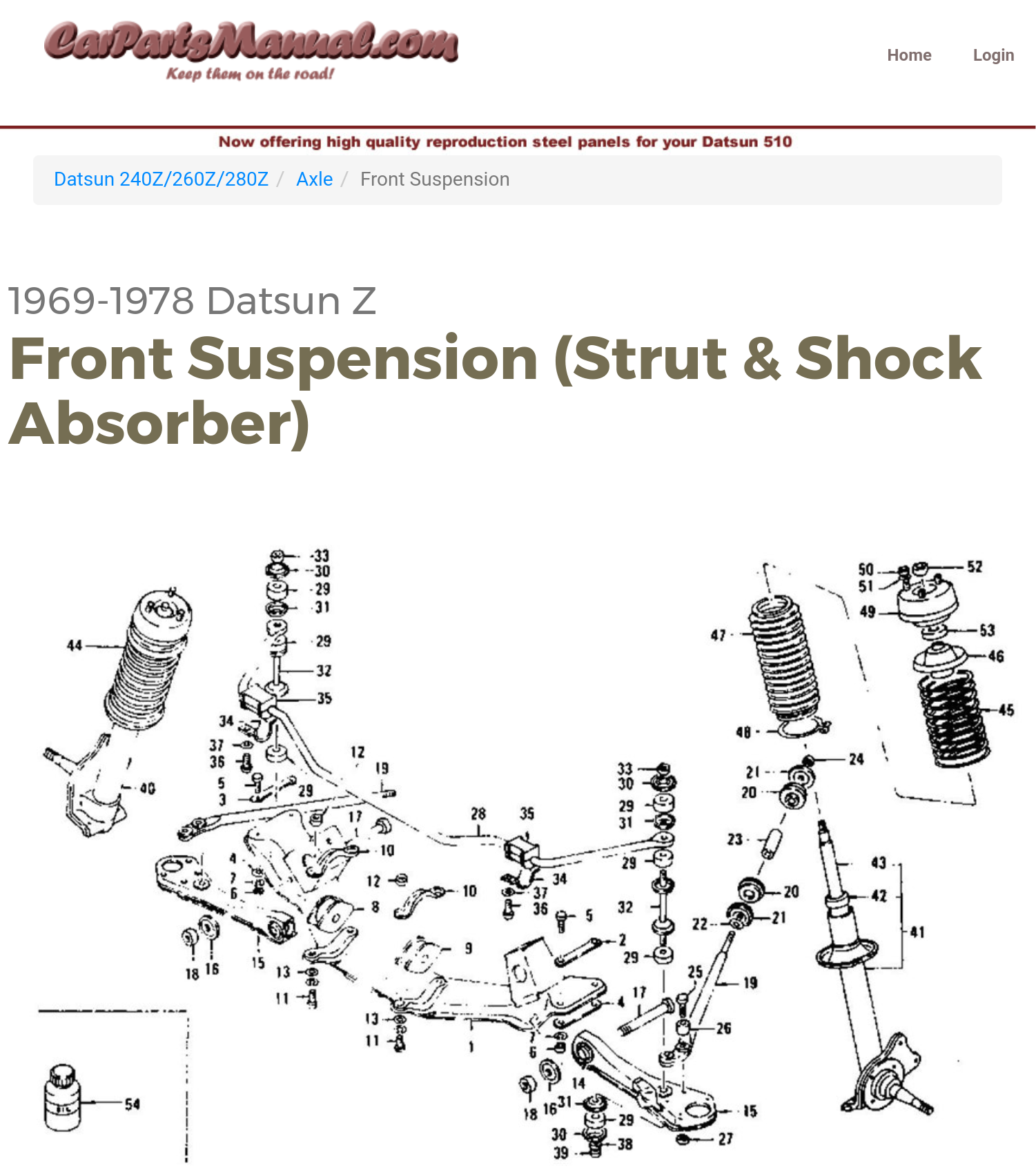

What did the 240Z have. All the info I find points to Nissan first using them on the 260Z in 74/09.
The ones on MSA look better than the set I have. Looks like a genuine copy of the original.
http://www.thezstore.com/page/TZS/PROD/classic20m01a/23-4090
don't forget the RING SNAP #48 without that they prob will not stay in place very well on the lower part of the strut. If you don't have one to look at, its a piece of wire that looks like its made from spring steel, with a eyelet formed on the ends to prevent it from digging into the rubber.

240zs had nothing as far as I can tell.

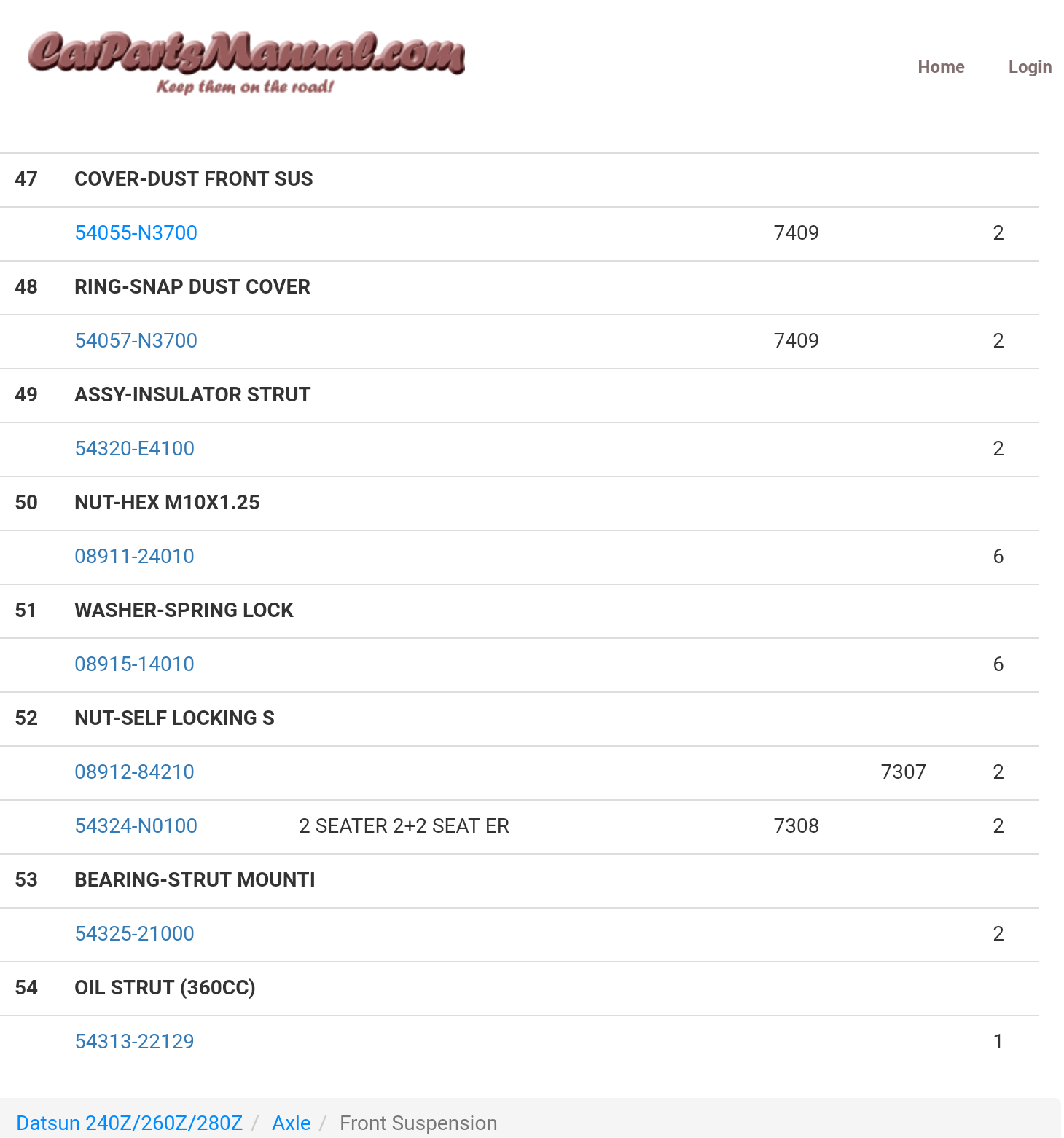

Looks like Courtesy has the bellow/dust cover (54055-n3700) for $48, but the snap ring (54057-n3700) is discontinued.
Also, MSA says 2 required per car, but also that they're sold individually, which should mean 4 per car. Curious.
