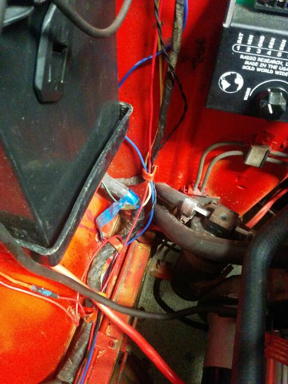

If you're searching for keyed 12V in the engine bay my car is not to far off of Duffy's - 12/70. I found an unused keyed 12V bullet connector lead in the harness by the battery. Like the plug in front of the console for the electric fuel pump it was in blue tape. I used it for the electric fan controller relay. Both the blue tape and fan controller can be seen in this shot.

I have that same wire.  So it's just a dangling 12v keyed?! Good old Nissan.
