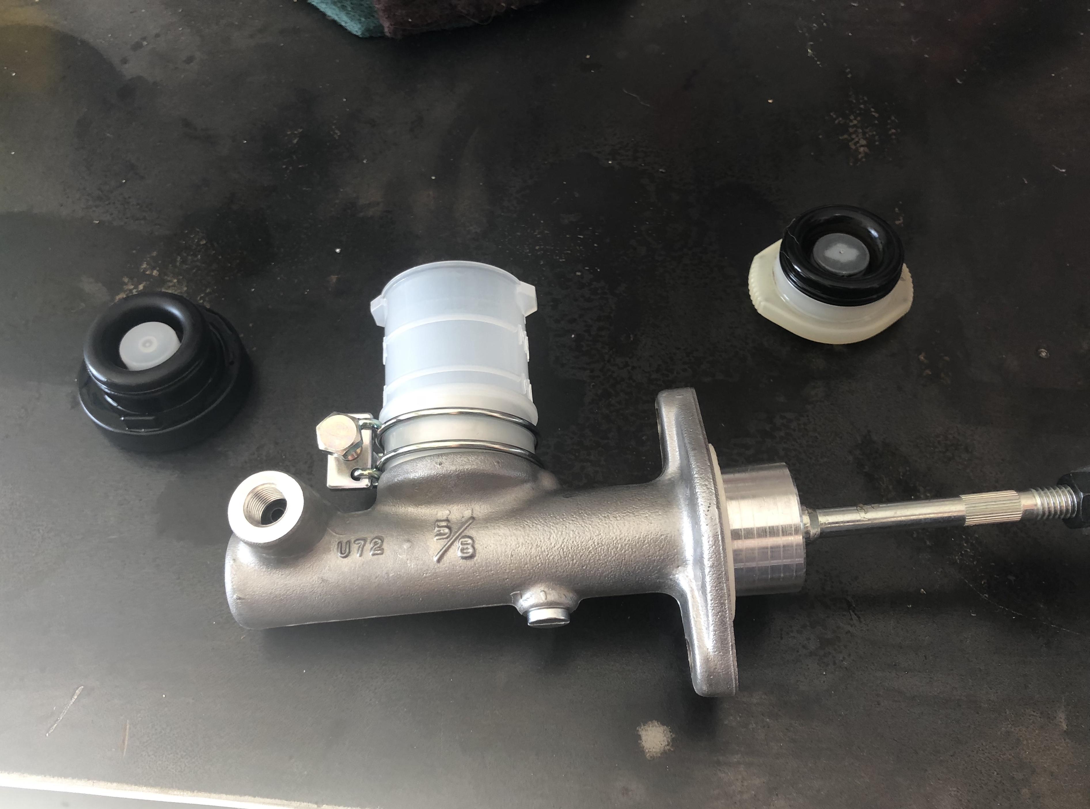

I have been driving it every chance I get.  I enjoy it so much.  Ac blows cold enough, but the fan is so loud I mostly prefer driving with the windows down.  Last week I pressed the clutch in, and boom, warm clutch fluid squirted onto my leg.  Then the clutch wouldn't do much.  I luckily was close to home and a few pumps I could get it in first.  So now it's time to change the clutch master.  Which is a first for me.  Luckily LynchBurg Nissan had a Nos one.  They still make this part but it looks a little different.
There's a recent thread about the clutch pedal clevis pin and the holes.  Can't find it.  You might read up on that before you start.  That area is not one you'll want to visit twice.
