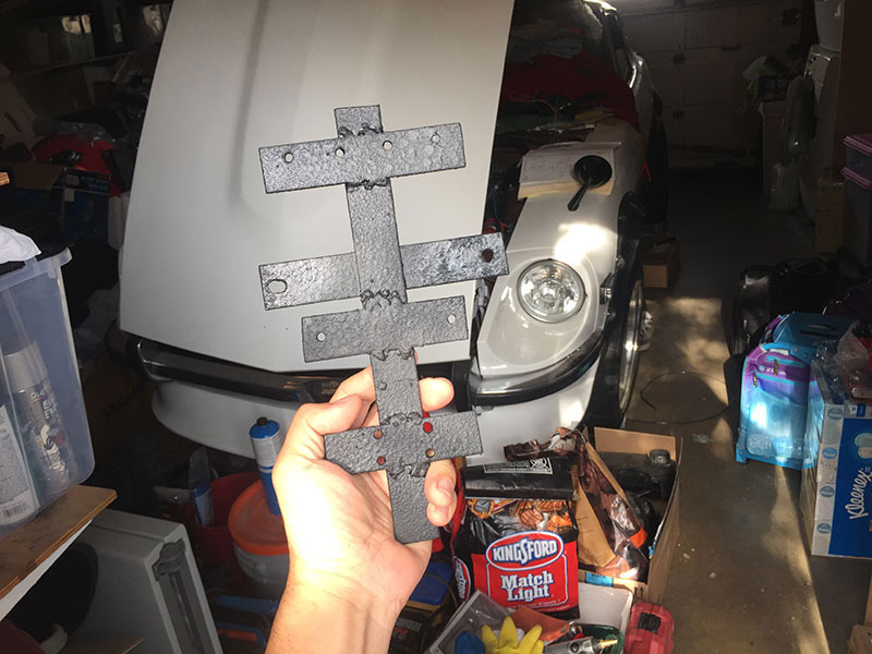

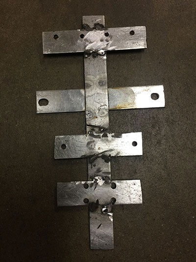

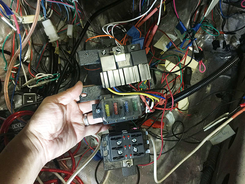

After removing transistor under passenger kick board, I found there are huge space available to mount.
I created mounting bracket. Chopping metal flat bar and drill holes and weld them together.
primed and painted with some leftover canned spray.
Completed.

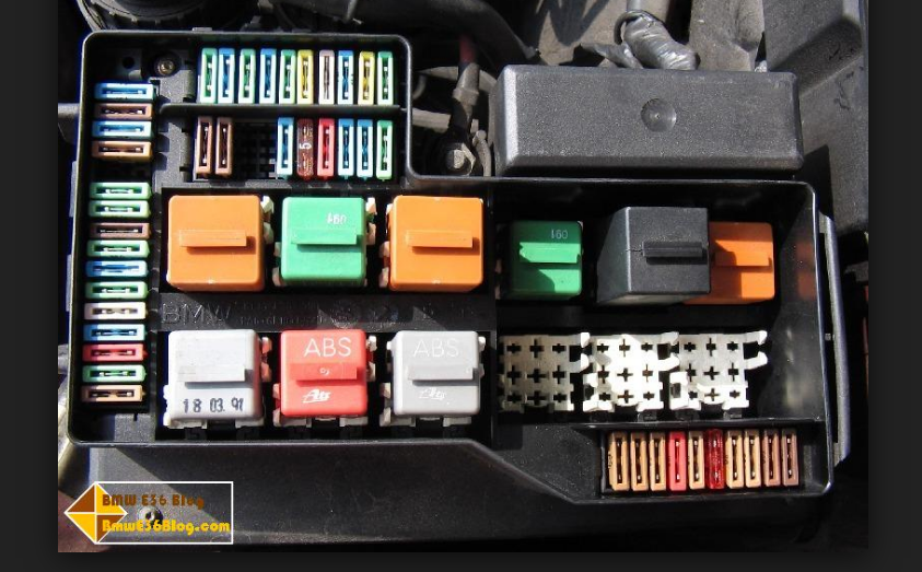

You might consider repurposing a BMW or Ford or other late model car's relay and fuse box.  Ford and BMW and several others have a nice weatherproof plastic box with a cover that they mount in the engine bay or under the front cowl.  Lots of slots for whatever variety of relays and fuses you like.
Found this picture on the internet, for example.  1997 BMW.
That's nice big box. It's a bit too big. Since relay and fuse are within cabinet( those are for power lock, power window, audio, security), it does not make sense to extend cable to rout out to engine bay in my case.
I installed power lock, power windows, Viper security system. Also I installed new modern stereo with 600W amp. Those need 4 relays and multiple fuses for IGN and +12V constant.
