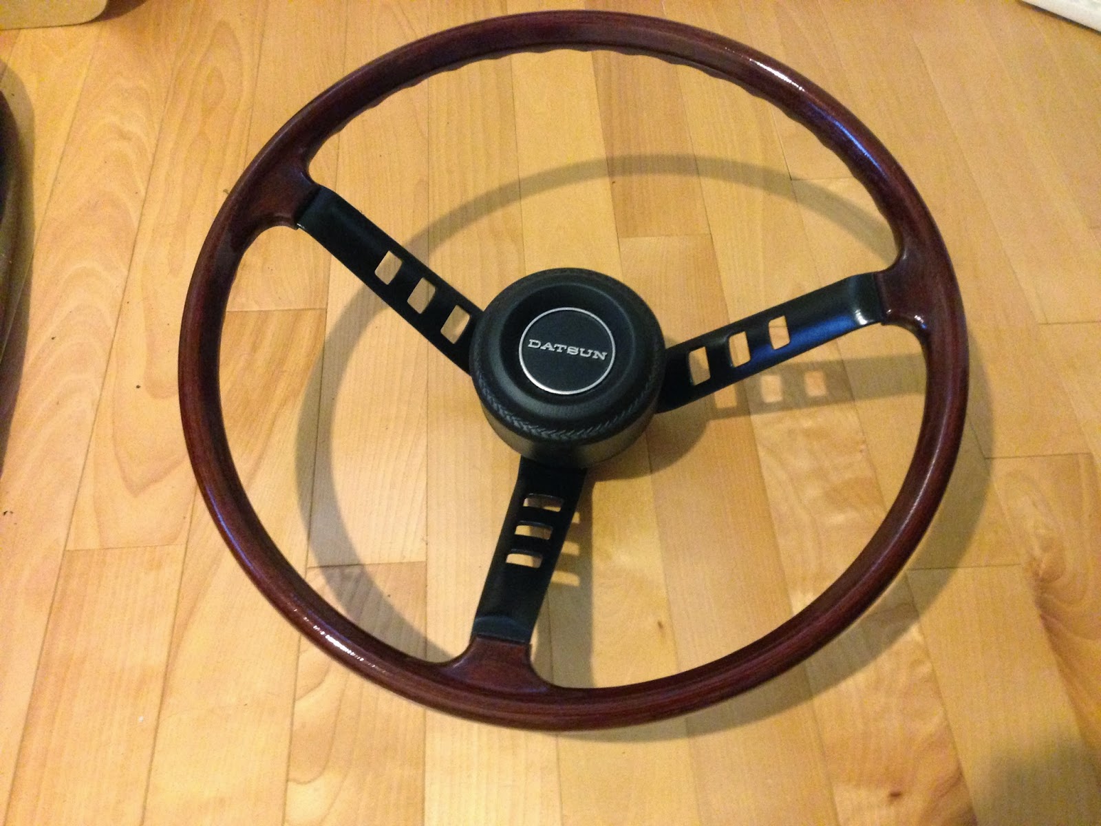

February 23, 20196 yr comment_569166 I like that steering wheel. All the 240Z wheels I've seen before have different spokes than what you have. The series 1 cars don't have the holes punched out, they're just indented where the holes on this wheel are. Edited February 23, 20196 yr by w3wilkes Link to comment https://www.classiczcars.com/forums/topic/58542-home-built-z-full-video-build/?&page=45#findComment-569166 Share on other sites More sharing options...
February 23, 20196 yr Author comment_569192 6 hours ago, w3wilkes said: I like that steering wheel. All the 240Z wheels I've seen before have different spokes than what you have. The series 1 cars don't have the holes punched out, they're just indented where the holes on this wheel are. I thought mine was the original, but one of my viewers identified it as a 240K wheel. Either way, I like it so it can stay. Link to comment https://www.classiczcars.com/forums/topic/58542-home-built-z-full-video-build/?&page=45#findComment-569192 Share on other sites More sharing options...
