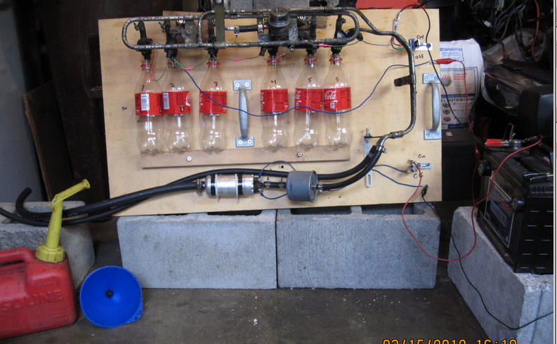

Chas, Haha! That sure does look familiar! I don't remember, but I probably got the idea from seeing what you did! Out of curiosity, how did you get the injectors to fire?

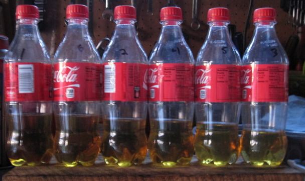

I wired my injectors in series and used a car battery to just hold them open for a certain time.  Then set all of the bottles on a level surface for comparison.
I first tried cranking, but it would take a long time to get any usable results, and even with the plugs out it would be hard on the starter/battery.
In the end I made a harness with some old connectors. 3 sets of two injectors in series so they would not be running at full battery voltage. Then two aligator clip on the battery. I still have the harness somewhere. Il take some photos of it and post them for reference.
Used a screwdriver through the aircleaner to activate the AFM flap and turned the ignition on to run the pump.
Chas, That's  exactly what I did as well. I used the starter for about ten seconds and decided I needed to do something different. That's when I got the signal generator out and used it to drive a relay that pulled the lower side of the coil to ground. That way, I could also test the ignition system and verify the one injector opening for every three sparks, as well as vary the frequency. A little crude, but it worked.
I only mentioned the sig gen because I'm sure Dave has one. Probably vacuum tube, but I'm positive he's got one there somewhere.   :)
Haha!! I'm disappointed! It's solid state and not tubes!!
Hope none of your neighbors are listening to the radio or they're gonna hear you testing your injectors.  :)
