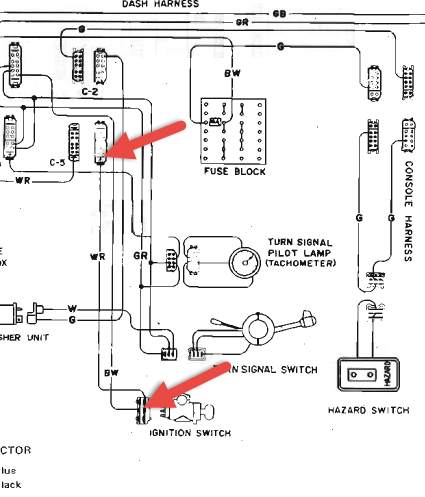

Well I know you know this, but don't get hung up too much on "continuity to ground". Some things will appear to be shorted to ground, but are working as they should be. Like the headlights...
If you are measuring continuity to ground through the headlight wire, it's not a problem. It's supposed to do that, and unless you have a good meter, you won't be able to tell the difference between a cold filament and a dead short.

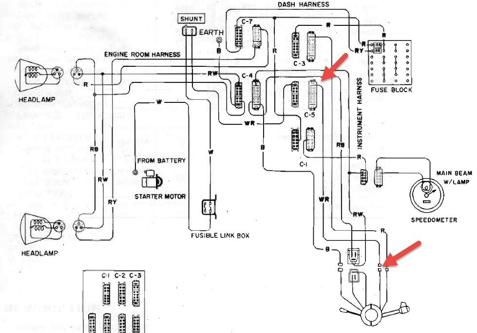

But if you have disconnected the circuit before the load or switch, you should not see continuity to ground on the side that is upstream of the load/switch. In this case, the W/R wires were disconnected on either end, so for all intents and purposes, we're talking about loose wires in the dash harness. However, I was still seeing 0.1 ohms to ground on either end of either wire. That is why we're going to examine the dash harness.
Oh. Nevermind. I was confused by semantics and picturing you taking measurements somewhere else. (I'm a dirty skunk? I'm a dirty skunk?)
Seems really odd that it would be both of those W/R wires though, doesn't it? Both ends disconnected, and they both still measure hard to ground?
Yes, it's very odd. That's why I want to inspect the harness closely. I could see a lot of vampire splices in other wires, too. That's usually not a good sign, but I hope we can restore everything to functional.
