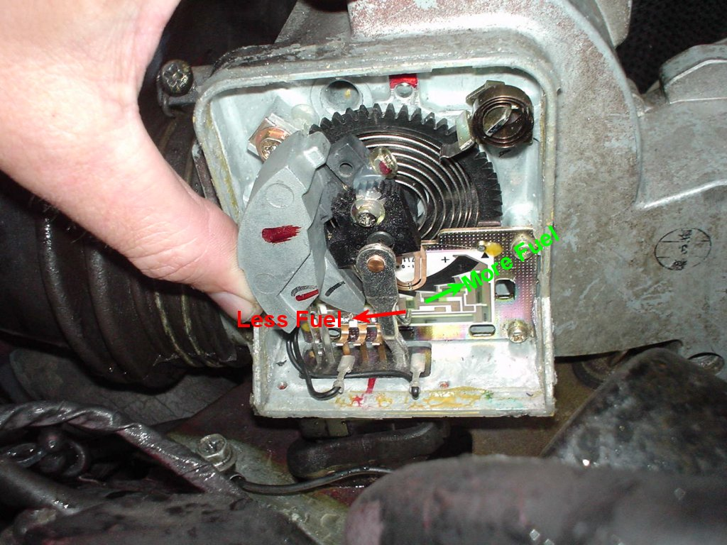

Is the vacuum hose hooked up and in good shape to the fuel pressure regulator?  All the air hoses are routed the right way?  Sounds to me like it's not getting enough air.  The throttle blade may be inoperable?  Have you taken the black cover off the AFM and "fingered" the vane with the weight on the other end?

I also messed with the AFM and rotating it caused the following results:
  • All the way shut against the stop: engine stalls (no suprise)
  • Let it sit where it wants to: runs like in the video
  • 10 degrees further: idle RPM goes up from 950 to about 1200
  • No real change until about 20 degrees past that, where the engine begins to stumble
  • 15 degrees past that: stalls

To disable the CSV all you need to do is unplug the fuel line and clamp it off. The TSP contributes to the fuel mix at idle and full throttle, should be set correctly. The temp sensor is the one that effect warmup mix the most. Hopefully no one as monkeyed around with the AFM. I think its a fuel pressure thing, need to make sure the FPR is working right and lowering the pressure after the engine starts and generate a vacuum in the intake manifold.
