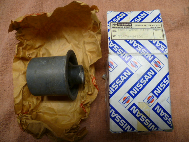

NLA, very hard to find NOS parts. I am hoping one of the larger vendors or even Nissan themselves will make a limited run of these. The last set I bought came out of Japan

I'm looking for alternatives.  I could get some lower hardness poly bush ones made, thats one option.  The other is looking for something like this
http://www.fibet.co.uk/perch/resources/flanged-headed-bush-fbf.pdf
I really need accurate measurements of standard ones though, that'd be a massive help.

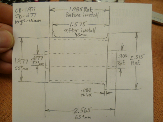

On ‎7‎/‎16‎/‎2017 at 10:12 PM, Captain Obvious said:
Here's a dimensioned sketch of the OEM bushing. For those of you who don't want to deal with my chicken scratch, the bottom line is:
OD ~ 1.977
OAL of bushing outer wall ~ 1.575 after installation (1.985 reference before installation)
length of center bolt cylinder ~ 2.565
ID of bolt hole through ~ .677 (clearance hole for 17mm dia bolt shank)
Note that the 40mm after install dimension should be on the inside edges of the bent over flanges instead the outside as it's drawn. I'm no draftsman.P1120074.JPG
