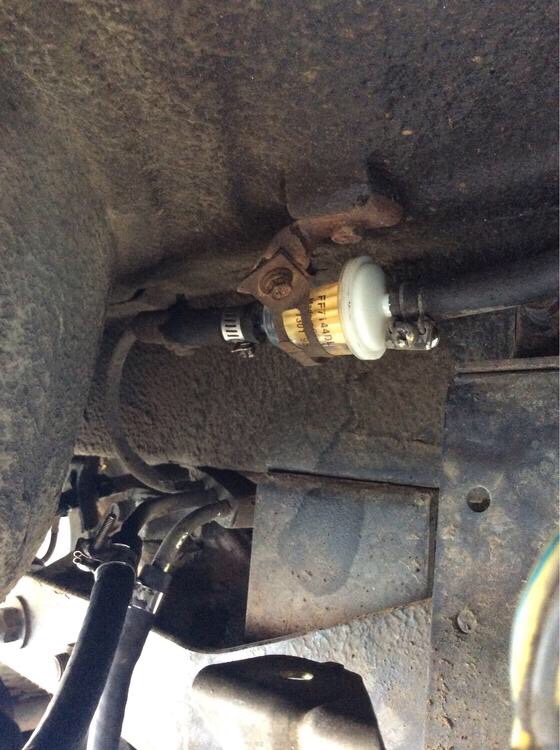

So do you guys want me to put the tank back on, but take off the fuel filters that are currently on?. Can I not do the jerry can test from the rear?. I also wanted to know that if I were to disconnect the small filter on the top how could I connect the two hoses togetherIMG_2907.JPG
Yes you can.  That would be one side of the break-it-down equation.  Put a can of fuel back there with both the return and supply hoses in it.
Use a longer piece of hose.
Sent from my iPad using Classic Zcar Club mobile
I'm pretty sure that line is for the evap fume line to charcoal canister. I honestly don't think it has anything to do with you issues.
You probably need to check the service manual to see if that is supposed to be there or not.
I maybe wrong here but that line with the dry filter looks like it goes to the carbon canister from the vapor  tank by the filler nozzle. not sure why anyone would filter that.
Yep what I was thinking too.
Prob would not hurt to check to see if that line is plug, mine was. IIRC I would get a pressure build up in there with the plugged line. Agree it would not effect operation. I think I had some odd fuel filling problems or something, really cant recall. Its on my to do list (nothing worked to clear the hose).
